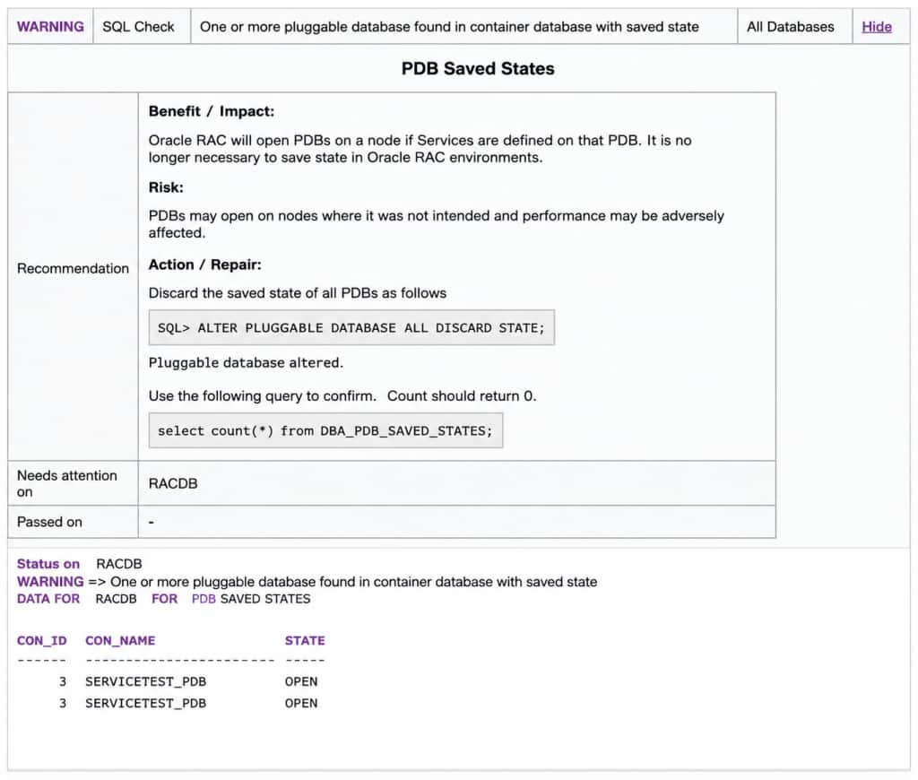

Oracle does not recommend saving the state of PDBs in RAC environments. The guidance also notes that saving PDB state can result in a PDB or its services becoming available on instances where they were not intended to run, potentially affecting performance.

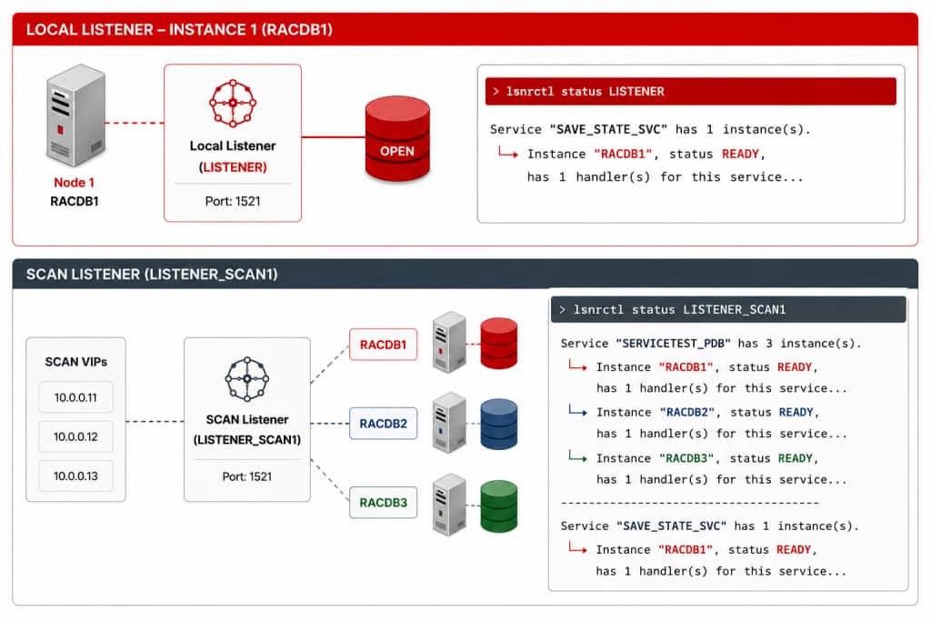

The listener registration also showed the service available only through RACDB1:

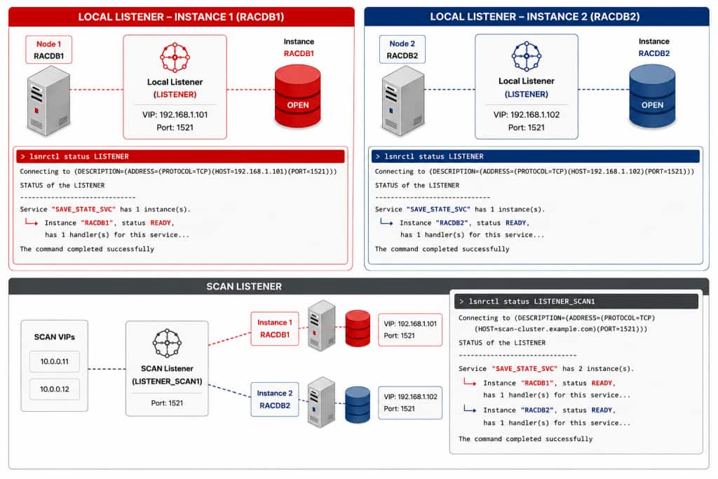

What Does the Local Listener See?
Current Status
  • Local listener on RACDB1: SAVE_STATE_SVC is active.
  • Local listener on RACDB2: SAVE_STATE_SVC is active
  • SCAN listener: SAVE_STATE_SVC is available on both instances.
  • Clusterware: SAVE_STATE_SVC is running on RACDB2.
What Happens to New Connections?
New connections can now use both instances because the service is registered with the local listeners on both instances and advertised through SCAN. The exact distribution depends on connection activity and load-balancing decisions, so the numbers themselves are not important. What matters is the change in placement: the same service is now available through two RAC instances.

When RACDB1 subsequently returned, the previously saved PDB state was restored. The saved service information associated with that PDB could also cause the service to become active on the returning instance.
Once the additional service is active inside RACDB1, it registers with the listeners. The SCAN listeners consequently become aware of both instances, making both available for new client connections.

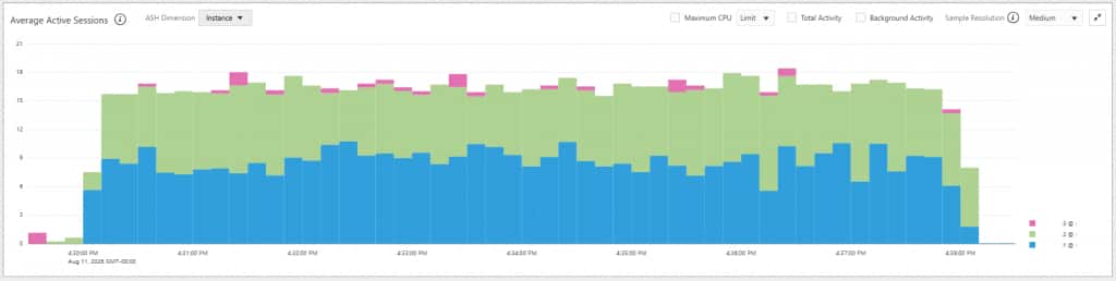

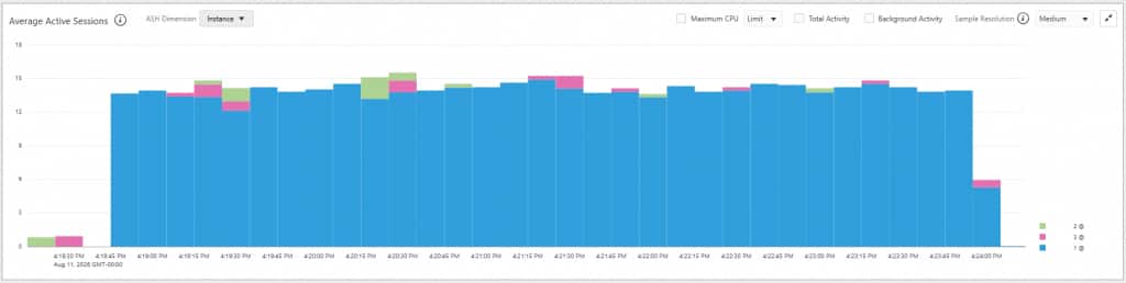

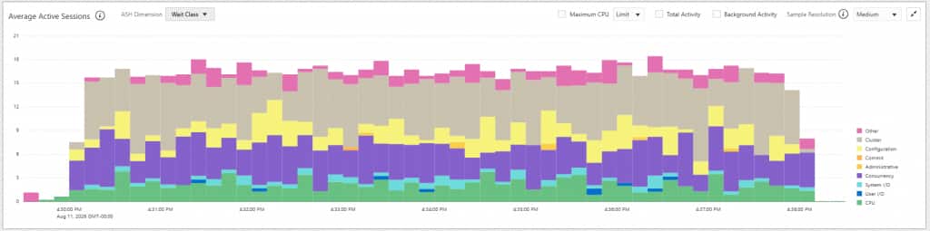

Figures 1 and 2 show the workload when the service is running on a single instance before the service failover.
Figure 1 – OEM Average Active Sessions (Single Instance)
Figure 2 – OEM Wait Events (Single Instance)

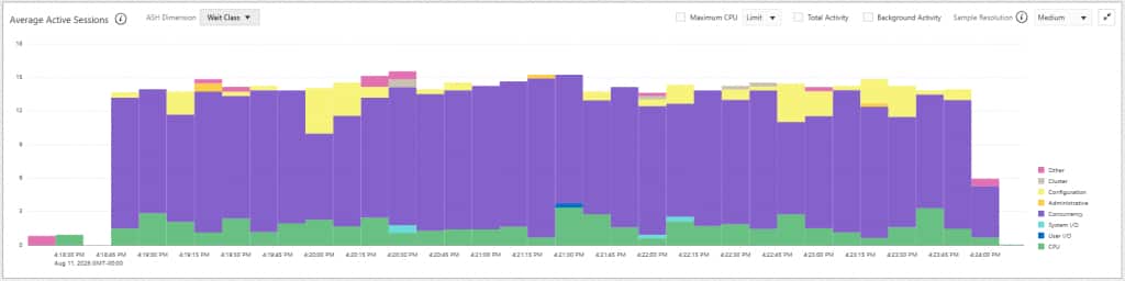

Figures 3 and 4 show the same workload after the service becomes active on two RAC instances.
Figure 3 – OEM Average Active Sessions (Multi Instance)
Figure 4 – OEM Wait Events (Multi Instance)
With the workload confined to a single instance, most database time was associated with Concurrency and CPU. Once connections were distributed across RACDB1 and RACDB2, RAC-related waits became a more visible component of DB time. The SQL and workload were unchanged; what changed was where those sessions were executing.
