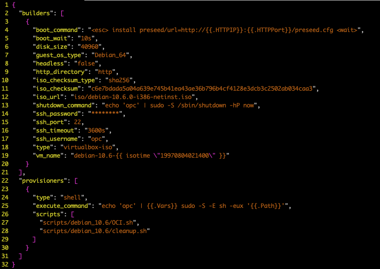

An in-depth description of Packer is outside the scope of this blog post. For this tutorial, a Packer configuration file, also called a template, is a JSON object with a set of keys configuring various components of Packer. Our Packer file has two main components:
A screenshot of the example Packer file running in the terminal.
  • Builders: The builders section contains all the code responsible for creating, installing, and configuring the OS in VirtualBox. Builders contain information like the disk size, memory, and shape of the virtual machine (VM). In our case, the builders section also contains a link to the Linux ISO distribution media and a pointer to a preconfiguration file for automating the OS installation.
  • Provisioners: The provisioners section contains a list of provisioners that Packer uses to perform any other OS configuration and install any additional software. Packer has many provisioner types. In this example, we use the ‘shell’ type, which enables us to run a series of scripts. The OCI.sh script performs the necessary configuration to make the image compatible within OCI, namely, adding kernel boot parameters and renaming the VNIC. The cleanup.sh performs some basic actions related to cleaning up the image and reducing its size for upload.

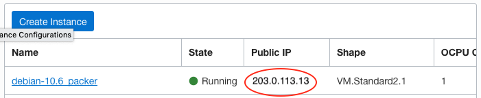

Now begins the part when you start testing in OCI. Log in to the tenancy where the instance was launched, and get its public IP address. You can now SSH into the instance using the public IP and the username and password specified in the preseed file.
A screenshot of the Packer file running in Oracle Cloud Infrastructure.
