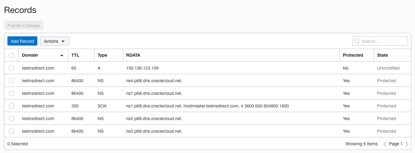

My zone contains six records: the 5 default records and an A record that I added on the top-level domain pointing to one of my webservers.
A screenshot that shows the six records in the zone.
Figure 2: Scenario 1 records

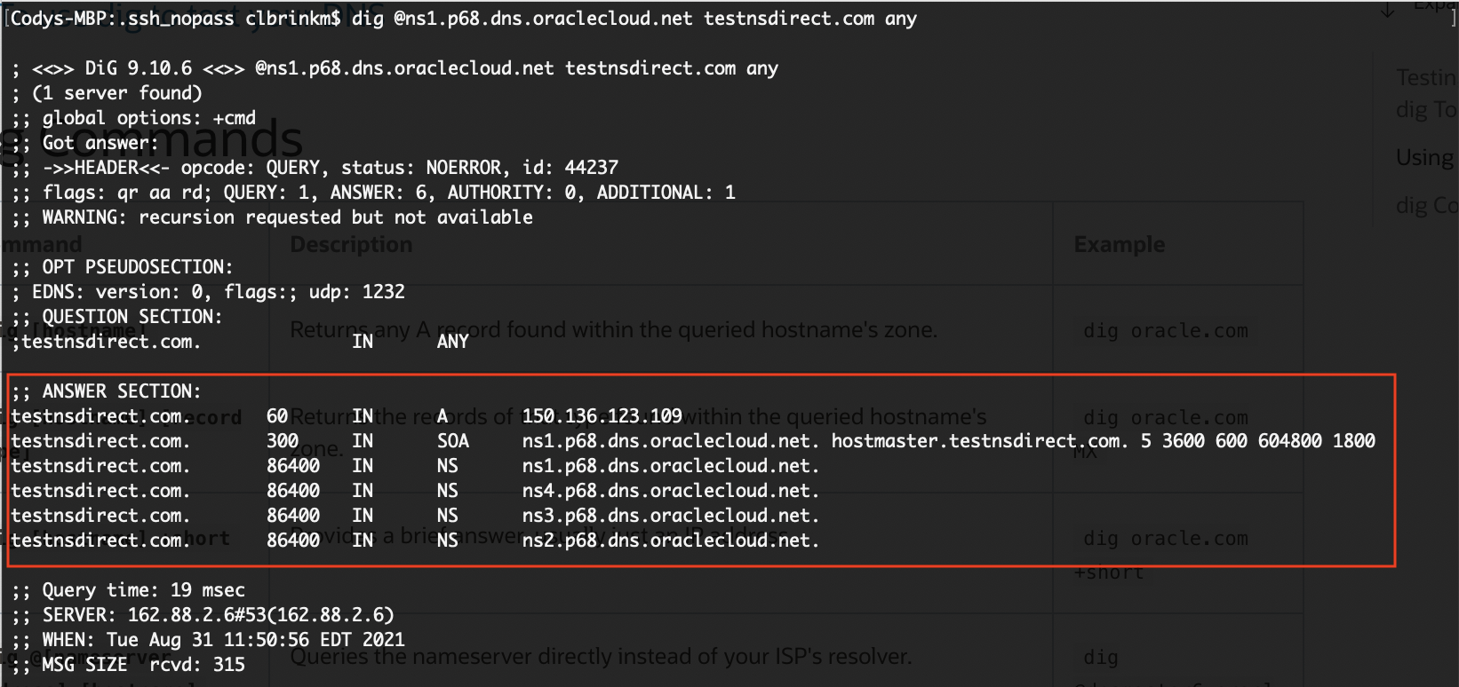

Again, my zone is not live on the internet. If you navigate to testnsdirect.com, no site exists (at least at the time this post was published). So how can I ensure that the nameservers are serving those records? Thankfully, dig gives us a way to query a nameserver directly instead of our ISP’s resolver. That’s the trick for testing your zones before delegation.
The command has the following form:
dig @[nameserver address] [hostname]
Remember those nameservers? Now’s the time to use one of them. I’ll use dig to return all the records on the zone, querying the OCI DNS nameserver directly. Here’s my command (yours might vary):
dig @ns1.p68.dns.oraclecloud.net testnsdirect.com any
As the following results show, the records match what I set up in the Oracle Cloud Console.
A screenshot of the command line that shows the records in the zone.
Figure 3: Scenario 1 result
Now I can be confident that the nameserver serves the correct records when I delegate the zone.

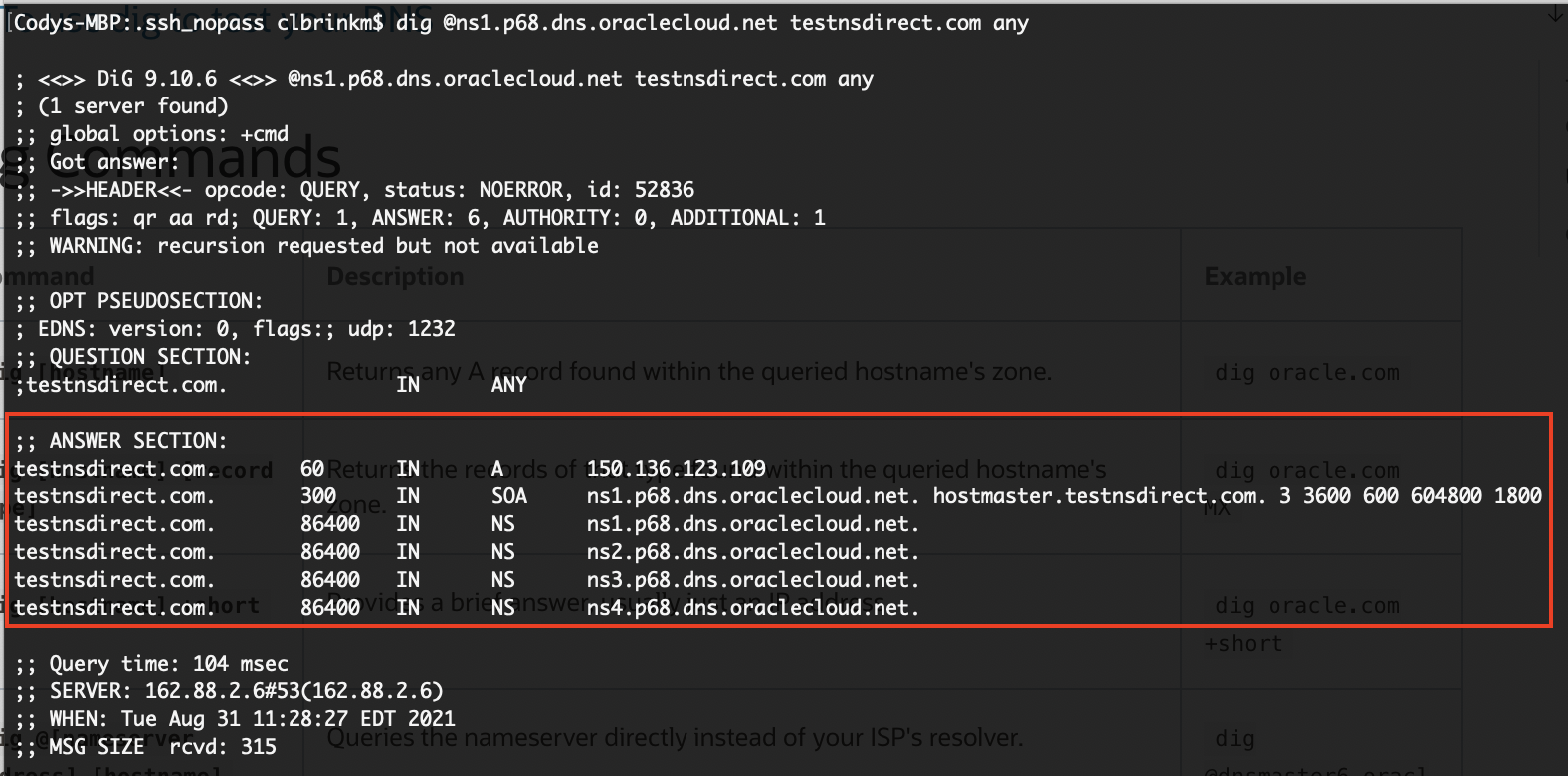

Let’s see how the nameserver responds, using the same command from scenario 1.
Figure 5: Scenario 2 Ashburn response

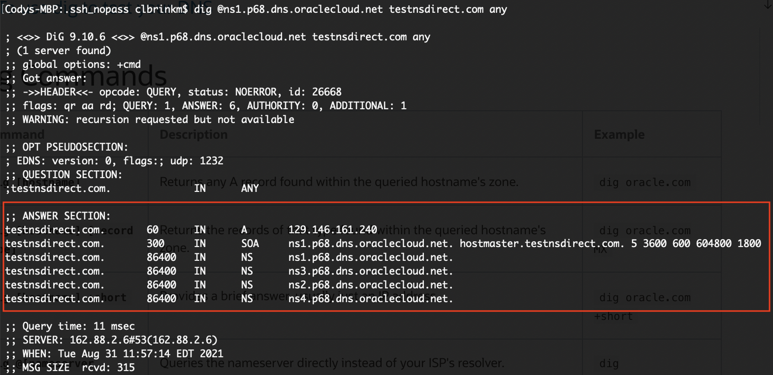

The nameserver is serving 150.136.123.109, the Ashburn webserver that I set up as the primary. This is what I expected. Now, if I shut off the Ashburn webserver, it should fail over to the Phoenix webserver and serve 129.146.161.240.
A screenshot of the command line that shows commands for stopping the Ashburn web server.
Figure 6: Stopping the Ashburn webserver
A screenshot of the command line that shows the nameserver now serving the Phoenix web server.
Figure 7: Scenario 2 Phoenix response
As expected, the nameserver is serving the Phoenix webserver (129.146.161.240). Now I can be confident that the active failover policy behaves correctly when I delegate the zone.

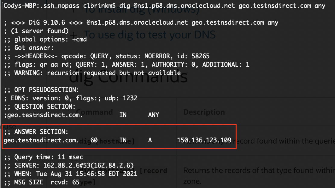

Let’s see what happens when I query it from each region. First, I’ll query the zone from my local machine, located in North America.
A screenshot of the command line that shows the nameserver pointing to the Ashburn web server.
Figure 9: Scenario 3 North America response

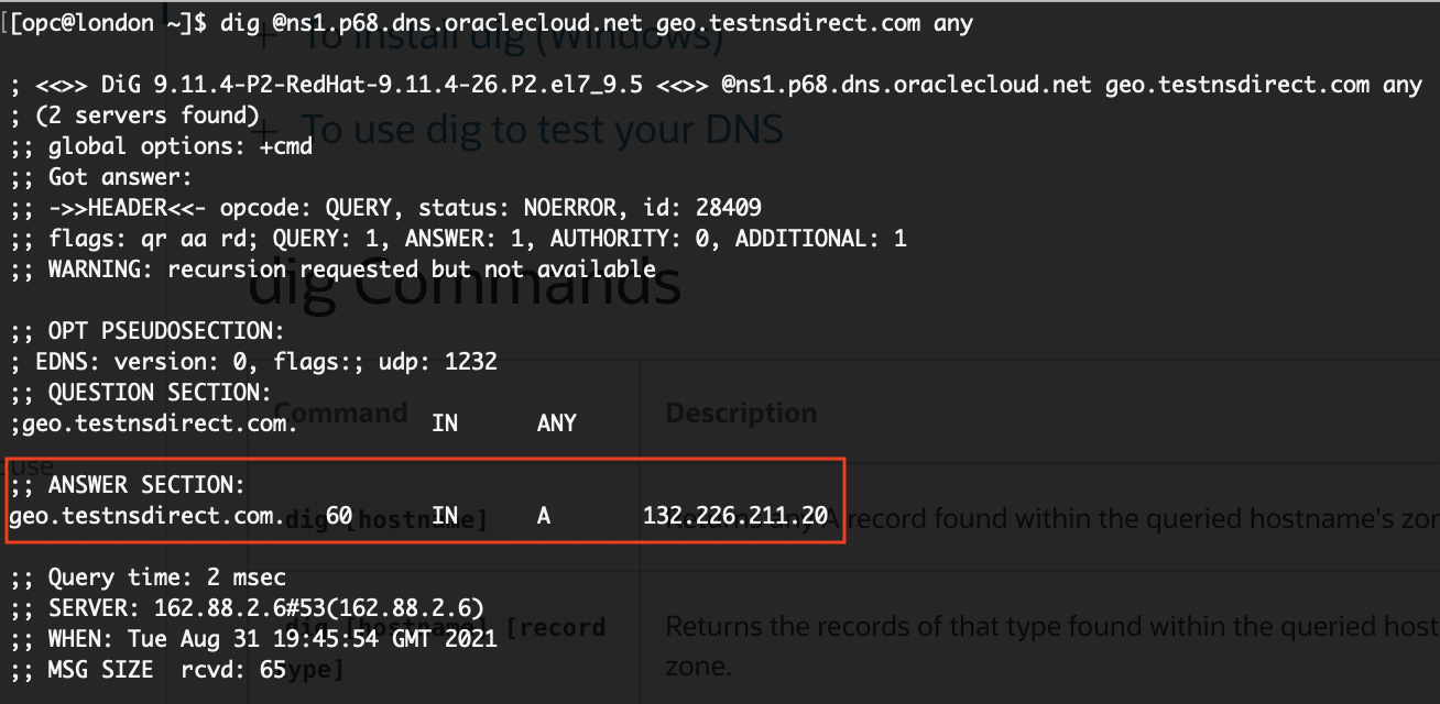

As expected, the nameserver is pointing to my Ashburn webserver. Let’s see what happens when I query the zone from an instance located in Europe.
A screenshot of the command line that shows the nameserver pointing to the London web server.
Figure 10: Scenario 3 Europe response
Viola! The response has changed to the webserver in London. Now I can be confident that the geolocation steering policy behaves correctly when I delegate the zone.
