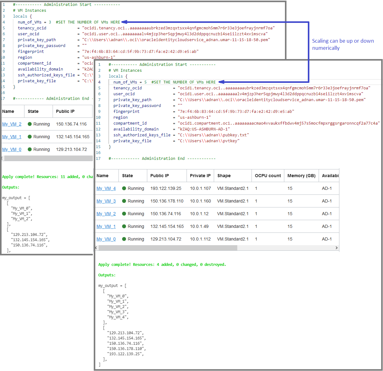

The traditional programmer might need a few online searches to get going with Terraform’s syntax. Because a well-written script is key to managing a cloud environment, this blog attempts to break the inertia by providing two short comprehensive scripts to jump-start a project in Oracle Cloud Infrastructure (OCI). Both scripts represent standard virtual machine (VM) images in OCI and run a set of commands using remote-exec.
The first script enables you to scale VM instances up and down by numeric value, and all VMs receive the same commands through remote-exec. The second script scales unique VMs with the ability to run different sets of commands based on VM’s display name.

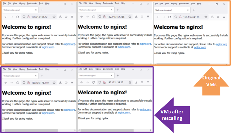

Script 1: Same VM, scaled with numeric index
Iterations with count
Using count, this script creates, scales up and down, and runs the same set of commands on each VM. The administrator only needs to change the numeric value of the count.
remote-exec
With touch and echo, the utility tee enables the remote-exec to run sudo commands while maintaining logs. The redirect fails for commands requiring sudo and using 'sudo tee' with pipe is a nice trick to resolve this permissions issue.

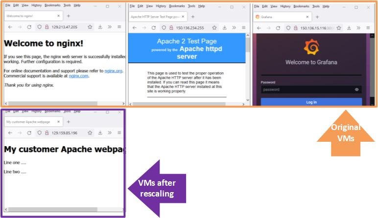

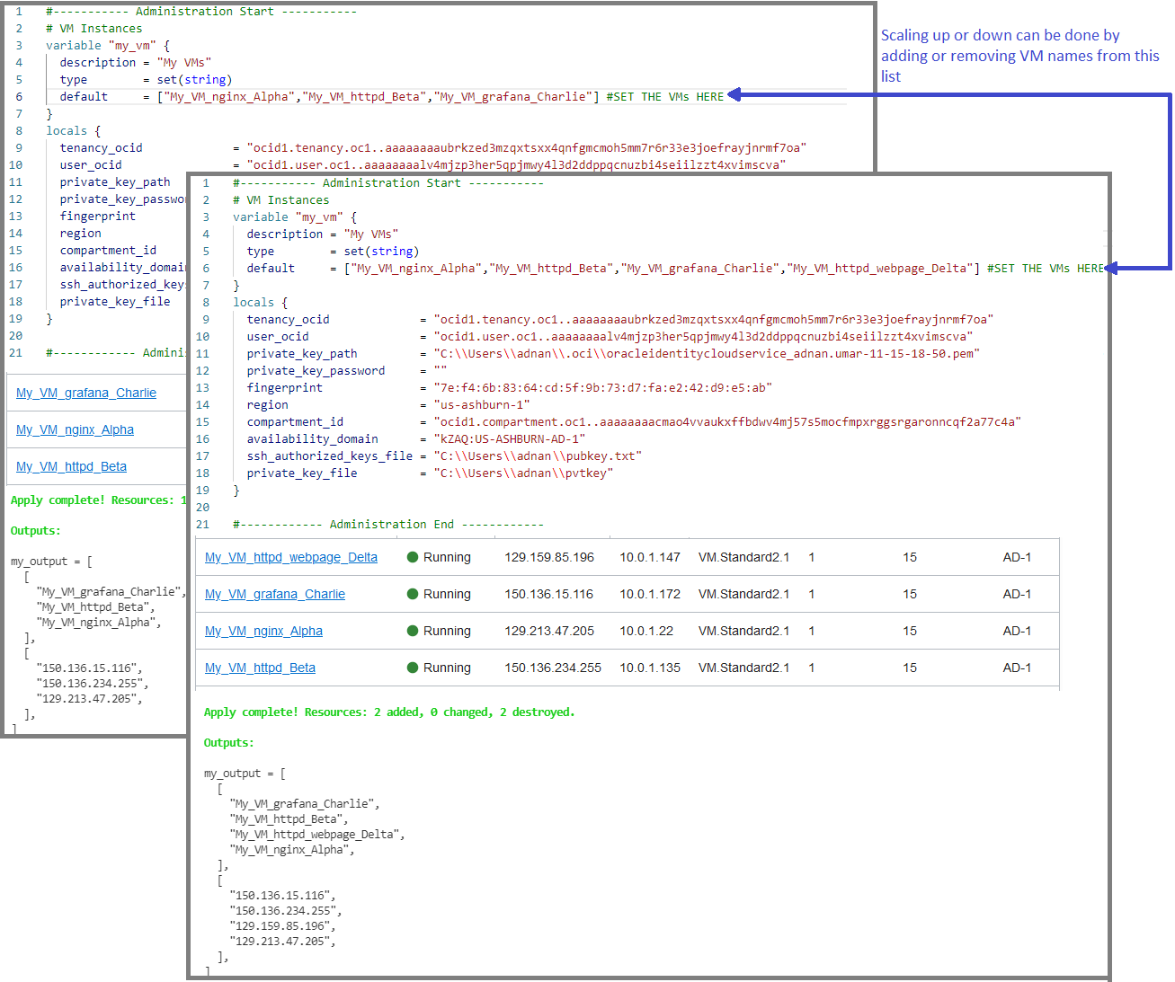

Script 2: Different VMs, scaled with display-name
Iteration with for-each
With for-each looping, this script matches the display-name with a set of commands. Only the commands in the specified set are run on the VM. Adding and removing VM names from the list scales up and down.

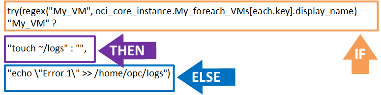

if-then-else
This script uses regex to match the display-name to filter for the command set to run in the VM. Since the regex returns an error instead of a false for a non-match, a try block helps with the else condition. This script shows one way that if-then-else can be implemented with RegEx.

try(regex("My_VM_httpd_webpage", oci_core_instance.My_foreach_VMs[each.key].display_name) == "My_VM_httpd_webpage" ? "sudo echo ' body {' | sudo tee -a /var/www/html/index.html" : "", "echo \"httpd not selected\" >> /home/opc/logs"),
try(regex("My_VM_httpd_webpage", oci_core_instance.My_foreach_VMs[each.key].display_name) == "My_VM_httpd_webpage" ? "sudo echo ' width: 35em;' | sudo tee -a /var/www/html/index.html" : "", "echo \"httpd not selected\" >> /home/opc/logs"),
try(regex("My_VM_httpd_webpage", oci_core_instance.My_foreach_VMs[each.key].display_name) == "My_VM_httpd_webpage" ? "sudo echo ' margin: 0 auto;' | sudo tee -a /var/www/html/index.html" : "", "echo \"httpd not selected\" >> /home/opc/logs"),
try(regex("My_VM_httpd_webpage", oci_core_instance.My_foreach_VMs[each.key].display_name) == "My_VM_httpd_webpage" ? "sudo echo ' font-family: Tahoma, Verdana, Arial, sans-serif;' | sudo tee -a /var/www/html/index.html" : "", "echo \"httpd not selected\" >> /home/opc/logs"),
try(regex("My_VM_httpd_webpage", oci_core_instance.My_foreach_VMs[each.key].display_name) == "My_VM_httpd_webpage" ? "sudo echo ' }' | sudo tee -a /var/www/html/index.html" : "", "echo \"httpd not selected\" >> /home/opc/logs"),
try(regex("My_VM_httpd_webpage", oci_core_instance.My_foreach_VMs[each.key].display_name) == "My_VM_httpd_webpage" ? "sudo echo '</style>' | sudo tee -a /var/www/html/index.html" : "", "echo \"httpd not selected\" >> /home/opc/logs"),
try(regex("My_VM_httpd_webpage", oci_core_instance.My_foreach_VMs[each.key].display_name) == "My_VM_httpd_webpage" ? "sudo echo '</head>' | sudo tee -a /var/www/html/index.html" : "", "echo \"httpd not selected\" >> /home/opc/logs"),
try(regex("My_VM_httpd_webpage", oci_core_instance.My_foreach_VMs[each.key].display_name) == "My_VM_httpd_webpage" ? "sudo echo '<body>' | sudo tee -a /var/www/html/index.html" : "", "echo \"httpd not selected\" >> /home/opc/logs"),
try(regex("My_VM_httpd_webpage", oci_core_instance.My_foreach_VMs[each.key].display_name) == "My_VM_httpd_webpage" ? "sudo echo '<h1>My customer Apache webpage</h1>' | sudo tee -a /var/www/html/index.html" : "", "echo \"httpd not selected\" >> /home/opc/logs"),
try(regex("My_VM_httpd_webpage", oci_core_instance.My_foreach_VMs[each.key].display_name) == "My_VM_httpd_webpage" ? "sudo echo '<p>Line one ....</p>' | sudo tee -a /var/www/html/index.html" : "", "echo \"httpd not selected\" >> /home/opc/logs"),
try(regex("My_VM_httpd_webpage", oci_core_instance.My_foreach_VMs[each.key].display_name) == "My_VM_httpd_webpage" ? "sudo echo ''| sudo tee -a /var/www/html/index.html" : "", "echo \"httpd not selected\" >> /home/opc/logs"),
try(regex("My_VM_httpd_webpage", oci_core_instance.My_foreach_VMs[each.key].display_name) == "My_VM_httpd_webpage" ? "sudo echo '<p>Line two ....</p>' | sudo tee -a /var/www/html/index.html" : "", "echo \"httpd not selected\" >> /home/opc/logs"),
try(regex("My_VM_httpd_webpage", oci_core_instance.My_foreach_VMs[each.key].display_name) == "My_VM_httpd_webpage" ? "sudo echo '</body>' | sudo tee -a /var/www/html/index.html" : "", "echo \"httpd not selected\" >> /home/opc/logs"),
try(regex("My_VM_httpd_webpage", oci_core_instance.My_foreach_VMs[each.key].display_name) == "My_VM_httpd_webpage" ? "sudo echo '</html>' | sudo tee -a /var/www/html/index.html" : "", "echo \"httpd not selected\" >> /home/opc/logs"),
try(regex("My_VM_nginx", oci_core_instance.My_foreach_VMs[each.key].display_name) == "My_VM_nginx" ? "sudo touch /etc/yum.repos.d/nginx.repo" : "", "echo \"nginx not selected ... 1\" >> /home/opc/logs"),
try(regex("My_VM_nginx", oci_core_instance.My_foreach_VMs[each.key].display_name) == "My_VM_nginx" ? "echo '[nginx]' | sudo tee -a /etc/yum.repos.d/nginx.repo" : "", "echo \"nginx not selected ... 2\" >> /home/opc/logs"),
try(regex("My_VM_nginx", oci_core_instance.My_foreach_VMs[each.key].display_name) == "My_VM_nginx" ? "echo 'name=nginx repo' | sudo tee -a /etc/yum.repos.d/nginx.repo" : "", "echo \"nginx not selected ... 3\" >> /home/opc/logs"),
try(regex("My_VM_nginx", oci_core_instance.My_foreach_VMs[each.key].display_name) == "My_VM_nginx" ? "echo 'baseurl=https://nginx.org/packages/centos/$releasever/$basearch/' | sudo tee -a /etc/yum.repos.d/nginx.repo" : "", "echo \"nginx not selected ... 4\" >> /home/opc/logs"),
try(regex("My_VM_nginx", oci_core_instance.My_foreach_VMs[each.key].display_name) == "My_VM_nginx" ? "echo 'gpgcheck=0' | sudo tee -a /etc/yum.repos.d/nginx.repo" : "", "echo \"nginx not selected ... 5\" >> /home/opc/logs"),
try(regex("My_VM_nginx", oci_core_instance.My_foreach_VMs[each.key].display_name) == "My_VM_nginx" ? "echo 'enabled=1' | sudo tee -a /etc/yum.repos.d/nginx.repo" : "", "echo \"nginx not selected ... 6\" >> /home/opc/logs"),
try(regex("My_VM_nginx", oci_core_instance.My_foreach_VMs[each.key].display_name) == "My_VM_nginx" ? "sudo yum -y install nginx >> /home/opc/logs; sudo systemctl start nginx" : "", "echo \"nginx not selected ... 7\" >> /home/opc/logs"),
try(regex("My_VM_grafana", oci_core_instance.My_foreach_VMs[each.key].display_name) == "My_VM_grafana" ? "sudo firewall-cmd --zone=public --add-port=3000/tcp --permanent" : "", "echo \"Error G1\" >> /home/opc/logs"),
try(regex("My_VM_grafana", oci_core_instance.My_foreach_VMs[each.key].display_name) == "My_VM_grafana" ? "sudo firewall-cmd --reload >> /home/opc/logs" : "", "echo \"Error G2\" >> /home/opc/logs"),
try(regex("My_VM_grafana", oci_core_instance.My_foreach_VMs[each.key].display_name) == "My_VM_grafana" ? "sudo touch /etc/yum.repos.d/grafana.repo" : "", "echo \"grafana not selected ... 1\" >> /home/opc/logs"),
try(regex("My_VM_grafana", oci_core_instance.My_foreach_VMs[each.key].display_name) == "My_VM_grafana" ? "echo '[grafana]' | sudo tee -a /etc/yum.repos.d/grafana.repo" : "", "echo \"grafana not selected ... 2\" >> /home/opc/logs"),
try(regex("My_VM_grafana", oci_core_instance.My_foreach_VMs[each.key].display_name) == "My_VM_grafana" ? "echo 'name=grafana' | sudo tee -a /etc/yum.repos.d/grafana.repo" : "", "echo \"grafana not selected ... 3\" >> /home/opc/logs"),
try(regex("My_VM_grafana", oci_core_instance.My_foreach_VMs[each.key].display_name) == "My_VM_grafana" ? "echo 'baseurl=https://packages.grafana.com/oss/rpm' | sudo tee -a /etc/yum.repos.d/grafana.repo" : "", "echo \"grafana not selected ... 4\" >> /home/opc/logs"),
try(regex("My_VM_grafana", oci_core_instance.My_foreach_VMs[each.key].display_name) == "My_VM_grafana" ? "echo 'repo_gpgcheck=1' | sudo tee -a /etc/yum.repos.d/grafana.repo" : "", "echo \"grafana not selected ... 5\" >> /home/opc/logs"),
try(regex("My_VM_grafana", oci_core_instance.My_foreach_VMs[each.key].display_name) == "My_VM_grafana" ? "echo 'enabled=1' | sudo tee -a /etc/yum.repos.d/grafana.repo" : "", "echo \"grafana not selected ... 6\" >> /home/opc/logs"),
try(regex("My_VM_grafana", oci_core_instance.My_foreach_VMs[each.key].display_name) == "My_VM_grafana" ? "echo 'gpgcheck=1' | sudo tee -a /etc/yum.repos.d/grafana.repo" : "", "echo \"grafana not selected ... 7\" >> /home/opc/logs"),
try(regex("My_VM_grafana", oci_core_instance.My_foreach_VMs[each.key].display_name) == "My_VM_grafana" ? "echo 'gpgkey=https://packages.grafana.com/gpg.key' | sudo tee -a /etc/yum.repos.d/grafana.repo" : "", "echo \"grafana not selected ... 8\" >> /home/opc/logs"),
try(regex("My_VM_grafana", oci_core_instance.My_foreach_VMs[each.key].display_name) == "My_VM_grafana" ? "echo 'sslverify=1' | sudo tee -a /etc/yum.repos.d/grafana.repo" : "", "echo \"grafana not selected ... 9\" >> /home/opc/logs"),
try(regex("My_VM_grafana", oci_core_instance.My_foreach_VMs[each.key].display_name) == "My_VM_grafana" ? "echo 'sslcacert=/etc/pki/tls/certs/ca-bundle.crt' | sudo tee -a /etc/yum.repos.d/grafana.repo" : "", "echo \"grafana not selected ... 10\" >> /home/opc/logs"),
try(regex("My_VM_grafana", oci_core_instance.My_foreach_VMs[each.key].display_name) == "My_VM_grafana" ? "sudo yum -y install grafana >> /home/opc/logs; sudo systemctl start grafana-server.service" : "", "echo \"grafana not selected ... 11\" >> /home/opc/logs")
