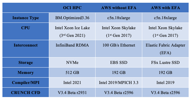

The following graphic shows the system specs of our benchmark setup and that of AWS:
A chart showing the comparison between OCI HPC and AWS with and without EFA.
Both AWS systems used c5n.18xlarge, but AWS with EFA had Elastic Fabric Adapter (EFA) as the interconnect. EFA is a network device that enables applications to communicate directly with the network interface hardware. In comparison, the Oracle setup used InfiniBand RDMA, which provides low-latency networking (as low as 1.7 µs) and scalability over thousands of cores. These setups also have no added overhead on the network to limit throughput.

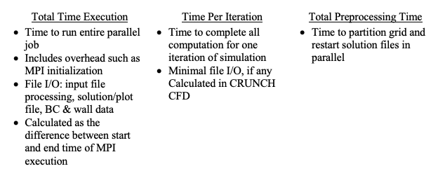

We used the 9-Species Hydrogen-Oxygen Petersen & Hansen Reaction Mechanism with k-ε Turbulence Model in three different cases: 5 Million cell, 15 Million cell, and 44 Million cell mesh size. The metrics taken were total execution time, time per iteration, and total time processing. The following graphic describes each metric:
A graphic depicting the total time execution, time per iteration, and total preprocessing time.

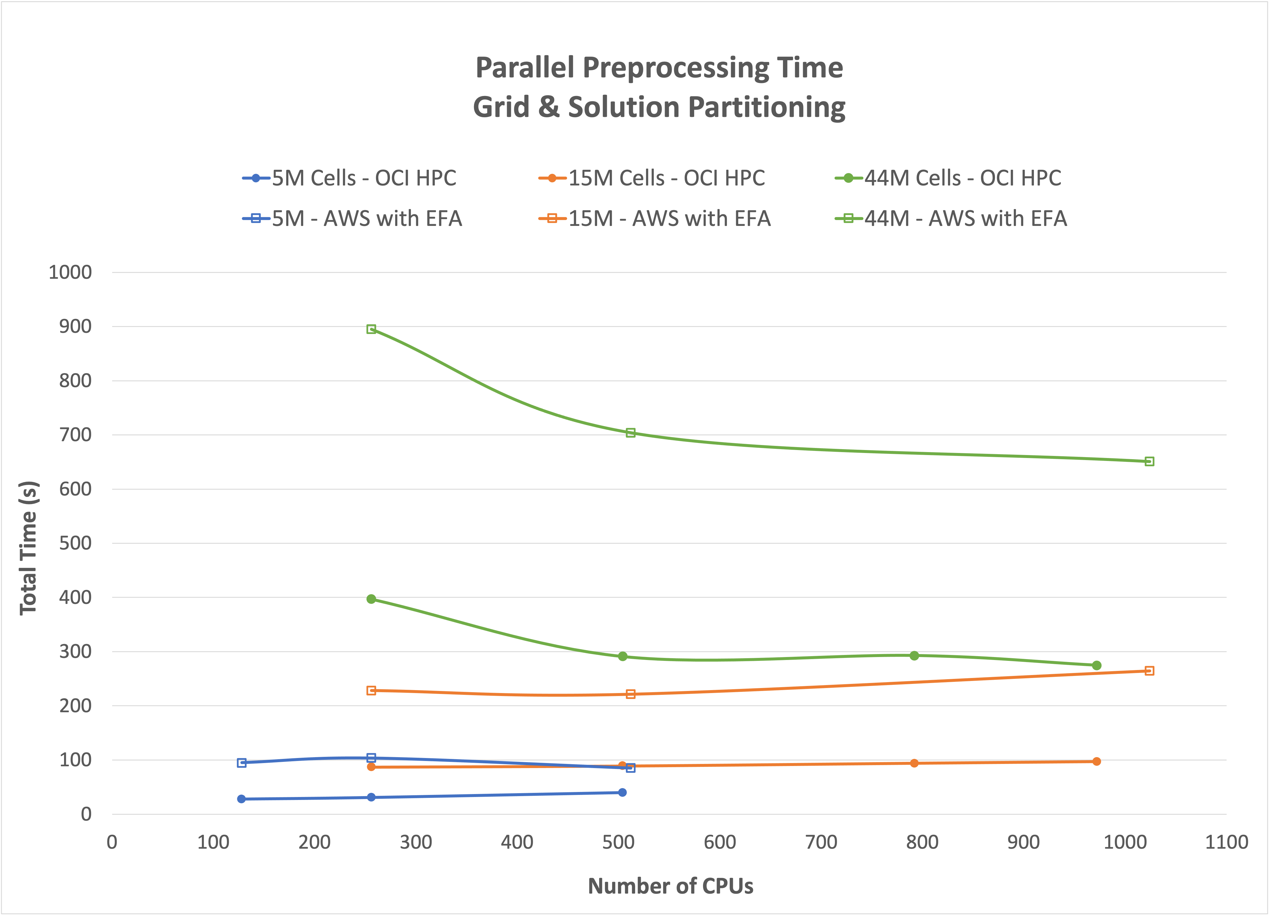

The following graph shows the comparison between BM.Optimized3.36 and c5n.18xlarge with EFA for total preprocessing time, where the lower time is better:
Figure 1: Parallel preprocessing time: Grid and solution partitioning comparison between OCI HPC and AWS with EFA. OCI HPC is up to 70% faster than AWS with EFA.

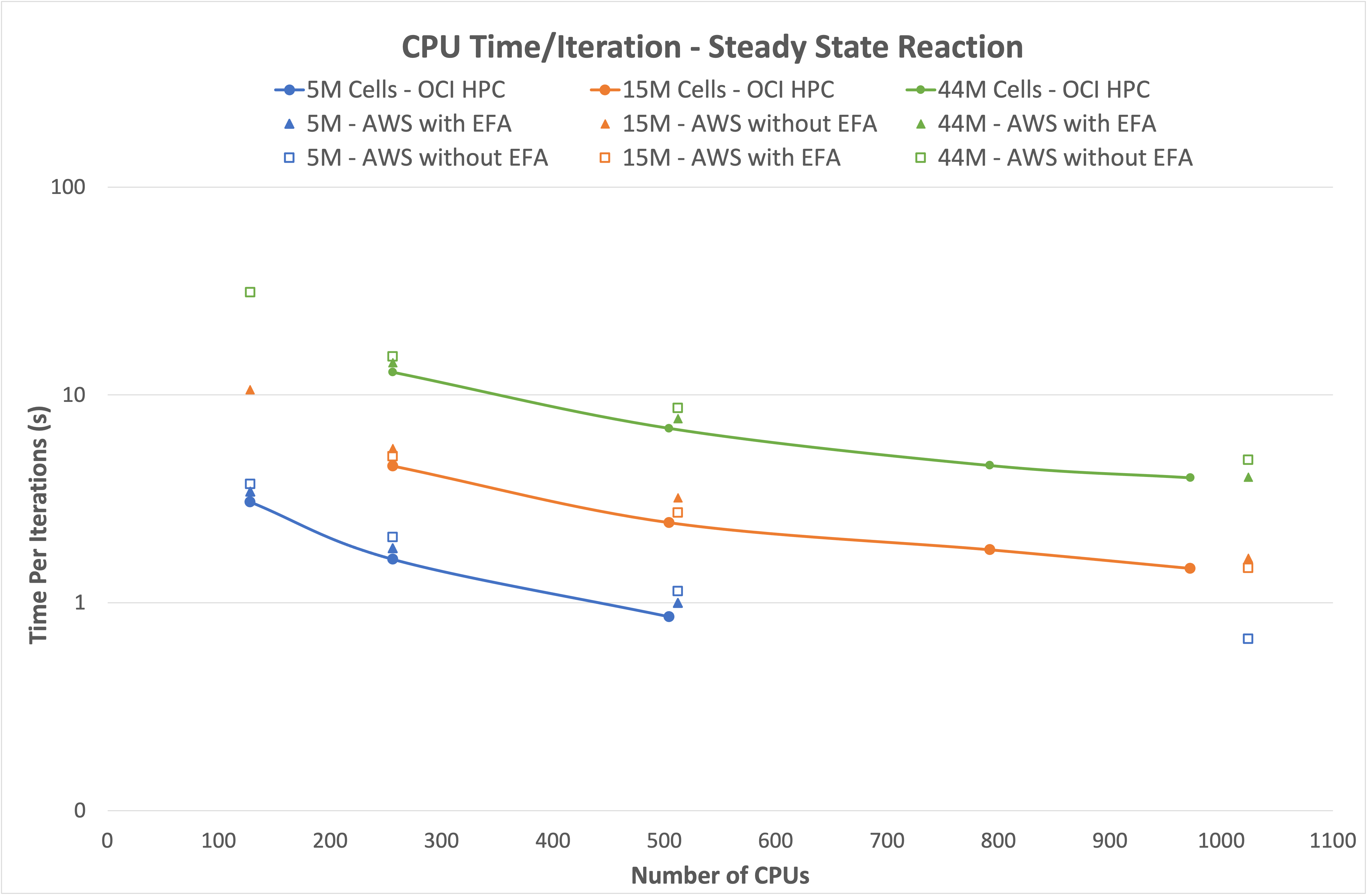

The following graph shows the comparison between BM.Optimized3.36, c5n.18xlarge with 100 GB/s Ethernet, and c5n.18xlarge with EFA for time per iteration, where the lower time is better:
Figure 2: The CPU time per iteration in the steady state reaction between OCI HPC, AWS with EFA, and AWS without EFA. OCI HPC is 18% faster than AWS without EFA and 10% faster than AWS with EFA.

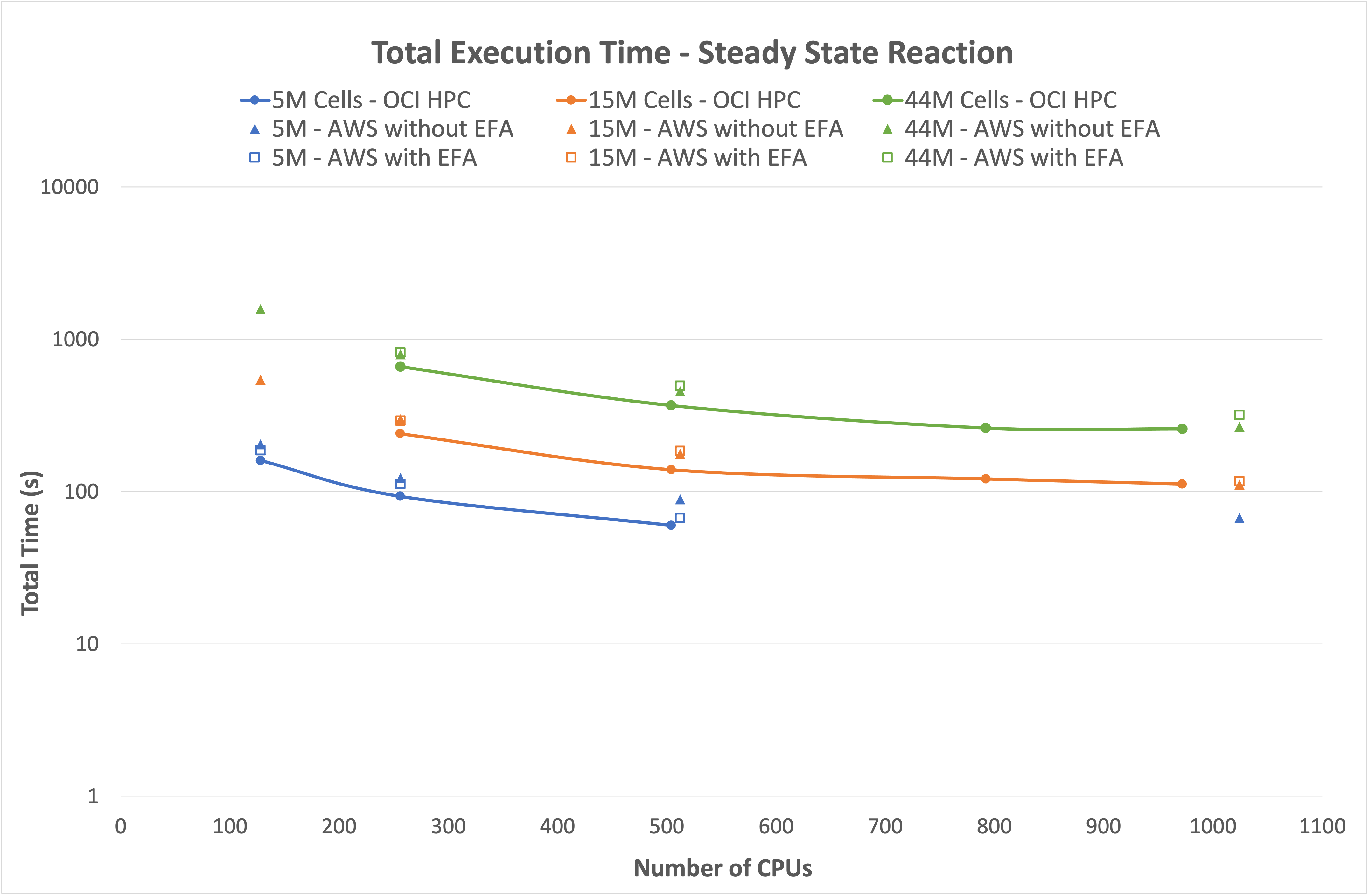

Figure 3: The total time of the steady state reaction between OCI HPC, AWS with EFA, and AWS without EFA. OCI HPC is 22% faster than AWS without EFA and 20% faster than AWS with EFA.
