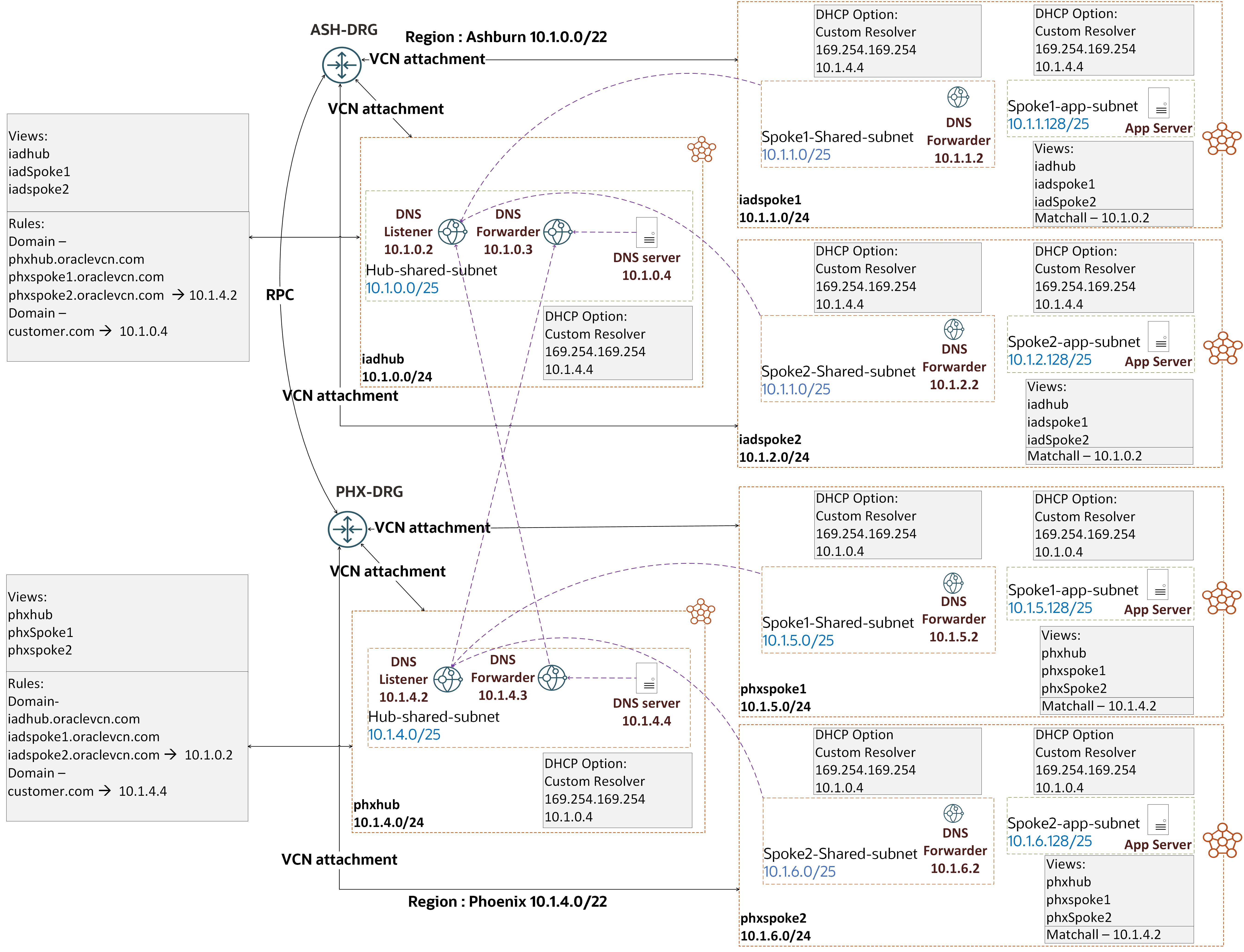

Current DNS state architecture
In the hybrid architecture, the spoke VCNs resolve queries within OCI in the same region locally, and the rest of the queries for the other region domains and the custom domain are forwarded to the listener in the hub. The forwarding rule in the hub forwards the queries to the name servers, and the name resolves.

Proposed architecture
In the proposed architecture, we’re modifying the DHCP options in the VCN and the hybrid DNS configuration. With this modification, the OS is aware of the alternative DNS server it can reach when the primary server has a problem. So, the name resolution continues to work, and you can avoid the complete DNS outage.
Configure custom DHCP options for the VCN with OCI DNS IP address, 169.254.269.254, as the primary server, and the customer’s DNS server as the second DNS server.
In this solution, the Phoenix DNS server 10.1.4.4 is used as the secondary DNS in the Ashburn VCN and Ashburn DNS server 10.1.0.4 as secondary DNS for the Phoenix VCN.
The VCN resolver still manages the name resolution within OCI regions, and only the custom domain or other region domains are forwarded to their respective servers.
If the custom DNS server fails or OCI loses the connectivity to the primary server, the secondary server in the list resolves the custom and other regional DNS zones.
The customer DNS servers are deployed in OCI to decrease the latency and dependency to the on-premises connectivity. This part isn’t mandatory unless the situation demands it.
The custom DNS server needs a conditional forwarding rule to oraclevcn.com to the DNS listener IP in the regional hub VCN. In this scenario, the custom DNS server has the forwarding rule to 10.1.0.2 and 10.1.4.2. This step is handy when the client forwards the request to any available DNS server in the list bypassing the order.
