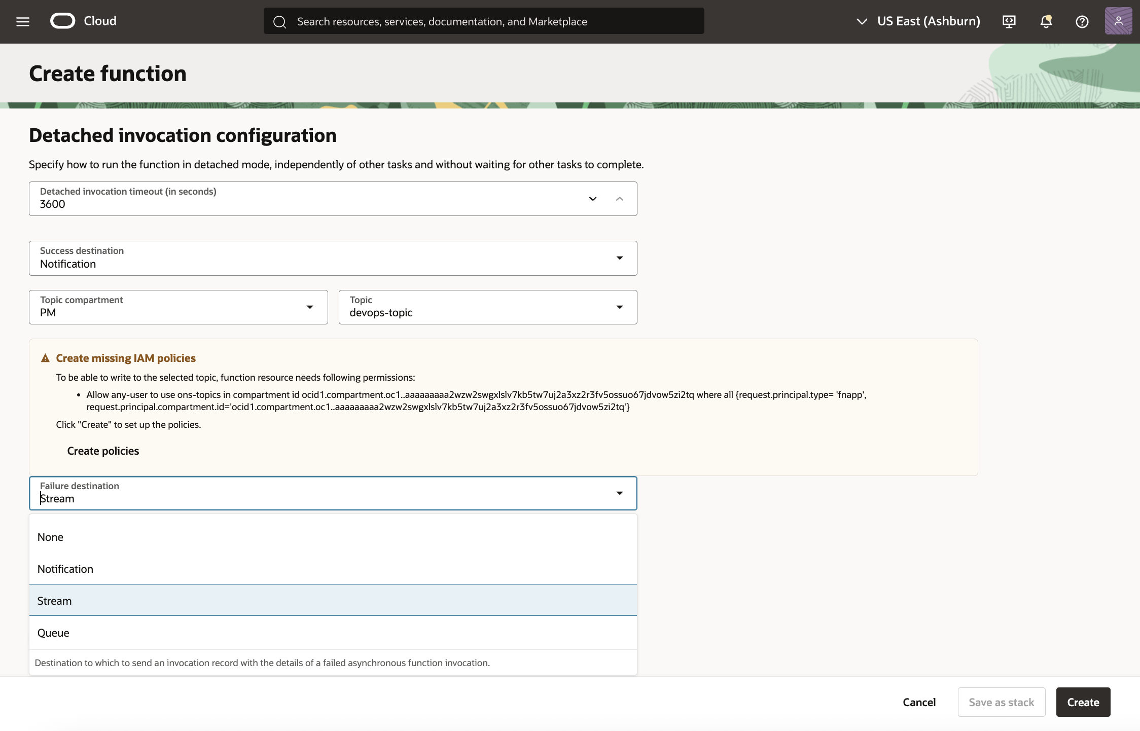

Getting Started: Configure Success/Failure Response Destination
You can also configure destinations that automatically receive the status of a function once it finishes. Be sure your Functions application has the required IAM policies to write results to your chosen Notification, Queue, or Streaming destinations. Without these permissions, destinations won’t receive status updates. See Creating IAM Policies for Detached Invocation Success and Failure Destinations for policy examples and more details.
Console Example
  1. Open the Functions service in the OCI Console.
  2. Select your application and click Create Function (or edit an existing one)
  3. Select Success destination or Failure destination field to view supported destinations
  4. Choose from supported services such as Streaming, Queue, or Notification as destination
Console Configure Response Destination
