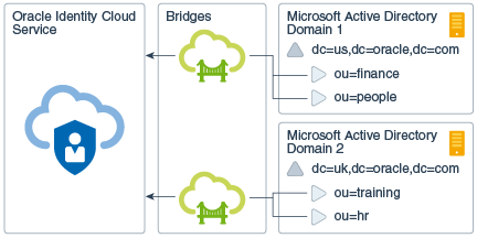

Use Case 3: Hierarchical Active Directory structure
If you have a hierarchical Active Directory structure with a root AD domain and child domains, and you have configured an AD bridge in the root domain, it may not work as expected if you’re hoping to retrieve users and groups from the child domains. To synchronize those users, you must configure an AD bridge separately for each child domain.
A graphic depicting the architecture for  a deployment with a root domain and separate child domains.

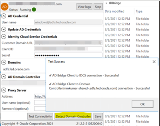

Use case 4: Configure high availability for AD bridge
The primary objective is to enable high availability for the AD bridge configuration in the production environment. You must set up an AD bridge on two distinct Windows machines and submit a service request with Oracle support to activate the high availability feature. Even with high availability enabled, you don’t have automatic domain discovery to connect to the other node if one domain controller becomes unreachable. In such cases, you can initiate manual discovery by utilizing the Detect Domain Controller button in the AD bridge connector agent.
A screenshot of the AD bridge connector agent screen showing the Test Success window with the Detect Domain Controller button highlighted.
