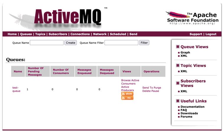

For high availability of the platform… That’s it! If the ActiveMQ pod goes down, it’s automatically rescheduled and the new pod acquires the lock in the database, all in just a few seconds. We can test this out. Log in to the web UI at <loadbalancer ip>:8161/admin/ and log in with the default admin/admin. Create a test queue and use ‘send to’ to publish a test message to the queue. Then simulate failover.
$ kubectl get pods -n active-mq
NAME READY STATUS RESTARTS AGE
active-mq-64bd4bb5d9-djcgn 1/1 Running 0 8m
$ kubectl delete pod active-mq-64bd4bb5d9-djcgn -n active-mq
pod "active-mq-64bd4bb5d9-djcgn" deleted
active-mq-64bd4bb5d9-8p4p2 1/1 Running 0 5s
Refresh your browser open to the AMQ web UI. Your test message is still there!
