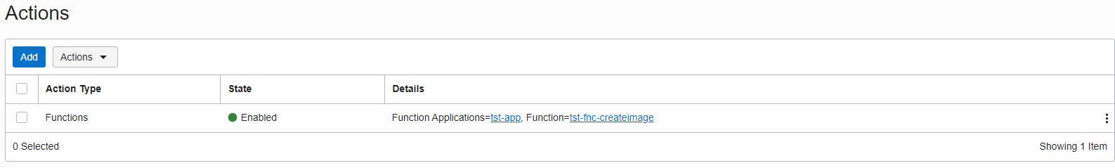

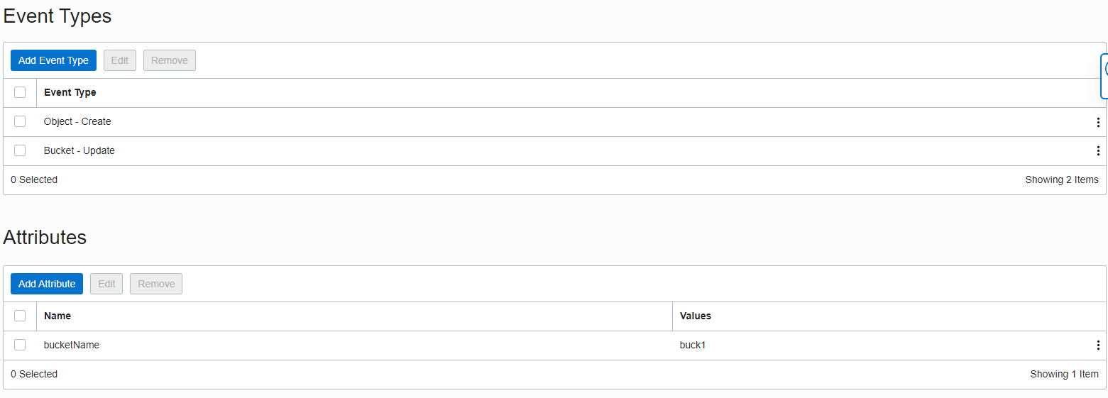

Whenever you upload a VMDK into a designated bucket, an Events rule triggers a function that creates a custom image from that object.
A screenshot of the Event Types section in the Oracle Cloud Console.
A screenshot of the Actions section for creating the first event rule.

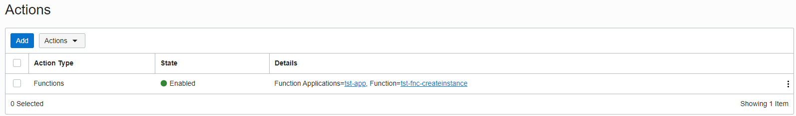

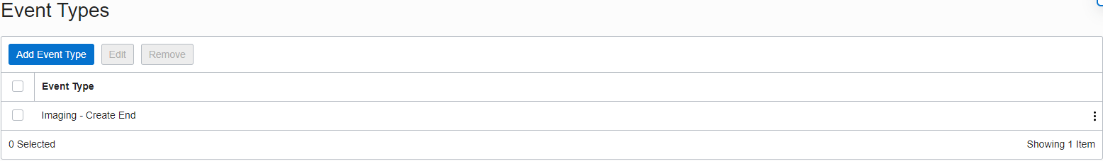

Then, another event rule triggers when the Custom Image is created. This event triggers another function to create a Compute instance based on that custom image.
A screenshot of the Event Types section for the second event rule.
A screenshot of the Actions section with selections made for the second event rule.

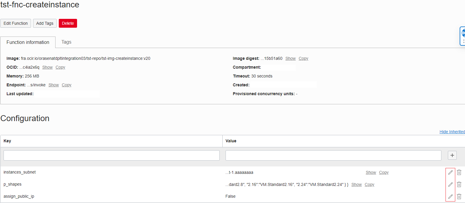

The shape for the Compute instance is taken from the configuration of the function that creates the instance. If the object’s name ends with “_2.2,” the shape uses VM.Standard2.2. The underscore is important, so ensure that you add it.
A screenshot of the details of the configuration for the created instance function.
You can change the configuration of the function from the Console by clicking the Edit button marked with red. You can change either the subnet in which the instances are created, regardless of if the instances have public_ip, and edit the corresponding shape for each key in the shapes map. For example, “2.1” has the corresponding shape VM.Standard2.1.

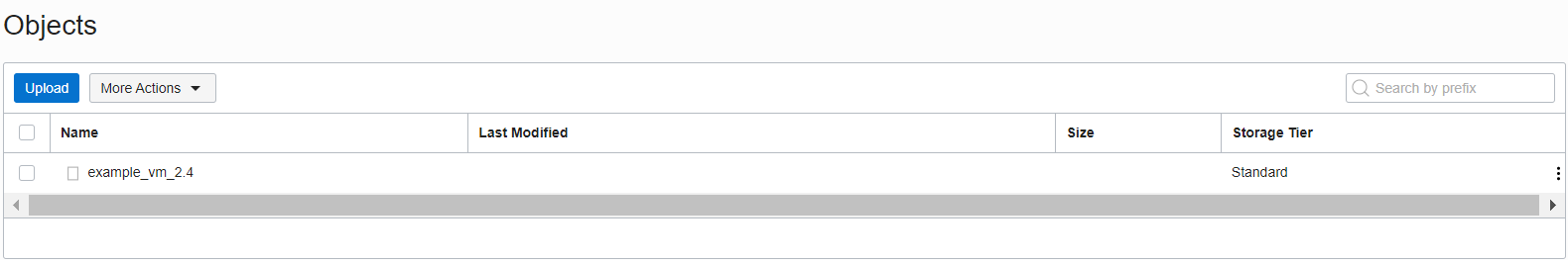

If you want to manually upload VMDKs in the designated bucket, you need to manually set the name of these files when you upload them. So if you have a VMDK file example_vm.VMDK and are using the default configuration, you want the VM.Standard2.4. When uploading the VMDK, name the object example_vm_2.4 to trigger the correct automation.
A screenshot of the Objects section showing the uploaded vmdk name in the bucket.
