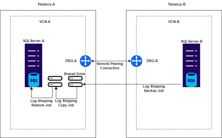

In this scenario, we’re working with two OCI tenancies and VCNs. So, we need to configure VCN peering so that the two SQL servers in two different OCI tenancies can talk to each other. The configuration of log shipping between SQL servers in the same OCI tenancy and VCN is simpler and doesn’t need VCN peering.
Our architecture uses the following the components:
OCI tenancy A:
  • VCN-A
  • DRG-A
  • SQLServer-A
OCI tenancy B:
  • VCN-B
  • DRG-B
  • SQLServer-B
A graphic depicting the architecture for Microsoft SQL Server log shipping between two tenancies on OCI.

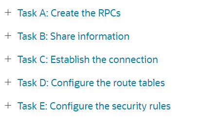

When configuring VCN peering between two tenancies, we must ensure that appropriate Identity and Access Management (IAM) permissions are applied to the VCNs in the different tenancies. We must also configure a DRG in both tenancies and attach the VCNs to these DRGs. When you have created the DRGs using the steps provided in the article, follow the steps in Peering VCNs in different regions through a DRG.
A screenshot of the tasks to follow to configure the DRGs in the tenancies and attach the VCNs.
Before task C, we must configure the IAM policies. In Tenancy A, you need a group (requestor-group) that has permissions to manage DRGs and VCNs in the tenancy. Tenancy A acts as the requestor and tenancy B acts as the acceptor. Run the following IAM policies through the requestor:

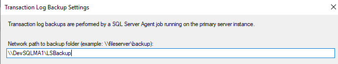

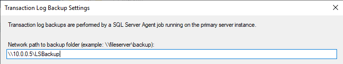

In step 5, provide the UNC path of the shared directory that you created. SQL Server and SQL Agent Service accounts from both the tenancies need read/write permissions in this directory.
A screenshot of the Transaction Log Backup Settings window showing the network path to backup folder.
A screenshot of the Transaction Log Backup Settings window showing an alternative network path to backup folder.

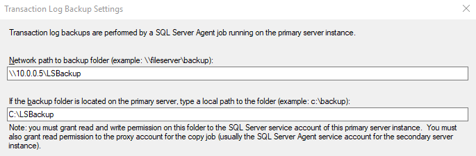

If you’re using a network path to the backup folder, you don’t need to follow step 6. If you want to use a local path for backup, provide the local path of the backup folder.
A screenshot of the Transaction Log Backup Settings window showing the local path to the backup folder.
