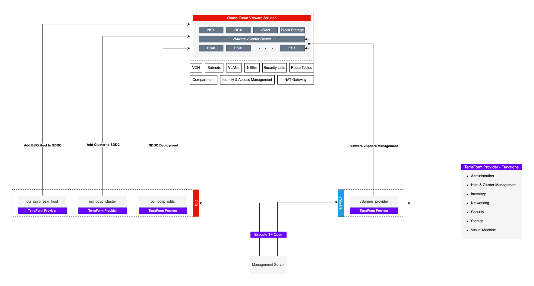

Performing different functions, the following Terraform providers are required to deploy and manage Oracle Cloud VMware Solution:
The Terraform provider for Oracle Cloud VMware Solution provides the capabilities to create, update, and destroy an SDDC, ESXi hosts and clusters, while the Terraform provider for VMware vSphere can be used to manage many aspects of a vSphere environment, including VMs, standard and distributed switches, datastores, content libraries, and more.
The architecture diagram for the solution deployment
The solution also uses the following Terraform providers for VMware NSX and Vmware HCX management:
In this blog post, we focus on the Terraform providers for Oracle Cloud VMware Solution and VMware vSphere to provide a brief overview on how to deploy and manage Oracle Cloud VMware Solution through Terraform.
