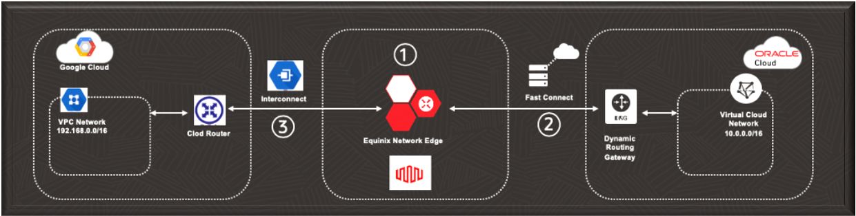

This post describes how to use Equinix Network Edge to enable multi cloud connectivity between Oracle Cloud Infrastructure (OCI) virtual cloud networks (VCNs) and Google Cloud Platform (GCP) Virtual Private Cloud (VPC) without deploying physical infrastructure (as shown in the following diagram).
The following high-level steps are required to create this connection:
1. Create an account with Equinix.
2. Create an OCI Fast Connect connection and add the connection to the Network Edge Device.
3. Add a GCP VPC connection, by using VLAN Attachment, to Equinix Network Edge Device to enable routing between the virtual networks.

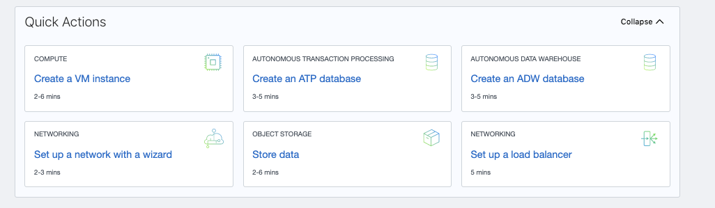

3. In the Quick Actions section of the home page, click Set up a network with a wizard.

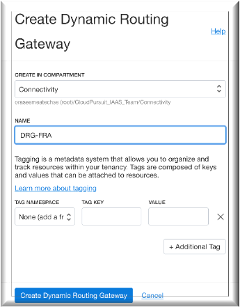

2. Click Create Dynamic Routing Gateway.
3. In the Create Dynamic Routing Gateway dialog box, select the compartment where you want the DRG to reside, and give the DRG a name (in this example, DRG-FRA).
4. Click Create Dynamic Routing Gateway.

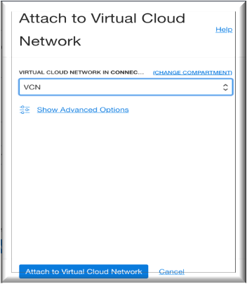

7. Click Attach to Virtual Cloud Network.
8. In the Attach to Virtual Cloud Network dialog box, select the same compartment where your VCN resides, and then select the VCN (in this example, VCN-FRA). You can ignore the Associate with Route Table settings.
9. Click Attach.
Your VCN is now attached to the DRG.

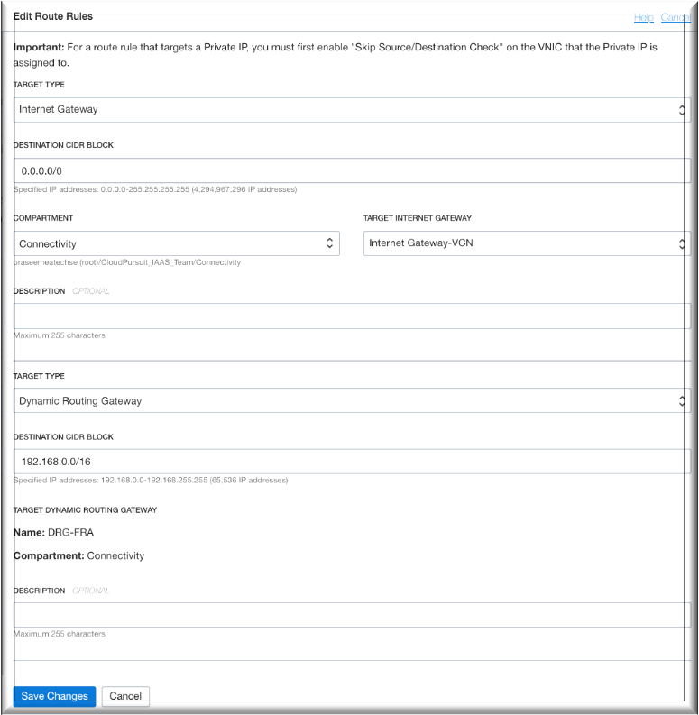

Add a Rule to the Route Table
The next step is to add a rule to the DRG on your route table. A VCN uses virtual route tables to send traffic out of the VCN.
1. Go back to the Networking section and select your VCN (in this example, VCN).
2. Under Resources, click Route Tables.
3. Click Default Route Table for VCN.
4. Click Edit Route Rules.
5. Click +Another Route Rule.
6. In the expanded dialog box, provide the following information:
• For Target Type, select Dynamic Routing Gateway.
• For Compartment, select the same one that you’ve been using throughout this exercise (in this example, Megaport).
• For Destination CIDR Block, enter the GCP network CIDR block. This example uses 192.168.0.0/16.
• For Target Dynamic Routing Gateway, select the DRG that you just created (in this example, DRG-FRA).
7. Click Save

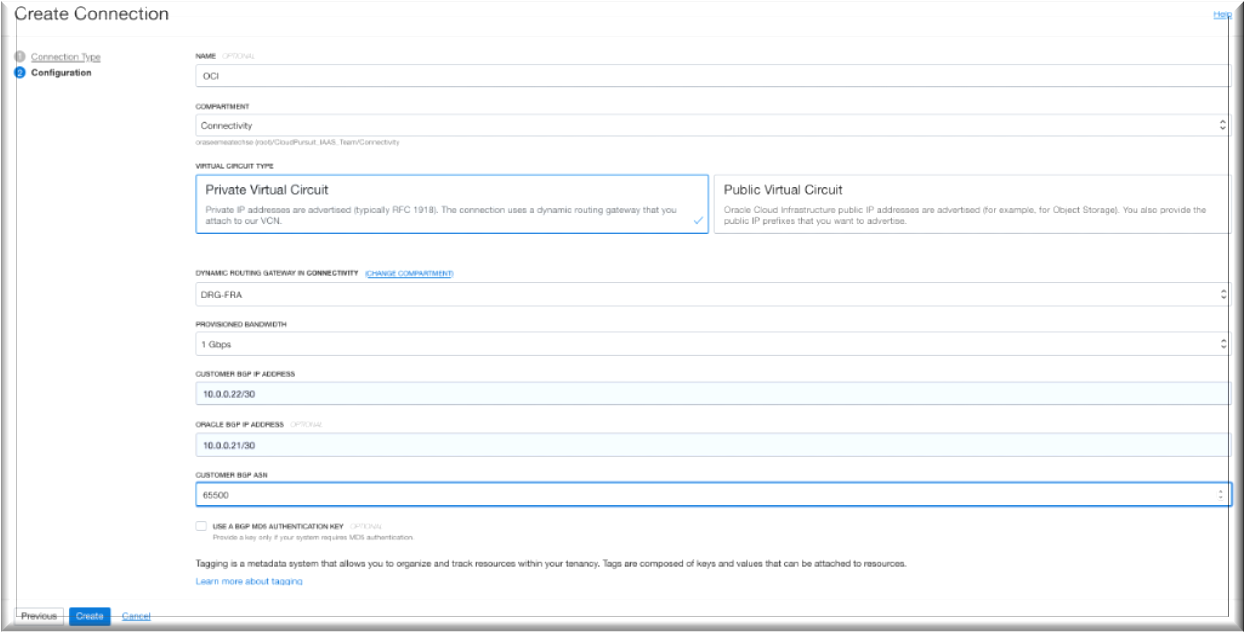

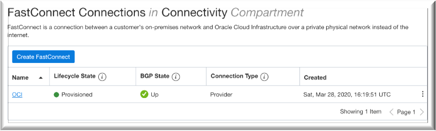

Create a FastConnect Circuit
The final step on OCI is to configure the FastConnect circuit that the DRG will use to reach the GCP VPC. For these steps, you need to know the BGP IP addresses and the Private Autonomous System Number (ASN) you would like to assign to the Network Edge Device, in this example 65500 .
Go back to the Networking section.
1. Under Networking, click FastConnect.

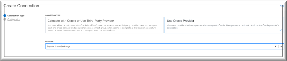

2. Click Create Connection.
3. In the Create Connection dialog box, select Connect Through a Provider, and then select Equinix Cloud Exchange.
  4. Click Continue.
  5. In the new Create Connection dialog box, provide the following information. The values provided here are specific to this example.
Name: Give the connection a name (in this example, OCI).
Compartment: Select the same compartment that you’ve been using throughout this exercise (in this example, Connectivity).
Virtual Circuit Type: Private Virtual Circuit
Dynamic Routing Gateway Compartment: Connectivity
Dynamic Routing Gateway: DRG-FRA
Provisioned Bandwidth: 1 Gbps
Customer BGP IP Address: 10.0.0.22/30
Oracle BGP IP Address: 10.0.0.21/30
Customer BGP ASN: 65500 (Private ASN assigned to the Network Edge Device)
6. Click Continue.

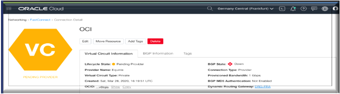

The connection is created from OCI.
7. On the details page for the connection, copy the OCID. You need it to provision the virtual connection from Equinix Network Edge in the next section.

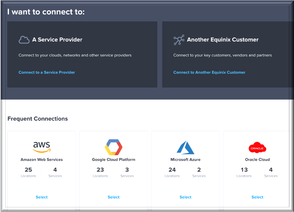

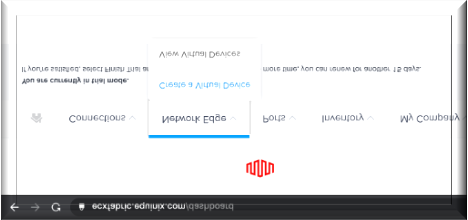

1. Log in to the Equinix Cloud Exchange Portal

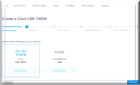

2. Create a Network Edge Virtual Device.
3. Select a Vendor Package for your Device (in this example Cisco CSR 1000V) and then click Continue.

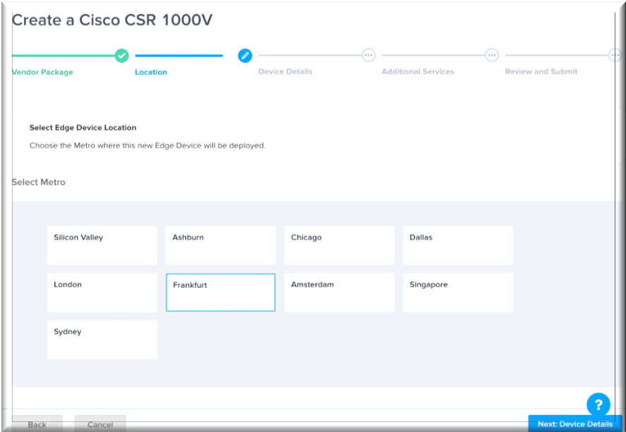

4. Select the Metro where this new Edge Device will be deployed (in this example Frankfurt) and click Next

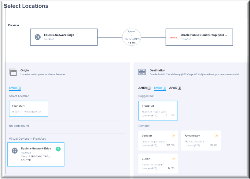

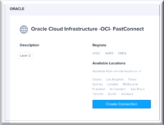

7. After the Virtual Device is available, add a connection to Oracle Cloud Infrastructure by clicking Oracle Cloud.
8. Select the Locations as indicated in the following figure, and then click Next:

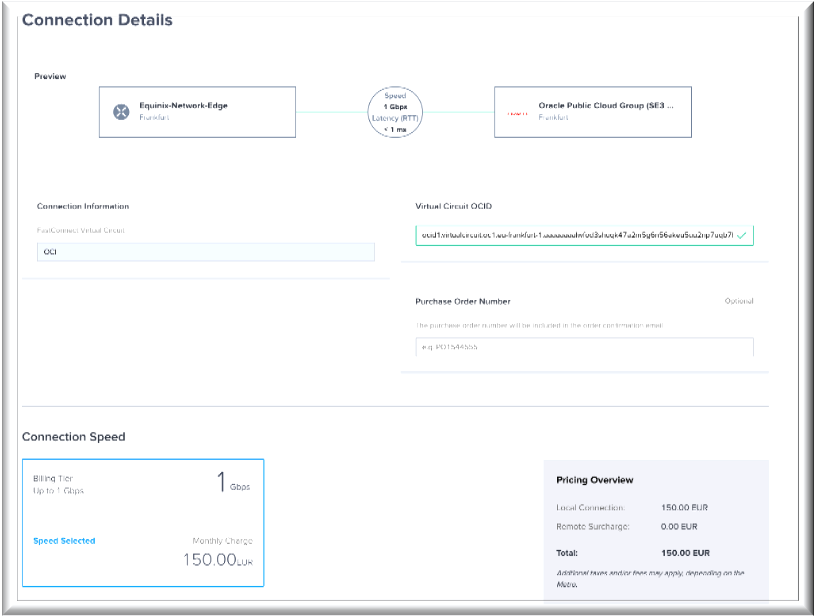

9. On the Connection Details page, provide the following information, and then click Next.
a. Enter a name for your connection, for example, OCI.
b. Paste the Virtual Circuit OCID, Enter the Connection Speed.
10. Click Order, and then click Order Now.

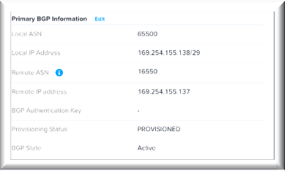

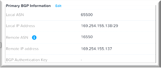

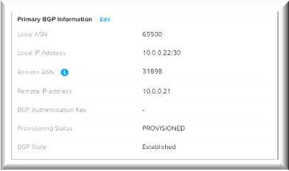

11. Once the OCI Connection gets provisioned complete the configuration with the BGP information and accept it.
12. After a few minutes the BGP status of the OCI Fast Connect connection goes UP.

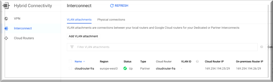

5. Go back to GCP console, go to the Interconnect page, click Activate and Accept the Partner request (you will see BGP IP addresses appearing).
6. Once the GCP Connection gets provisioned complete the configuration with the BGP information and accept it.
7. After a few minutes the BGP status of the GCP LAN attachment goes UP and the DRG advertises the VCN subnets prefixes to the GCP cloud router.

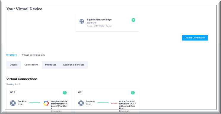

Verify Connectivity
You can verify the success of the BGP advertisement reviewing the BGP state of the two connections under the Equinix Network Edge Router.
1)OCI connection BGP State:
2)GCP connection BGP State:

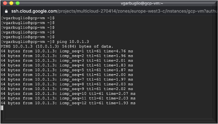

You can test the connection between the two clouds by launching a terminal window and launching a ping command, as shown in the following example:
