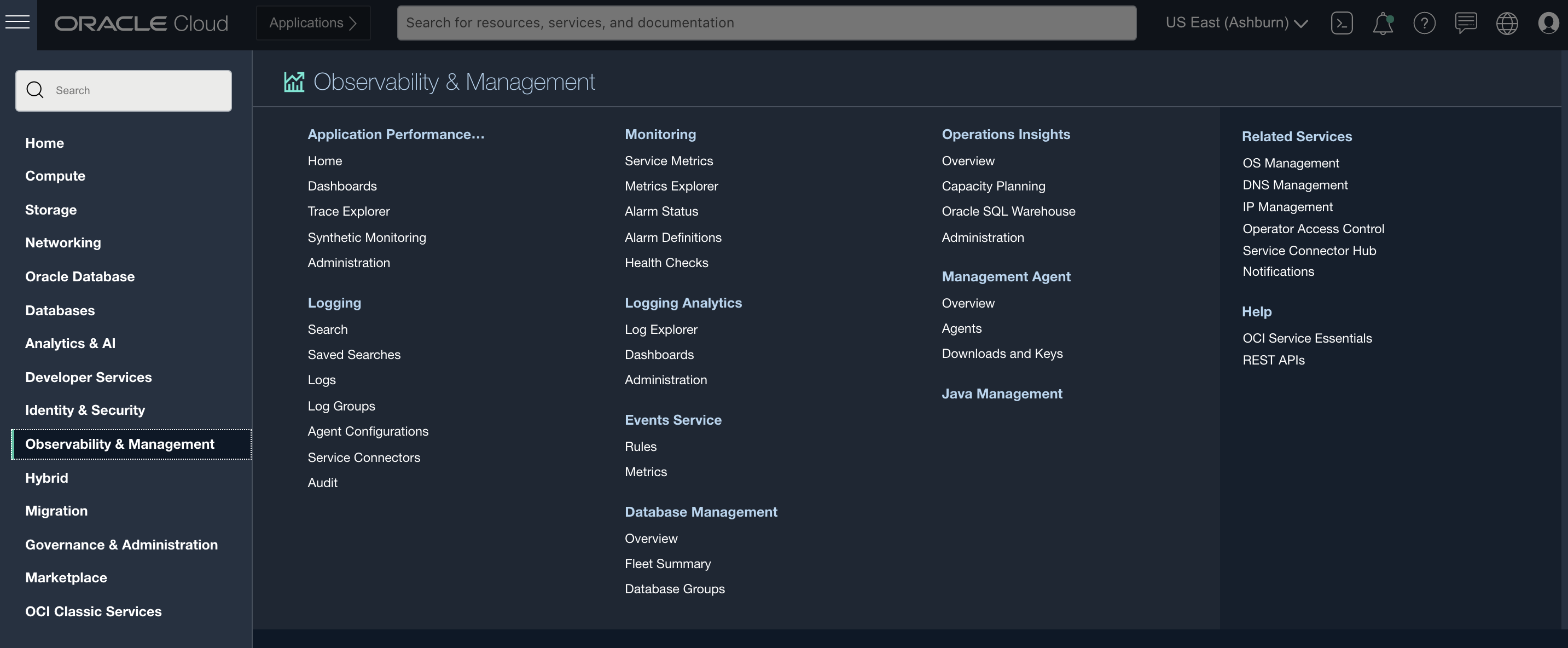

You can access all the features mentioned in this blog post from Observability and Management.
A screenshot of Observability and Management in the Oracle Cloud Console.

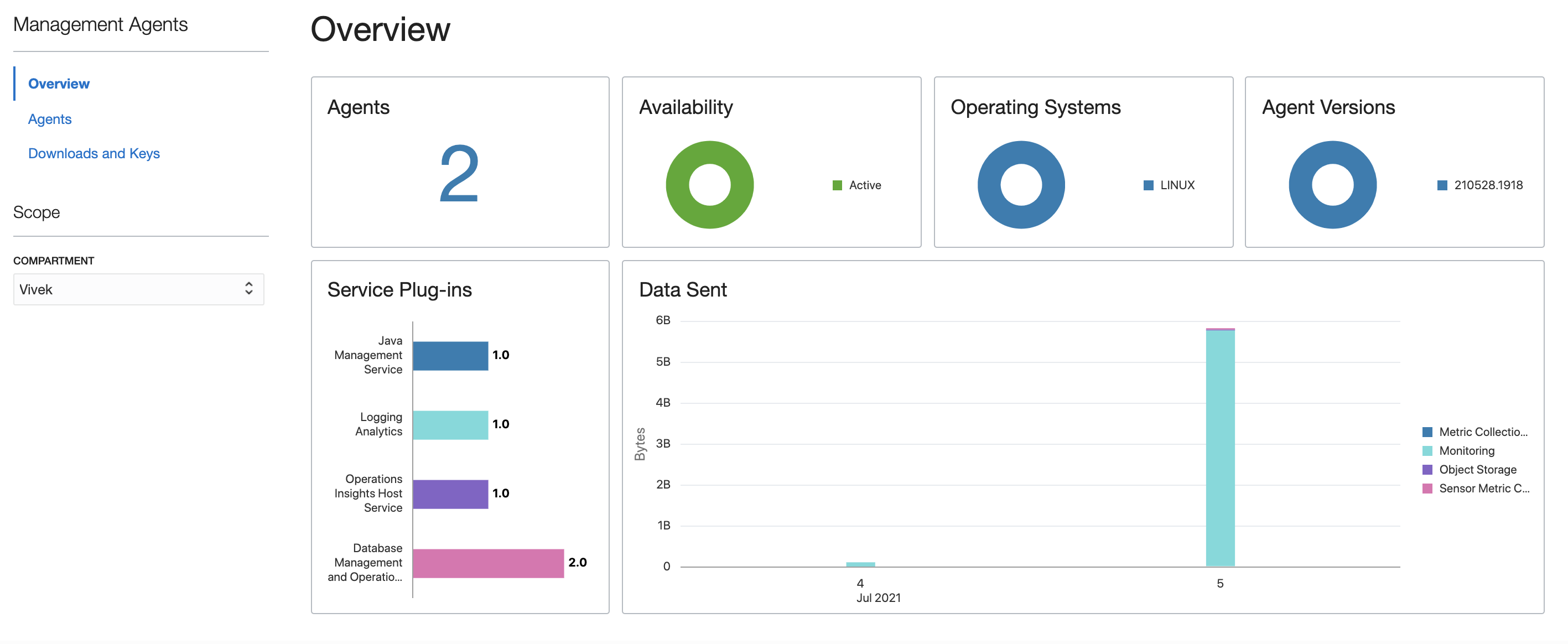

Install the management agent on the host where Oracle Database service is running. Database Management uses the management agent for operations such as collecting data and metrics and for running jobs on the database. To download the agent, go to Management Agent and select Downloads and Keys.
A screenshot of the Management Agents Overview page in the Console.

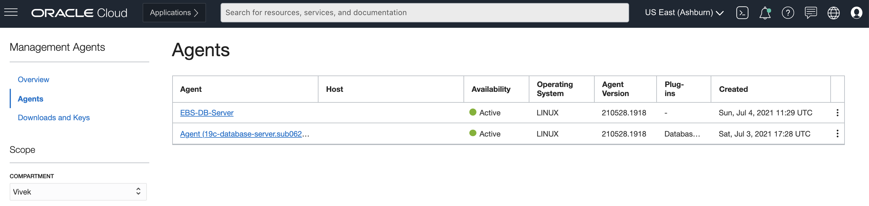

Verify the agent under Management Agents
A screenshot of the Agents page in the Management Agents section of the Console.

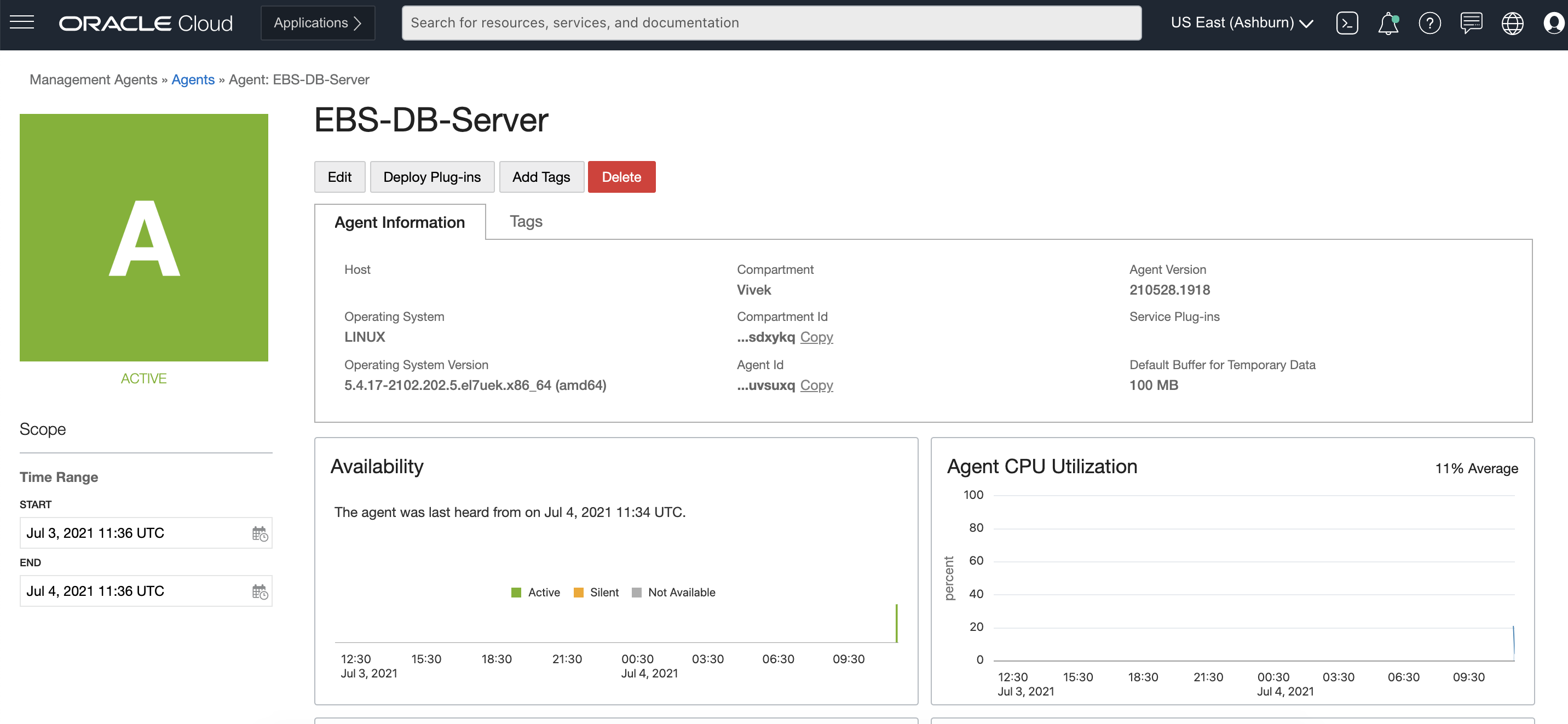

Ensure that agent availability is active. If the status of the agent is not active, check the prerequisites for deploying management agents. Click the agent and check the host details.
A screenshot of the details page for the EBS-DB-Server agent.

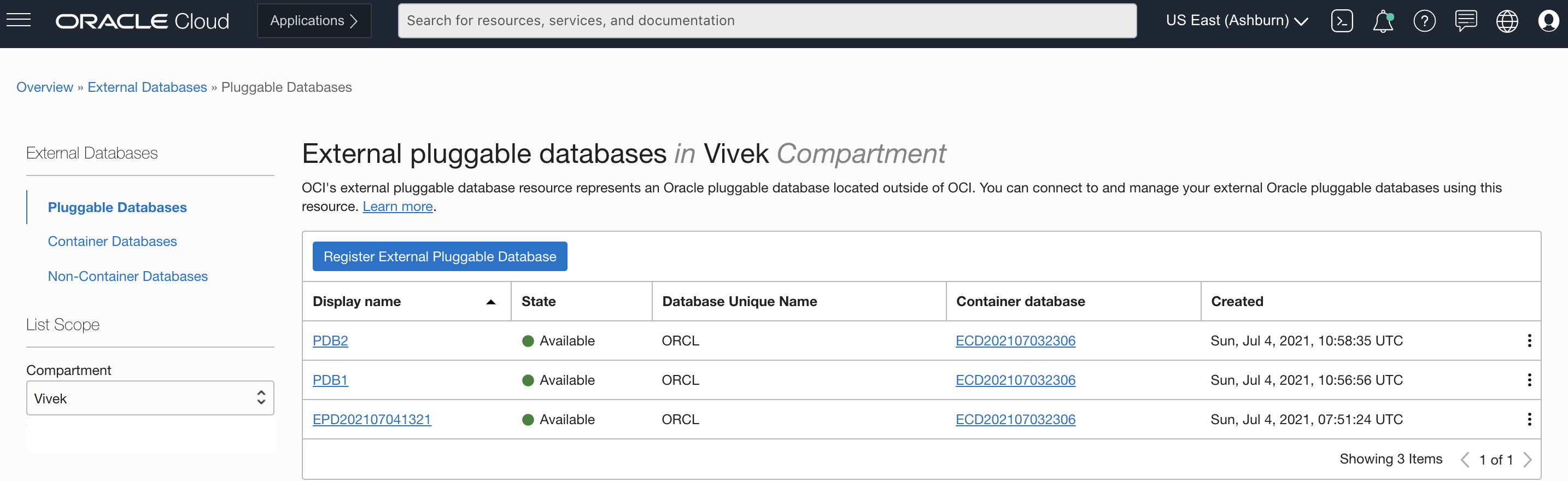

Next, we register the Oracle database on the management agent host as an external database. From the Console, go to Oracle Database and click External Database. We can register pluggable, container, and non-container databases.
A screenshot of the External Pluggable Databases page.

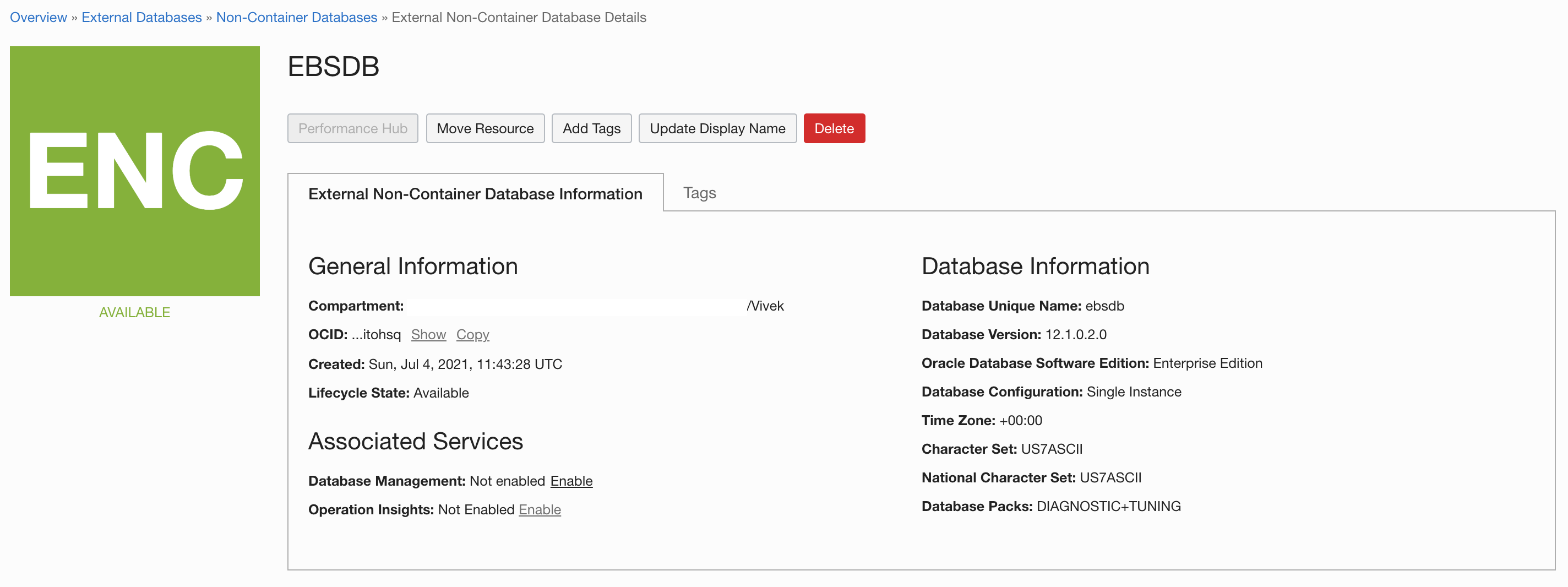

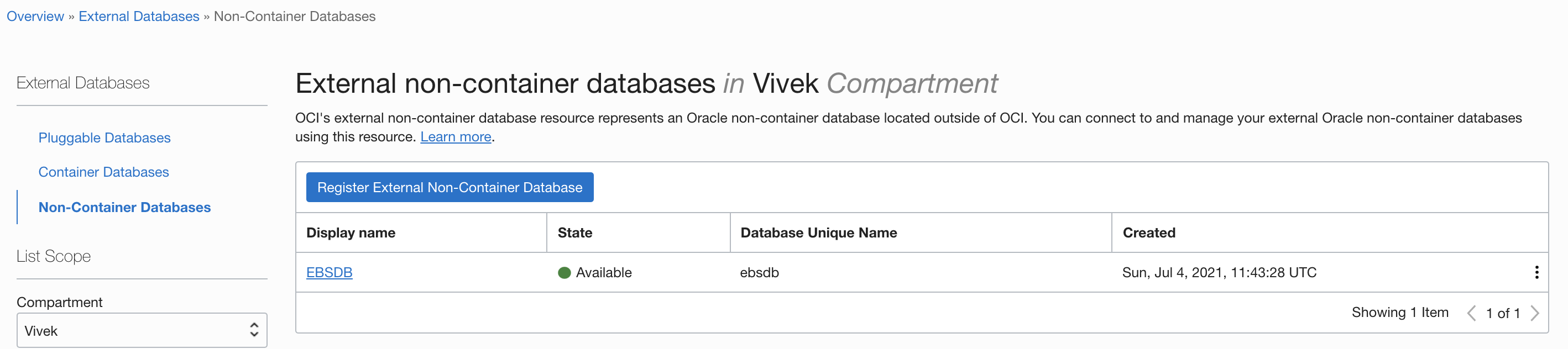

Go to Non-Container Databases and click Register External Non-Container Database. Enter all required details, such as connector agent ID, connection string information (server name and port), and database connection credentials.
Verify the status of the external database as available. If the registration fails during connection to Oracle Database service, verify that the management agent host isn’t blocking any connections to the port and service.
A screenshot of the External Non-container Databases page details.

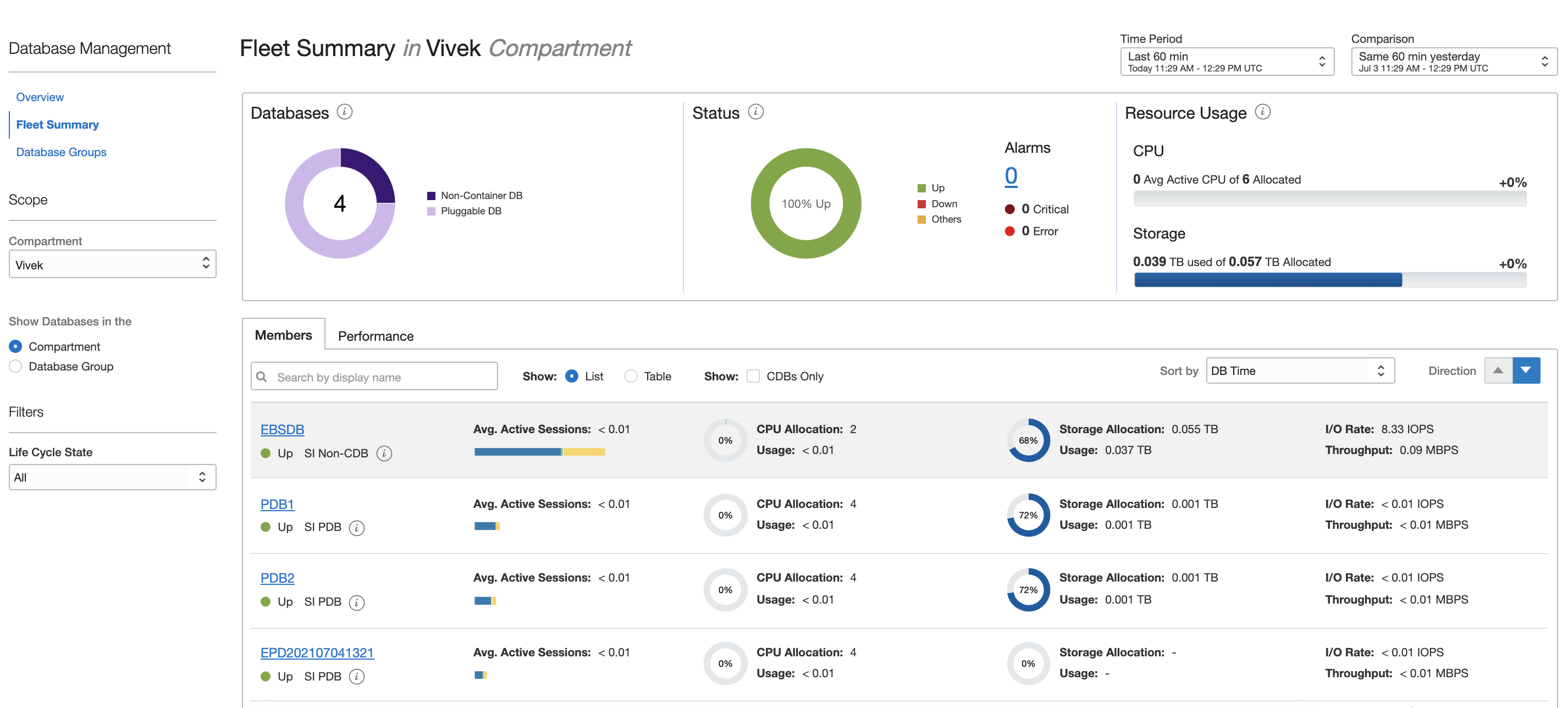

When Database Management is enabled, under Database Management, go to Fleet Summary and confirm that the database is listed. On the Fleet Summary page, you can monitor multiple Oracle databases, which include single-instance and Real Application Cluster (RAC) databases. With this capability, you can proactively detect and identify the cause of performance issues across a fleet of databases and respond to performance and configuration-related alerts.
A screenshot of the Fleet Summary page in the Console.

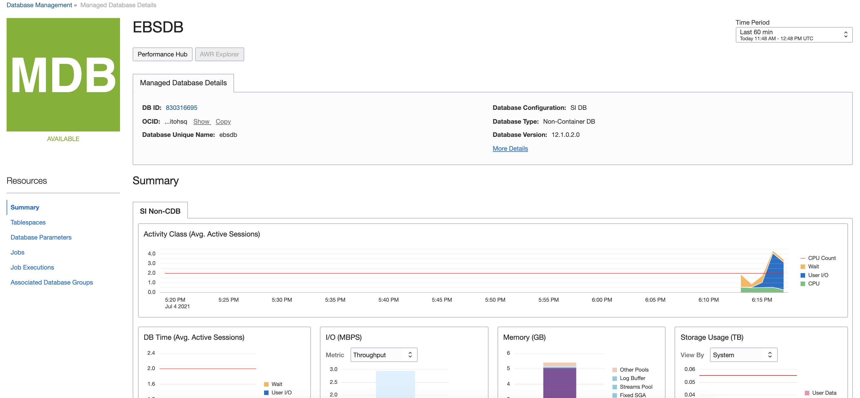

To open Managed Database details, such as the database ID, OCID, database configuration, and database type, click the name of the Oracle database. To view more details about the database, such as edition and compartment, you can click the More Details link in this section.
A screenshot of the Managed Database Details page in the Console.

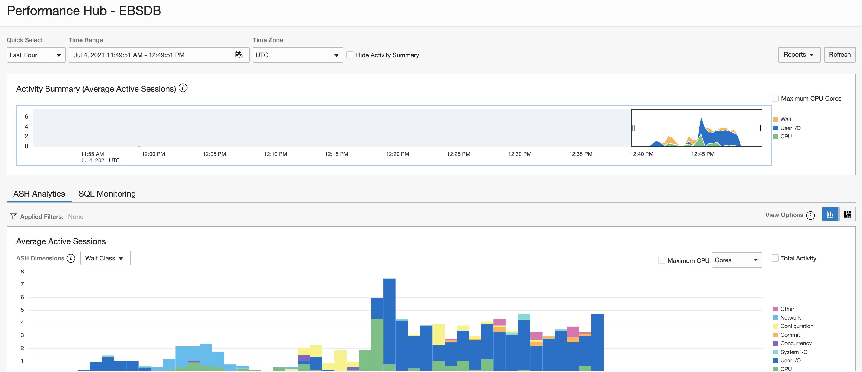

Click Performance Hub to go to the Performance Hub and analyze and tune the performance of the Oracle database. With this tool, you can view real-time and historical performance data.
A screenshot of the Performance Hub page in the Console.
The Performance Hub window consists of a graphical time range display that you use to select the period of all data to be displayed. It includes the following tabs that display performance data:
