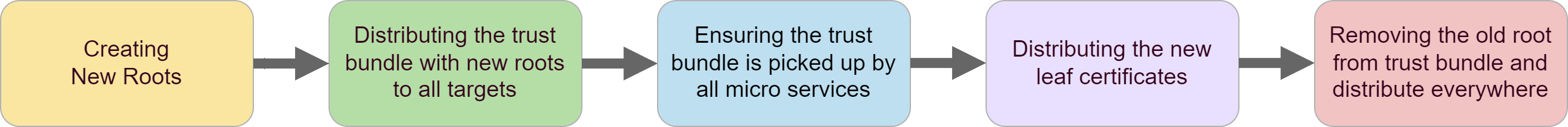

These certificates are anchored to root certificates through a chain of trusted intermediate certificates. We rotate the root certificates and the chain of intermediaries in each cloud region periodically to maintain our security and compliance bar. This complicated deployment process spans across hosts, virtual machines (VMs), SmartNICs, root of trust devices and several other service targets.
Figure 1: Root rotation sequence
A small mishap in any of these steps can lead to a significant outage in that region, causing a poor customer experience. The worst part about these outages is that they can be difficult to recover from. The services required for recovery themselves might be impacted if two services can’t talk to each other because of a lack of trust. This complex process is infrequently exercised in a region but can lead to serious problems if the steps don’t work as expected.

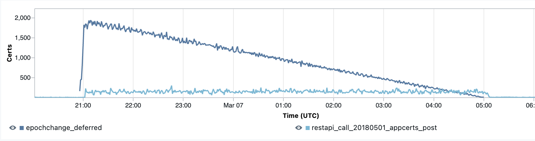

In Chaos Lab, we identified that the phase during which we forcibly renew all existing certificates had no velocity control. As a result, we ran into severe throttling from several downstream services, including load balancers to which certificates must be distributed. The storm of retrying that resulted from throttling failures dropped some of our dependencies, which further slowed down the recovery.
This area is one where we made most improvements and continue to make more progress. Having to issue certificates and certificate authority (CA) bundles across thousands of targets including hosts, SmartNICs, and load balancers require controlling the sequence and speed of distribution of artifacts. We built and deployed configurable controls in our certificate distribution service and agents to manage the area of damage. For example, we introduced a mechanism to control the speed of distribution with a configurable parameter decided based on the number of certificates needed to be issued in a region. As a result, we started with 1% of targets receiving new certificates and gradually increasing it over a period of 6–8 hours. It allowed us to watch as the certificates were redistributed and react quickly to any sign of failures.
Figure 2: Certificate distribution velocity control
The higher, dark blue line shows the decline of certificate renewals, while the flatter, light blue line shows the number of certificates renewed every minute.

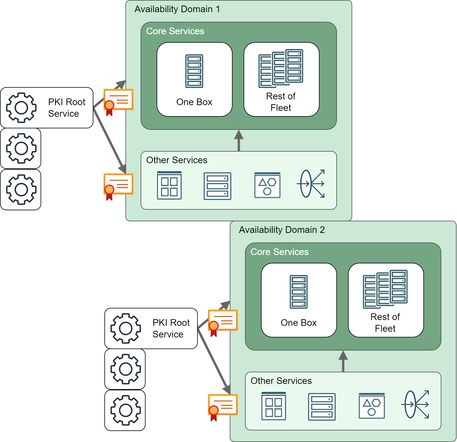

On top of minimizing damage, we built a mechanism to introduce new roots and certificates to specific services’ targets. Because PKI is at the bottom of the OCI stack, ensuring that the platform services don’t fall apart during root rotation is critical. It can lead to cyclic dependency issues while recovering a region if a full-blown failure occurs. We emulated this scenario in Chaos Lab and discovered that specific core platform services must break the cyclic dependency during the bootstrap of a region. We then built mechanisms for the following processes:
- Release certificates to a single fleet of core services’ control and data planes, which greatly helped us answer a key question at the early stages of processing: “Which services are impacted at what time?”
- Distribute the root and dependents to one fault domain at a time across all services, which helped us narrow down the potential impact and respond to issues effectively.
Figure 3: Deterministic distribution of certificates
Deterministically isolating impact targets helps respond to unrelated OCI-wide incidents without using a lot of developer hours on false positives. The teams can be on alert during their potential impact window.
