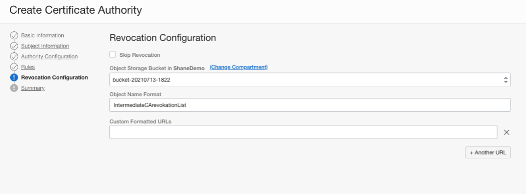

CAs created in OCI Certificates can automatically manage the CRL list for you. You create an OCI object bucket, and the list will be created automatically. Any time a certificate or CA is revoked, it is instantly added to the CRL.

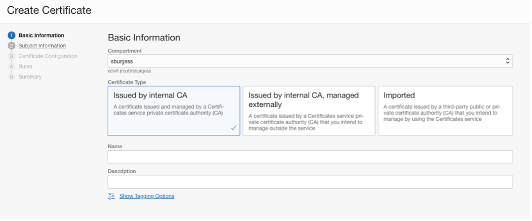

There are three ways you can manage your certificates with the new OCI Certificates service. The first method is issued by internal CA as the fully automated path. Your private CA creates the certificate and deploys it to the integrated services, such as the OCI Load Balancers automatically. In this path, your certificates are monitored and automatically renewed and deployed.
The second method is issued by internal CA, managed externally if you have a policy that requires the private key to be kept on-premises. If this is the case, you can create a Certificate Signing Request (CSR) and upload it to the certificate service so your CA can create the certificate.
Finally, use imported certificates if your certificates come from a particular vendor. Similar to the managed externally method above, once the certificate has been uploaded, it will be deployed to the load balancer automatically and you will get alerted when it’s time to renew the certificate.

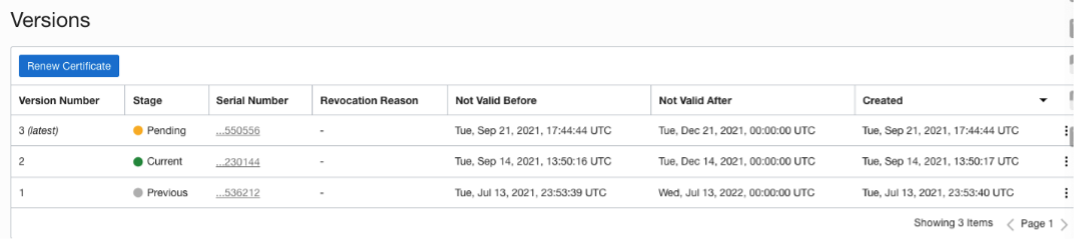

OCI Certificates will keep track of up to ten versions of your certificates. You can easily tell which certificate is in use by the stage column in the versions field. The active certificate will be in the current stage. Older versions will be in the previous stage. If you just manually renewed the certificate, but the certificate has not be deployed to a resource automatically, then the certificate will be in the pending stage.

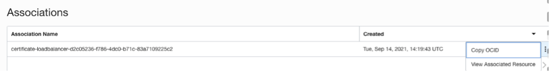

Another tool to help you keep track of which certificate is deployed on what OCI resource is associations. Associations show you what resource is using the certificate. In addition, as long as an association exists for the certificate, you will not be able to delete the certificate. This helps avoid human error while managing the certificates.
