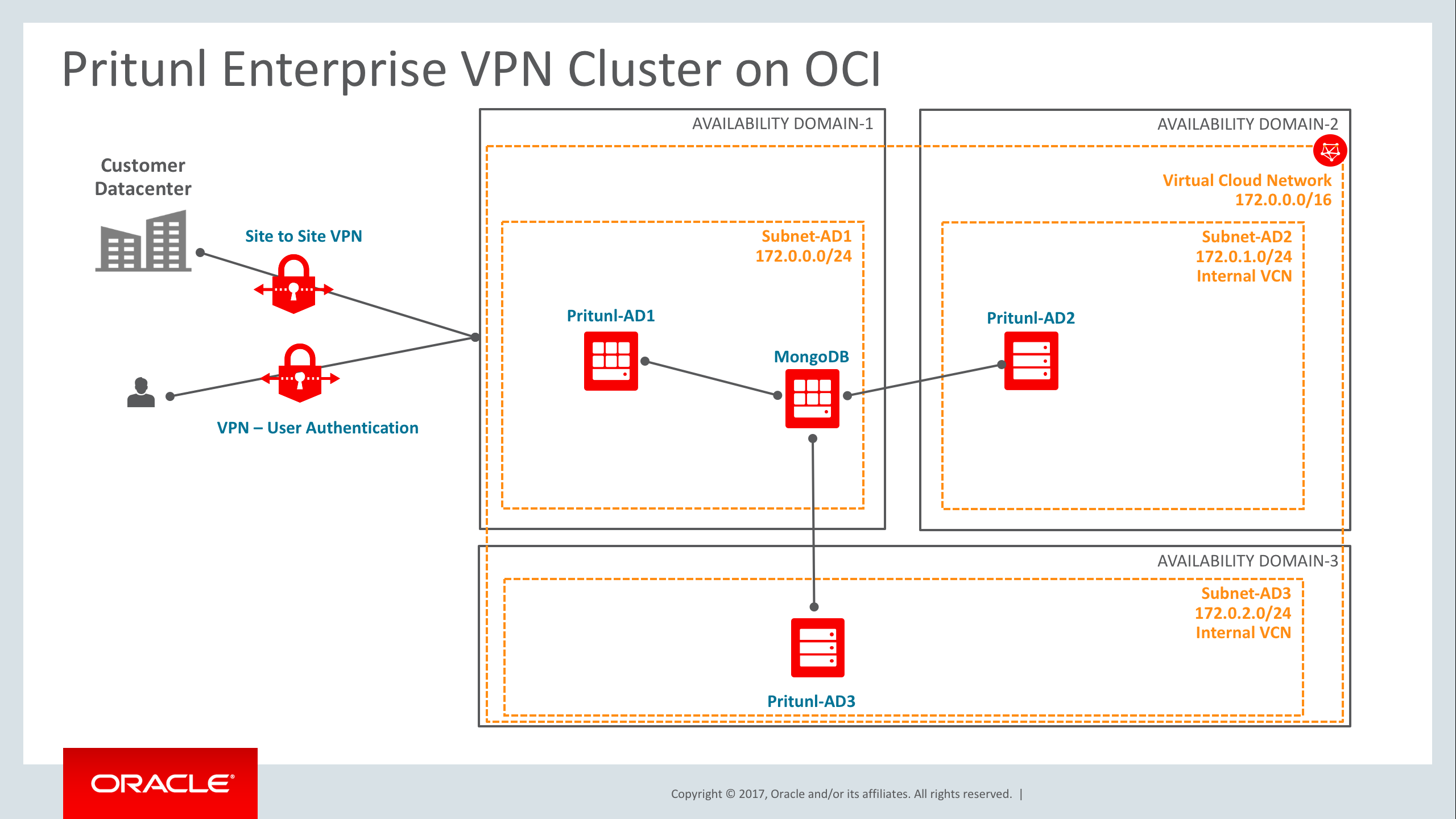

Architecture
Configuration Process
Using Pritunl on Oracle Cloud Infrastructure to automate the VPN Server failover and client reconnection is very simple:
1- Provision four Oracle Cloud Linux Instances. One node will host MongoDB so choose the appropriate Instance shape based on the workload. The remaining instances will be used for the Pritunl VPN servers – one in each of the three Availability Domains in the region, for fault tolerance.

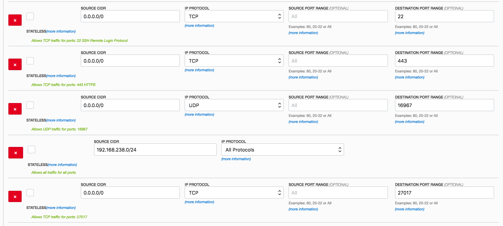

3- Enable only the required ports for the internal network using the Oracle Cloud Infrastructure Dashboard Security List Option for the above services as well. Below is an example for MongoDB port.
Source: 172.0.0.0/16
IP Protocol: TCP
Source Port Range: All
Destination Port Range: 27017
Allows: TCP traffic for ports: 27017
4- Make sure that ports 443 (HTTPS) and 27017 (mongoDB)  are enabled for 0.0.0.0 (internet) communication.

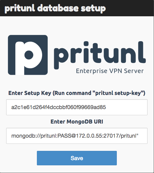

10- Identify the VPN Instance’s public IP address, open a browser and type https://publicIP-VPNServer1. When Pritunl starts for the first time a database setup prompt will be shown on the web server running on port 443 and the database setup will prompt for a setup key and MongoDB URL. To get the setup key, ssh on to the server and run the command “pritunl setup-key” and this will return the setup key. By default the MongoDB URL will be filled with the uri for the localhost MongoDB server so make sure to change the default URL to “mongodb://pritunl:PASSWORD@MONGODB_INTERNAL_IP:27017/pritunl” as the following example for a MongoDB instance with a local IP 172.0.0.55, using username “pritunl” and password “PASSWORD” (default username and password are “pritunl”).
Repeat this process on all additional VPN instances in your environment.

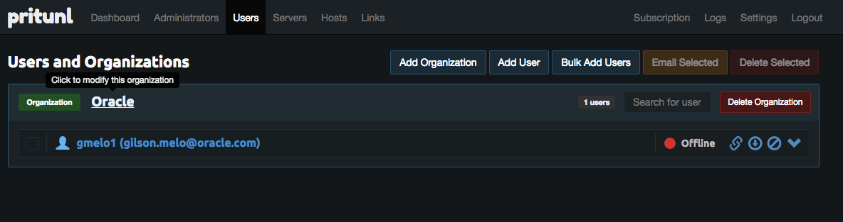

11a- Create an Organization (i.e.; Oracle) and users

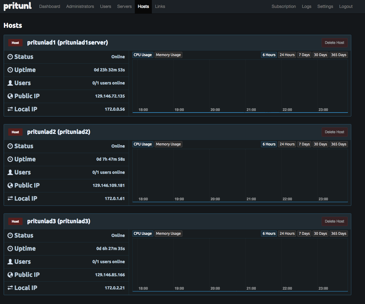

11b- Check the Hosts tab to make sure all the VPN instances are there and update the names if needed

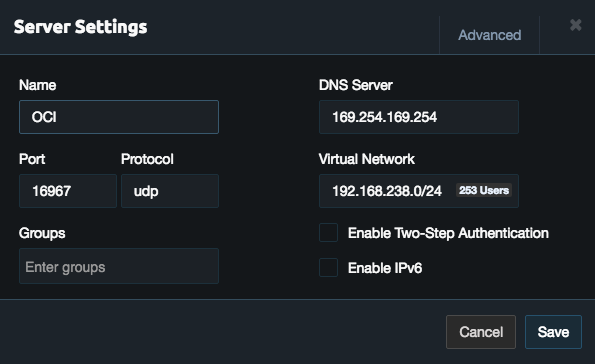

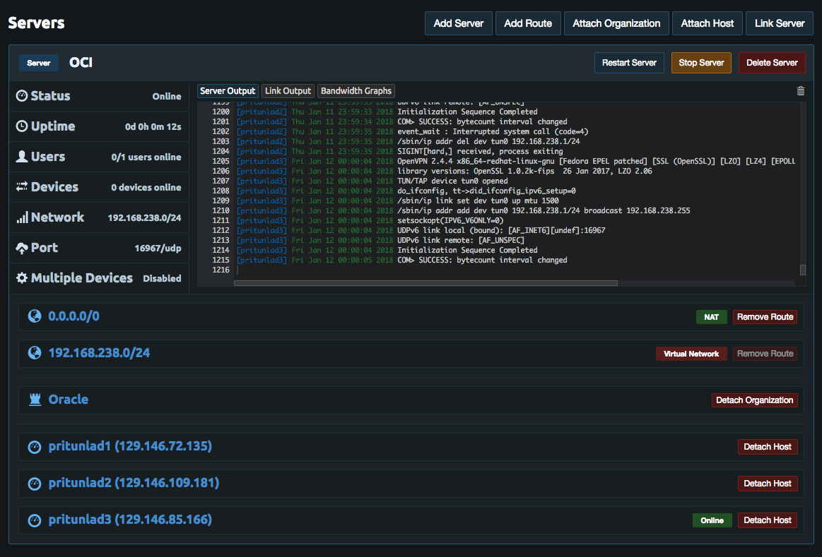

11c- Create a new Server and pay attention to the protocol, port and Virtual Network subnet that you are using.
11d- Make sure you enable the above port, protocol and network using Oracle Cloud Infrastructure Dashboard
11e- Start the Pritunl Server
12- Now it’s time to test a client connection. Download the appropriate Pritunl Client based on your operating system, start it, and import the user profile that was created on step #11a.
