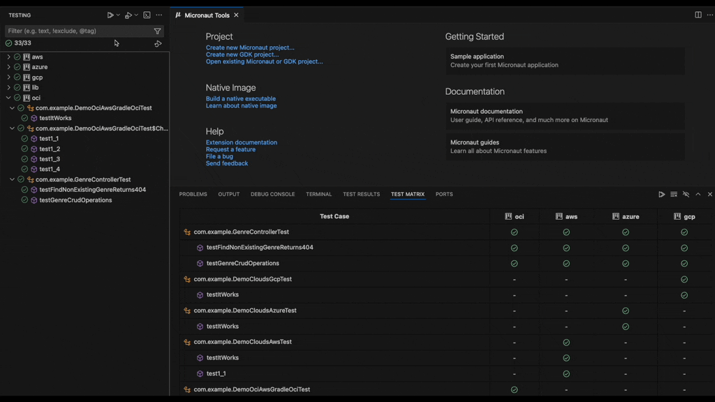

With the latest version of the GDK Extension pack installed, you can run all your tests in parallel, saving you time and streamlining your development workflow. A new default test-running profile is registered, which includes a new action, Run Tests in Parallel, for each GDK project module. Use the action, Run Tests in Parallel, to run all your tests for each module in your application simultaneously. Running tests in parallel significantly speeds up test execution.
Running test in parallel with the Multicloud Tester.

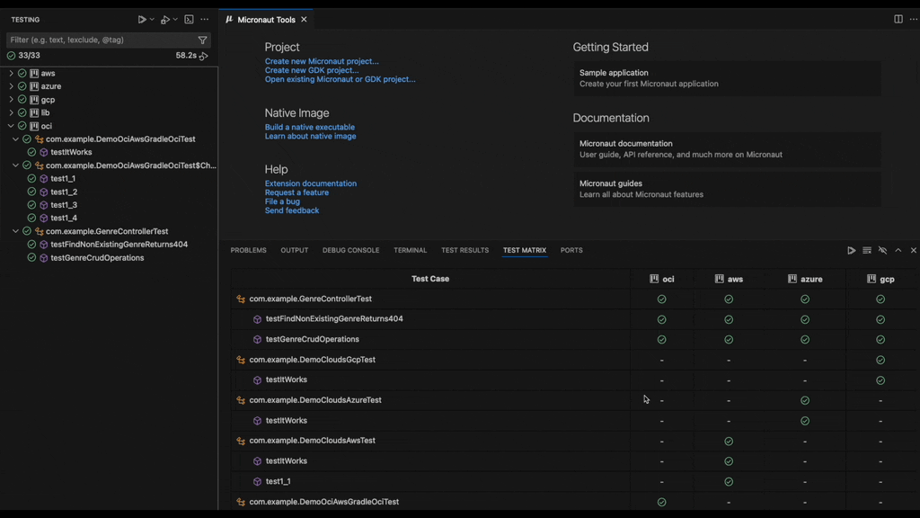

The results of running the tests are displayed in an easy-to-navigate matrix. Clicking on the result of any particular test will navigate to the test code. If a test fails, you can update your code to make it pass and then rerun just that test, which will also update the matrix. There is no need to run all of your tests again.
Navigating using the Multicloud Teste.
