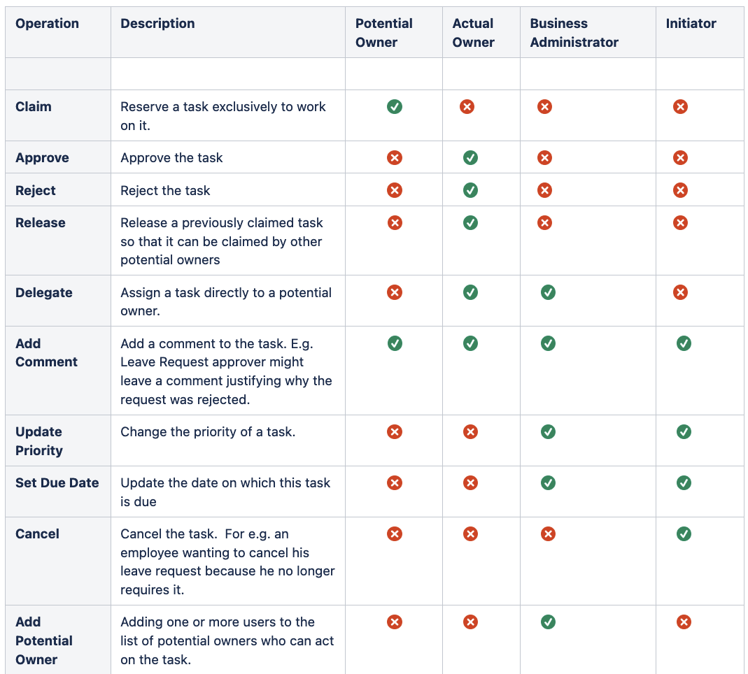

Task Operations
These are the operations the application user can perform on a task, depending on his persona.

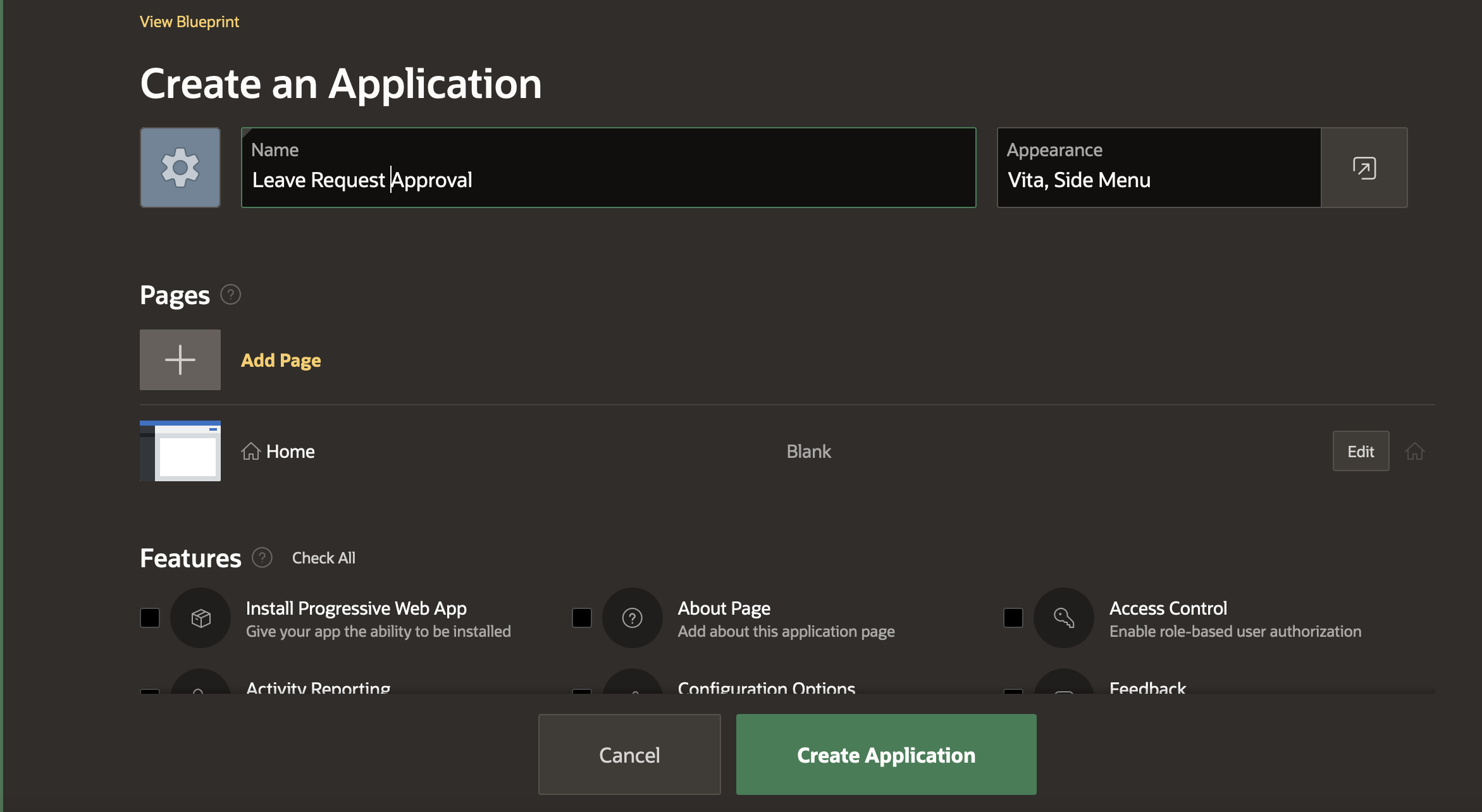

Create the App
- Navigate to App Builder
- Click Create
- Click New Application
For Name – enter Leave Request Approval

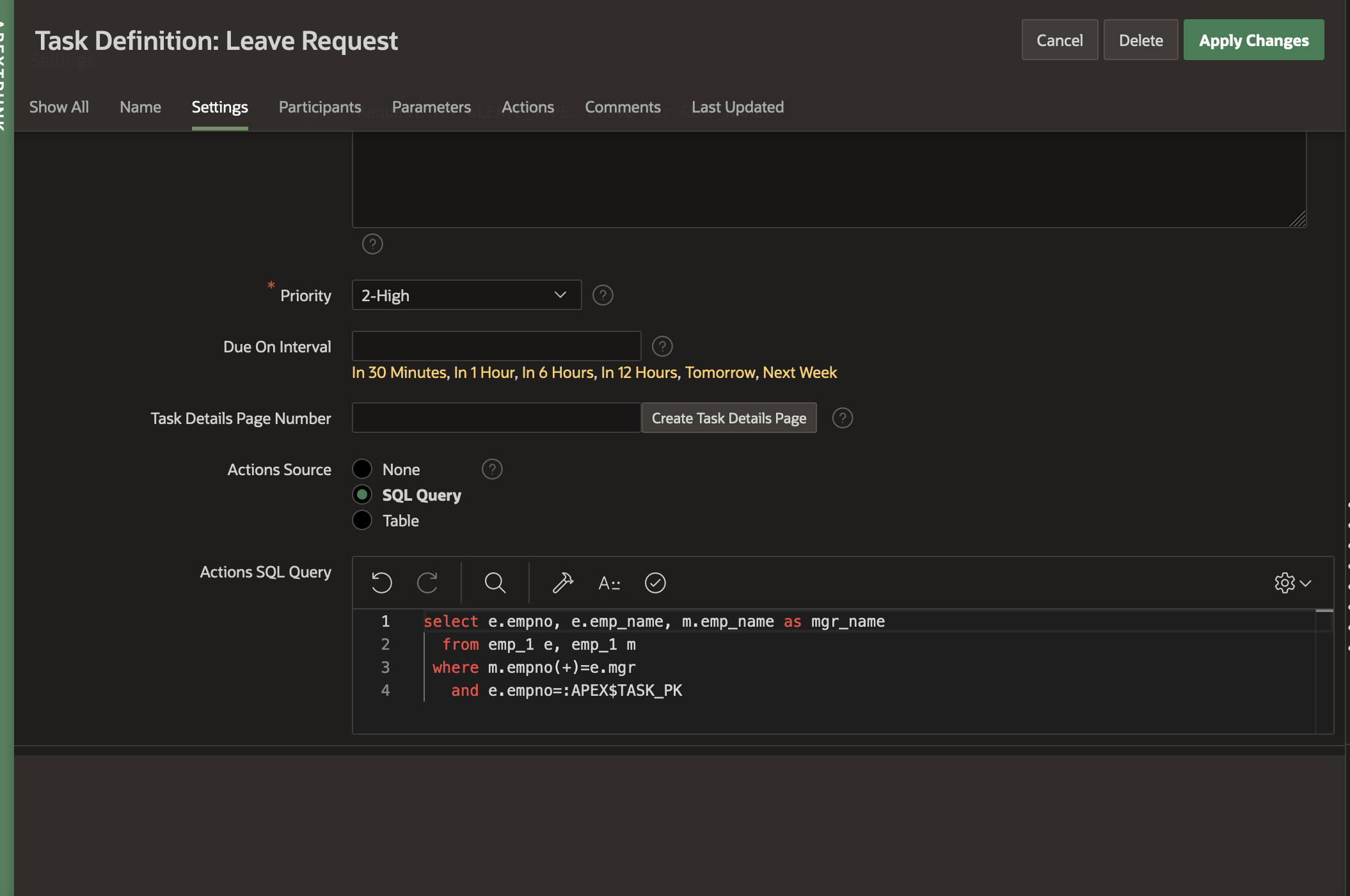

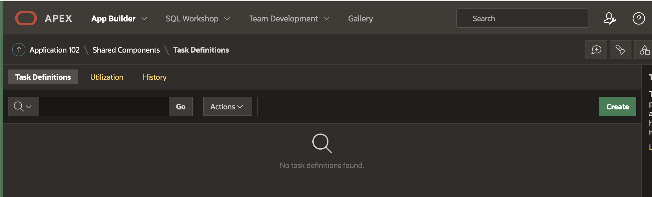

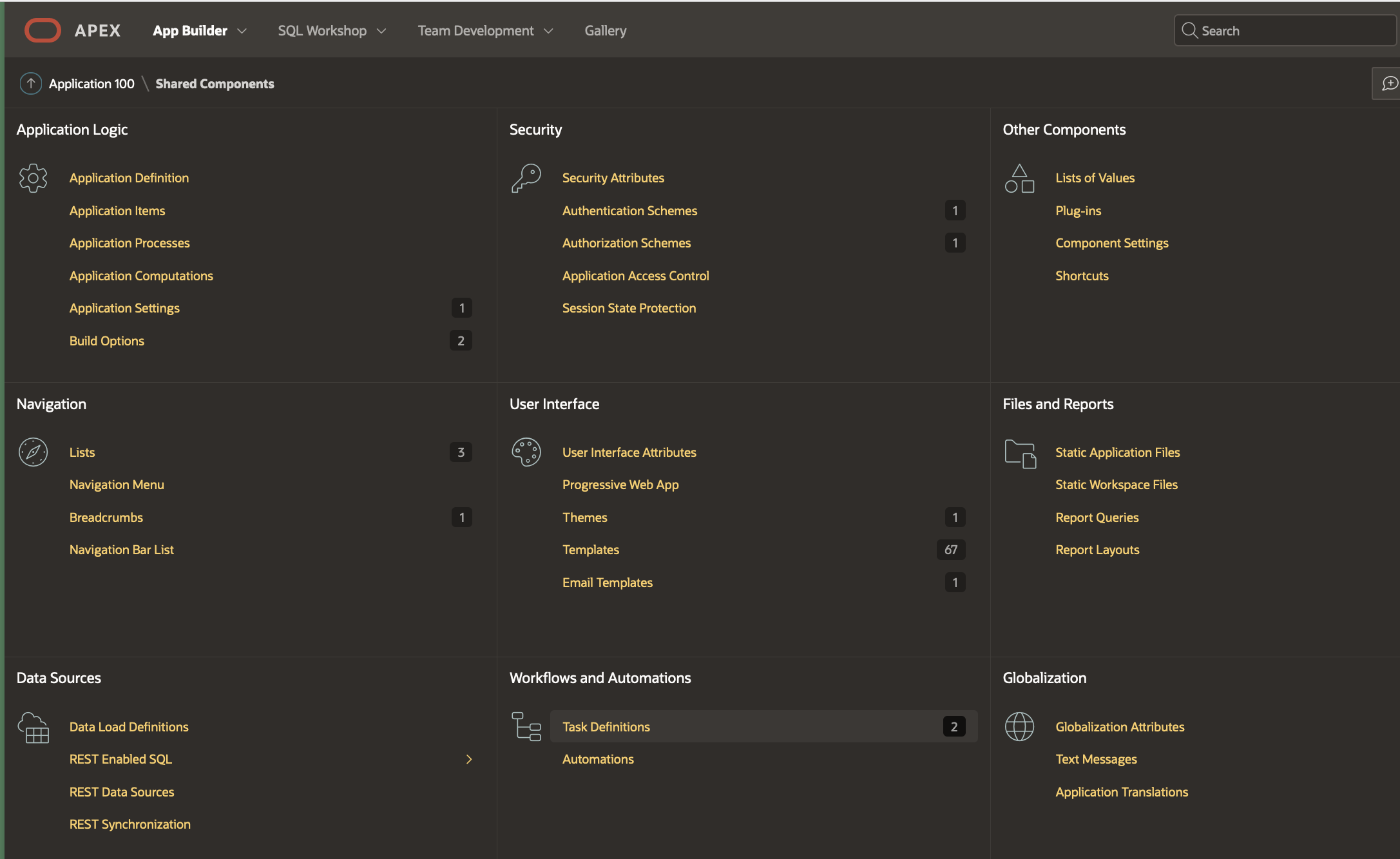

Creating the Task Definition

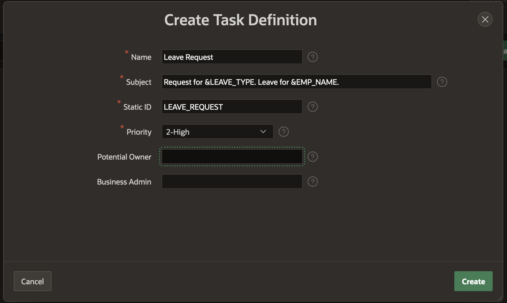

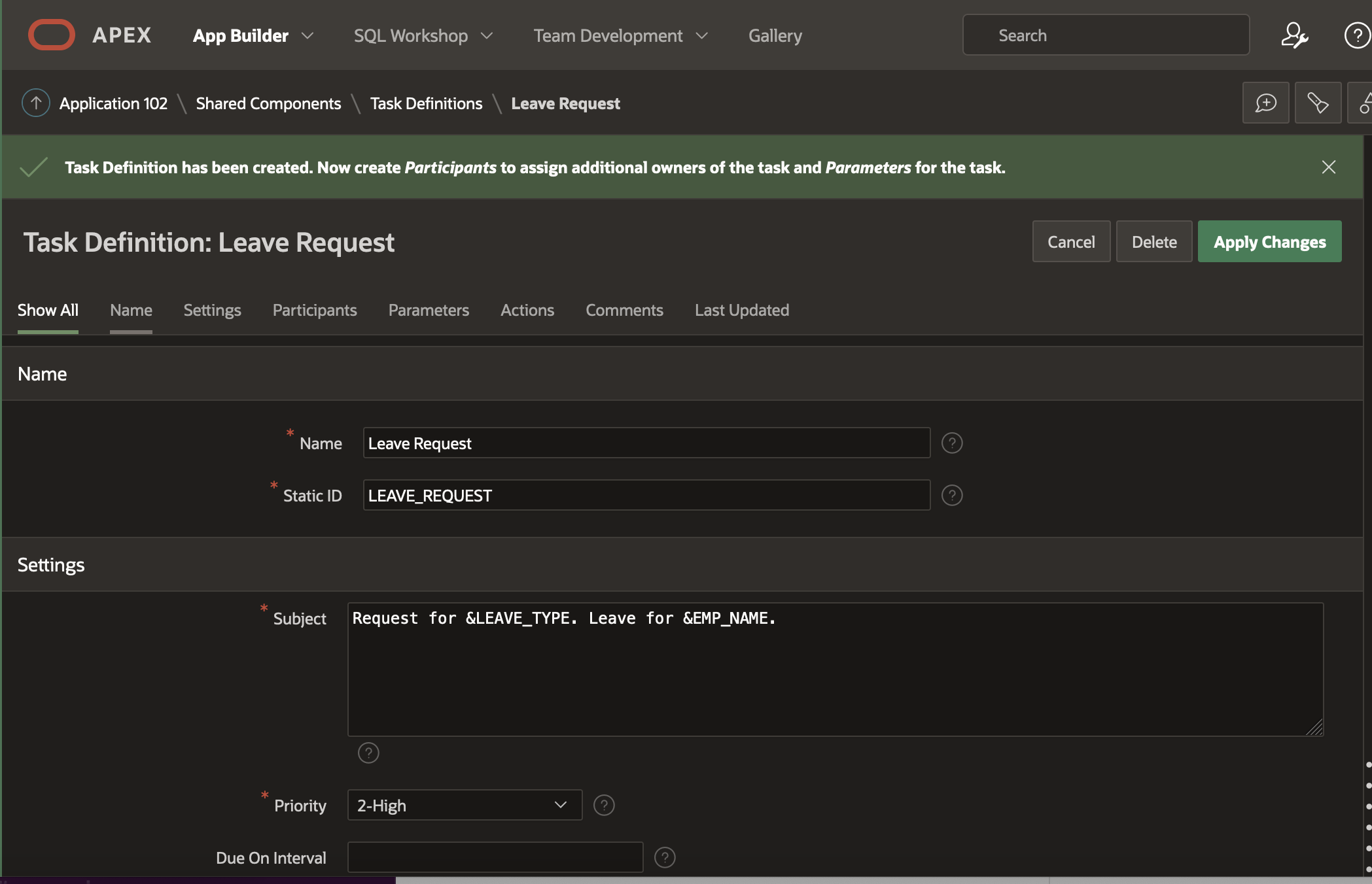

In the empty Application, we go to the Shared Components→ Workflows and Automations→ Task Definitions and hit Create.
Fill in the Create Task Definition Wizard fields as shown below, and hit Create.
Leave the Potential Owner and Business Administrator fields empty for now. We will fill them up in the next section.

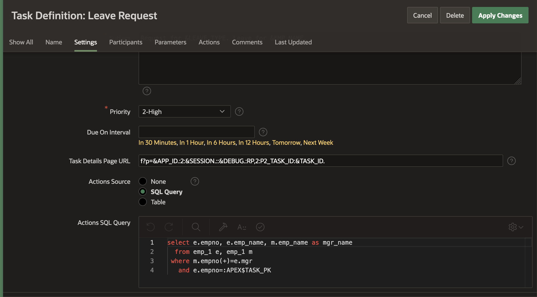

We can now further configure the Leave Request Task Definition in the Edit Task Definition screen that opens once the Create is hit.
Adding the Action source – This step ties our task to the system of records, in this case, the employee records. Select SQL Query as the action source and add the following SQL statement in the Actions SQL Query editor.
select e.empno, e.emp_name, m.emp_name as mgr_name from emp_1 e, emp_1 m where m.empno(+)=e.mgr and e.empno=:APEX$TASK_PK
APEX$TASK_PK is a substitution string that holds the value of primary key of the system of records to which the task is tied. In this case, it will hold the employee number of the employee for whom this leave request task is being submitted. Note: Please check the documentation for a complete list of Substitution Strings available for Approvals Component.

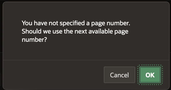

Generating Task Details Page – Notice that the Task Details Page Number is empty. Click on the Create Task Details Page button to generate the details page for this task. You will get a popup dialog asking if the next available page number should be used. Click OK.
We will find that the Task Details Page Number is replaced by the Task Details Page URL containing the link to the generated Details Page.

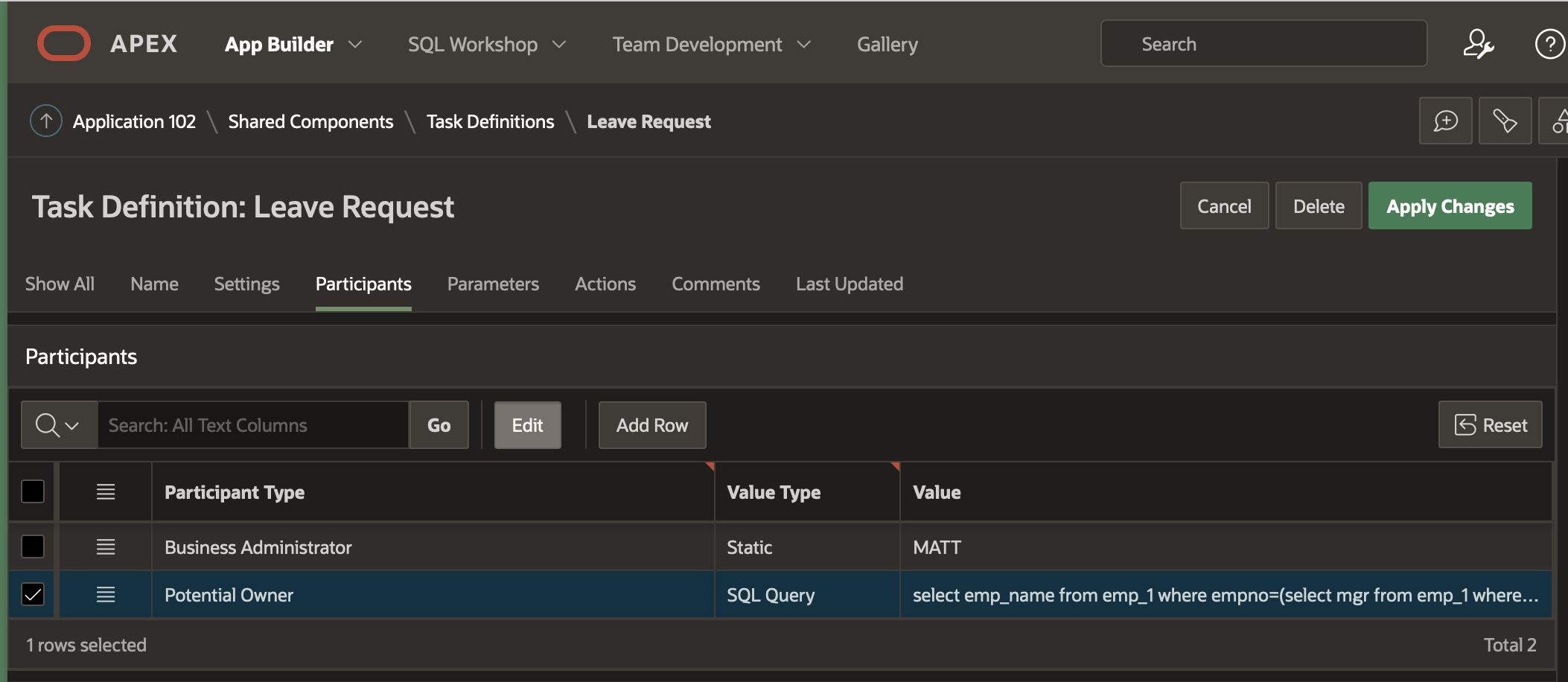

Add Task Participants
In the Participants section, select Participant Type as Potential Owner and Value Type as SQL Query. In the Value field, add the following SQL query
select emp_name from emp_1 where empno=(select mgr from emp_1 where empno=:APEX$TASK_PK)
NOTE: This query will fetch the manager of the employee for whom the request is being created.
Add another row to the Participants section . Select Participant Type as Business Administrator, Value Type as STATIC. In the Value field, type ‘MATT’.

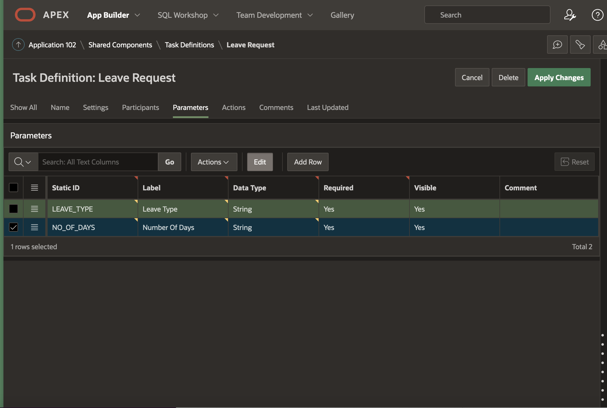

Add Task Parameters
Add the following entries to the Task Parameters section.
NOTE: Any parameter you add to the Task Parameters , can be used as bind variables in your participant or actions source SQL queries, as well as substitution strings in the task definition subject as shown in this example, where the subject contains a reference to the LEAVE_TYPE parameter.

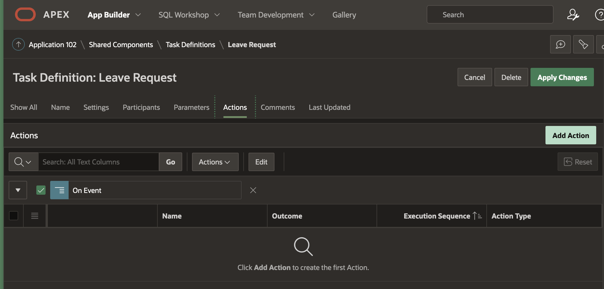

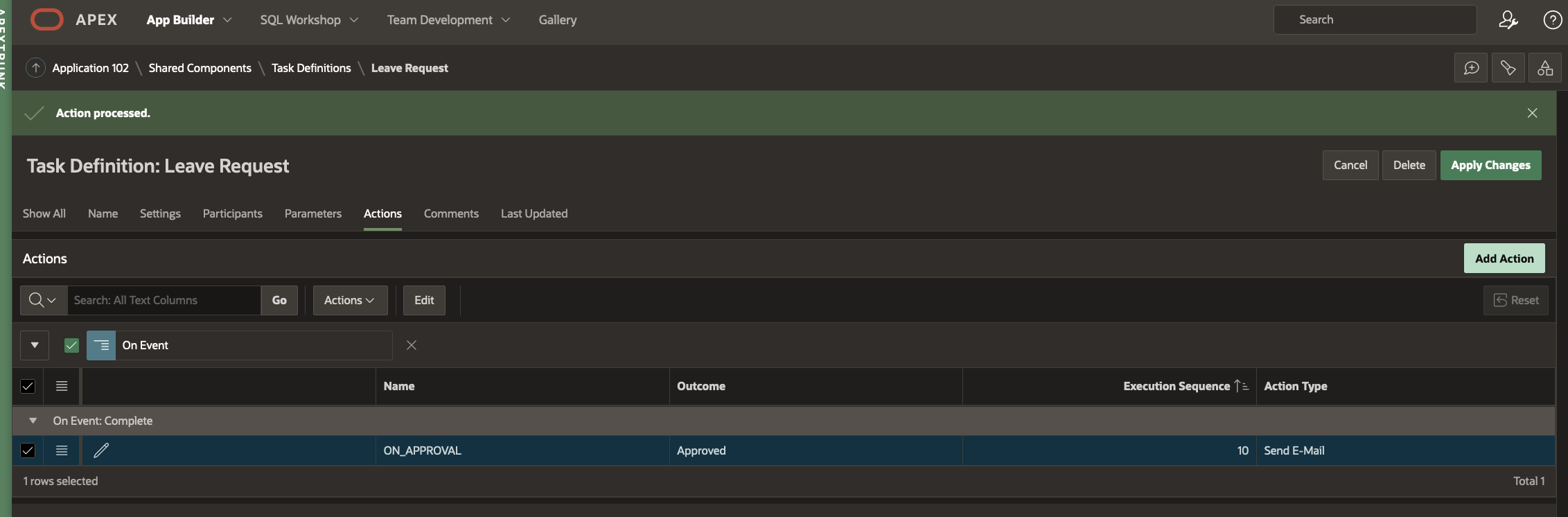

Add Actions

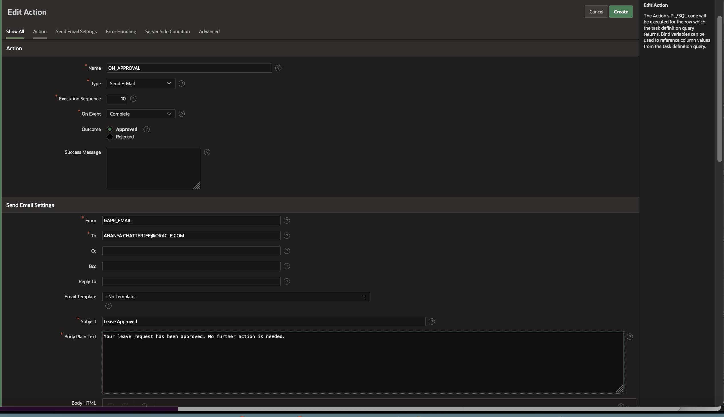

You could choose to perform additional actions when an event (defined in the Task Events section above) occurs on a task. Click on Add Action as shown below . This will take you to the Task Definition Actions Edit Page
We will set up an action that sends an email to the applicant of the leave, when his/her Leave Request is approved. Fill out the Edit Action page as shown below and then hit Create:
You can do a lot more with Task Actions to update other tables, create additional tasks, and so on. We will explore this in a subsequent blog.
That’s all! Your task definition for Leave Request is complete. Apply Changes and come back to your application.

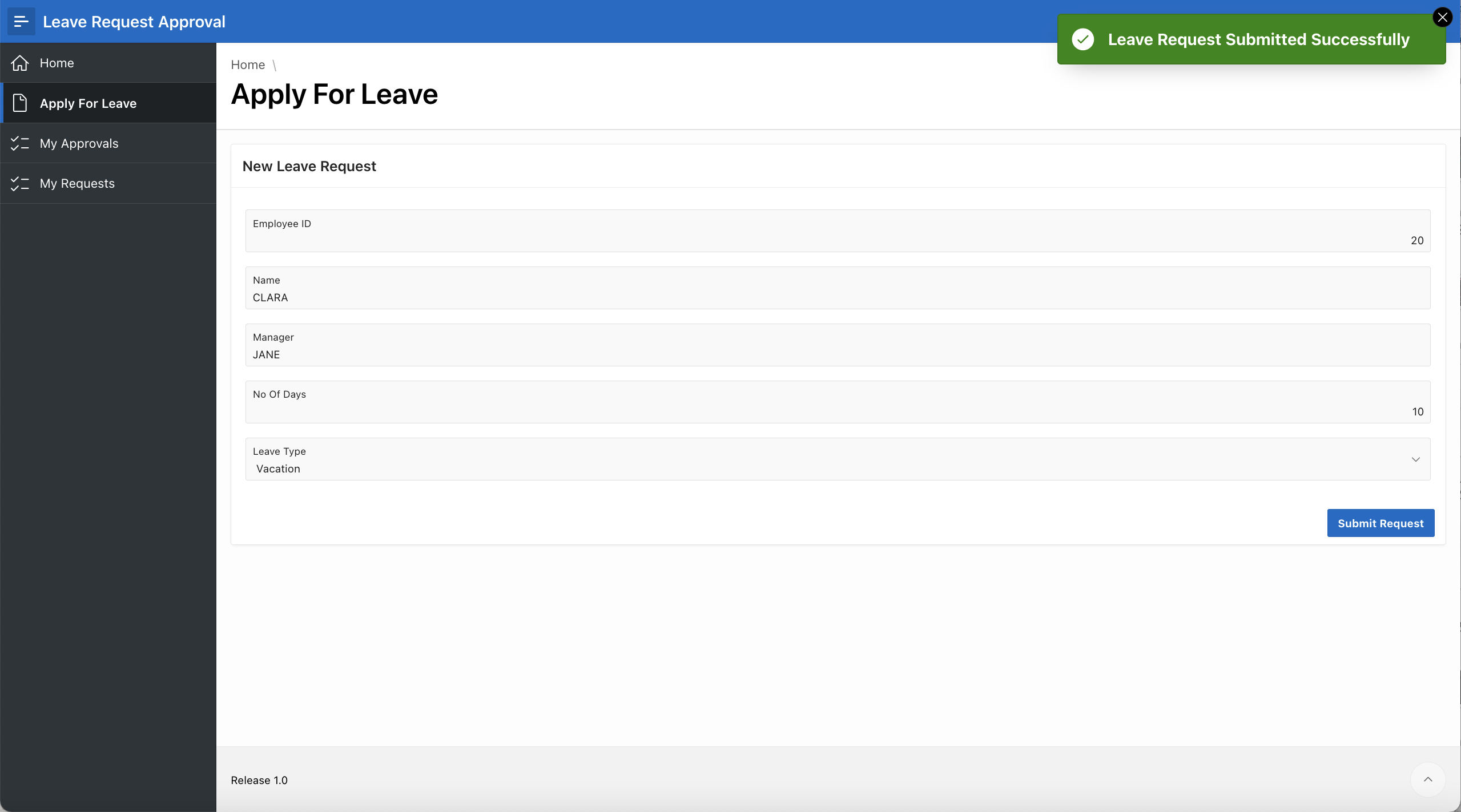

Creating the Apply for Leave page
Now that we have the task definition created, we will need to create the page which the employee will submit when requesting for leave. Submitting this page will create a Leave Request task based on the task definition we have just configured.

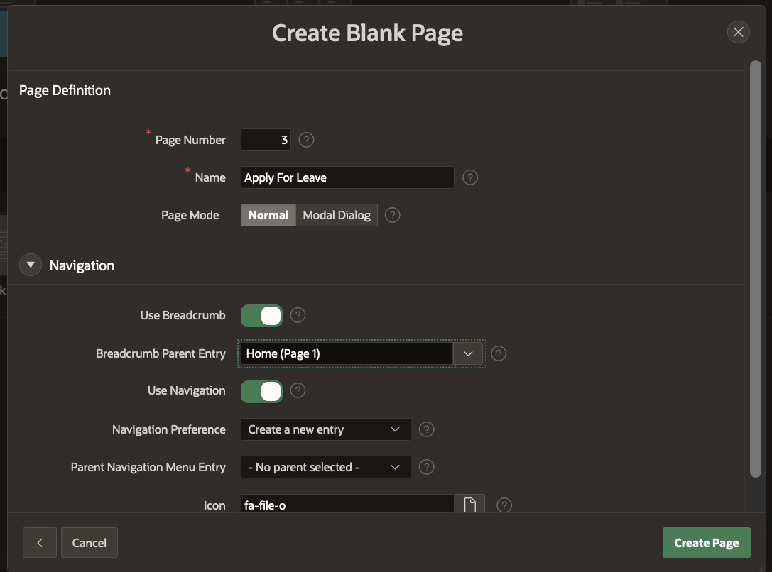

Click on Create Page in your Leave Request Approvals application.
Note that there is a new Task Details page in the list of pages for your application. This got generated when you had hit the Create Task Details Page while editing the task definition.
Name this page “Apply For Leave” and add it as a breadcrumb under the Home page

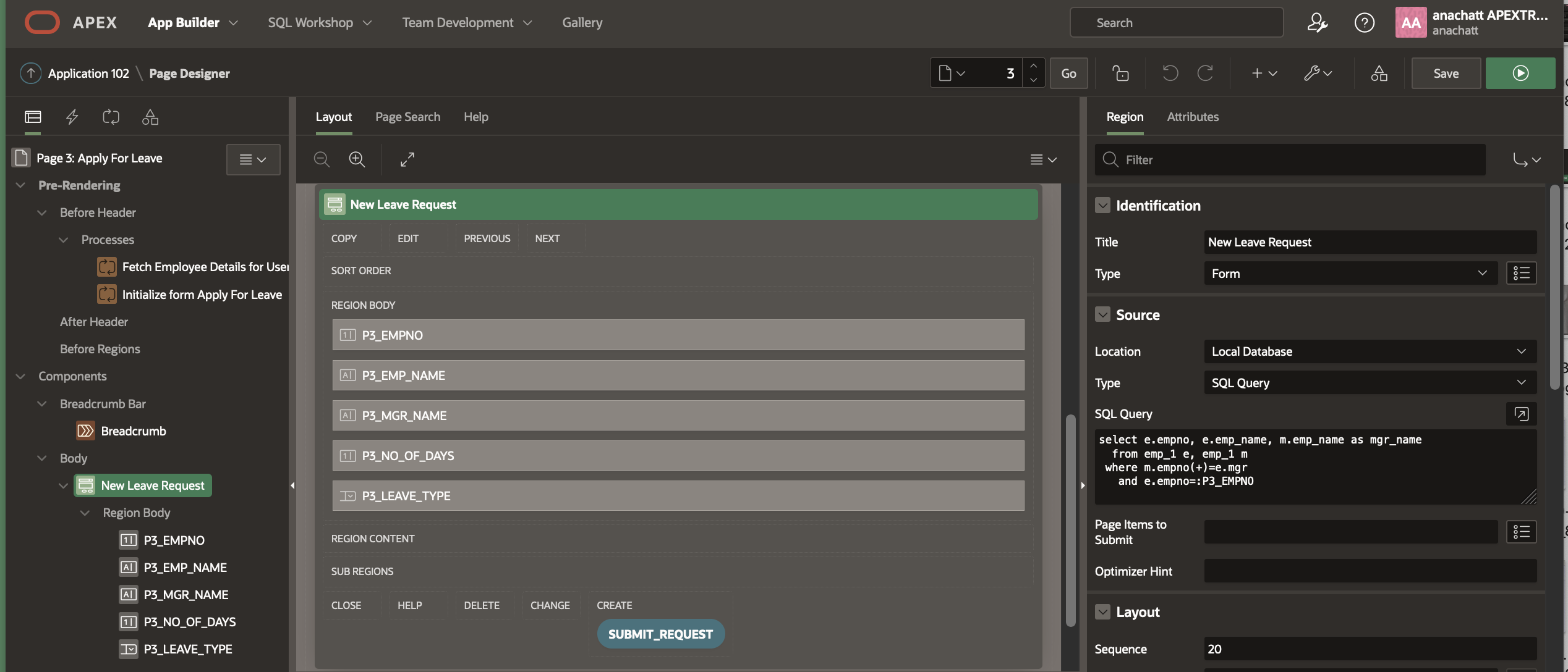

In the Page Designer, create a new Form and name it New Leave Request. Choose SQL Query as the source and enter the following in the query region:
select e.empno, e.emp_name, m.emp_name as mgr_name from emp_1 e, emp_1 m where m.empno(+)=e.mgr and e.empno=:P3_EMPNO
You will find the following page items already created: P3_EMPNO, P3_EMP_NAME and P3_MGR_NAME.

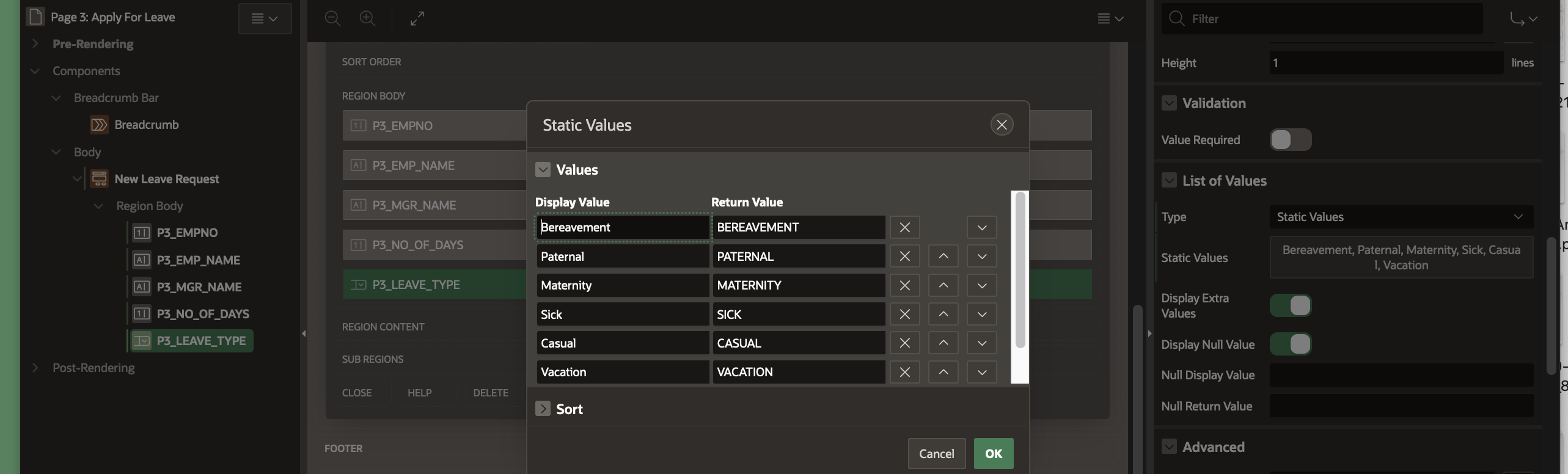

Add 2 new page items P3_NO_OF_DAYS and P3_LEAVE_TYPE.
Set the type for P3_LEAVE_TYPE to Select List and define a list of static values as following:
In the Pre-Rendering section add a New Process above the Initialize form Apply For Leave and name it “Fetch Employee Details for User”. Set the type to Execute Code and add the following in the PL/SQL Code editor
select empno into :P3_EMPNO from emp_1 where emp_name=:APP_USER;

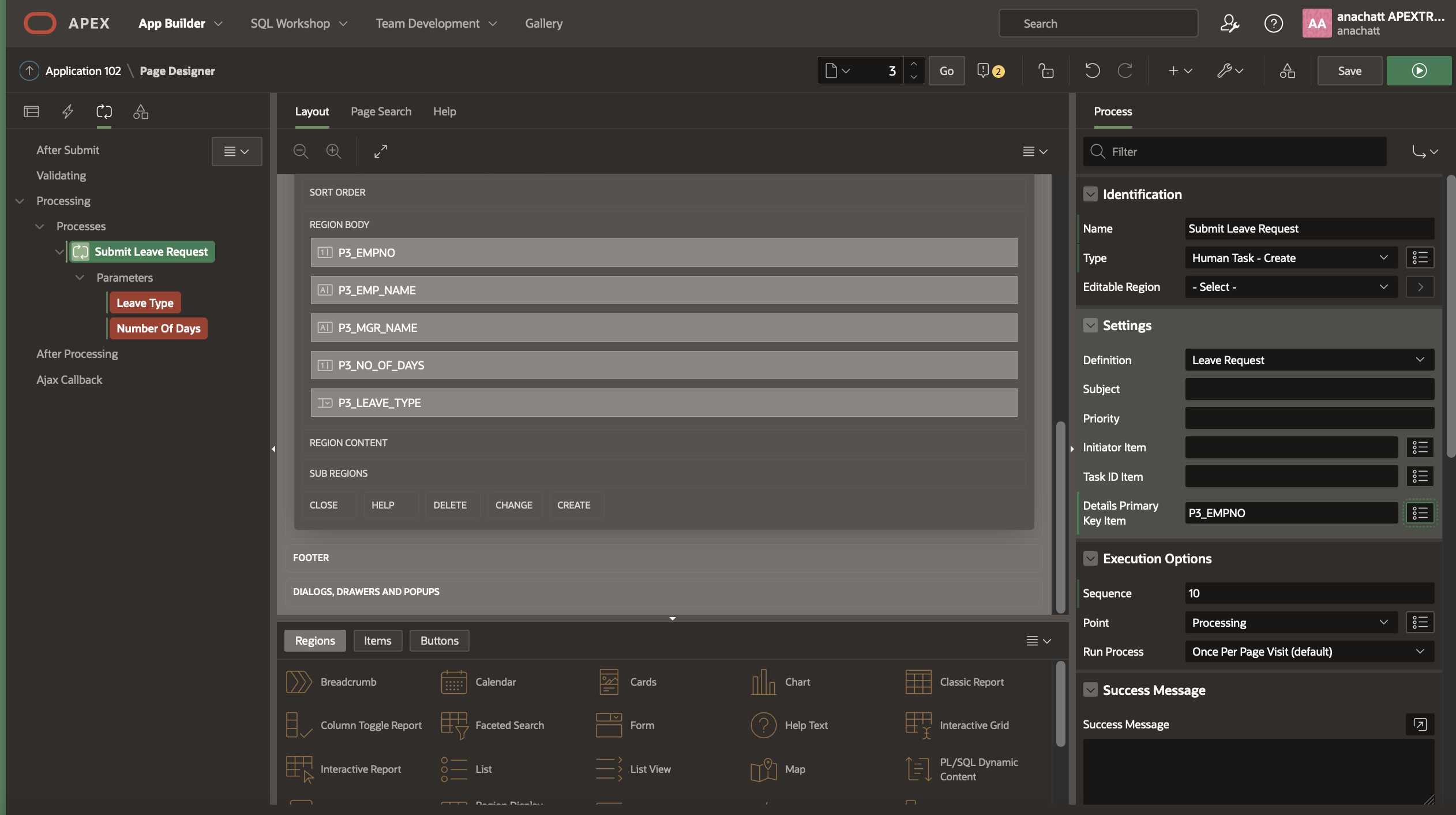

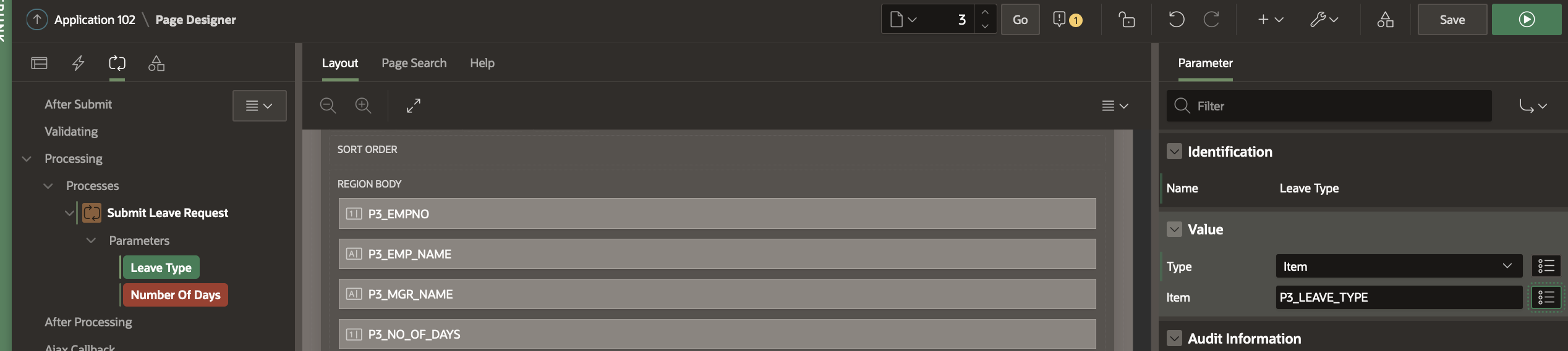

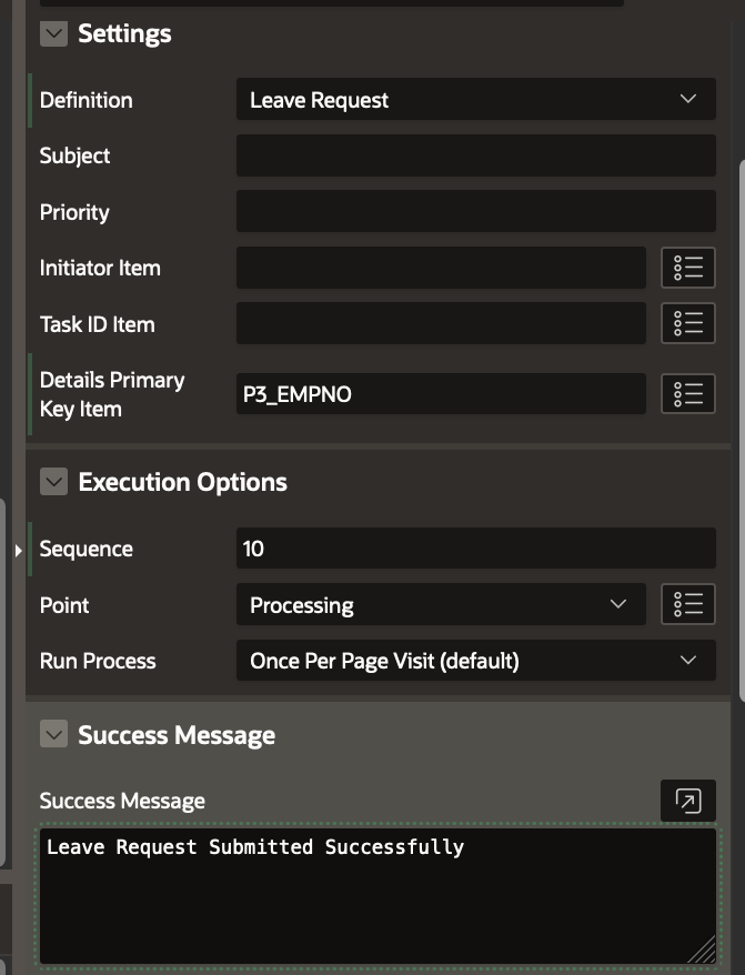

Navigate to the Processing Tab and Create a new Page Process of type Human Task – Create. Name the process “Submit Leave Request”.
Under the Settings, Click the Task Definition and select “Leave Request” from the drop down.
Set the Details Primary Key Item as P3_EMP_NO. This is how the task in your approvals component gets tied to the employee system of records.
Add a Success Message which will show up once the Request is submitted.

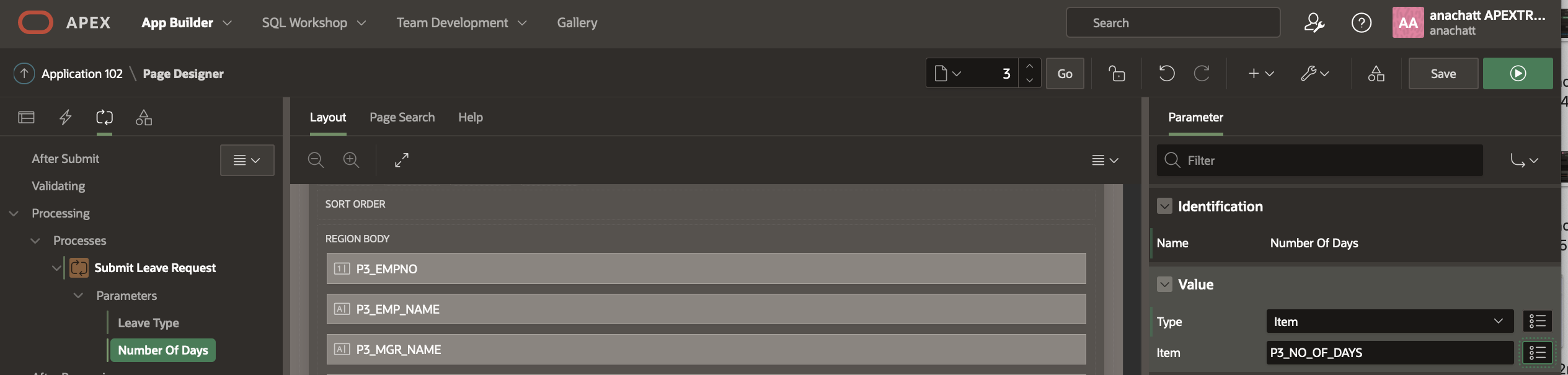

You will notice Leave Type and Number Of Days under the Parameters on the Left pane to be highlighted in RED. This is because, these were defined as required Parameters in the Leave Request Task Definition. Click on each parameter and set it to the corresponding page item (P3_NO_OF_DAYS and P3_LEAVE_TYPE) you had created earlier.

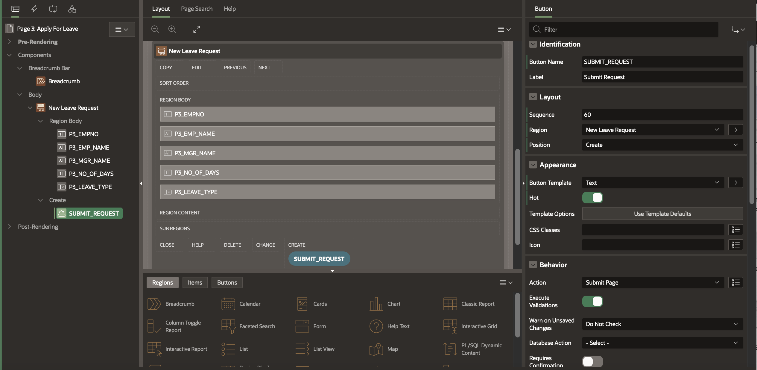

Click Save and navigate back to the Rendering Section. Create a new Button and name it Submit Request. Go back to the Submit Leave Request Process and under server side conditions, select “When Button Pressed” -Submit Request.
Your Apply For Leave Page is now complete!

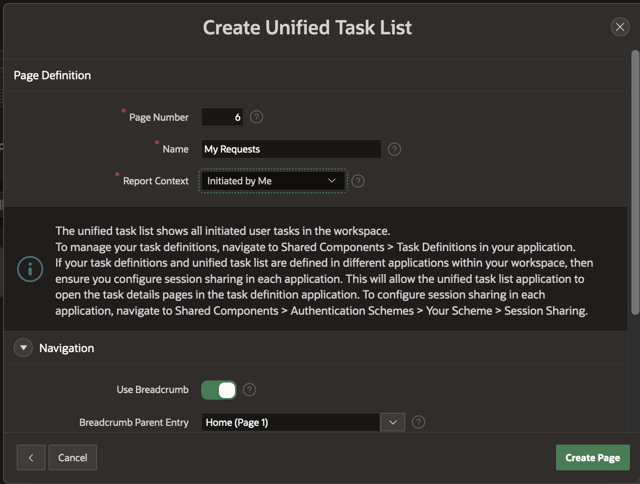

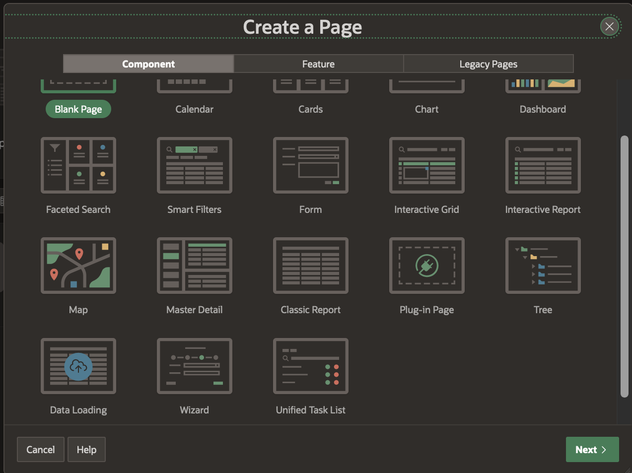

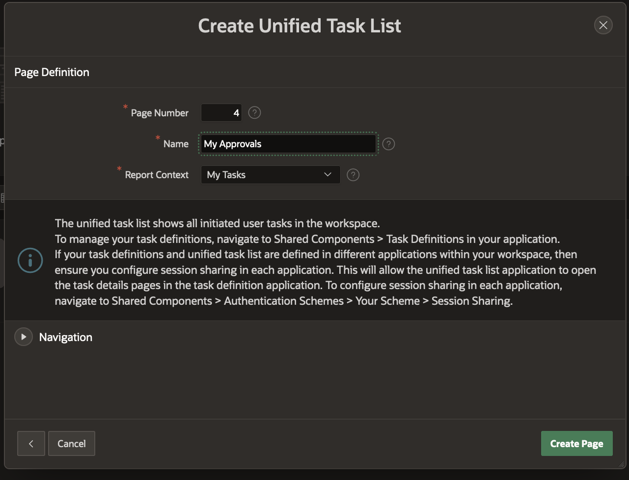

Click on the Create Page wizard and select Unified Task List from the Components section . Name the Page “My Approvals” and select Report Context as “My Tasks”. Similarly create another Unified Task List, name it “My Requests” and set the Report Context as “Initiated By Me”.
NOTE: Unified task list page can be customized in the Page Designer. But for this example we will use the one generated out of the box.

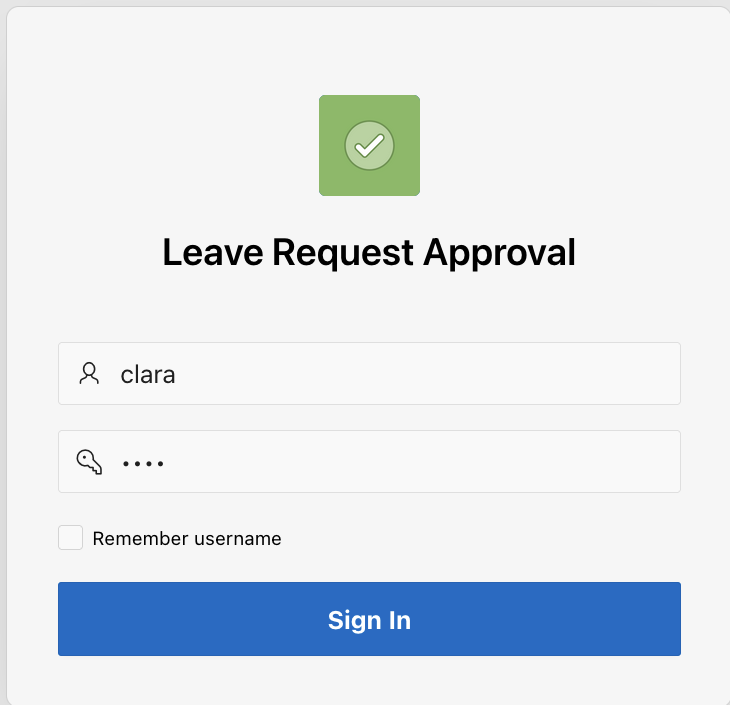

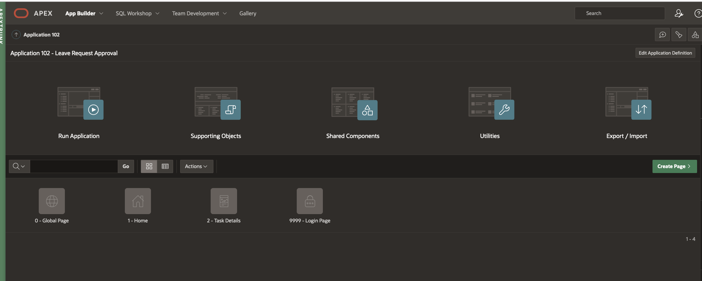

Select the Leave Request Approvals in the App Builder and click on Run Application. The Application is launched on a separate tab. Log in as CLARA and navigate to the Apply For Leave page. The Employee ID, Name and Manager fields will be pre-populated. Enter values for the No. Of Days and Leave Type as shown below. Hit “Submit Request” after that.

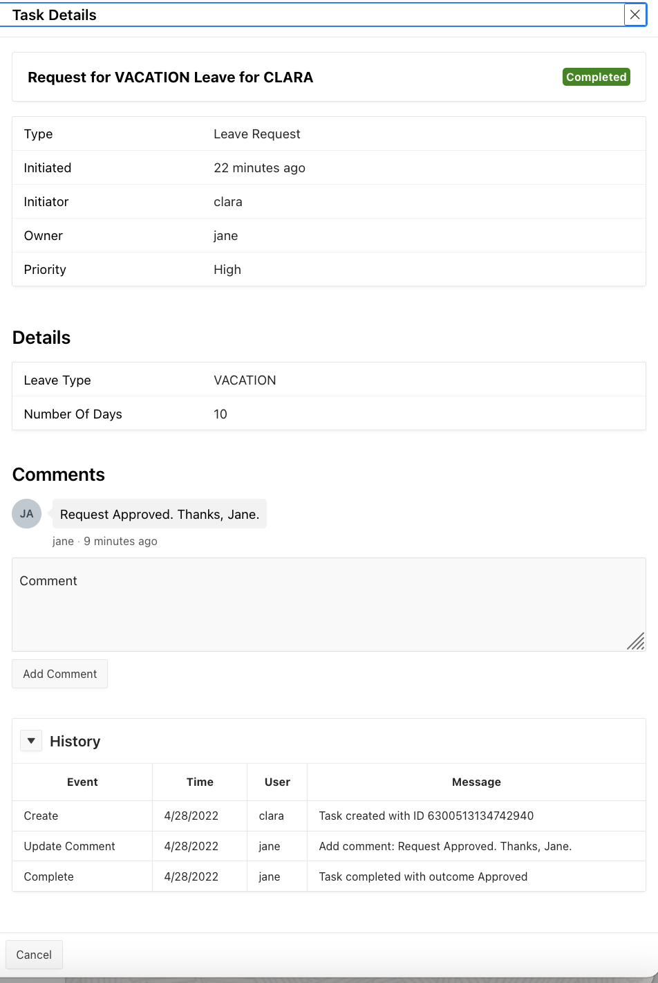

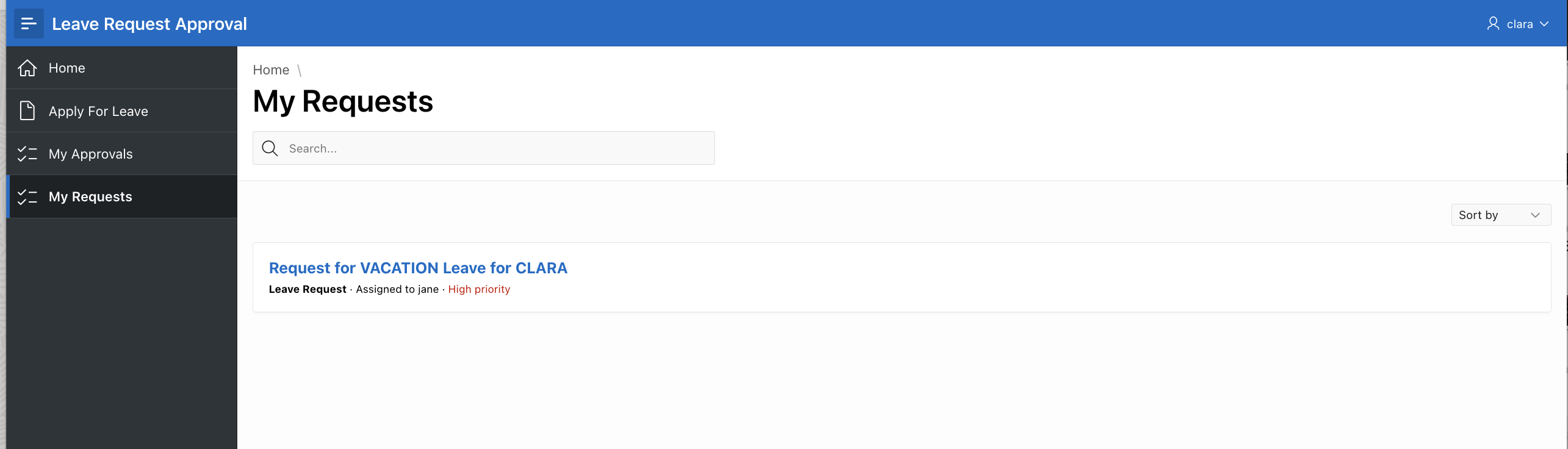

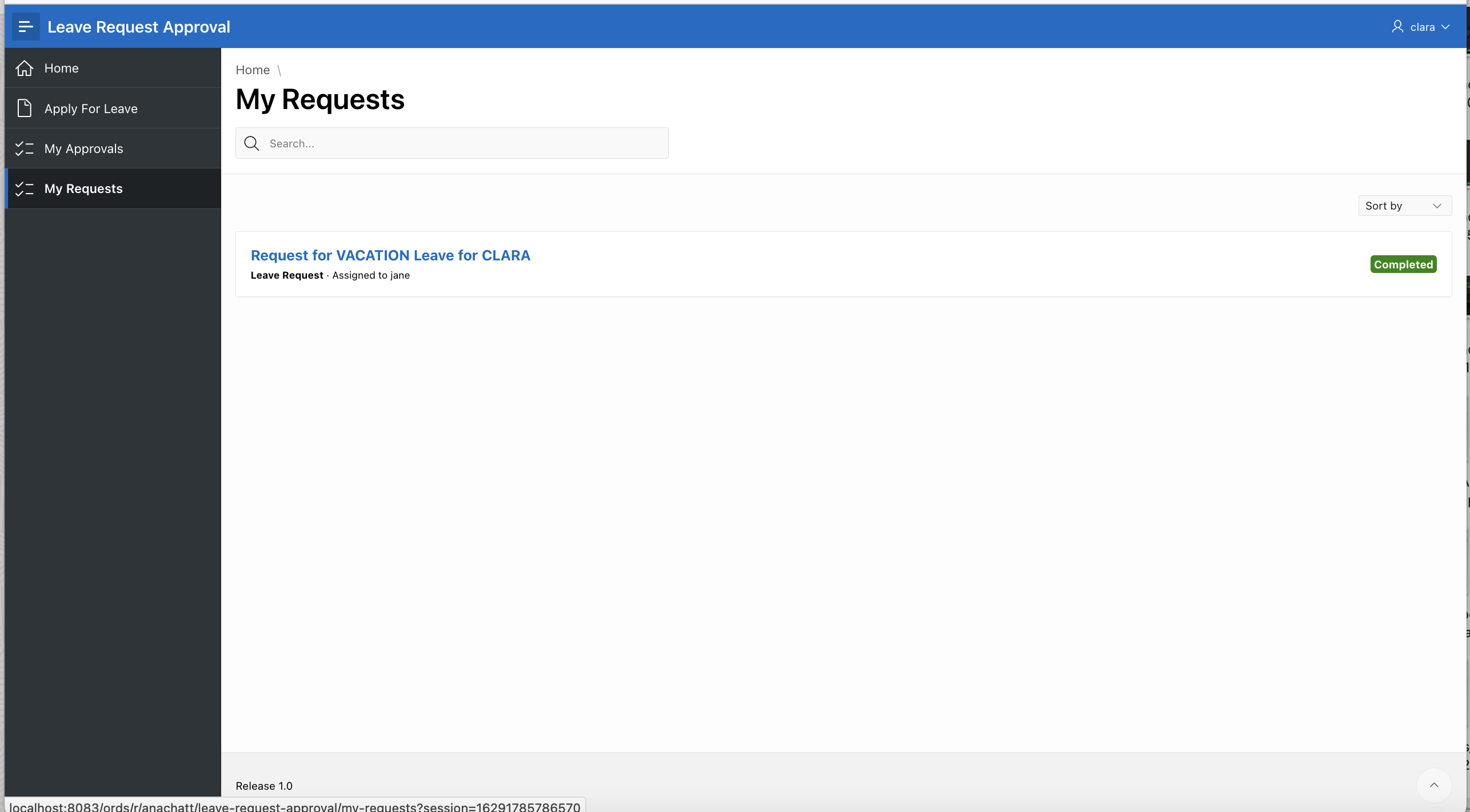

You can navigate to the My Requests Page to view the task that got created. Note how the substitution strings for LEAVE_TYPE and EMP_NAME have been replaced in the Task subject!

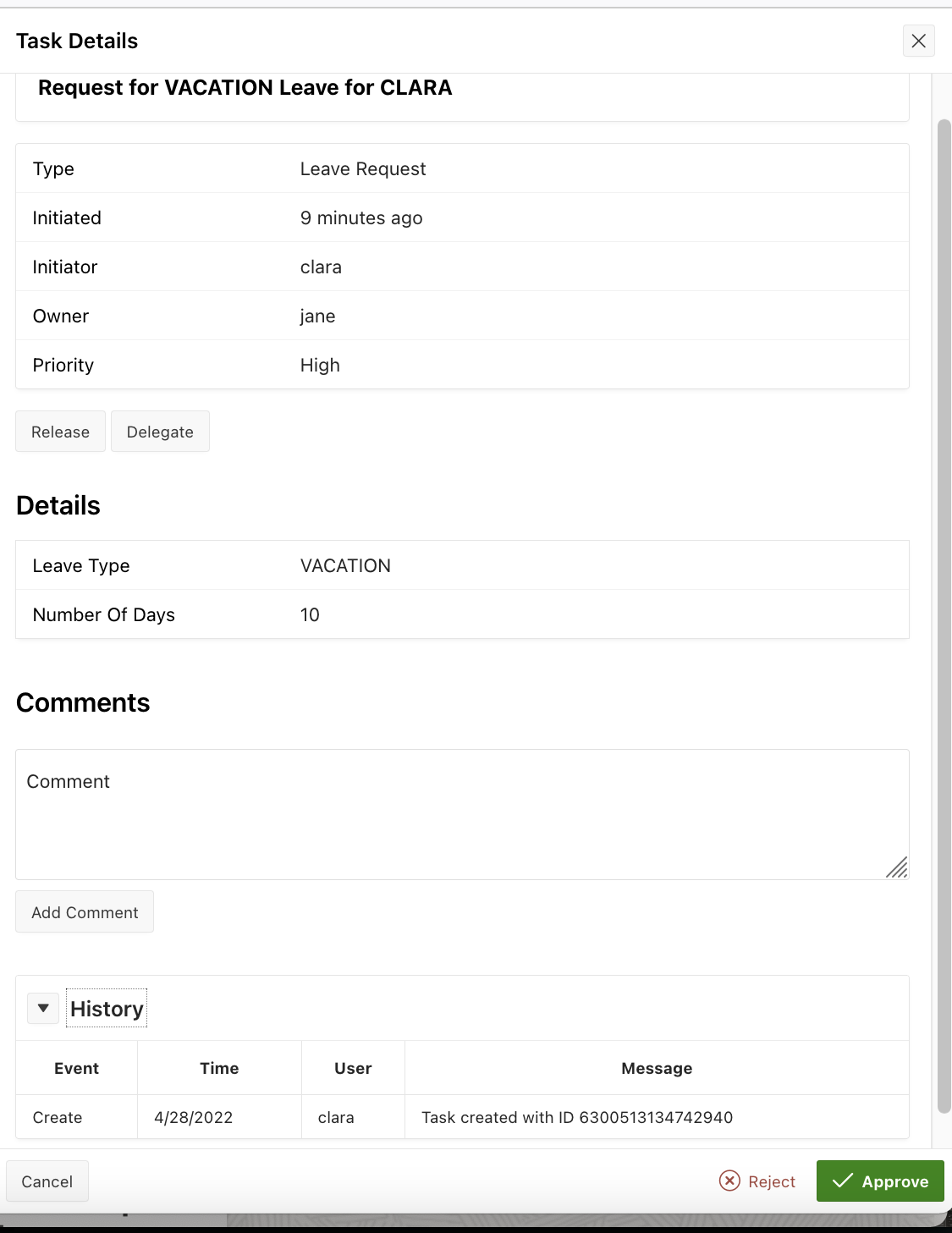

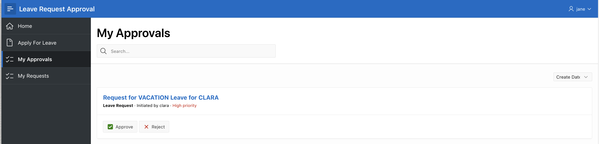

Log out and Log back in as Jane who is the manager of Clara. Navigate to the “My Approvals” page . You will find Clara’s request.

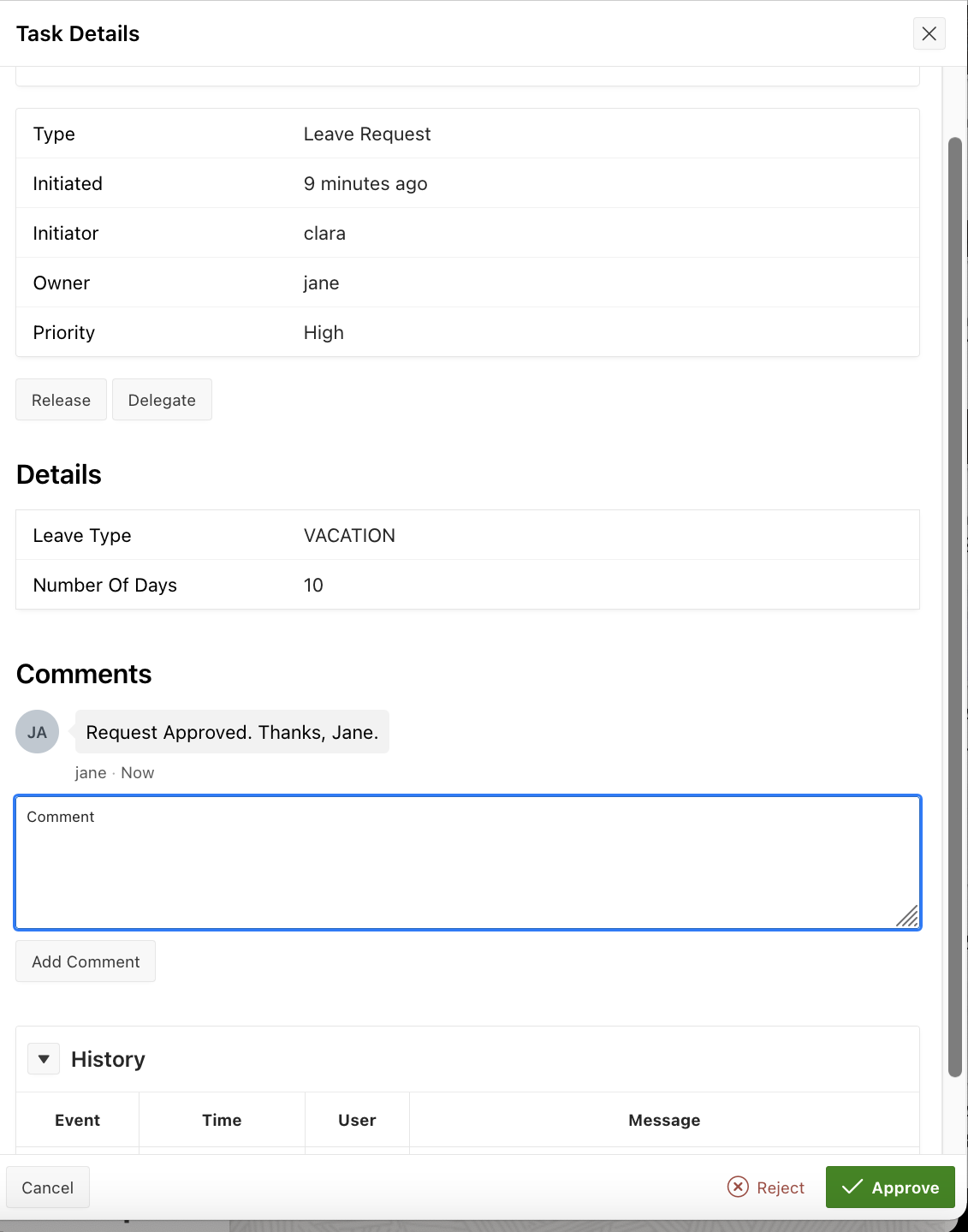

Jane can Approve or Reject the request using the buttons shown above. But, Jane can also choose the click on the task to view the details page which pops up.
NOTE: The History section shows the progress of the task so far. The Details section shows the values of the task parameters that were configured in the Leave Request Task Definition
Let’s Add a Comment from Jane in the Comments section saying that the request is approved. And then click on Approve to approve the task.
Once the task is Approved, it disappears from Jane’s My Approvals page. Log out and Log back in as Clara and navigate to the My Requests page. The task is shown to be in Completed state.
Clicking on the task, opens the Details Page which shows the comments and history with the outcome of the task i.e Approved.

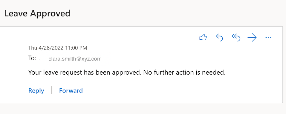

Clara also receives an email saying that her leave got approved.
