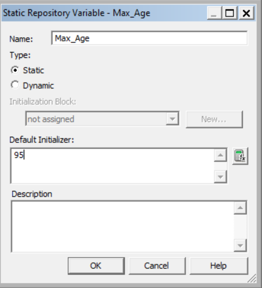

The value of a static repository variable is initialized inside the variable dialog interface of Oracle Analytics Cloud Admintool. The value then persists and does not change until an administrator decides to change it.
For example, you can define a static variable called Max_Age and assign a value to it.
https://1.bp.blogspot.com/-3JkX3OxRPP8/XpanEYMxhEI/AAAAAAAAFNA/xm3vusnPeYc3JbdBNx6xCxPFFhuVUd5twCLcBGAsYHQ/s320/admin1.PNG

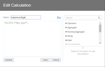

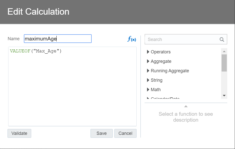

The syntax to access a static repository variable from any logical calculation or filter is as follows :
VALUEOF(“<name_of_static_variable>”). In the case of the example it will be something like :
https://1.bp.blogspot.com/-puvBiN4cDXI/Xpanr3PhkkI/AAAAAAAAFNI/WrHED2h2pOsgWXpuAPXLmpAou-si9IDmQCLcBGAsYHQ/s400/admin2.PNG

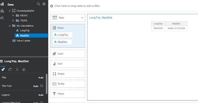

Simply save the RPD, upload it on to an Oracle Analytics Cloud instance and bring the subject area into a project or Analysis. The syntax for accessing the dynamic repository variables is the same as for a static repository variables.
VALUEOF(“<name_of_dynamic_repo_variable>”)
Create 2 custom calculations for the 2 dynamic repo variables with the following syntax:
VALUEOF(“Longest Trip”)
VALUEOF(“Maximum_Distance”)
and display it on a DV canvas.
https://1.bp.blogspot.com/-kQFAlqbe1dE/Xpazg6VoydI/AAAAAAAAFNo/s3qC6mZSP18d0cX9mJh6ikTjNt6k7YbPwCLcBGAsYHQ/s640/admin5.PNG

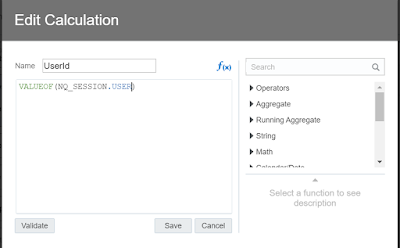

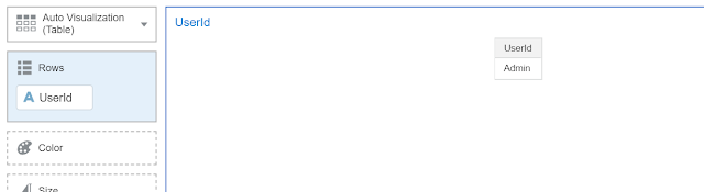

Let us consider the system session variable USER which holds the value the user enters as his or her logon name. The syntax for accessing the System session variable in DV is as follow.
VALUEOF(“NQ_SESSION.<name_of_system_session_variable>”)
https://1.bp.blogspot.com/-WWzLVuGRf9I/Xpa3KtgsERI/AAAAAAAAFN0/jiOKK60meoUDVfgmZSfDUqoXiqfEmQ-qACLcBGAsYHQ/s400/admin6.PNG
This is similar to syntax for repository variables but with prefacing their names with NQ_SESSION.
This syntax can be used as an argument for in any logical calculations, or custom filters. When dragging the custom calculation on to a DV canvas, the value of system session variable is seen.
https://1.bp.blogspot.com/-HJ_fJqS-3O8/Xpa3p3Ks7qI/AAAAAAAAFOA/y5gy4QWjJVoTwX_jUGtUOu_k46HMK2VlwCLcBGAsYHQ/s640/admin7.PNG

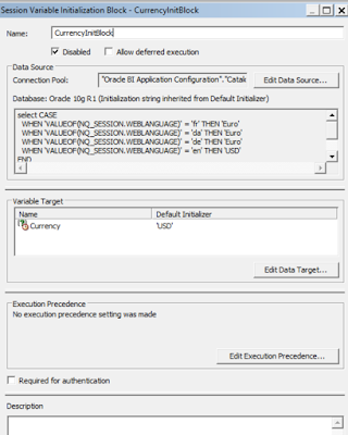

To define Non-System Session Variables, simply go to the variable manager in the admin tool and click on Action -> New -> Session -> Initialization block and replicate the one shown in the below diagram.
https://1.bp.blogspot.com/-x_ui85Rp9Y4/XsMEcNbjDrI/AAAAAAAAFZk/E3eQh1IiQG0eY4GIXmKSTVPd7_Dc03RSwCLcBGAsYHQ/s400/NSSessionVar.PNG

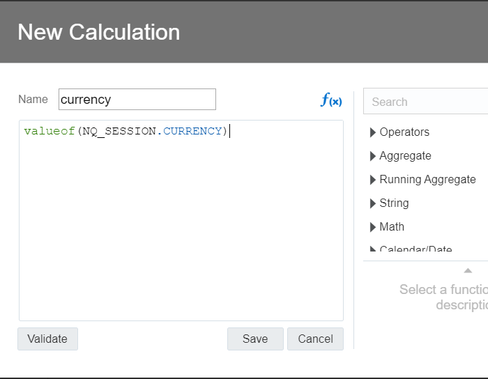

Now a non system session variable called Currency is created and the user can now access them in DV using the same syntax of system session variables. VALUEOF(“NQ_SESSION.<name_of_non-system_session_variable>”)
https://1.bp.blogspot.com/-SIOn272W0NU/XsME4_4_2LI/AAAAAAAAFZs/FZqFJnqOQLYviw-W_4ehRDFYLccj1BgVgCLcBGAsYHQ/s400/NSSessionVar1.PNG
Drag and drop this calculation on a canvas to see the value of the currency variable set.
