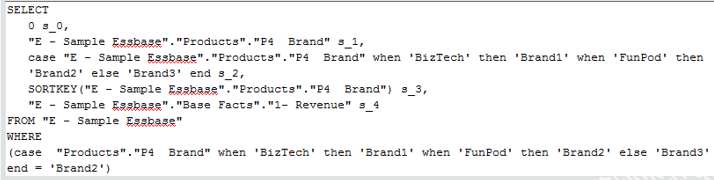

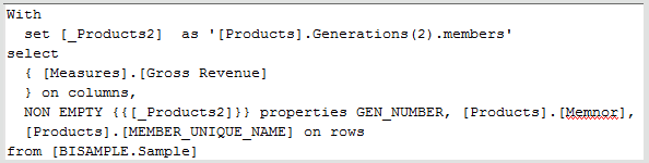

Scenario – Dashboard Prompt:
A developer applies a Case statement to rename brands, and a dashboard prompt allows users to select the brand:
As the Case statement is not supported in MDX, the filter on ‘Brand2’ can’t be applied in the MDX query. All brands are selected, and this is not optimized.
In this scenario, we recommend you remove the Case statement and rename members in the database or create aliases.
