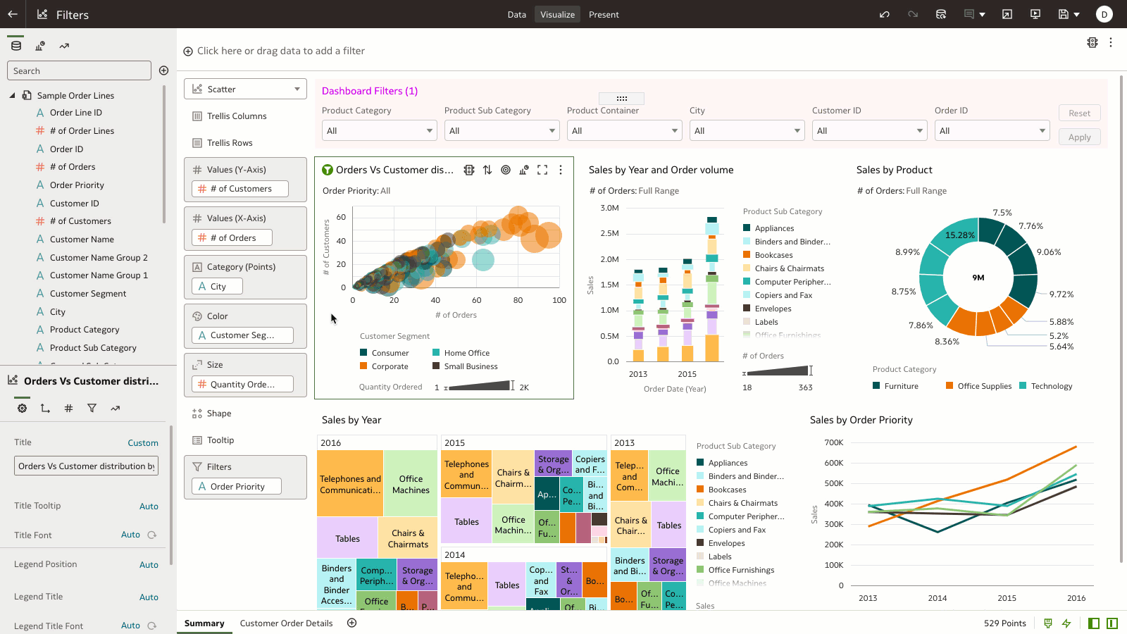

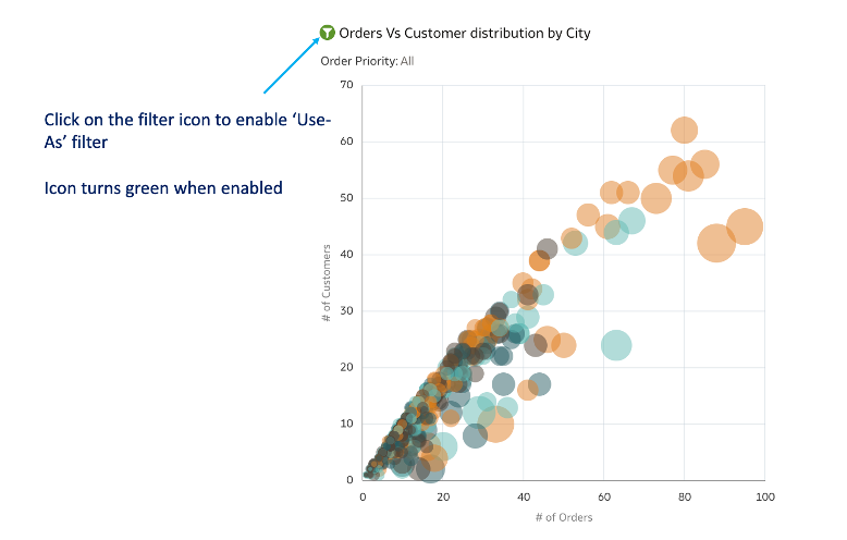

Use a visualization to filter data

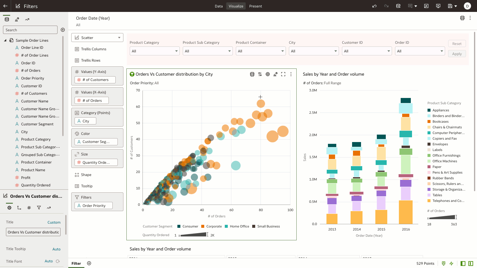

The “Use As” filter is an extremely powerful capability when you want to cascade filter values and pass the context to other visualizations on the canvas. To use a visualization as a filter, simply click the filter icon on the visualization, as shown in this example.
In the following example, selecting a mark on the scatter plot (enabled for the “Use As” filter) passes the selected data context values to other visualizations on the canvas and filters the respective data.
You can specify any visualization in the canvas as “Use As” and very easily filter to the data that you want to double-click to get to insights quickly.

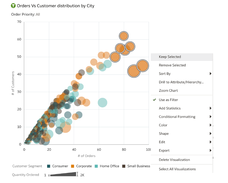

Filter the data that you want focus on (Keep) or Hide
You can easily show or hide certain data in visualizations by using the Keep Selected / Remove Selected option. This option is helpful when you want to focus on certain data (Keep Selected) or to remove noise in the data (Remove Selected).
In the following example, “brushing” is enabled, which allows you to select a series of data and keep the selected data on the visualization. When you “keep” certain data selected in the visualization, a expression filter is added to the visualization filter scope (as the example show). You can copy the expression filter and add it as an expression filter on the Workbook filter bar or in a calculation.

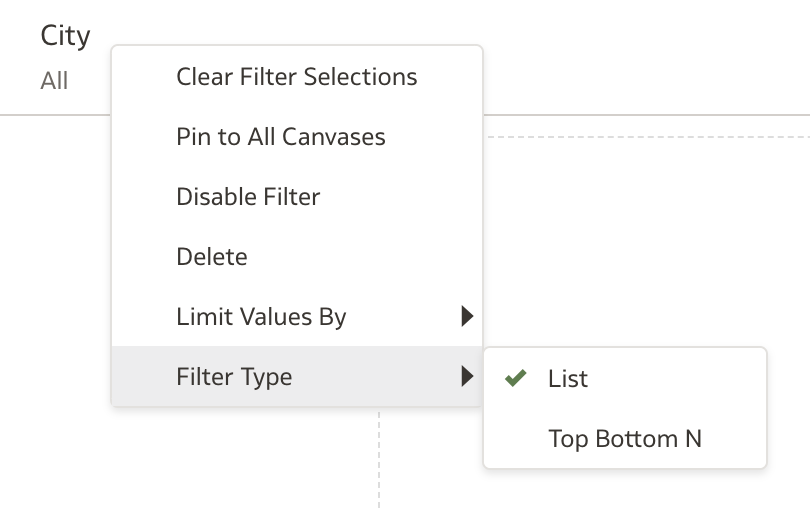

Finding the Top or Bottom N of the data
When working with dense data, you might want to see the Top or Bottom grouping of that data. Top Bottom N is an option available for each filter added to the filter scope. On a workbook or visualization filter, find the Top Bottom N operation under the Filter menu options.

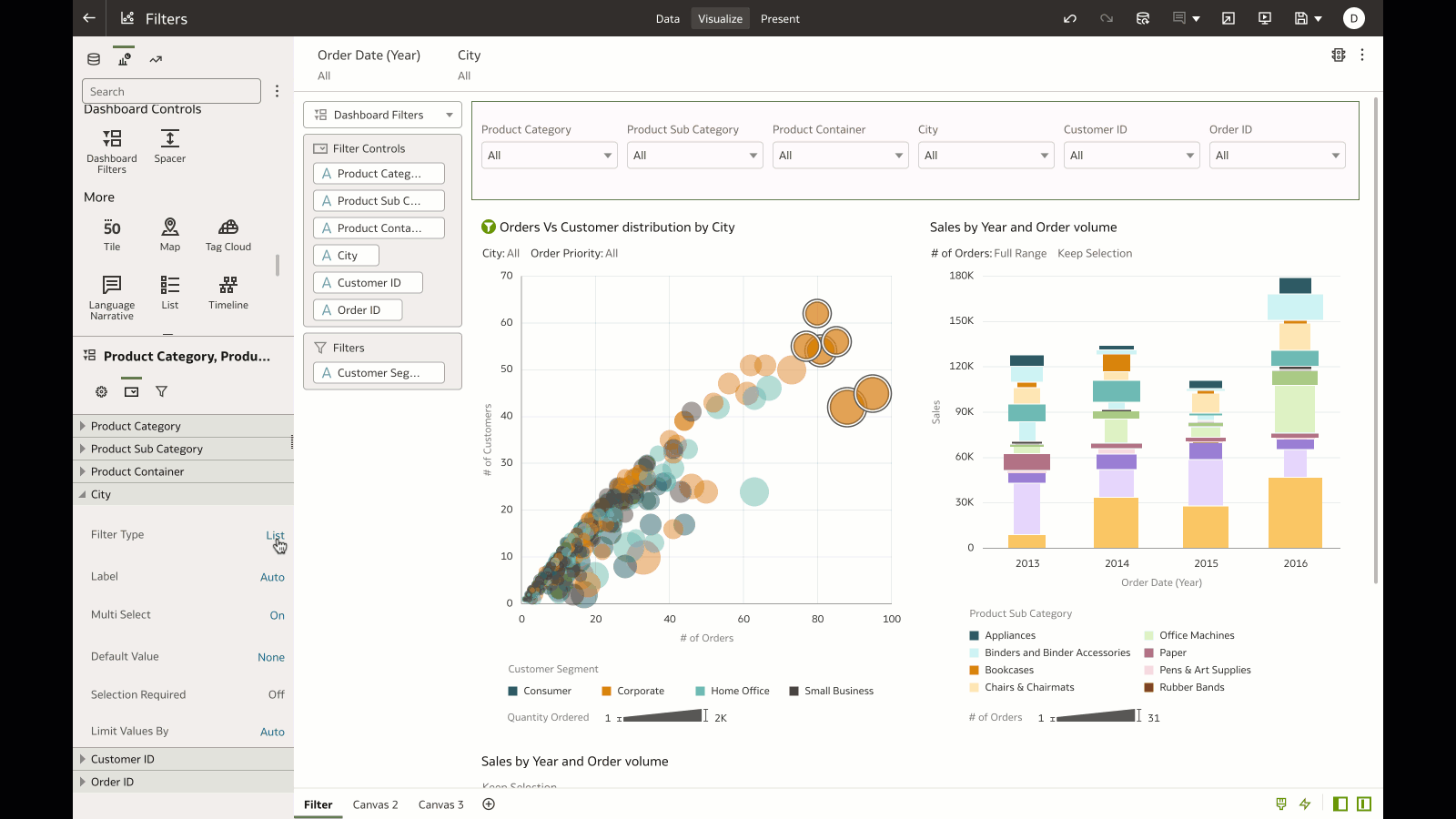

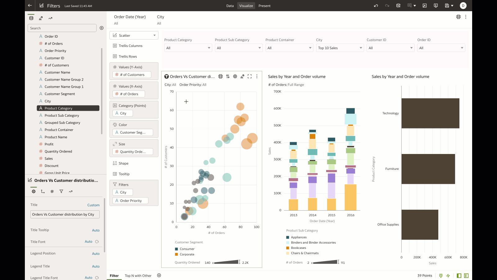

In the following example, the City filter is set to show the Top 10 Cities by Revenue. For filters on the Dashboard Filter bar, you find the Top Bottom N operation on the Property panel of the Dashboard Filter visualization, under the filter control tab.
