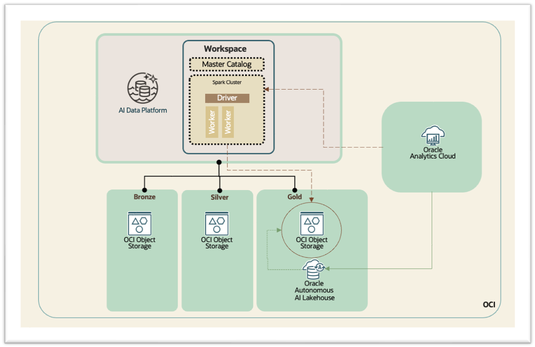

Both paths let business users create datasets and workbooks in OAC. The difference is the service that resolves the query and the governed objects it exposes.
OAC query paths to curated data
Figure 1 OAC query paths to curated data
In the AI Data Platform path, OAC connects to the selected AI Data Platform compute resource and catalog. This is useful when the gold layer is governed and prepared in AI Data Platform and Spark is the intended execution engine. Oracle’s current AI Data Platform documentation describes an OAC native connection flow based on an OCI API key and an Oracle Analytics connection configuration file.

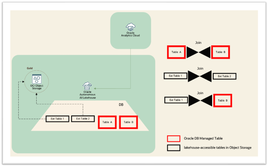

In the Autonomous AI Lakehouse path, OAC connects to the lakehouse as a database source. This is useful when curated data is already represented by database objects, when the analysis needs SQL joins with database-resident data, or when the database/lakehouse query engine is the intended serving layer. Autonomous AI Lakehouse can work with open data in object storage, including Iceberg-based data, while providing SQL access through the database.
A more complete picture of the two paths is reported in the following image.
Architecture 2-path of Data accessibility
Figure 2 Architecture 2-path of Data accessibility

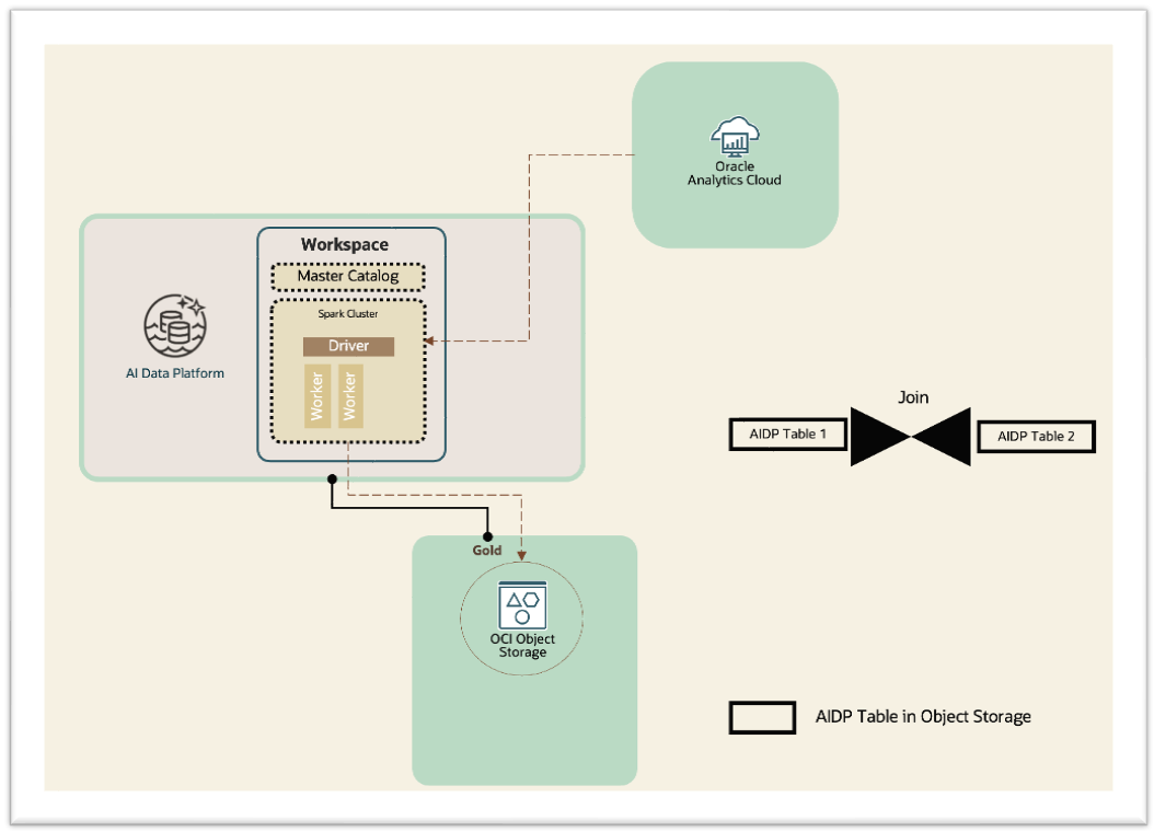

Path 1: Query an AI Data Platform catalog through Spark
Use this path when the analytics-ready data product is resident in Object Storage and the team wants OAC to work against that Oracle AI Data Platform catalog through the selected compute cluster. It keeps the BI connection close to the Gold Layer data in Object Storage.
AI DP access path
Figure 3 AI DP access path
Connect OAC to AI Data Platform
To connect Oracle Analytics Cloud (OAC) to Oracle AI Data Platform, follow the steps in Connect to AI Data Platform.
Path 2: Query through Autonomous AI Lakehouse
Use this path when Autonomous AI Lakehouse is the serving layer for the Gold data. For example, OAC might need to
  • Query curated database tables stored in Autonomous AI Lakehouse Storage
  • Query curated lakehouse-accessible tables in Object Storage
  • Execute the joins and aggregations of gold layer table in Autonomous AI Lakehouse Storage and Object Storage
This route isn’t an Object Storage file connection. OAC connects to Autonomous AI Lakehouse; the lakehouse is responsible for resolving the database objects and any configured lakehouse-accessible data. That distinction matters for governance, SQL design, and performance expectations.
Autonomous AI Lakehouse access path
Figure 4 Autonomous AI Lakehouse access path
Connect OAC to Autonomous AI Lakehouse
To connect Oracle Analytics Cloud (OAC) to Oracle Autonomous AI Lakehouse, follow the steps in Oracle’s connection tutorial.

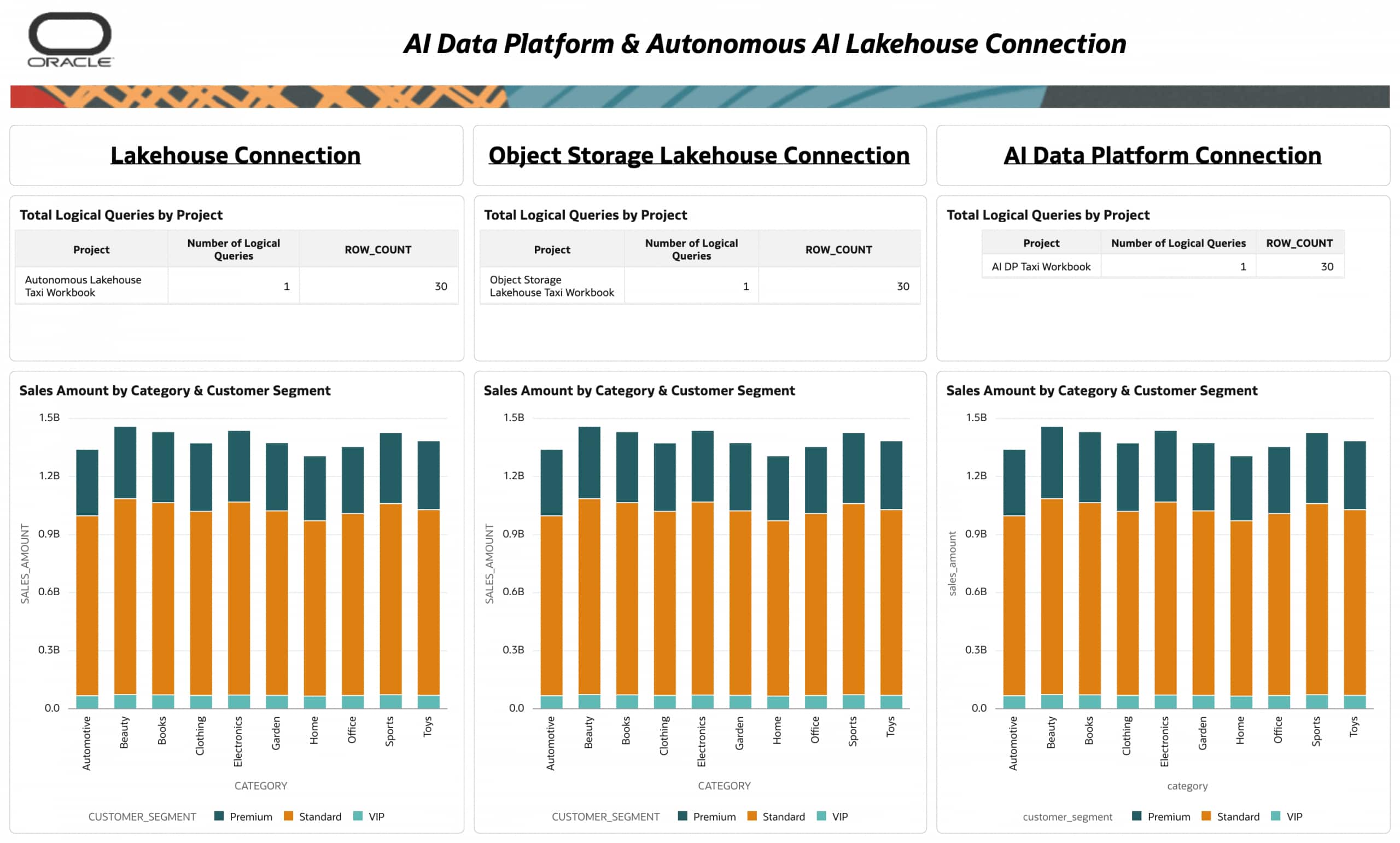

How the paths behave in a workbook
An OAC report can look identical while the execution path is very different. For an AI Data Platform connection, the query is issued through the selected AI Data Platform compute and catalog. For an Autonomous AI Lakehouse connection, the database/lakehouse layer resolves the query against database-resident and configured lakehouse-accessible data.
The image below shows a single dashboard containing three reports, each built using one of the query strategies described in this article:
  • Autonomous AI Lakehouse connection: A report built on Autonomous AI Lakehouse using database-managed tables.
  • Autonomous AI Lakehouse connection with Object Storage data: A report built on Autonomous AI Lakehouse that joins lakehouse-accessible data in OCI Object Storage.
  • Oracle AI Data Platform connection: A report built on curated data in an AI Data Platform catalog, queried through a Spark compute cluster.
Three visuals: the first two use Autonomous AI Lakehouse—one with an external table and the other with a managed table—while the third uses AI DP
Figure 5 Three visuals: the first two use Autonomous AI Lakehouse—one with an external table and the other with a managed table—while the third uses AI DP
The three approaches described above may exhibit different reporting performance because they use different execution architectures and optimization techniques. Elapsed time and overall performance can also vary based on file format, partitioning, statistics, data volume, cache state, query complexity, service configuration, and concurrent workload.
