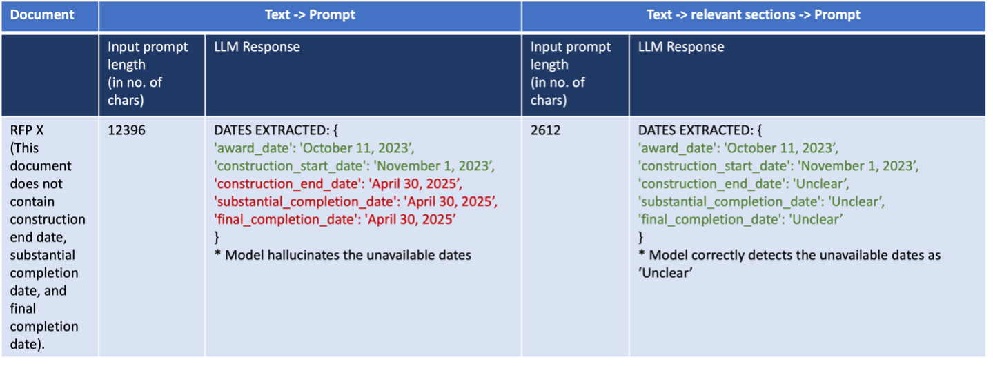

Let’s consider the task of extracting certain dates and deadlines from the RFP. You might face difficulties because dates are usually presented in diverse, nonstandard formats and might be referred to using different labels that mean the same thing. Regular entity extraction models, such as pretrained spaCy models, tend to be insufficient for this task. For our date extraction use case, partitioning the RFP document into sections and then pinpointing the sections with abundant date references, using rule-based entity detection and named entity recognition (NER), and passing only those relevant sections to the LLM results in a more precise date extraction from RFPs. By reducing the amount of context to what’s necessary, we can improve the LLM’s ability to pinpoint the most important data, enhancing its performance. This reduction is especially useful when dealing with large documents that can’t reasonably fit into the LLM’s context window. The following example illustrates this use case with correct responses in green and incorrect responses in red.
The output results of a document analyzed with RFP with correct and incorrect responses.

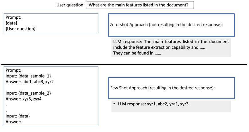

  • Zero-shot, one-shot, and few-shot learning: When you provide the LLM with examples, it helps improve its responses. Zero-shot learning refers to when you ask a question without providing any examples of prompt-completion pairs in the input to the LLM’s context window. In this case, the LLM answers based on its existing knowledge and understandings. On the other hand, one-shot learning requires you to give the LLM one example of a prompt-completion pair to provide more context. If you give the LLM multiple examples, this process is known as few-shot learning.
    The following example shows obtaining the wanted response using few-shot learning for extracting most relevant feature codes from a document:
The code, prompt, and output for a user question using both zero-shot and few-shot approaches.

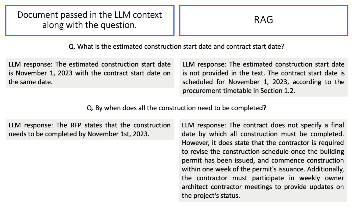

Let’s consider the example where an Oracle Construction and Engineering user wants to ask questions about the RFP document and receive relevant answers. Providing the entire document as input to the LLM alongside the user’s question, which might only be pertinent to one or more small sections of the document, can lead to less accurate results. The LLM might become confused by the excessive context.
Instead, by using RAG, we can create embeddings for each section of the document. Subsequently, we can ask the RAG model questions, and it can identify the sections of the document that are most relevant to the user’s query. This process ensures that only the most pertinent information is added to the model’s context, resulting in more accurate responses.
The following example shows the RFP document shared with the LLM in context with the question, yielding less accurate responses, versus the RAG approach the yielding the correct responses:
The response output from an LLM using the in-context document and the RAG method.
