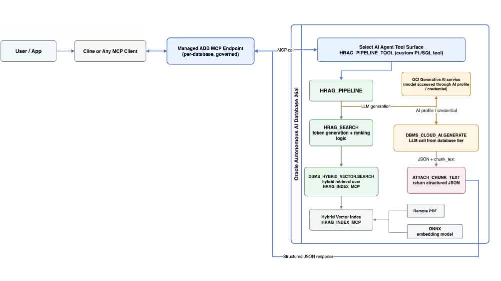

Diagram 1: Technical Architecture/Design
Architecture Diagram
Figure 1. Architecture overview of the in-database HRAG pipeline and managed MCP endpoint.

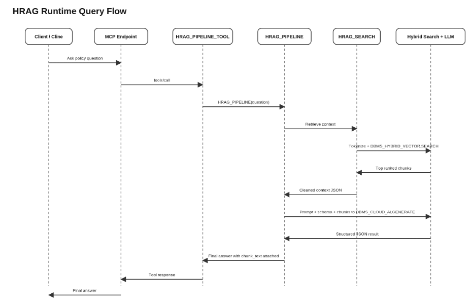

Diagram 2:Process Flow
Process Flow
Figure 2. Runtime query flow from MCP client request through hybrid retrieval and in-database LLM generation.
