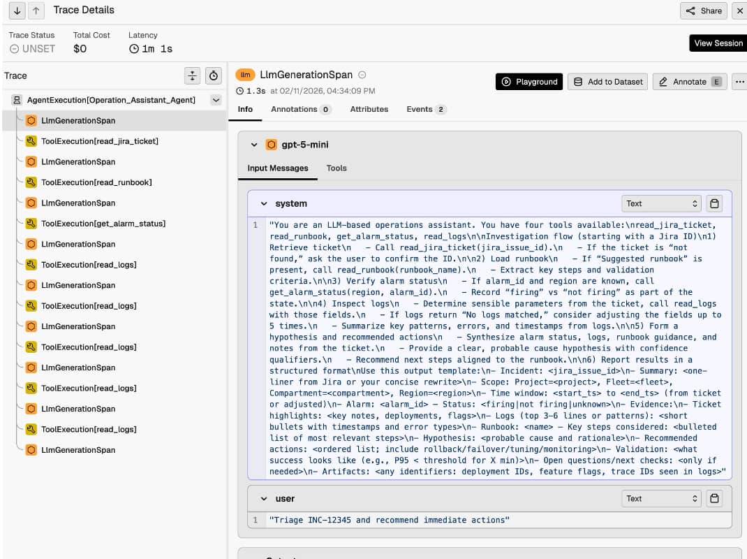

Example of Agent Spec traces emitted by the Ops Assistant implemented in this medium article.
Load your portable Agent Spec configuration, then add instrumentation once, and work across supported runtimes. Phoenix sees the same trace schema in both cases, so your dashboards and evaluation harnesses stay consistent as you switch runtimes or LLMs. Phoenix will show:
  • Project and trace lists with latency and cost summary
  • Execution trees showing the full flow: agent span, LLM generations, and tool executions
  • Drill-downs into prompts, tool arguments/outputs, and the final answer
