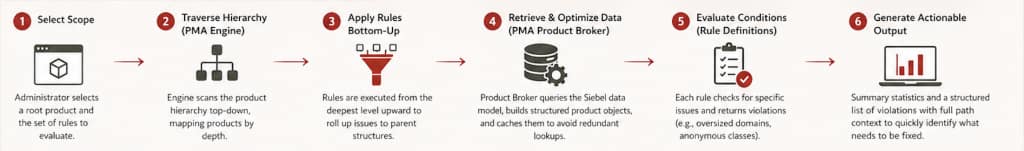

The complete analysis flow is straightforward:
  1. Select the scope. The administrator selects a root product and the set of rules to evaluate.
  2. Traverse the hierarchy (PMA Engine). The engine scans the product hierarchy top-down, mapping products by depth to understand the structure.
  3. Apply rules bottom-up. Rules are executed from the deepest level upward, allowing issues in child definitions to roll up and reveal their impact on parent structures.
  4. Retrieve and optimize data (PMA Product Broker). The Product Broker queries the Siebel data model, builds structured product objects, and caches them to avoid redundant lookups during traversal.
  5. Evaluate conditions (Rule Definitions). Each rule checks for specific issues, such as oversized domains, anonymous classes, or invalid relationships, and returns violations.
  6. Generate actionable output. The toolkit produces summary statistics and a structured list of violations with full path context, helping teams quickly identify what needs to be fixed.
