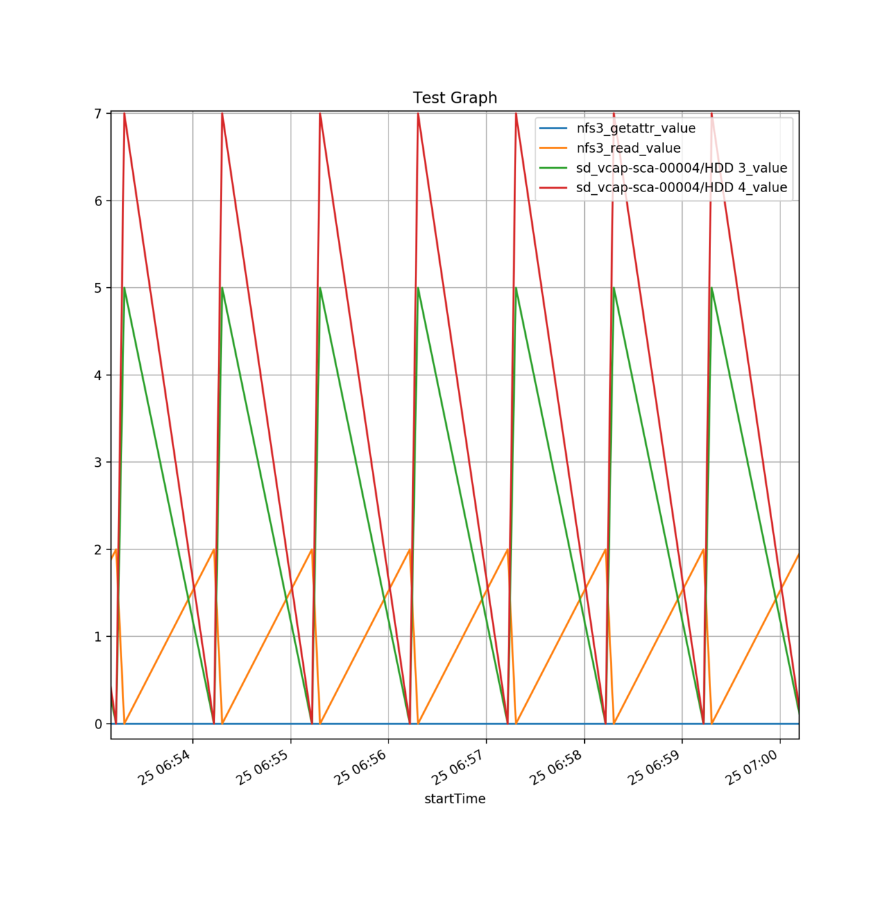

Sample Graph
I downloaded 24 hour worth of data for the number of commands for NFSv3 GETATTR and READ as well as disk IOPS for HDD3 and 4. Per-second data for 24 hours results in 86,400 data points for each dataset. Plotting all the data-points that I downloaded without any care made my line plot graph almost looks like a bar chart. So the sample below is a zoomed-in version for the 6-minute duration.
It’s a simple I/O graph and not the best graph for a sample, but you get an idea of how we can overlay the graphs.
