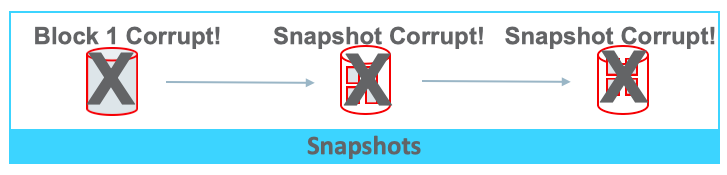

3. No database recovery validation. While snapshots are often used for test activities, to be useful for Oracle database recovery purposes, they need to be validated by RMAN on a periodic basis to ensure there are no issues in the backup storage and network layers. RMAN backup validation goes beyond storage-based validation by verifying database block data for inconsistencies and that all files required for successful recovery are present and accounted for. Because this in-depth validation requires database server processes, production resources are needed to read and validate backup files, which can induce non-trivial load for especially for large data volumes.
As discussed in Part 1, snapshots must first be restored as image copies and then cataloged by RMAN in order to run validation. Couple this process with the time and overhead to run validation and it’s easy to see that performing this activity on a continual basis would be a massive undertaking and practically infeasible for large database environments. This presents an additional risk when relying on snapshots for recovery, as one corrupt block in single snapshot can affect the restorability of successive snapshots that rely on that same block.  Inevitably, when a corruption is discovered during a restore, this becomes especially painful to resolve, prolonging database downtime and ultimately impacting business operations.

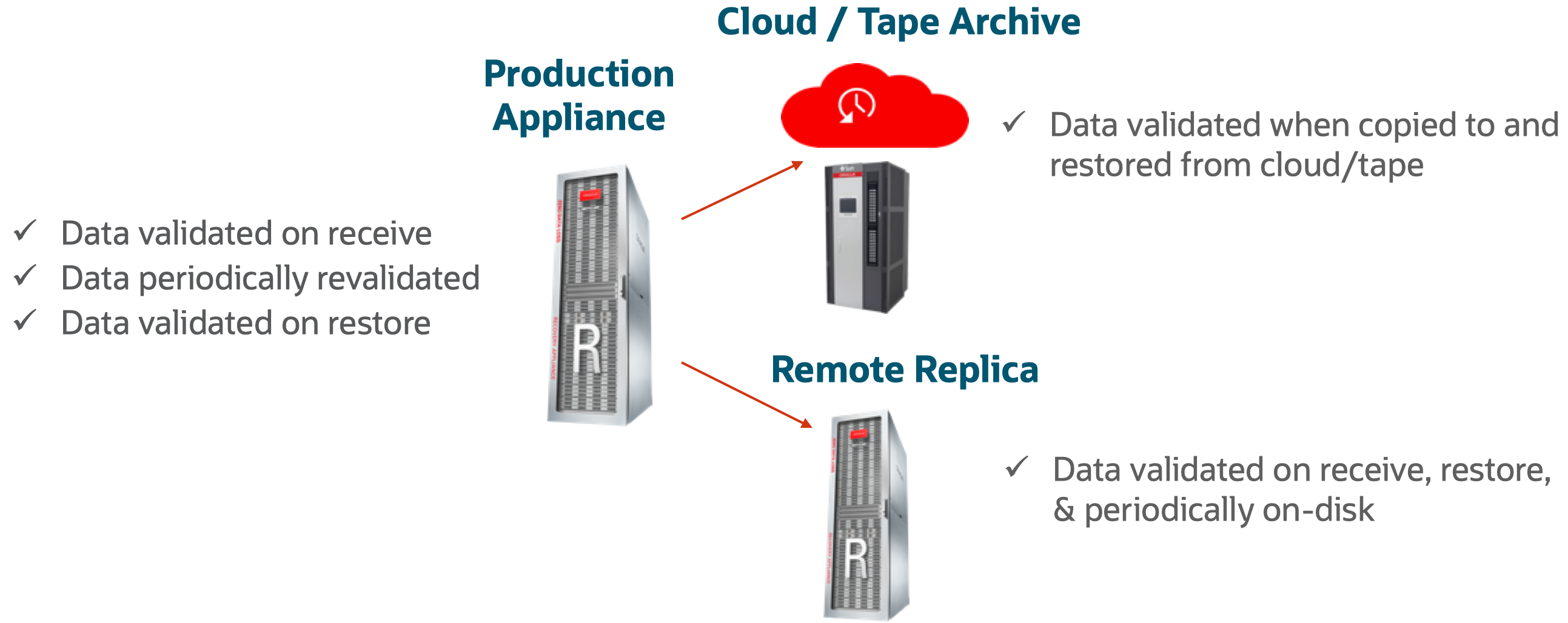

With Recovery Appliance, database backups sent, stored, and restored are continually validated for Oracle database recoverability. The Recovery Appliance leverages RMAN validation, but without impacting production database server resources. This unique capability ensures that potential recovery issues are caught early and resolved proactively, instead of being uncovered during a critical production restore operation. Additionally, through Enterprise Manager, validation and recoverability status can be monitored on per-database level, providing insights into the overall health of enterprise data that was never before possible.

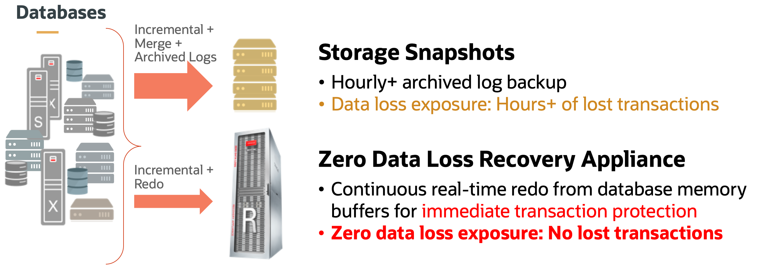

4. Inherent data loss. Snapshots represent fixed, point-in-time views of source data. This means that for database snapshots, complete recoverability is gated by:
  1. Last validated snapshot
  2. All archived log backups from the snapshot time forward being available
  3. Current archived and redo logs being available on production storage.
However, if the production storage system becomes unavailable because of an outage or a disaster, recovery point objective becomes gated by the timestamp of the last completed archived log backup, which could be many hours back. This means loss of critical business data from that time onward, a scenario that has a lasting adverse impact on any company.
With Recovery Appliance, all database transactions are recorded in real-time via an efficient transport of redo blocks, the same technology underpinning the industry-proven Oracle Data Guard. This means there are always current and validated archived log backups on the appliance ready for use in any database recovery operation. Simply put, hours or more of data loss risk are eliminated, in favor of immediate transaction protection with zero data loss exposure.
