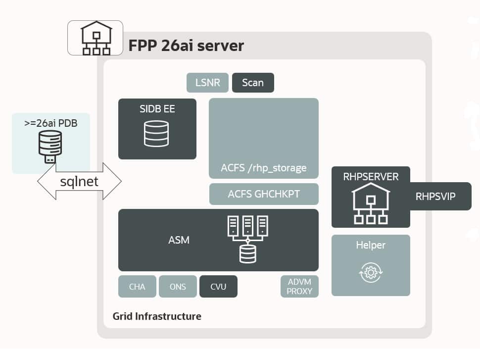

As you recall from the previous post, the FPP architecture looks as described in the picture below:
With the review of the architecture fresh in mind, we can start configuring the FPP Server on our already installed Grid Infrastructure. Any Real Application Clusters (RAC) installation ( single RAC node, multiple RAC nodes, or RAC One node) and an ACFS-compatible kernel will do.
