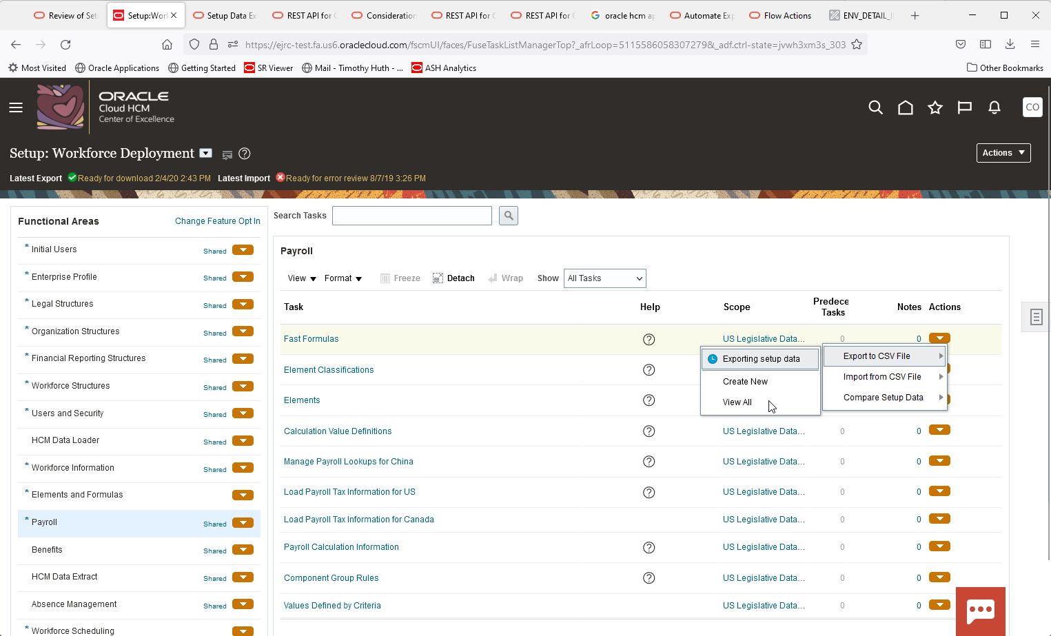

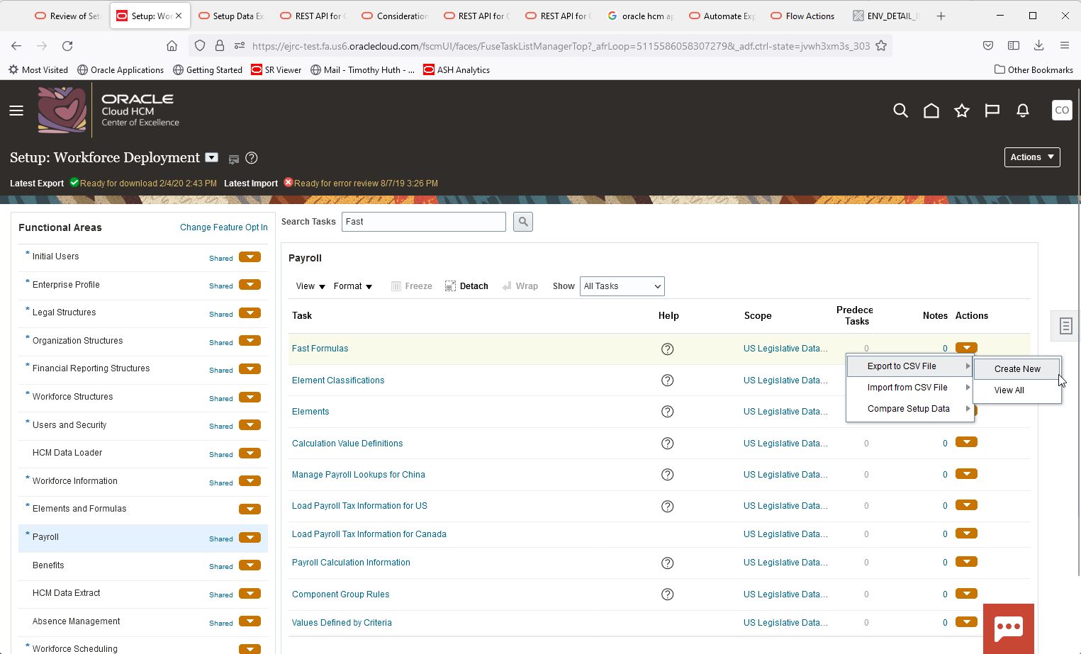

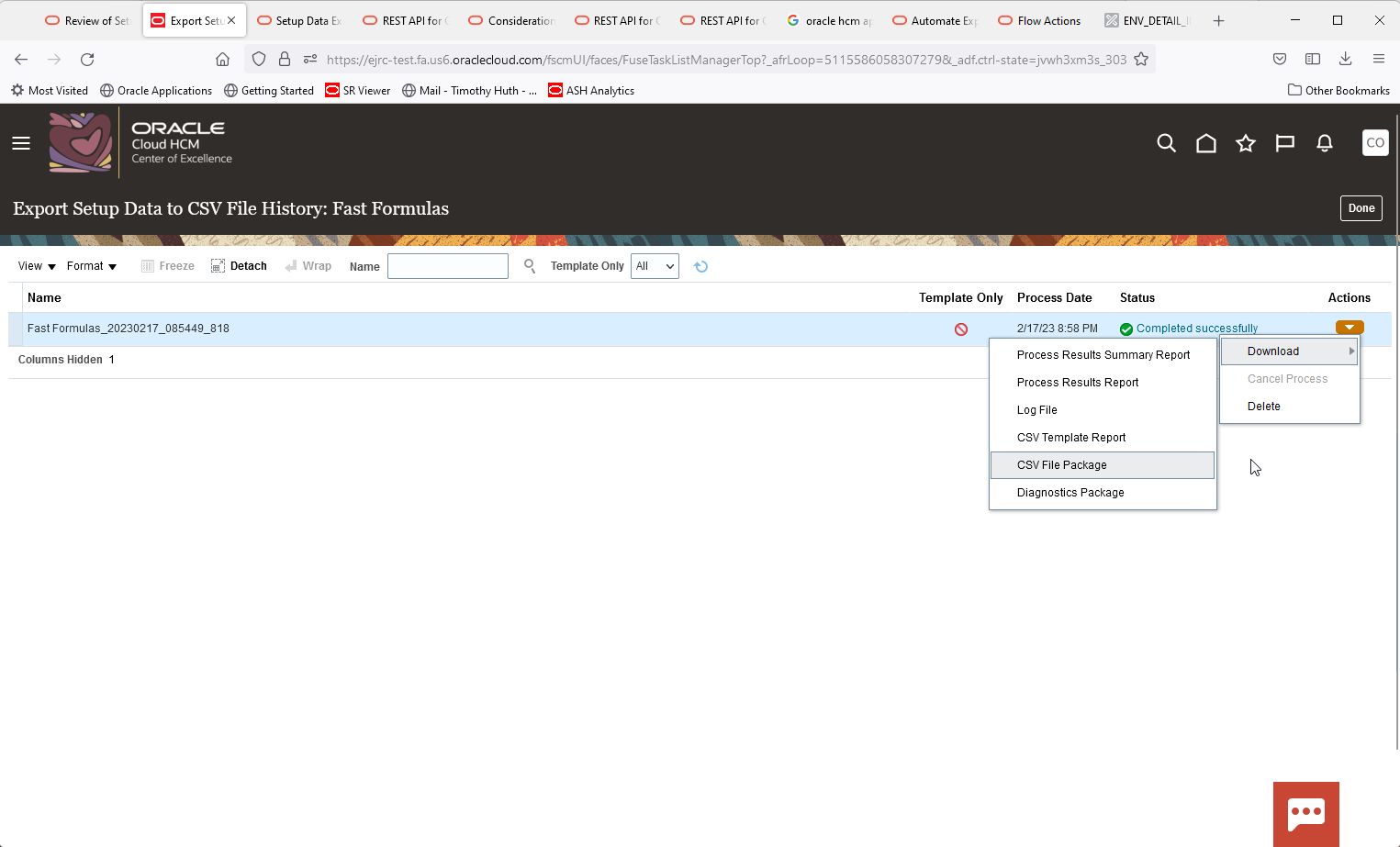

First, though, trigger an export via the FSM UI and download the generated CSV File Package which is a zip file. You can then take a look at the generated content to get some crucial info.

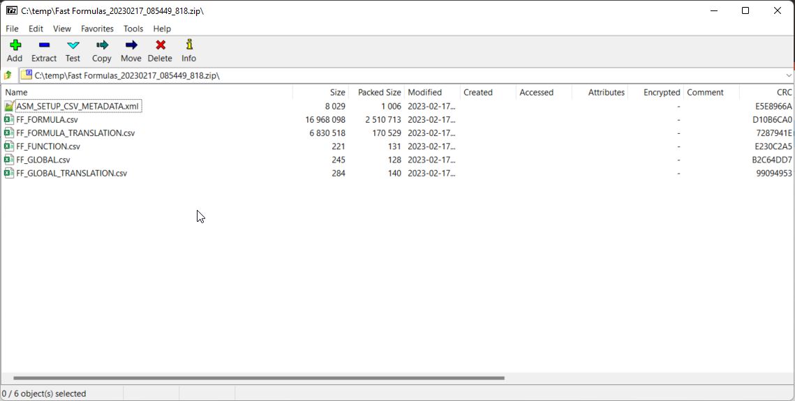

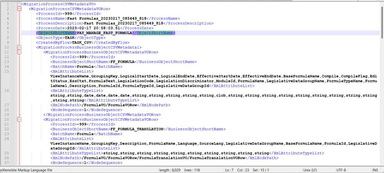

If you open the generated zip file you will see CSV files representing the Fast Formula objects, and a metadata file that contains details about the export process and contents of this CSV File Package. Extract and open the metadata file (ASM_SETUP_CSV_METADATA.xml) and look for ObjectShortName which represents the business object selected for export. In this case you will see PAY_MANAGE_FAST_FORMULA. This is the TaskCode you pass in the API call to start the export process.
