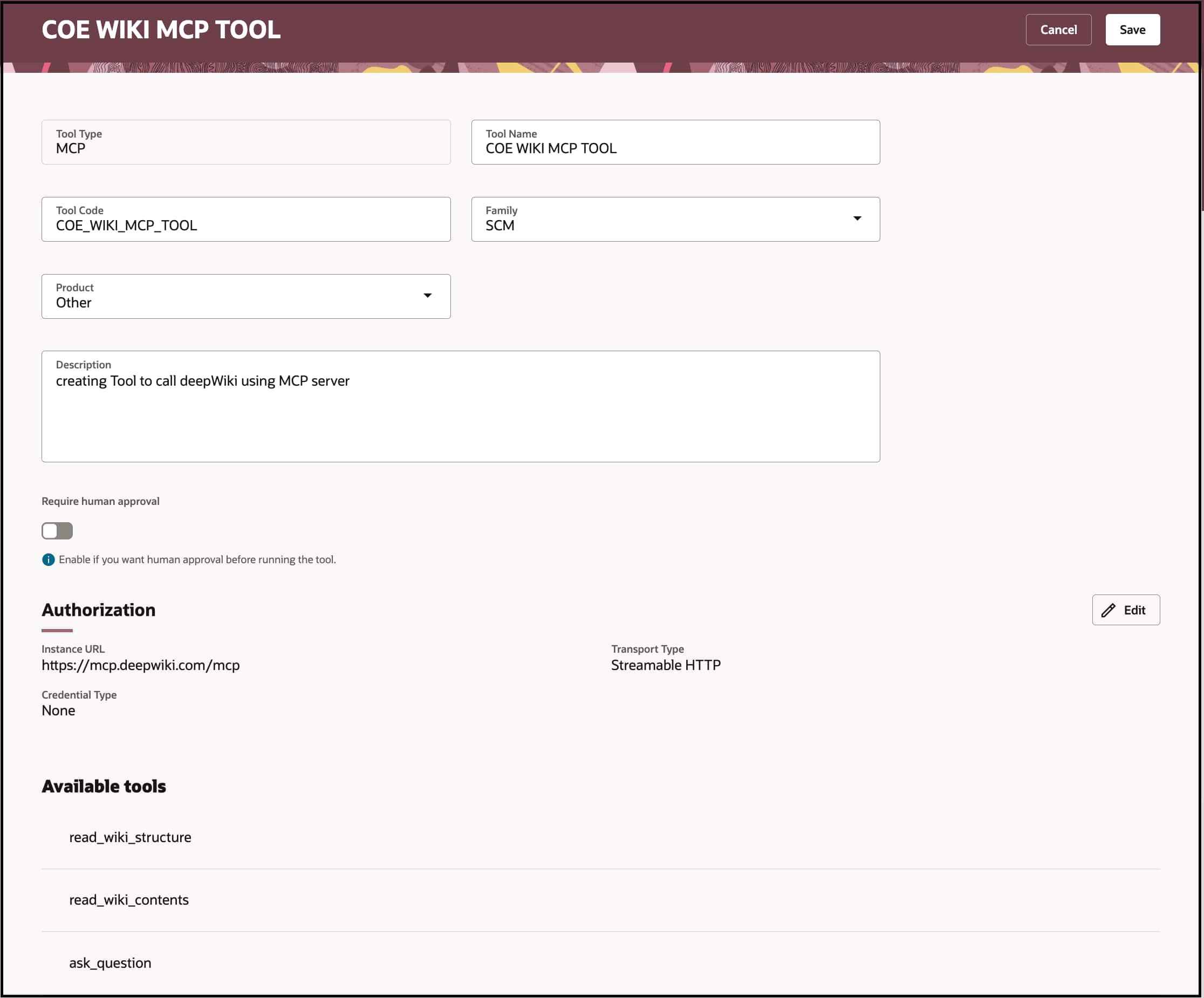

Step 1 — Access MCP Tool Setup
Navigate to Tools tab of AI Agent Studio and add tool type as MCP
Step 2 — Configure Basic Tool Metadata
Define the tool’s identity by filling in the following fields:
  • Name — unique identifier for the tool
  • Code — short alphanumeric code
  • Family — logical grouping
  • Product — associated product or service
  • Description — plain-language explanation of what the tool does
Step 3 — Configure the MCP Server Connection
The connection block defines how the agent communicates with the MCP server. Key fields include:
  • Instance URL — the MCP server endpoint the agent will call
  • Transport Type — SSE (Server-Sent Events) or Streamable HTTP (recommended for modern servers)
Authentication credentials are also configured here. Supported types:
Credential TypeDescription
NoneNo authentication required — suitable for public MCP servers.
API KeyPass a static key in the request header.
JWT AuthenticationToken-based auth using signed JSON Web Tokens.
Client CredentialsOAuth 2.0 machine-to-machine authentication.
Credentials are securely stored within the system and can be updated at any time without recreating the tool.

Endpointhttps://mcp.deepwiki.com/mcp
Configuration settings:
  • Transport Type: Streamable HTTP
  • Credential Type: None (public server)
Step-by-Step: Creating a MCP Tool
Create Tool using MCP tool type and configure the URL, transport type.
Let us walk through how to use a MCP Tool in AI Agent Studio. In this example, we will use a deepWiki MCP Server that helps answer wiki structure, content and questions DeepWiki repositories.
  • Navigate to AI Agent Studio, Tools tab to create a new MCP tool.
MCP Tool Setup
MCP Tool Setup

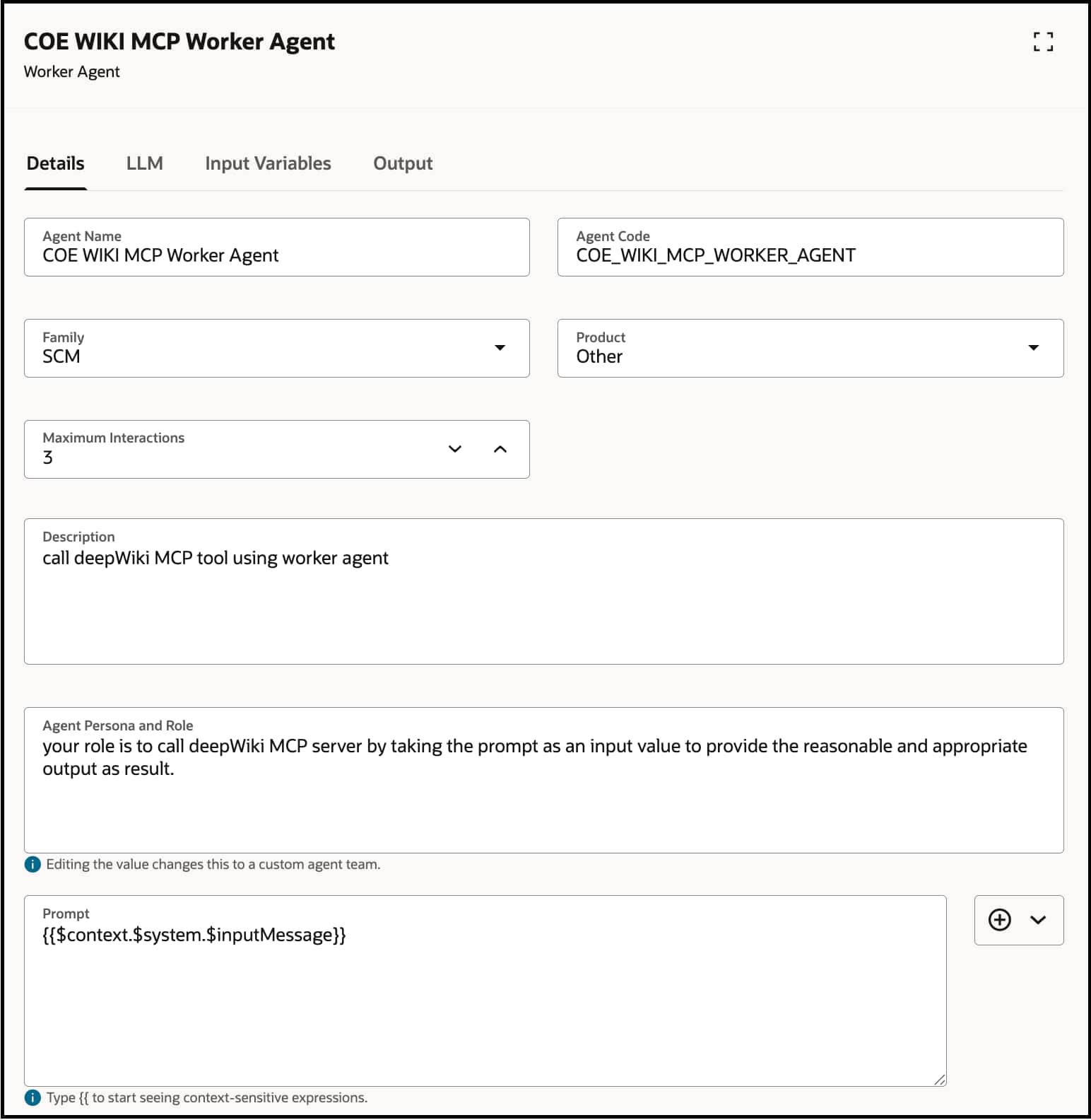

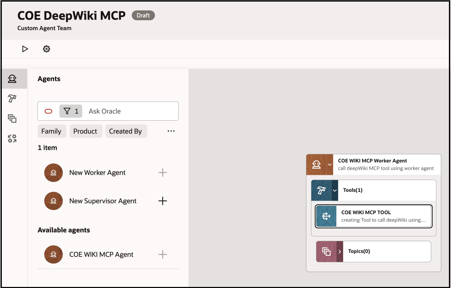

  • Create Supervisor Agent in Agent teams
  • Add Worker Agent
Worker Agent details
  • Search for MCP Tool created above and add into Tools of Worker Agent
Adding MCP Tool into Worker Agent

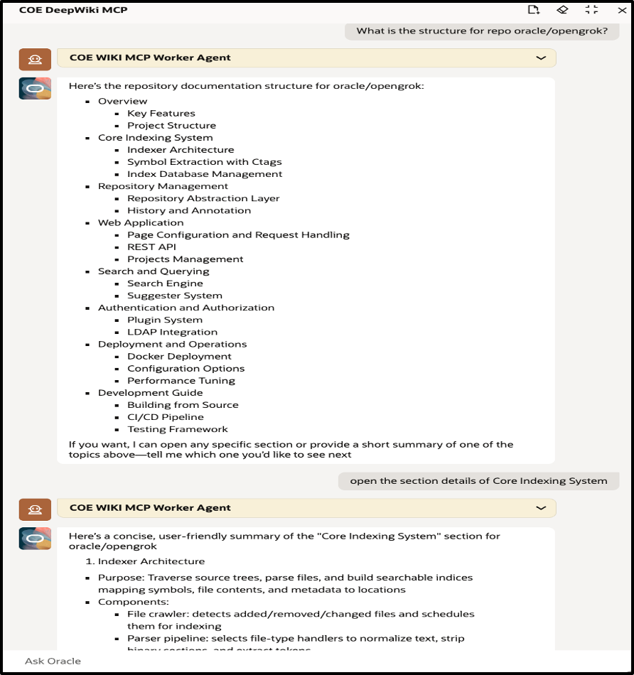

Sample questions agents can answer via DeepWiki MCP:
  • What is the structure for repo oracle/opengrok?
  • Follow up question: open the section details of Core Indexing System to get more details from the results.
MCP Results
MCP Results
  • How does the Indexer architecture work?
  • How can LDAP integration be configured?
  • How can a REST API be constructed using opengrok?
This demonstrates how MCP enables dynamic, context-aware knowledge retrieval from external sources without any custom coding.
