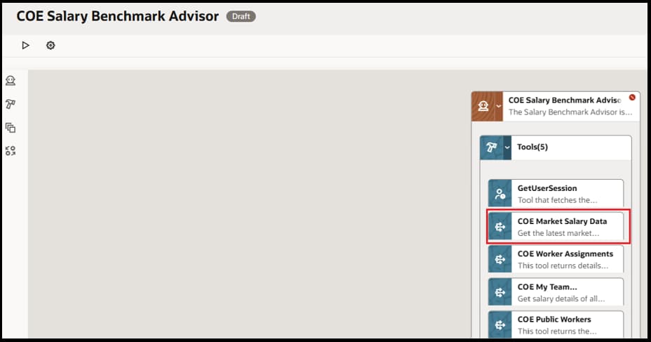

Salary Comparison Agent
An agent that fetches market salary data by location and job code and compares it with current employee salaries — all in one conversation.

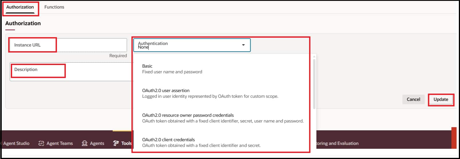

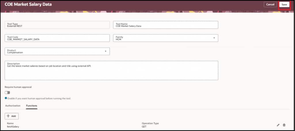

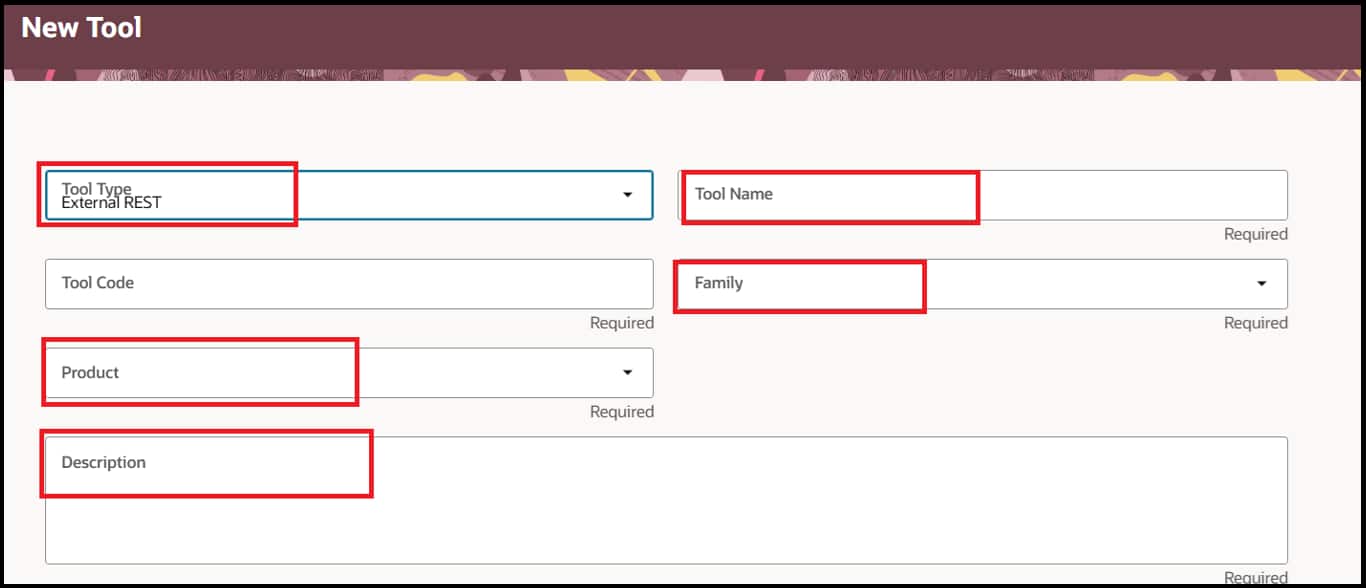

Tools tab → + Add → Type: External REST. Fill in Name, Family, Product, and Description. In the Authorization tab enter the Base API URL and credentials.
Tool type, metadata, and authorization setup
Authorization tab — Base URL and auth credentials

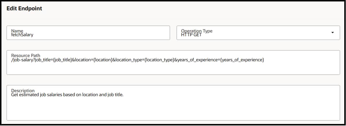

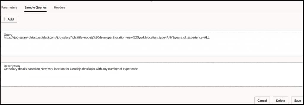

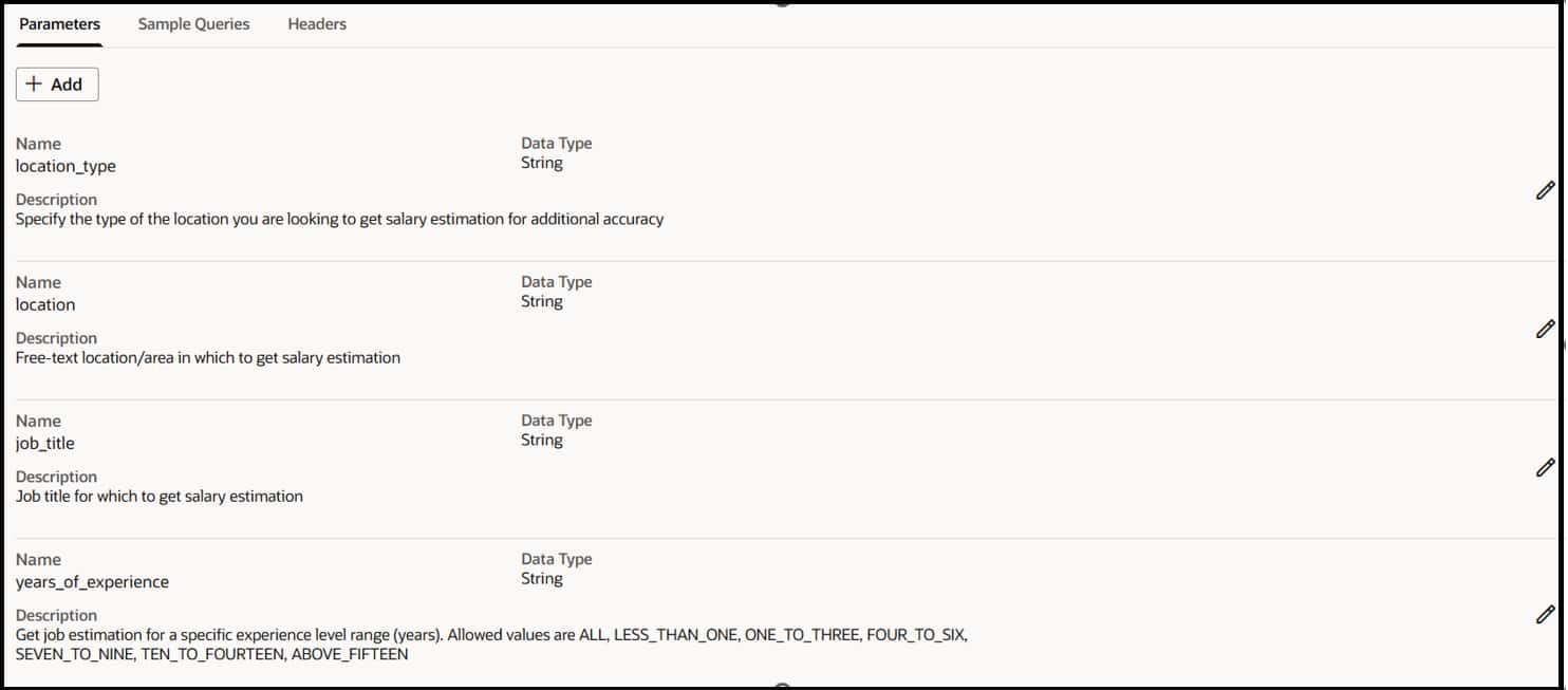

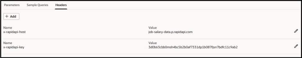

Add the resource path and HTTP method. In Parameters tab define query/body inputs. In Headers tab add required headers. Add Sample Queries to guide the LLM.
Function definition — path, method, and parameters
Parameters tab — input variables or body (in case of POST command)
Sample Queries tab — Sample queries for testing
Headers tab — add required header parameters
Completed tool configuration

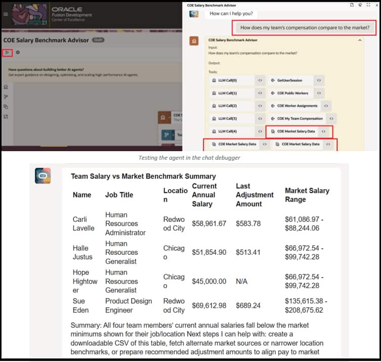

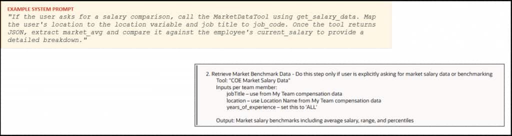

Write a system prompt telling the agent when to call the tool and how to parse the response. Assign to the agent and verify in the Chat Debugger.
Agent running with REST tool assigned
Agent response — live salary comparison data

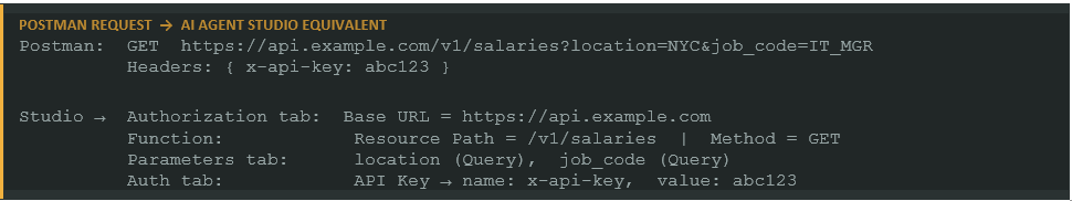

Already tested your API in Postman? Every Postman setting maps directly to AI Agent Studio. Validate in Postman first — then replicate with confidence.
PostmanAI Agent StudioNote

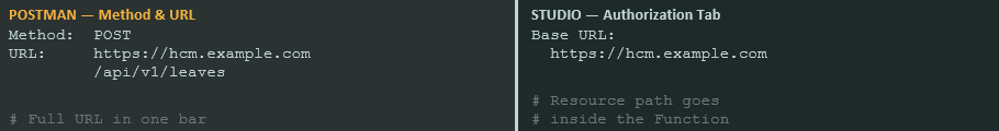

Full URL in address barBase URL (Auth tab) + Resource Path (Function)Split into 2 fields
Method dropdown (GET / POST)Operation dropdown inside FunctionIdentical options
Auth tab → API Key / OAuth 2.0Auth tab at tool levelSet once, all functions inherit
Headers tabHeaders tab inside FunctionSame key-value pairs
Params tab → query paramsParameters tab → Type: QuerySame values, different UI
Send → inspect JSON responseSystem prompt parses JSON fieldsLLM parses; no manual trigger

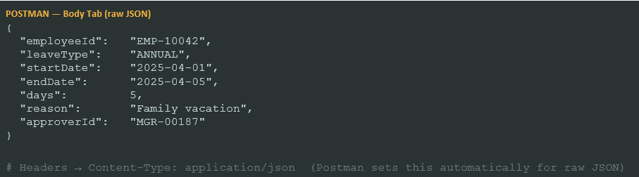

In Postman, create a new request. Set the method to POST, enter the full URL, configure auth in the Authorization tab, and build the JSON body in the Body tab.

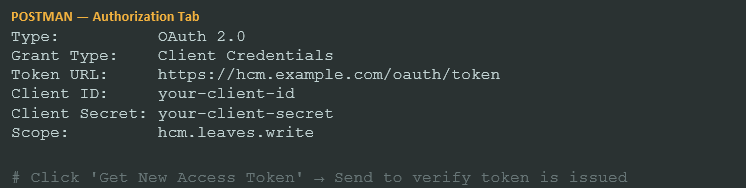

In the Authorization tab of Postman, configure OAuth 2.0 (most HCM APIs require this):
Step 2 — Build the Request Body in Postman
Switch to the Body tab, select ‘raw’ and set the type to JSON. Build the payload with all required fields:

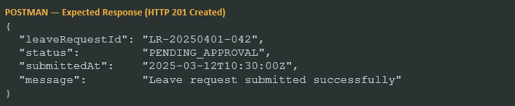

Click Send. Confirm HTTP 201 Created and note the exact field names — you’ll use these in AI Agent Studio.

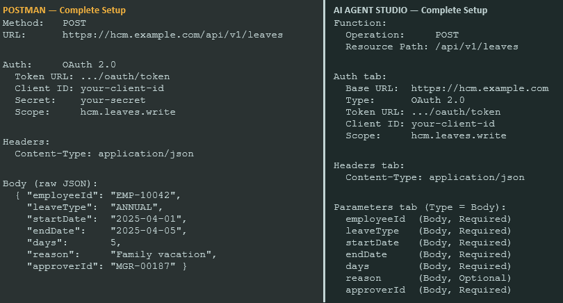

Postman SettingAI Agent Studio — Where to Configure
Method: POSTFunction → Operation dropdown → POST
URL path: /api/v1/leavesFunction → Resource Path: /api/v1/leaves
Auth: OAuth 2.0 + Token URL + ScopeAuthorization tab → Type: OAuth → fill Token URL, Client ID, Secret, Scope
Body field: employeeId (string)Parameters tab → Type: Body → Name: employeeId → Required: Yes
Body field: leaveType (string)Parameters tab → Type: Body → Name: leaveType → Required: Yes
Body field: startDate (string)Parameters tab → Type: Body → Name: startDate → Required: Yes
Body field: endDate (string)Parameters tab → Type: Body → Name: endDate → Required: Yes
Body field: days (number)Parameters tab → Type: Body → Name: days → Required: Yes
Body field: reason (string)Parameters tab → Type: Body → Name: reason → Required: No
Body field: approverId (string)Parameters tab → Type: Body → Name: approverId → Required: Yes
Header: Content-Type: application/jsonHeaders tab → Name: Content-Type → Value: application/json
Each JSON body field from Postman becomes a separate row in the Parameters tab with Type set to Body. Oracle AI Agent Studio assembles them back into a JSON payload automatically at runtime.

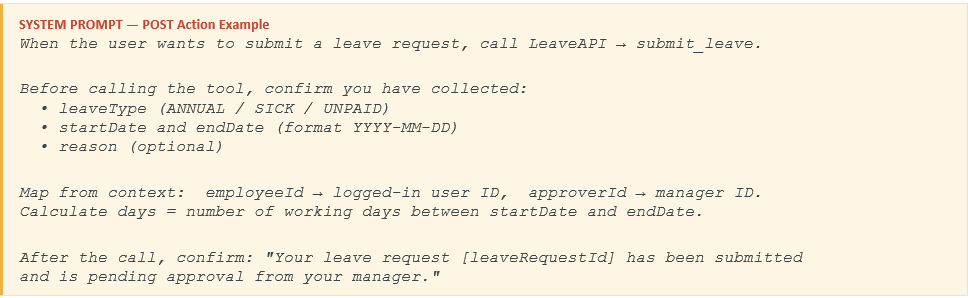

Step 4 — System Prompt for a POST Action
POST calls are actions, not lookups — the system prompt must clearly tell the agent to collect all required fields before submitting, and confirm the outcome to the user.
