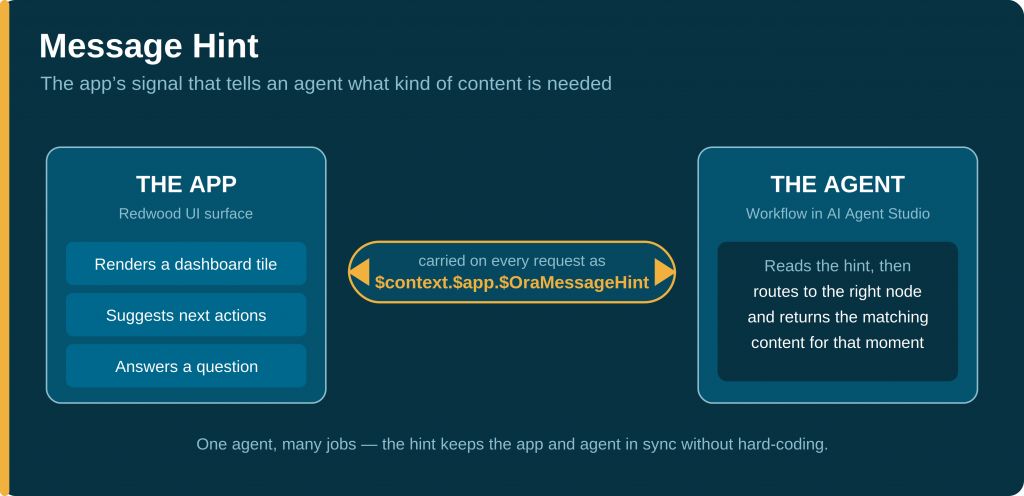

What Is a Message Hint?
In an agentic app, a single agent does many different jobs. The same agent might write a one-line summary at the top of the screen, render a chart in a dashboard tile, suggest a few priority actions, answer a typed question, and draft an email — all within one session. The app needs a way to tell the agent which of those jobs it is being asked to do at any given moment. That signal is the message hint.
Every time the app calls an agent, it attaches a hint value. The agent reads it from $context.$app.$OraMessageHint and responds accordingly. Think of it as the app’s shorthand: a small label that says “right now I need a summary,” or “right now the user clicked an action button — handle it.”
Because the hint carries this intent, you don’t build a separate agent for every screen element. You build one agent that recognizes the hint and branches its logic. This is what makes the capability “built in, not bolted on” — the orchestration is part of the framework, not something you wire up by hand.
The message hint is the signal the app sends with every request, telling the agent what kind of content is needed

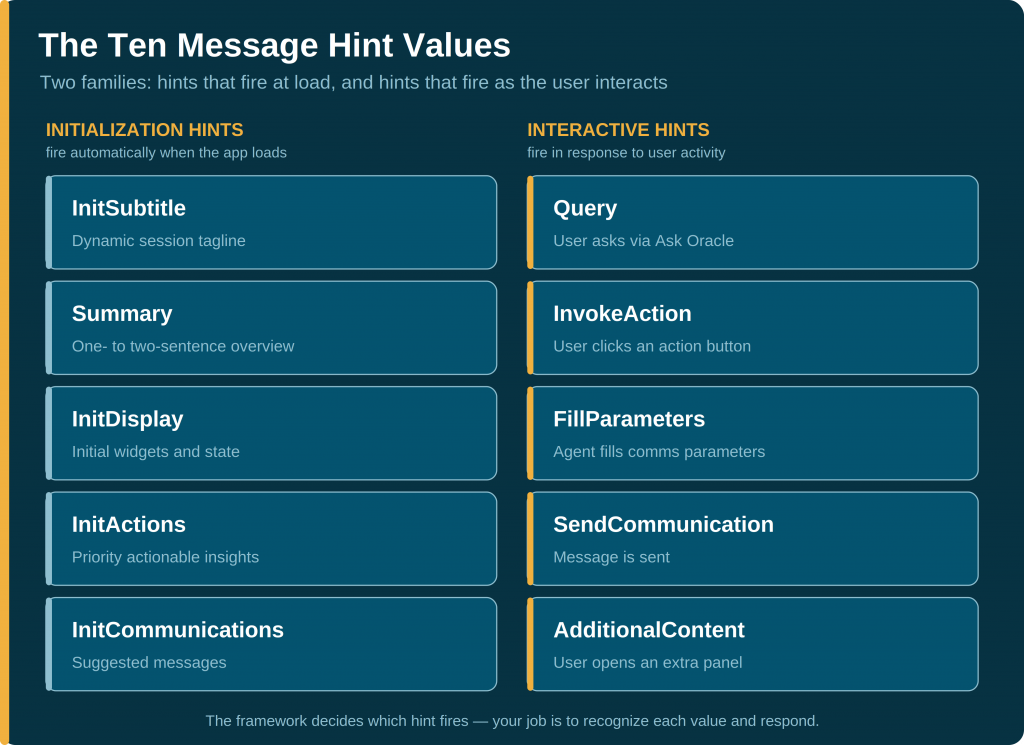

The Ten Message Hint Values
There are ten hint values, and they fall into two natural families. Initialization hints fire automatically the moment an app loads. Interactive hints fire later, in response to what the user does.
The ten values, grouped by when they fire. You don’t choose the hint — you recognize it and respond
Complete Reference
Hint valueWhat the app is asking forWhat your agent should return
SummaryAn initial summary for this agent’s contributionA short (1–2 sentence) summary of the current state
InitSubtitleThe dynamic subtitle / session taglineA short, personalized subtitle line
InitDisplayThe initial information display at startupOne or more oraInfoDisplay blocks (may include actions or comms)
InitActionsPriority actionable insights at startupZero or more action suggestions
InitCommunicationsCommunication suggestions at startupZero or more oraComms blocks
QueryAn answer to something asked through Ask OracleAn answer to the question; may include displays, actions, or comms
InvokeActionHandling of an action the user triggeredFollow-up handling using the $OraAction payload
FillParametersCommunication parameters to be filledThe requested parameters, filled before generation/send
SendCommunicationThe communication to be sent / completedSend or complete the communication flow
AdditionalContentMore content for an expanded panelContent for the panel named in $OraPanelName

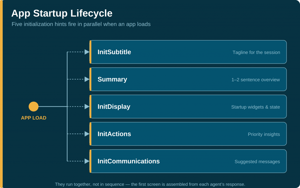

Startup: the five initialization hints
When an agentic app first loads, the framework fires its initialization hints in parallel — they run together rather than one after another. The first painted screen is assembled from whatever each agent returns for its hint.
At startup you can expect:
  • InitSubtitle — a dynamic tagline for the session (for example, a personalized welcome line).
  • Summary — a one- to two-sentence overview of the current state.
  • InitDisplay — the initial widgets and visual state, built from the display prompt.
  • InitActions — the priority actions the user should consider first.
  • InitCommunications — suggested messages relevant to the current state.
App load fans out into five initialization hints, each populating a different part of the first screen

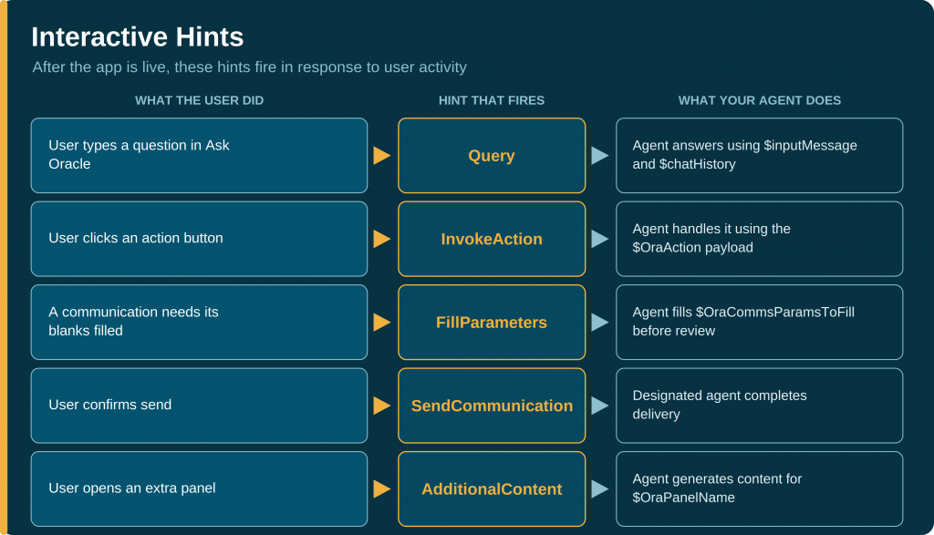

After initialization: the interactive hints
Once the app is live, the remaining hints fire in response to user activity. Each one carries its own piece of context so your agent has what it needs to respond.
After the first paint, what the user does determines which hint fires next
Hint valueFires when…Context delivered to the agent
QueryThe user types in Ask OracleThe question in $context.$system.$inputMessage, plus $context.$system.$chatHistory for follow-ups
InvokeActionThe user clicks an action buttonThe action payload in $context.$app.$OraAction
FillParametersA communication needs its parameters filledThe parameters to fill in $context.$app.$OraCommsParamsToFill
SendCommunicationThe user confirms sendThe communication, for the designated agent to deliver
AdditionalContentThe user opens an extra panelThe panel name in $context.$app.$OraPanelName
Note on chat history: the user’s question is not automatically combined with prior turns. For a Query, pass both $context.$system.$inputMessage and $context.$system.$chatHistory into your query node so follow-up questions keep their context. (The older OraChatHistory is deprecated — use $context.$system.$chatHistory.)

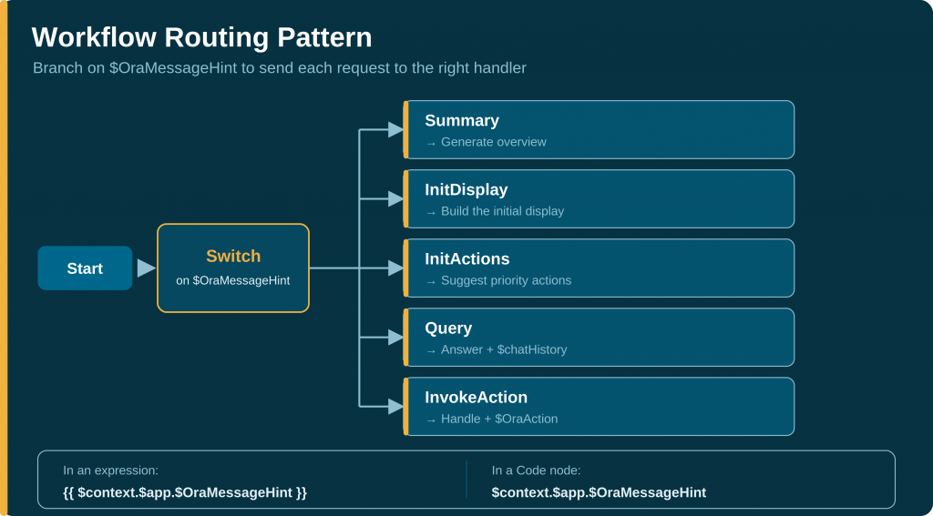

Putting It Together: the Routing Pattern
The standard way to build an agent for an app is a single workflow that branches on the hint. A Switch node reads $context.$app.$OraMessageHint and routes each request to the handler that produces the right output.
A Switch on $OraMessageHint sends each request to its handler node — one workflow, many behaviors
Expressed as logic, the routing looks like this:
/* Route based on $OraMessageHint */
if  $OraMessageHint == "Summary"
      -> summary generation node
if  $OraMessageHint == "InitDisplay"
      -> initial display node
if  $OraMessageHint == "InitActions"
      -> actions generation node
if  $OraMessageHint == "Query"
      -> query handler  (include $chatHistory)
if  $OraMessageHint == "InvokeAction"
      -> action handler  (use $OraAction for context)
In a multi-agent app, an orchestrator first decides which agent should handle a request based on each agent’s description, and then the chosen agent’s workflow routes on the hint. That’s why specific, well-written agent descriptions matter: vague descriptions cause the orchestrator to skip your agent, or pick the wrong one.
