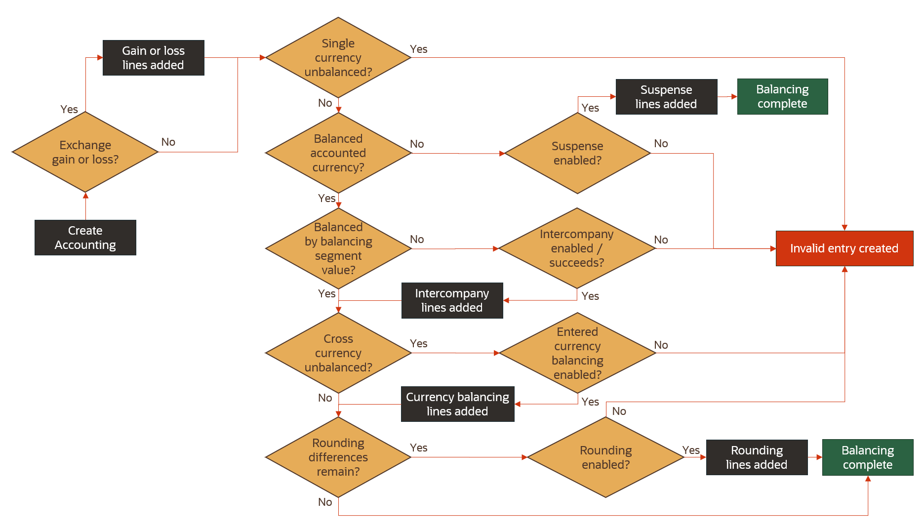

A chart showing the subledger balancing flow

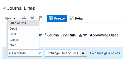

To have gain/loss posted to same GL account, define:
  • A gain or loss journal line rule with Merge Matching Lines: All
  • No accounting attribute assignment
  • Assign it to the rule set along with an exchange gain/loss account rule
To have gain and loss posted to different GL accounts, define:
  • A gain journal line rule with Merge Matching Lines: Credit
  • A Loss journal line rule with Merge Matching Lines: Debit
  • Assign the Gain rule to the rule set along with a gain account rule
  • Assign the Loss rule to the rule set along with a loss account rule
Alternatively, you can add assignments for the Exchange Gain Account and Exchange Loss Account accounting attributes and map accounts to be used when there are no Gain or Loss journal line rules defined.
Note: Exchange gain or loss is calculated by comparing the debit and credit amounts generated for each transaction line. Therefore, for pass-through implementations where a transaction line results in either a debit or a credit, a gain line is created to offset each debit and a loss line is created to offset each credit.
The gain and loss lines can be merged to a single zero amount journal line by defining:
  • A single gain or loss journal line rule with Merge Matching Lines: All.
  • A header level source, such as Transaction Number, assigned to the Gain or Loss Reference accounting attribute.
Additionally, the Zero Amount Journal Lines Displayed profile option can be set to No to prevent transfer of zero lines to GL.

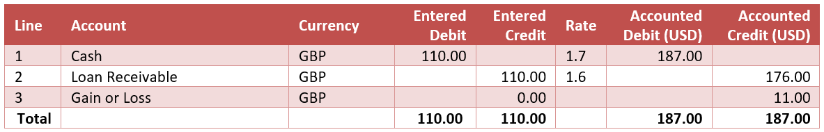

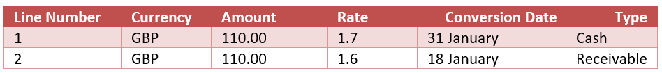

Consider a foreign currency loan paid out in the same currency. Provide Accounting Hub with conversion information, so it calculates the accounted amounts along with any exchange gain or loss resulting from rate fluctuations between loan origination and payment.
The table below lists source values for a loan payment. An amount of 100 GBP is received on January 31st (at a rate of 1.7 GBP/USD) against a loan originated on January 18th (at a rate of 1.6).
Line NumberCurrencyAmountRateConversion DateType
1GBP110.001.731JanuaryCash
2GBP110.001.618JanuaryReceivable
Loan payment transaction
The table below lists the details of the resulting subledger journal entry in a USD ledger.
Loan payment accounting

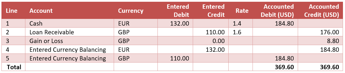

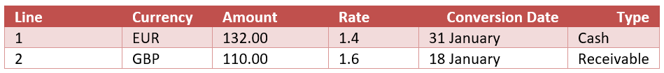

This is a similar scenario, but the loan payment is in EUR at a rate of 1.4 EUR to USD as shown in the table below.
Loan payment in Euro
The table below lists the details of the resulting subledger journal entry in a USD ledger. In this case entered currency balancing lines will be added too.
Suspense balancing

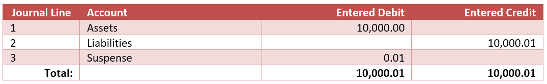

Example: suspense lines added to balance a single-currency entry by accounted currency
The accounting process can also automatically create balancing lines for single currency subledger accounting entries unbalanced by both unrounded and rounded accounted amounts.
With Subledger Accounting Suspense Enabled in ledger options, differences in rounded accounted and entered amounts are added to the Default Suspense Account for each balancing segment value and entered currency.
The following table shows the lines, accounts, and debits and credits, for an accounting entry with differences between accounted amounts.
An accounting entry with a difference between accounted debit and accounted credit
The following table shows the lines, accounts, and amounts, for the automatically balanced accounting entry.
A balanced accounting entry with a suspense line added

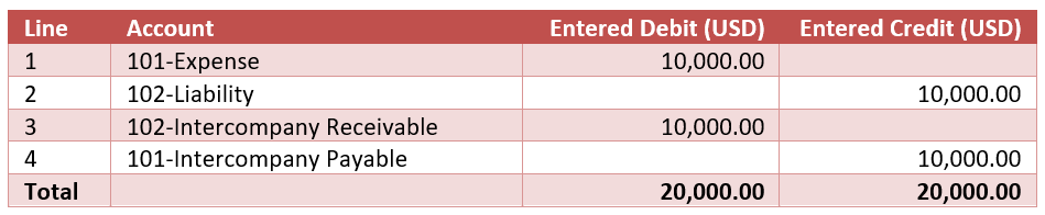

Journals with unrounded accounted amounts not balanced by one or more balancing segment values are automatically balanced according to intercompany setup.

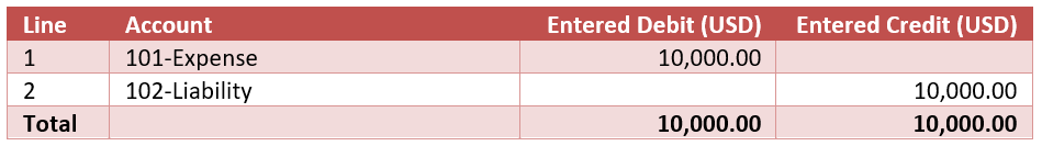

Example: balancing segment values out of balance
The following table shows the lines, accounts, and debits and credits, for an accounting entry in the ledger currency that balances in total, but not by balancing segment value (BSV).
A cross balancing segment value entry
Note that:
  • Entered debits equal entered credits.
  • Entered and accounted amounts are not balanced by balancing segment value. Balancing segment value 101 has only debits and balancing segment value 102 has only credits.
  • Intercompany enabled. To balance the journal by balancing segment value, the process creates intercompany balancing lines.
The following table shows a basic example of the lines, accounts, and amounts, for the accounting entry.
A balanced accounting entry with intercompany balancing lines added

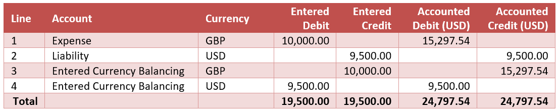

Entered currency balancing
Cross-currency subledger accounting entries unbalanced by balancing segment value and unrounded entered amounts will be automatically balanced using the Entered Currency Balancing account from ledger options, if defined.
Example: balancing a cross-currency entry by entered currency
The following table shows the lines, accounts, currencies, and debits and credits, for a cross-currency accounting entry with accounted amount differences too.
A cross-currency accounting entry
The following table shows the lines, accounts, currencies, and amounts, for the resulting accounting entry with suspense lines added by the accounting process to balance the entry in each entered currency:
A balanced cross-currency accounting entry

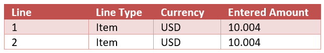

Example: entered amount rounding
To illustrate journal rounding errors, the table below lists source transaction details.
Resulting accounting entry

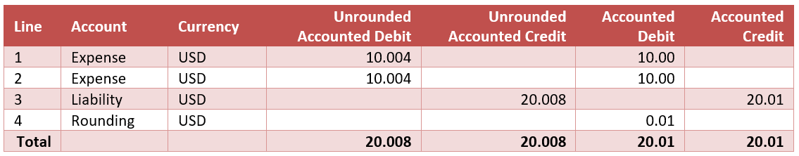

Journal line rules Liability and Expense are used to create accounting for this transaction. The Merge option is set to Yes for Liability and to No for Expense.
The table below lists the resulting journal entry. Since the total of Unrounded Accounted Debit equals the total of Unrounded Accounted Credit but the total of Accounted Debit does not equal the total of Accounted Credit, a rounding line is created for the difference.
Note: Accounted amounts only are shown in the table below to illustrate the logic. Yet, entered amounts and unrounded entered amounts are also stored in Subledger Accounting.

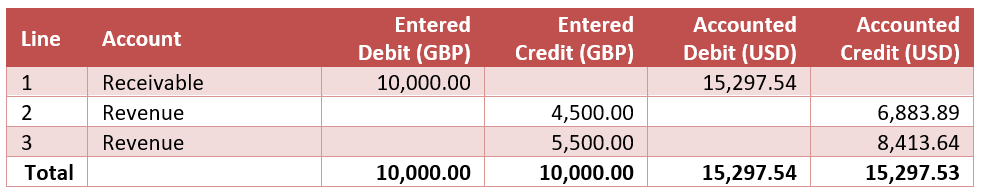

Example: accounted amounts rounding

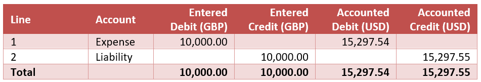

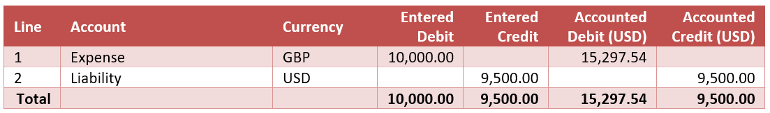

The following table shows the lines, accounts, and debits and credits, for a foreign currency accounting entry with a difference due to rounding.
Foreign currency accounting entry with a rounding difference
Note that:
  • GBP to USD rate is 1.5297536.
  • Entered and accounted unrounded amounts are balanced.
  • All lines are for the same balancing segment value.
  • Accounted amount differences remain.

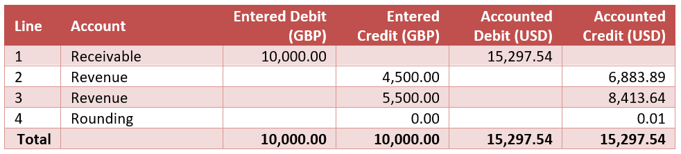

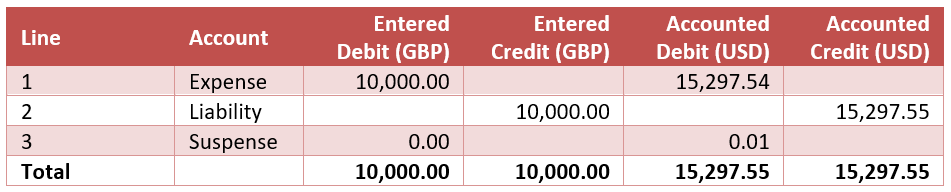

The following table shows the lines, accounts, and amounts for the resulting entry with a rounding line added.
Foreign currency accounting entry with a rounding line added

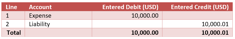

Example: single-currency entries unbalanced by entered currency
Single currency subledger accounting entries must be balanced in entered currency. If the unrounded entered amounts are not balanced within a balancing segment value, the resulting entry would be unbalanced by entered currency and hence invalid.

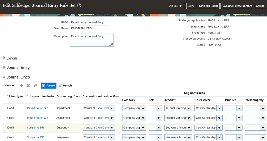

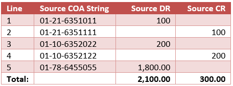

For pass-through journals with multiple sets of debits and credits that should balance, you can assist accountants by highlighting exactly which line(s) have provoked the imbalance. To do this, assign a source that uniquely identifies each set of debits and credits to the suspense journal line rules. The resulting suspense journal line(s) will be “tagged” with the identifying criteria.
Consider a pass-through journal that contains multiple sets of balanced debits and credits for each location. If location is an account combination segment, populate it on the suspense journal line rule’s account rule. If location is not part of the COA, populate the suspense line’s description or supporting reference. The resulting suspense journal lines will be generated for the suspense account and location that has provoked the imbalance.
As in the explicit balancing rules example, keep the same Suspense Account segment rule for both the debit and the credit suspense lines. For remaining segments – such as Company and Cost Center – use the same segment rules as for the regular debits and credits.
Subledger Journal Entry Rule Set Setup

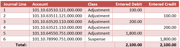

Import a pass-through transaction missing a credit line (all debit lines having a matching credit line except the last one).
Pass-through transaction missing a CR line
The resulting journal entry will have just that amount posted to suspense. Cost center 751 below is derived from the Source COA String 01-78-6455055 through a substring formula and a mapping set (same as for the respective debit line). 78990 is the suspense account constant.
Balanced journal entry created
