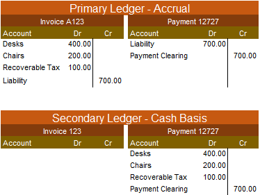

Tables illustrating how an invoice is accounted differenently under accrual and cash basis accounting
In the above diagram, invoice A123 and its payment are accounted using the accrual accounting method in the primary ledger, and according to cash basis in the secondary.
