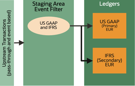

Accounting Treatment Secondary ledgers
Use accounting treatment secondary ledgers when financial accounts differ between accounting standards but, accounting event timing and monetary valuation do not vary. A classic example of accounting treatment secondary ledgers arises when a supplier invoice uses a different liability account depending on the accounting standard.
When you have configured subledger level secondary ledgers and not checked the valuation method checkbox, the accounting engine applies multiple accounting methods to each transaction to generate two or more complete sets of accounting in separate ledgers.
Accounting treatment secondary: a single transaction feeds the Accounting Hub to generate journals in the primary and secondary ledgers
Noteworthy characteristics of accounting treatment secondary ledgers include:
Full representation. Accounting treatment secondary ledgers generate a complete set of journals and balances in each ledger.
Shared valuations. Accounting treatment secondary ledgers lend themselves to transactions whose timing and monetary valuation does not vary by accounting standard. You can leverage Accounting Hub formula to take care of accruals and small valuation or timing differences. But AHCS cannot be considered a subledger capable of generating its own transactions.
Flexibility. All aspects of accounting treatment secondary ledgers can differ from the primary ledger: chart of accounts (COA), accounting currency, accounting method, and calendar.

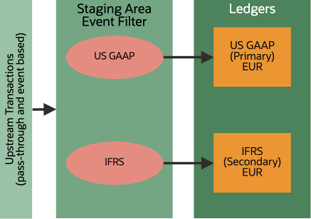

Valuation Method Secondary ledgers
Use accounting treatment secondary ledgers when accounting standards dictate different timing and / or monetary valuations of accounting events. Differences between asset or stock valuations constitute a common use case for valuation method secondary ledgers.
When you have configured subledger level secondary ledgers and checked the valuation method checkbox, the Accounting Hub allows independently valued transactions to be fed directly into primary and secondary ledgers.
Valuation method secondary: separate transactions feed the Accounting Hub to generate journals in the primary and secondary ledgers
Noteworthy characteristics of valuation method secondary ledgers include:
Full representation. Valuation method secondary ledgers generate a complete set of journals and balances in each ledger.
Disparate valuations and events. Valuation method secondary ledgers lend themselves to cases where monetary valuation or timing of most accounting events varies between accounting standards.
Flexibility. Valuation method secondary ledgers can differ in every respect from the primary ledger: chart of accounts (COA), accounting currency, accounting method and calendar.

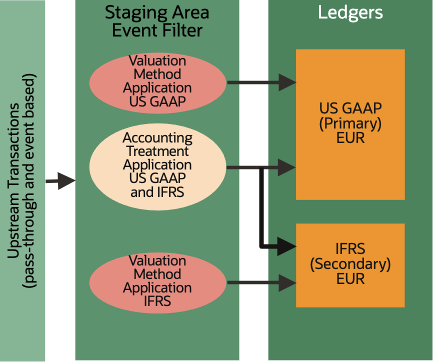

Combining Approaches
You can mix accounting treatment and valuation method approaches in a single accounting configuration. A subledger application-level option controls how the secondary ledger is populated.
Accounting treatment and valuation method applications feed the same primary and secondary ledger configuration

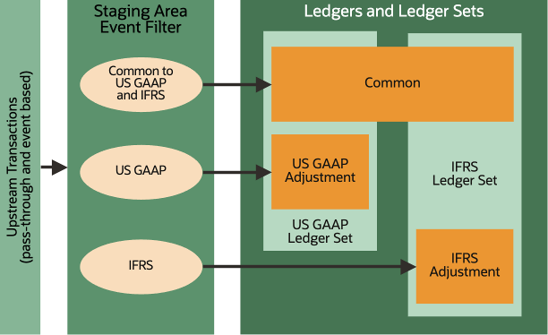

Common Ledger
Common ledger uses three ledgers to generate two complete accounting representations. A common ledger stores journals and balances whose accounting treatment is the same for both accounting standards. Two ledgers store journals and balances specific to each accounting standard. Ledger sets combine the common ledger with one of the accounting standard specific ledgers to build complete accounting representations.
Since the common ledger’s journals, balances, and processing are shared between accounting representations, the Accounting Hub consumes less time and resources.
​  Common ledger uses three ledgers, and two ledger sets to generate two complete accounting representations  ​
The approach relies on an event filter, accounting rules, and ledger sets.
Event filter
The event filter directs accounting accounting events and pass-through journals to different ledgers for processing.
  • Common: transactions and pass-through journals whose valuation and accounting treatment is common to US GAAP and IFRS.
  • US GAAP: transactions and pass-through journals that require accounting under US GAAP only; or whose accounting treatment differs between accounting standards.
  • IFRS: transactions and pass-through journals that require accounting under IFRS only; or whose accounting treatment differs between accounting standards.
The event filter’s design will depend on the way upstream systems send transactions or pass-through journals to the Accounting Hub. Consider transactions that impact both US GAAP and IFRS but whose accounting treatment differs. A single transaction or pass-through journal could store both US GAAP and IFRS details and be directed to both accounting standard specific ledgers. Alternatively, the source system could send separate transactions or pass-through journals that the event filter directs to the corresponding adjustment ledgers.

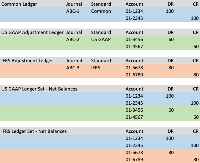

Accounting Rules
The common ledger does not need special versions of accounting rules since the event filter determines which transactions are fed into which ledger. You could, for example, assign the same US GAAP accounting method to the common and US GAAP ledgers. Similarly, you could assign a complete IFRS accounting method to the IFRS specific ledger.
Pass-through example of the common ledger approach to adjustment only ledgers
Ledger Sets
Ledger Sets effectively merge two or more ledgers into a single entity for the purpose of reporting and downstream processing. The US GAAP and IFRS ledger sets include the common ledger and their respective accounting standard specific ledgers.

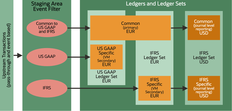

Reporting currencies. To accommodate subledger level reporting currencies, you should define the common and accounting standard specific ledgers as primary ledgers. However, note that you cannot assign a legal entity to more than one primary ledger. The upshot is that subledger level reporting currencies and common ledgers work together only if you assign no legal entities to ledgers. Journal level reporting currency ledgers offer an alternative that avoids this drawback since they can be linked to a secondary ledger. Define the accounting standard specific ledgers as valuation method secondaries and ledger sets to combine the reporting currency ledgers.
Using valuation method (VM) secondary ledgers combined with journal level reporting currencies

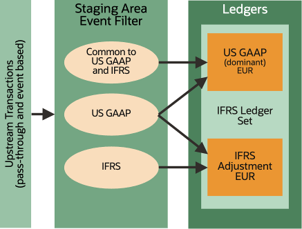

Dominant Primary
Dominant primary is alternative approach that favors the primary ledger’s accounting representation. It uses fewer ledgers and ledger sets but relies on more complex accounting rules.
The primary ledger’s accounting representation is no different from an accounting treatment or valuation method primary. All transactions subject to its accounting standard are fed into the primary ledger. Its accounting method has a complete set of accounting rules.
The secondary, adjustment ledger’s journals convert the primary ledger’s accounting to comply with the alternate accounting standard.
Dominant primary uses two ledgers and a ledger set to generate two complete accounting representations
Like, common ledger, dominant primary relies on an event filter, accounting rules and ledger sets.
Event filter
The event filter directs transactions to different ledgers for processing.
  • Common: transactions and pass-through journals whose valuation and accounting treatment is common to US GAAP and IFRS. The event filter directs them to the US GAAP ledger.
  • US GAAP: transactions and pass-through journals that require accounting under US GAAP only; or whose accounting treatment differs between accounting standards. The event filter directs them to both the US GAAP and IFRS adjustment ledgers.
  • IFRS: transactions and pass-through journals that require accounting under IFRS only; or whose accounting treatment differs between accounting standards. The event filter directs them to the IFRS ledger.
As with common ledger, the event filter’s design will depend on the way upstream systems send transactions or pass-through journals to the Accounting Hub. With the dominant ledger approach, the event filter directs transactions that impact US GAAP only to both the US GAAP and IFRS adjustment ledgers.

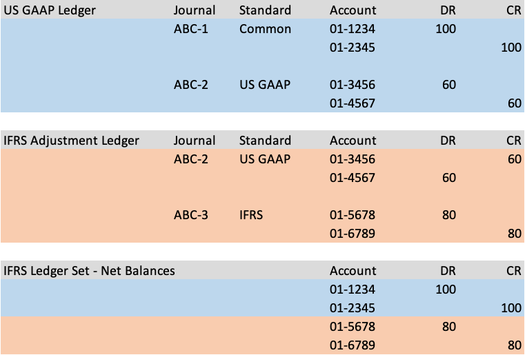

Accounting Rules
The dominant standard’s accounting rules generate a complete US GAAP accounting representation without further processing or combination.
The IFRS adjustment-only ledger’s accounting rules convert US GAAP into IFRS:
  • Transactions and pass-through journals that impact US GAAP only or whose accounting treatment differs between accounting standards. The accounting rules reverse the US GAAP accounting of the transaction or journal.
  • Transactions and pass-through journals that impact IFRS only or whose accounting treatment differs between accounting standards. The accounting rules generate accounting applicable to the IFRS accounting standard.
Pass-through example of the dominant ledger approach to adjustment only ledgers
Ledger Sets
Since the US GAAP ledger stores a complete accounting representation, no ledger set is necessary. The IFRS ledger set stores the US GAAP and the IFRS Adjustment ledgers. The IFRS ledger’s journals convert US GAAP into a full IFRS accounting representation.
