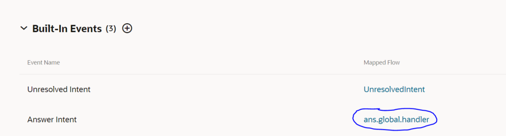

You can see this is an answer intent – which does not need a dialog flow. We can, however, customize this behavior. That means we need to create a flow that is called for answer events. Using the Main flow in the visual flow designer this can be done – we map the event answer intent to a flow. Every answer intent will call this flow from now onwards.
events

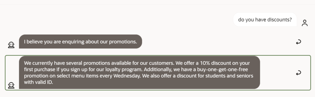

This is the result.

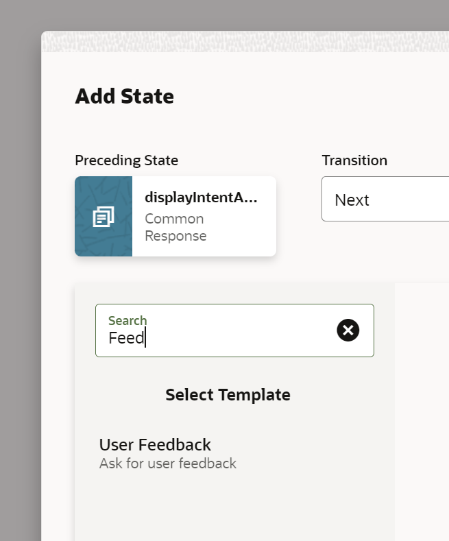

Add Feedback

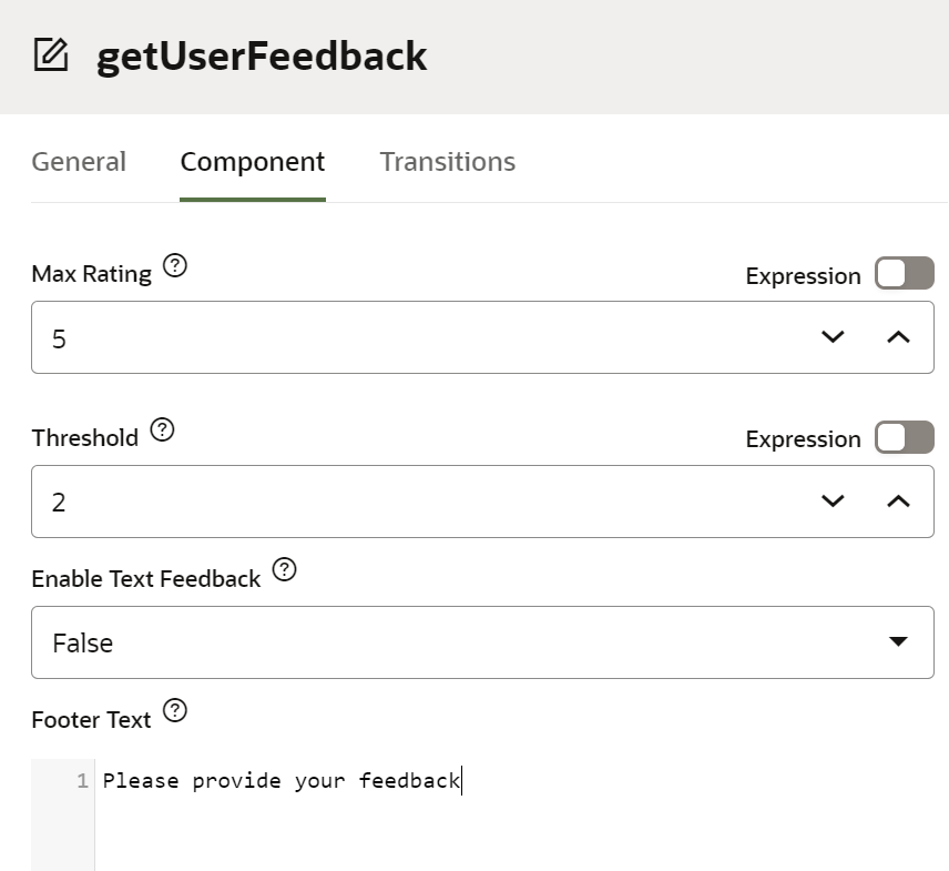

Then you add the component getUserFeedback at the end.

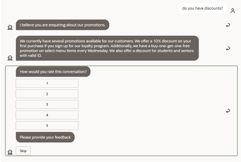

And this is the result!

The rating feedback component comes out of the box, but if you wish to implement a different mechanism, like "thumbs-up-thumbs-down", then check this article that explains that implementation in detail.
