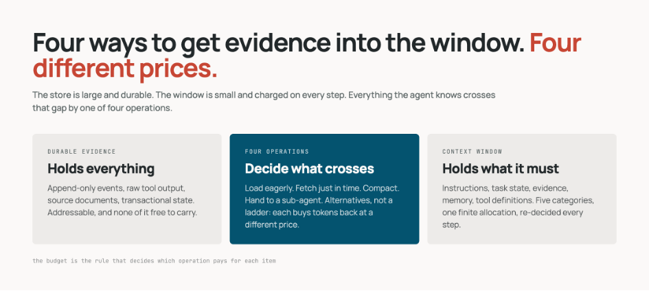

Four operations sit between an agent's evidence store and its context window: load eagerly, fetch just in time, compact, and hand to a sub-agent. Each buys back tokens and each charges a different price, so context engineering is a choice among four costs rather than a ladder of best practice.
Slide explaining four operations that determine what evidence crosses an agent’s context window.

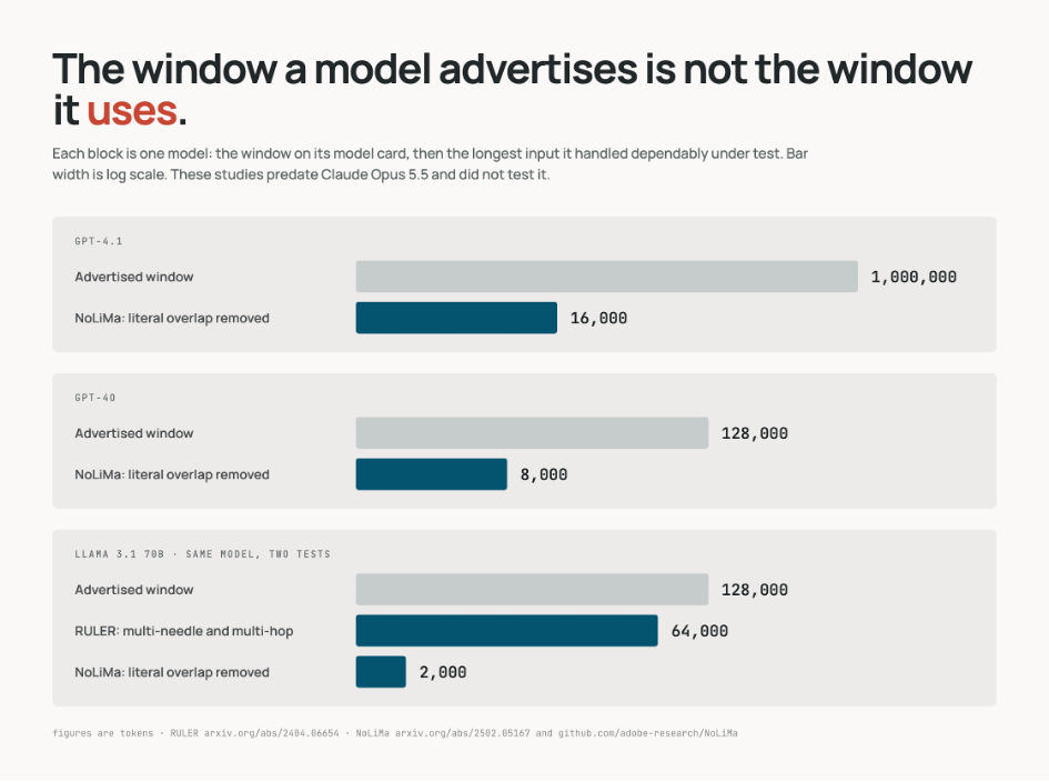

Three blocks, one per model, each comparing the context window on the model card with the longest input the model handled dependably under test. GPT-4.1 advertises one million tokens and held up to sixteen thousand on NoLiMa. GPT-4o advertises one hundred and twenty-eight thousand and held up to eight thousand. Llama 3.1 70B advertises one hundred and twenty-eight thousand, held up to sixty-four thousand on RULER and two thousand on NoLiMa. These studies did not test Claude Opus 5.5.
Bar chart comparing advertised model context windows with dependable input lengths under NoLiMa and RULER tests.
Read each block as one model measured against itself. GPT-4o accepts 128,000 tokens and held up to about 8,000 once the question and the evidence stopped sharing the same words (NoLiMa). Llama 3.1 70B held up to 64,000 on RULER (RULER) and to 2,000 on NoLiMa, which is the same model giving you a thirty-two-fold difference depending on how hard the test is. Nobody has published the same measurement for Claude Opus 5.5, so I’m not going to guess at its number.
The industry has a name for this now. Anthropic and Chroma both call it context rot: as the input grows, the model’s ability to recall what’s in it drops (Effective Context Engineering for AI Agents). Chroma tested 18 models and found that “performance grows increasingly unreliable as input length grows”, even on simple tasks (Context Rot).
Three things pull the measured bars down, and they fail independently. Position: models use evidence most reliably near the start or the end of a long input and least reliably in the middle (Lost in the Middle). Difficulty: RULER adds multiple needles, aggregation and multi-hop tracing, and half the models it evaluated fell over well below the window they advertised. Literal overlap: NoLiMa removes the shared phrasing between question and evidence, and effective lengths collapse.
Then there’s the result that removes the last excuse. Give a model perfect retrieval, put the evidence immediately before the question, and performance still degrades as the input grows (Context Length Alone Hurts LLM Performance Despite Perfect Retrieval).
So the effective context window is a measurement you take, not a specification you read. A bigger van still gets loaded badly.
What are the four operations, and what does each one cost?
There are four, and they’re alternatives rather than a ladder. Just-in-time fetching isn’t more advanced than eager loading, and a sub-agent isn’t where you graduate to. Each one buys tokens back at a different price.

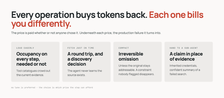

If you’ve read LangChain’s write, select, compress and isolate (Context Engineering for Agents), this is the same territory cut a different way. Eager loading and just-in-time fetching are both ways to select, compaction is compress, and the sub-agent is isolate. Write, which means saving notes and state outside the window, isn’t an operation here because it’s what makes the other four safe: you can only compact or fetch what’s been written somewhere first. I’ve grouped them by what each one costs you rather than by what it does, because the cost is what you’re actually choosing between.
Four lanes, left to right: eager load pays permanent occupancy, just in time pays a round trip and a discovery decision, compaction pays irreversible omission, sub-agent handoff pays a claim in place of evidence. Under each lane, the production failure that price turns into.
Slide showing how four evidence-handling operations create different costs and failure modes.
There’s one cost that cuts across all four, and it’s the one teams notice last: the prompt cache. Providers cache the unchanged front of your context, and cached tokens are far cheaper. The Manus team reported cached input at 0.30 USD per million tokens against 3 USD uncached on Claude Sonnet, a ten-fold gap, and called the cache hit rate “the single most important metric for a production-stage AI agent” (Context Engineering for AI Agents: Lessons from Building Manus). So a stable, eagerly loaded prefix pays for itself, while every compaction or reshuffle near the top of the window throws the cache away and you pay full price again.

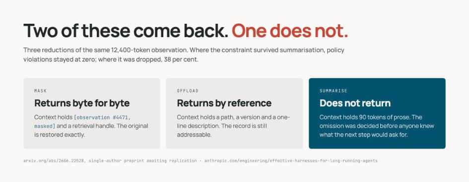

Three reductions of the same history side by side. Masking leaves a marker and a retrieval handle so the original returns exactly, offloading leaves a path and a version, and summarising leaves prose with no way back. Only the first two are reversible, and the constraint that doesn't survive summarising is the one that lets an agent break policy.
Comparison of three context compression methods and whether the original observation remains recoverable.
The cost is that you decide what to leave out before you know what the next question will be, which is why masking and compaction aren’t the same operation. Masking hides an observation behind a marker and a retrieval handle, so the original comes back exactly. Compaction on its own didn’t preserve enough state to restart coding-agent sessions, which is why Anthropic added progress files and structured feature records alongside it (Effective Harnesses for Long-Running Agents).
