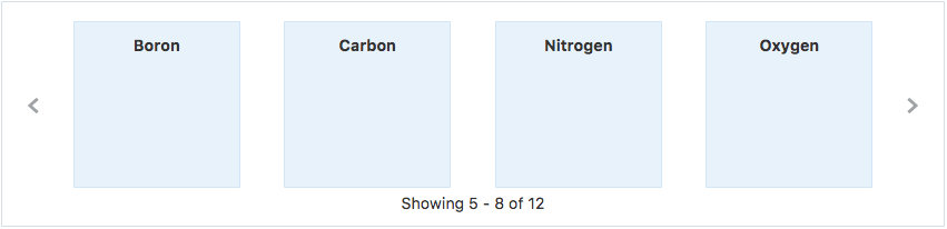

A fairly common question I get asked about JET UIs is how to somehow monitor paging events in components such as the table or filmstrip. For example, the filmstrip with a paging control:

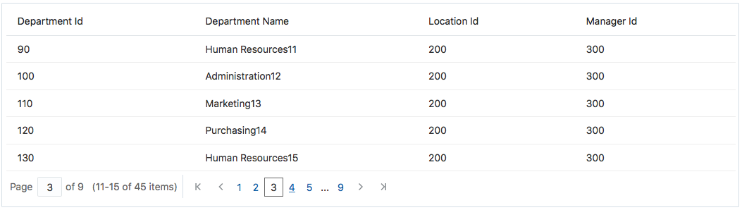

Or the table:
