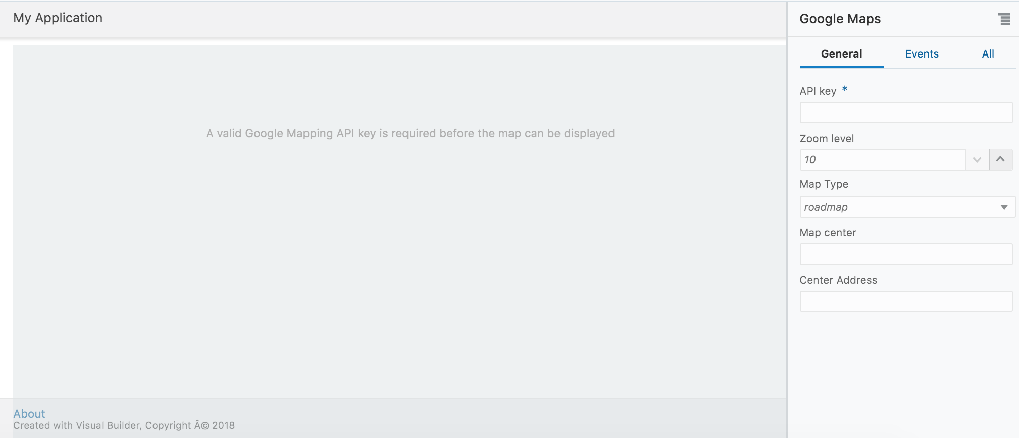

  2. If the component requires some information before it can even attempt to draw, then have it output some useful message as a placeholder that can disappear once configuration is complete.  For example, here’s my Google Maps integration component when it is first dropped onto the canvas. This component needs a Google API key before it can operate, so whilst I’m waiting for the developer to provide that I at least tell them so:
Unconfigured component display at DT

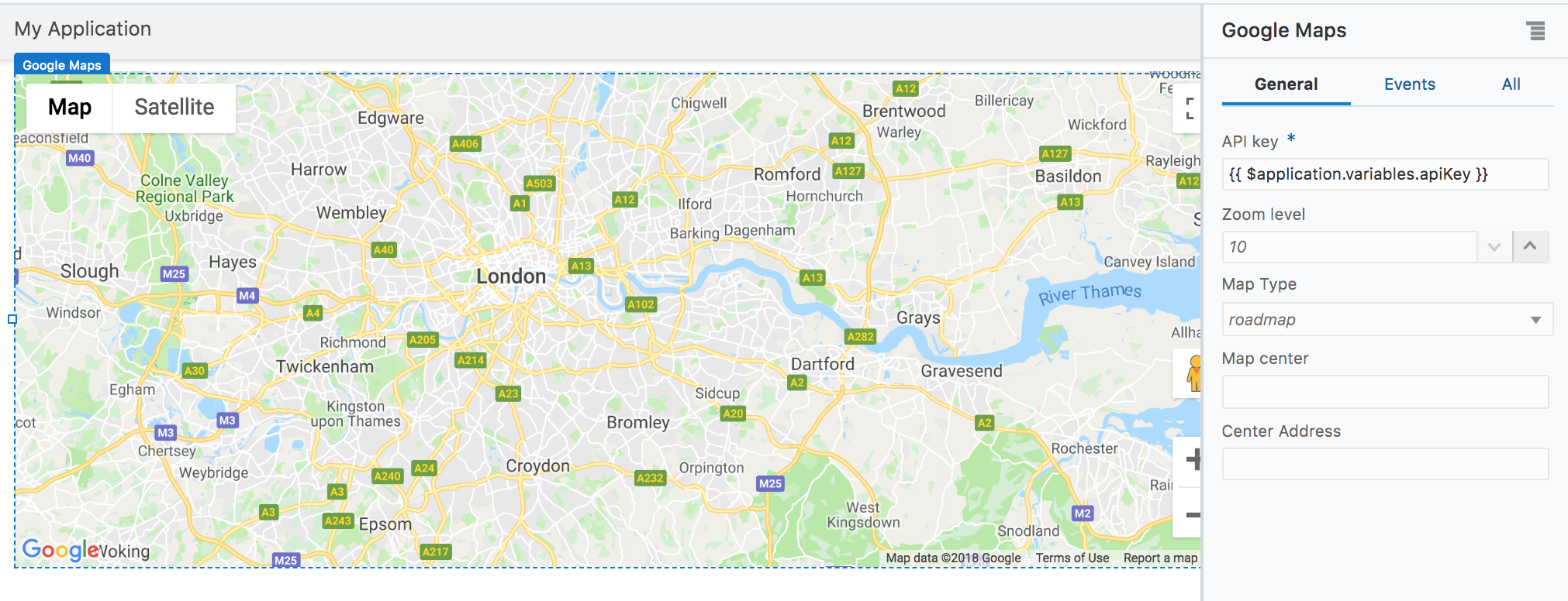

Of course as soon as the required information is supplied, the component then uses some sensible defaults to show something to the user which they can then further configure:
You’ll notice here that the property inspector is showing some default values for things like the map type and the zoom level, although the default map-centerpoint is something the component defaults internally until the component user overrides it.  This simple act of thinking about the consuming developers first encounter with your component is so important!

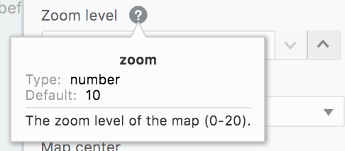

“description”
Just like displayName, the description attribute is present at various levels of the metadata and using it you can provide a additional information about the component as a whole or just a single property.  In either case you’ll see a question mark icon displayed at design time and when you hover over that you’ll get the description information displayed to help the user of the component.

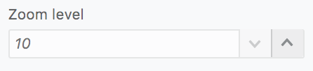

Property Level Attribute – “value”
The property level attribute value is used at runtime to provide a default value for the specified property, but it is also used at design time in Visual Builder and is displayed as a place-holder in the property inspector field so that the user can see what the default would be.  We saw this already in the screenshot of the zoom property PI. As it’s a placeholder value it is displayed as a lighter grey colour and the user can of course overtype it:

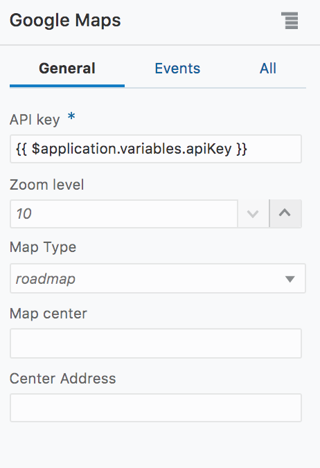

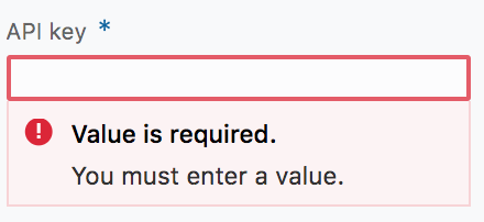

Property Level Attribute – “required”
The required attribute in the property metadata is honored in the form of an indicator (*) on the field – just a hint to the user that this is a property that really must be supplied. Here we see it on the apiKey property of the map component:
As you can see, the user will also get a gentle reminder if they still forget to provide that property!

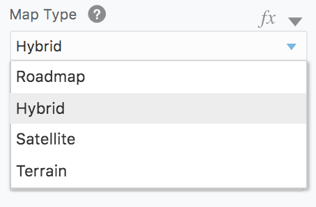

Just like the use of displayName to make the labels for properties more readable, sometimes you don’t want the actual enumeration values to be what you display in the enumValues drop-down.  If you need something more readable then you define a propertyEditorValues attribute for the property and for each enumeration optioin you can provide extra metadata for the displayName and description. Here’s an example from the mapType property:
  "mapType": {
    "description": "Display style of the map",
      "type": "string",
      "writeback": true,
      "enumValues": [
          "roadmap",
          "hybrid",
          "satellite",
          "terrain"
      "propertyEditorValues": {
          "roadmap": {
            "displayName": "Roadmap",
              "description": "Displays the basic map style concentrating on road / transport links."
          "hybrid": {
              "displayName": "Hybrid",
              "description": "Displays a mix of roadmap and satallite views."
                "satellite": {
                    "displayName": "Satellite",
                    "description": "Displays Google Earth satellite images."
                "terrain": {
                    "displayName": "Terrain",
                    "description": "Displays a physical map with roadmap overlay."
            "value": "roadmap",
            "propertyGroup": "common"
Again notice how displayName is used to provide an alternate label in the drop down (in this case capitalized versions of the possible values). Here’s the result:
Property Level Attribute – “propertyGroup”
Finally, each property can define which propertyGroup it is a part of.  PropertyGroup is a logical collection of properties and is used as a hint by Visual Builder design time to decide on which Property Inspector tab to display the property on. All properties are visible on the “All” tab in the Property inspector, but if your compoennt has an important property that needs to be set most of the time then you’ll want it to appear on the General tab of the property inspector. To do this, you set the propertyGroup attribute to “common”. Likewise you may set the propertyGroup to “data” to make the property appear on the Data tab. If we look again at the property inspector for the Map component:
You can see how I’ve just put the most important properties, those that are set nearly all the time, on the General tab. The idea here is to help the user to understand what parts of the component API are the most important to set, so consider carefully which properties you prioritze in this way.
