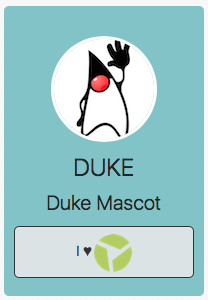

Furthermore, you can define multiple references to a named slot and the component will gather them up and place them into the slot in the order that they are defined, thus:
<ccdemo-name-badge badge-name="{{personName}}"
                   badge-image="[[personImageURL]]">
  <span slot="greetingArea">Hello</span>
  <div slot="greetingArea">
    <span>I &hearts;</span>
    <img src="https://blogs.oracle.com/images/oracle_jet_icon.png"
     style="vertical-align:middle"/>
  </div>
</ccdemo-name-badge>
Results in:
Note how the HTML nodes defined with the slot=”greetingArea” can be of different types.
