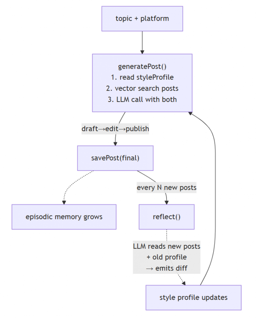

Here’s the loop:
Flowchart showing a writing workflow. A topic and platform feed into generatePost(), which reads a style profile, performs vector search over previous posts, and calls an LLM. After drafting, editing, and publishing, the final post is saved. Saved posts expand episodic memory. Every N new posts, a reflection step compares new posts with the existing style profile, generates updates, and feeds the revised style profile back into future post generation.
Published posts build episodic memory, while periodic reflection updates the style profile used for future content generation.

The applyDiff function is simple. It iterates through the additions and removals, and edits the profile object in place. It’s in the repo if you’re interested. I need to point out again that the only reason applyDiff works is because we tell the model to be conservative with its reflections. Remember, we don’t want wild swings in the profile. Your posts won’t make it past the “AI sniff test” if you’re calm and collected one day, and corporate and metric-driven the next.
If that does happen though, we can use the reflection log as a point-in-time snapshot we can rollback to. Just rebuild from a previous profile_after snapshot and the agent effectively “unlearns” that unwanted style.
Agent memory in action
Now that we’ve gone through all three types of memory, it’s time to build the generatePost function and see them all in action as we compose the prompt.
// src/server/agent.ts
import { chat } from './llm';
import { loadStyleProfile, retrieveSimilarPosts } from './memory';
export async function generatePost(args: {
  userId: string; platform: string; topic: string;
  const profile = (await loadStyleProfile(args.userId)) ?? {};
  const examples = await retrieveSimilarPosts({ ...args, k: 5 });
  const examplesText = examples.map((e) => e.content).join('\n\n---\n\n');
  const system = `You are drafting a social media post in the user's voice.
    STYLE PROFILE (how this user writes):
    ${JSON.stringify(profile, null, 2)}
    EXAMPLES (recent posts by this user on similar topics):
    ${examplesText}
    Write ONE draft post. Match the style profile and the cadence of the examples. Do not copy phrases from the examples. Do not mention that you are an AI or that you are following a profile.`;
  const draft = await chat({
    system,
    user: `Platform: ${args.platform}\nTopic: ${args.topic}`,
  return { draft, basedOn: examples };
That’s it. That’s the whole thing. This is deceptively simple. It’s doing two database reads to load the profile and perform a vector search, AND it’s making a call to an LLM.
The agent will get better over time. The first time you use it, it will sound like everything else you see on social media these days. But as you edit the drafts and build up the data with examples in your true voice, it gets better and eerily starts sounding like you.
