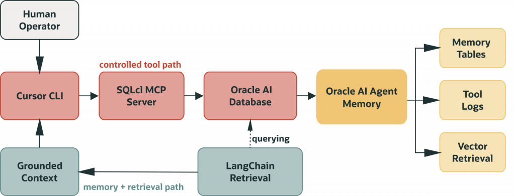

Here is how those components connect in this pattern. The important visual point is that Cursor does not connect directly to Oracle AI Database. Cursor calls SQLcl MCP tools, SQLcl uses a saved Oracle connection, and Oracle AI Database remains the durable store for memory records, retrieval evidence, vectors, and tool traces. Oracle AI Agent Memory and LangChain sit in the application layer after that database-backed path is in place.
Production success depends less on clever prompting and more on boundaries, privileges, logging, scoped retrieval, and repeatable runbooks.

Architecture diagram showing a human operator using Cursor CLI and SQLcl MCP Server to access Oracle AI Database and Oracle AI Agent Memory, with memory tables, tool logs, vector retrieval, LangChain retrieval, and grounded context.

The workflow has five layers. Cursor CLI is the developer-facing agent interface. SQLcl MCP is the tool boundary. Oracle AI Database is the durable substrate for memory, traces, and retrieval. The notebook is the build-and-validation harness that proves the pieces are wired correctly before the workflow is handed to Cursor.
Layer Responsibility
Cursor CLI Developer-facing MCP client and agent interface.
SQLcl MCP Exposes declared Oracle tools to Cursor; it is the tool boundary.
Oracle AI Database Stores durable data, retrieval evidence, vectors, metadata, traces, and enforces database privileges.
Oracle AI Agent Memory Provides application APIs for users, agents, threads, durable memories, scoped retrieval, and context assembly.
LangChain  Wraps Oracle-backed retrieval results as Document objects and supports application-side orchestration.

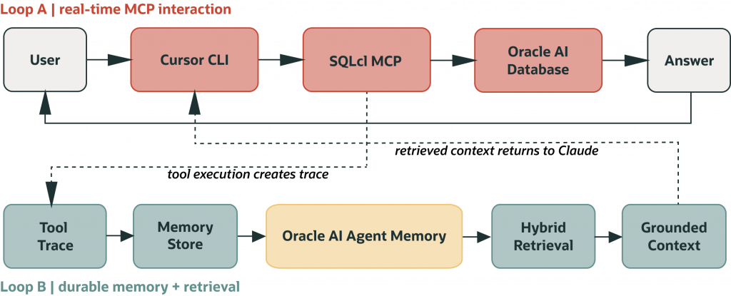

The Two Execution Loops
Building on that split between tool boundary and durable store, the system naturally forms two execution loops:
  • Loop A is the operational interaction loop: Cursor CLI works with MCP to discover tools, inspect data, run bounded read-only queries, and return results immediately.
  • Loop B is the durable memory and retrieval loop: application code writes history, tool logs, memory records, chunks, and embeddings to Oracle AI Database, then retrieves context before a later answer or workflow step.
Diagram showing User to Cursor CLI to SQLcl MCP to Oracle AI Database to Answer, with a second loop where tool traces enter a memory store, Oracle AI Agent Memory, hybrid retrieval, and grounded context returned to Claude.
Dual Execution Loop: MCP Interaction and Durable Memory
SQLcl MCP handles live tool use. Oracle AI Agent Memory handles durable memory and scoped recall. Most production setups need both loops, but they solve different problems.

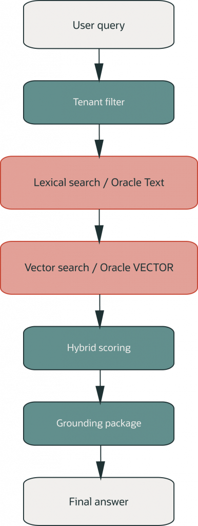

In practice, hybrid retrieval for agent memory usually combines exact operational terms, such as sql -mcp or cursor_mcp, with semantic search over memory records.
The notebook shows the lower-level mechanics first so the storage and retrieval path is visible. This is also a context engineering problem: the application has to decide which memories, tool traces, and retrieval results should be assembled before Cursor or another assistant answers. Oracle AI Agent Memory then gives application code a cleaner package API over that same database-backed idea.

  • Native VECTOR readiness means the database can store and search vectors through the Oracle AI Database vector path.
  • Deterministic demo embeddings are local, repeatable vectors used so the notebook can run without external model billing.
The deterministic embeddings are useful for portability and inspection, but they should not be described as productionsemantic embeddings. For production, replace the notebook’s demo_embed() or LocalCursorEmbedder with a supported embedding model after cost, latency, privacy, and retrieval-quality review.
The final notebook snapshot makes this separation explicit with two rows: Native VECTOR execution path and Demo embeddings.
Vertical flow from user query through tenant filter, lexical search using Oracle Text, vector search using Oracle VECTOR, hybrid scoring, grounding package, and final answer.
Hybrid search pipeline combining tenant filtering, Oracle Text lexical search, Oracle VECTOR search, scoring, and a grounding package.
