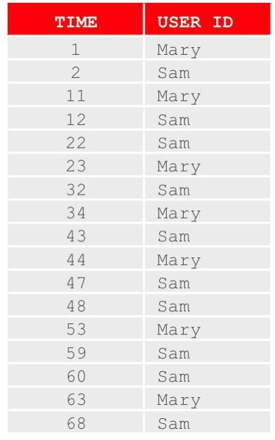

This is the default behaviour and in many circumstances this is the most obvious choice. In these situations the searching for the next pattern it makes sense to resume at the row after the last match since going back over previous rows does not make any sense and would only result in more rows than necessary being processed. For example, let’s look at the sessionization example: http://oracle-big-data.blogspot.co.uk/2014/02/sessionization-with-12c-sql-pattern.html and if you want to try the code see the tutorial on the LiveSQL site.
 Looking at the source data for the sessionization example it’s clear that as we walk through the entries in the log file to check if an entry is part of the current session or not, there is no point in stepping backwards to begin searching again once a match has been found.
Source data for sessionization example
You can run the code for this sessionization example on LiveSQL.

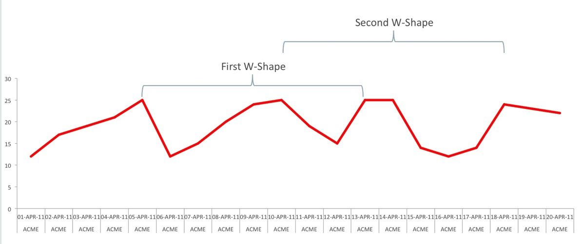

Looking for shapes and controlling skipping
As I previously stated, you might think the obvious position to start searching for the next occurrence of a pattern is the next record after the last row of the current match. But what if there are overlapping patterns where the middle of an earlier match overlaps with the start of the next match? For example if we are looking for a w-shaped pattern within our ticker data set then it is quite possible to have overlapping w-shapes where the next “W” starts within the second down phase of the previous ”W”.
Fortunately MATCH_RECOGNIZE  provides great flexibility in terms of being able to specify the restart point. If we look at the source data for the ACME symbol within our ticker data set then we can see that there are overlapping W-shapes (assuming we allow for the flat-top in the middle of the 2nd w-shape by using the <= and >= tests for each pattern variable!).
Twin W-shapes within source data

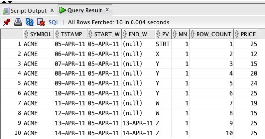

and if we expand the output, using ALL ROWS PER MATCH, so we can see how the pattern was matched we can see that it starts on 05-Apr-11 with pattern variable STRT and ends on 14-Apr-11 with pattern variable Z.
All rows report for single W shape

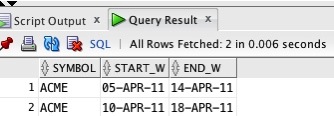

Now let’s change the above code sample so that after the first pattern has been found we begin searching at the row after the end of the matching process for the Y variable – i.e. row 6, 10-Apr-11.
SELECT *
FROM Ticker MATCH_RECOGNIZE (
 PARTITION BY symbol ORDER BY tstamp
 MEASURES STRT.tstamp AS start_w,
          LAST(z.tstamp) AS end_w
 ONE ROW PER MATCH
AFTER MATCH SKIP TO LAST Y
 PATTERN (STRT x+ y+ w+ z+)
 DEFINE
     x AS x.price <= PREV(x.price),
     y AS y.price >= PREV(y.price),
     w AS w.price <= PREV(w.price),
     z AS z.price >= PREV(z.price)
) MR
WHERE symbol=’ACME’
ORDER BY symbol,start_w;
which now finds two w-shapes with the second W starting on 10-Apr-11 and ending on 18-Apr-11:
Two w shapes within ticker data stream

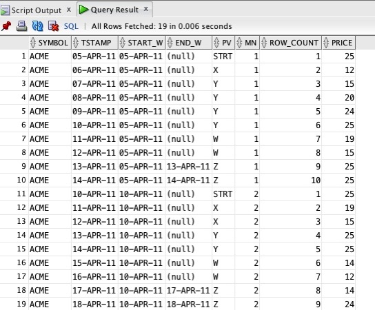

but what is going on under-the-covers?
SELECT *
          LAST(z.tstamp) AS end_w,
          classifier() AS pv,
          match_number() AS mn,
          count(*) as row_count
 ALL ROWS PER MATCH
 DEFINE
) MR
WHERE symbol=’ACME’
ORDER BY symbol, mn, tstamp;
now shows us that the records for 10-Apr-11 to 14-Apr-11 were actually processed twice:
Detailed report for 2 w-shapes

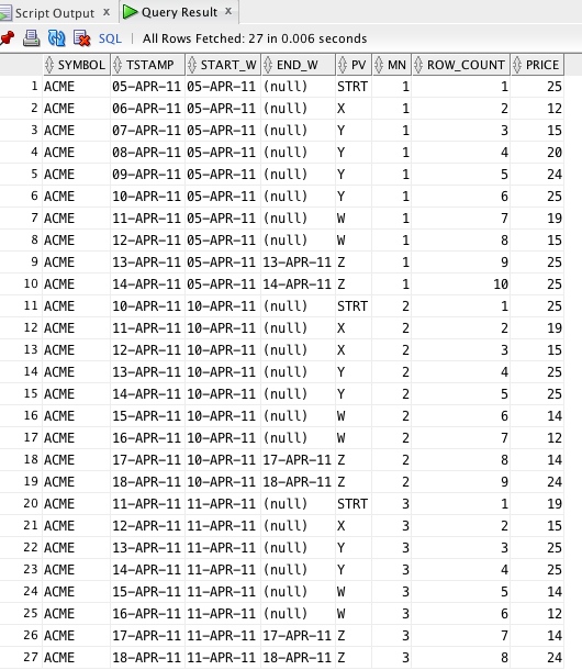

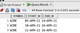

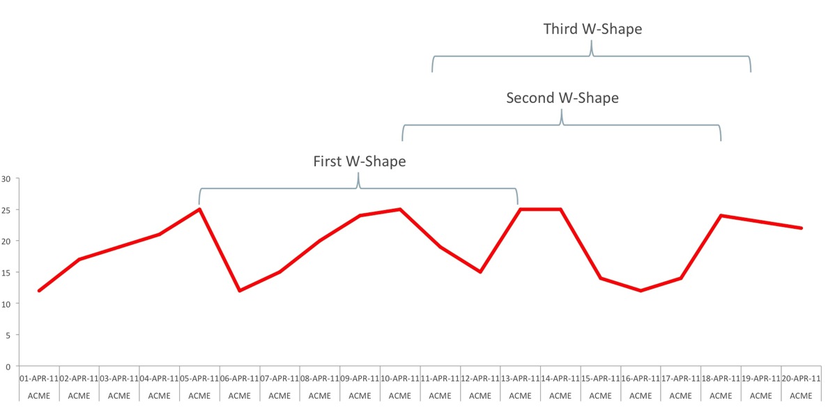

What about using the SKIP TO NEXT ROW syntax? How does that affect our results? It is important to remember that this will force MATCH_RECOGNIZE to resume pattern matching at the row after the first row of the current match. Using our ticker data we can see that this would actually increase the number of W-shapes to three!
3 W shapes in our ticker data stream
In match 2 we have two occurrences of pattern variable x, there once the second W-shape has been matched the search process restarts on row 12, i.e. the first row of the current match, which is row 12 mapped to STRT.
SELECT *
 ONE ROW PER MATCH
 AFTER MATCH SKIP TO NEXT ROW
 DEFINE
 ) MR
WHERE symbol=’ACME’
ORDER BY symbol, mr.start_w;
creates the following output:
Three w shapes within ticker stream
and if we change our code to return the more detailed report we can see how the pattern is being matched:
SELECT *
          classifier() AS pv,
 ALL ROWS PER MATCH
 DEFINE
) MR
WHERE symbol=’ACME’
which produces the following output:
Detailed report showing mapping of 3 w-shapes
Note that match two, the 2nd W-shape, starts on line 11 but we began the search for this second match on row 2, i.e. the next row after the first start variable. Similarly, the search for the third W-shape on row 12 after the second STRT variable. Given that our original data set for ACME only contained 20 rows you can see from this example how it is possible to do a lot more processing when you start to fully exploit the power of the AFTER MATCH SKIP syntax.
