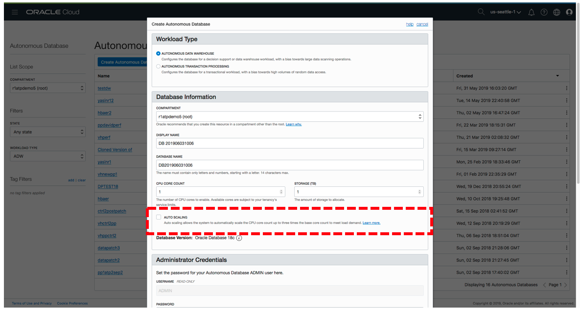

Creating a new “auto scaling” data warehouse

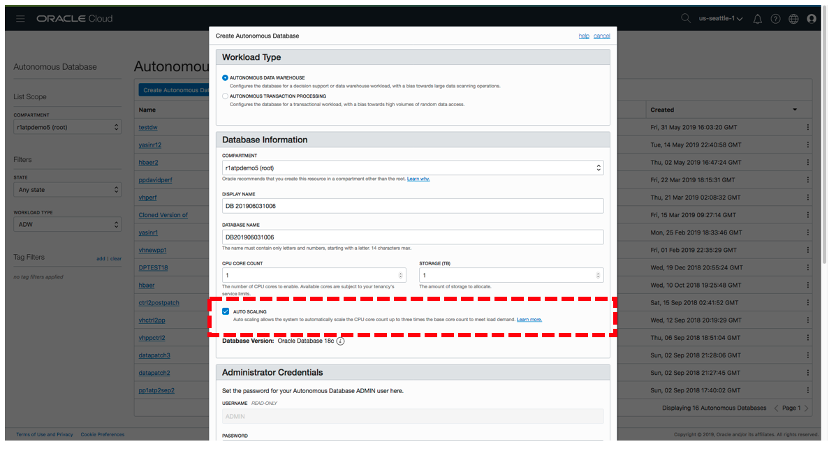

 If you have already created a few data warehouses in the Oracle Cloud then you will be familiar with the very simple pop-up form we provide to create a new autonomous data warehouse. From today you should notice a new check box just underneath the boxes where you decide how many OCPUs and how much storage you need….
Screen Shot 2019 06 04 at 21 08 38
It says “Auto Scaling” and the associated text explains what the feature does – essentially what I just explained above. Simply click the check box and that’s it.
Screen Shot 2019 06 04 at 21 10 52
In one single click you have created a super smart, autonomous data warehouse that is going to scale itself based on your workload. Really, we could not have made it any easier!

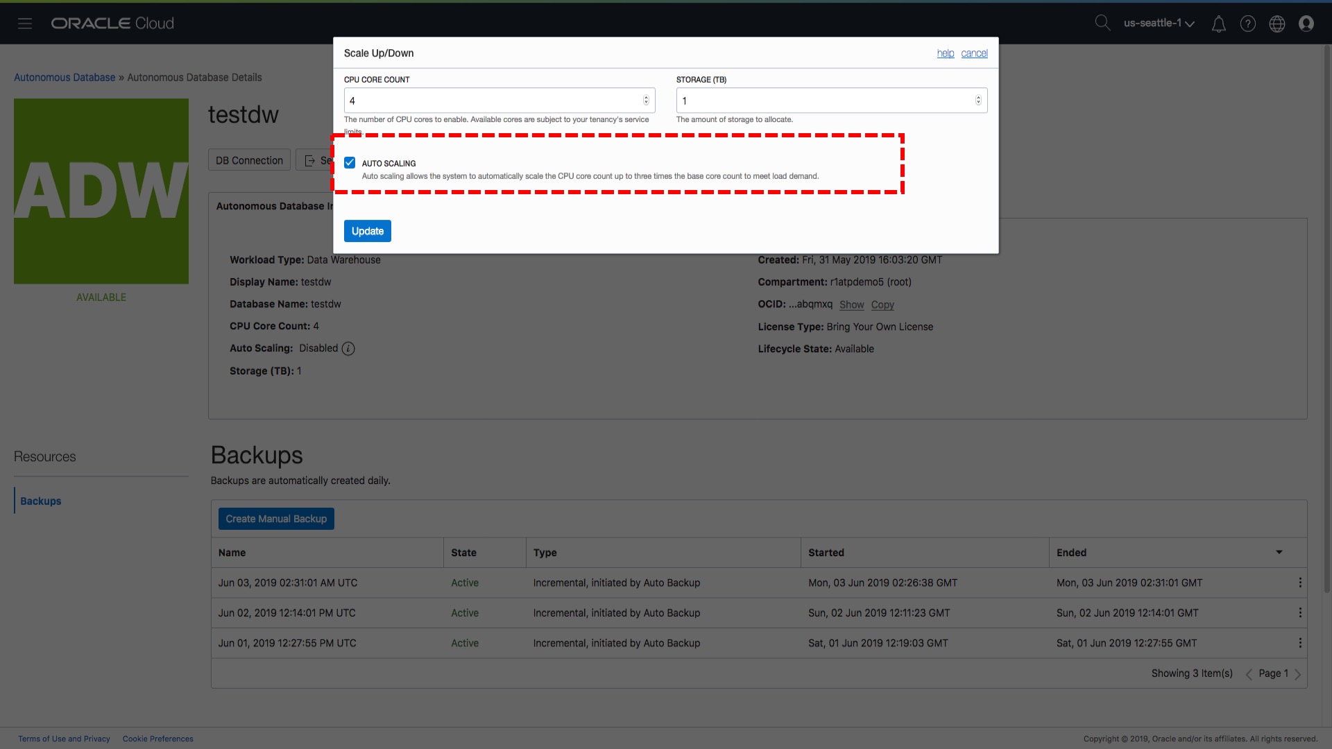

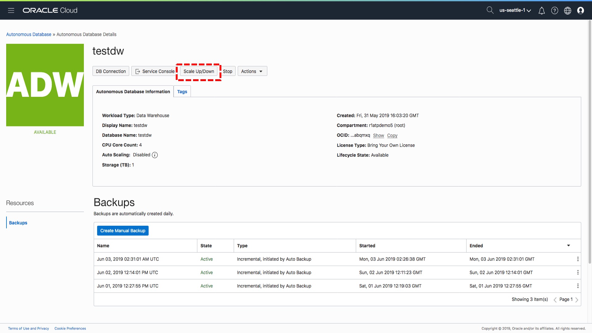

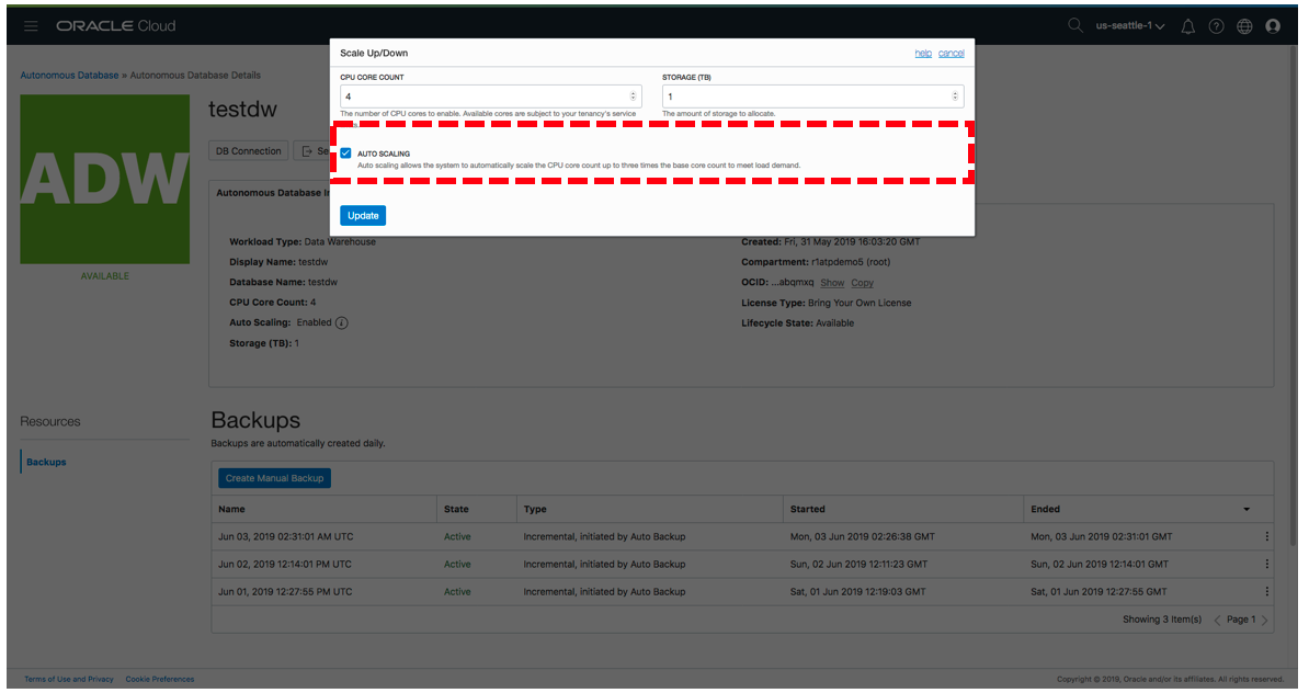

So what do you do if you already have an autonomous data warehouse and it’s being used non-stop, every day. Great news, you can switch on auto scaling for an existing data warehouses with a single click. All you need to do is click on the “Scale Up/Down” button on the OCI console and this pop-up form which manages scaling also now contains a new check box to enable (and disable) auto scaling.
Screen Shot 2019 06 04 at 21 15 41
Enabling auto scaling on an existing instance requires zero downtime. We have made it super easy for you to take advantage of this important new feature.

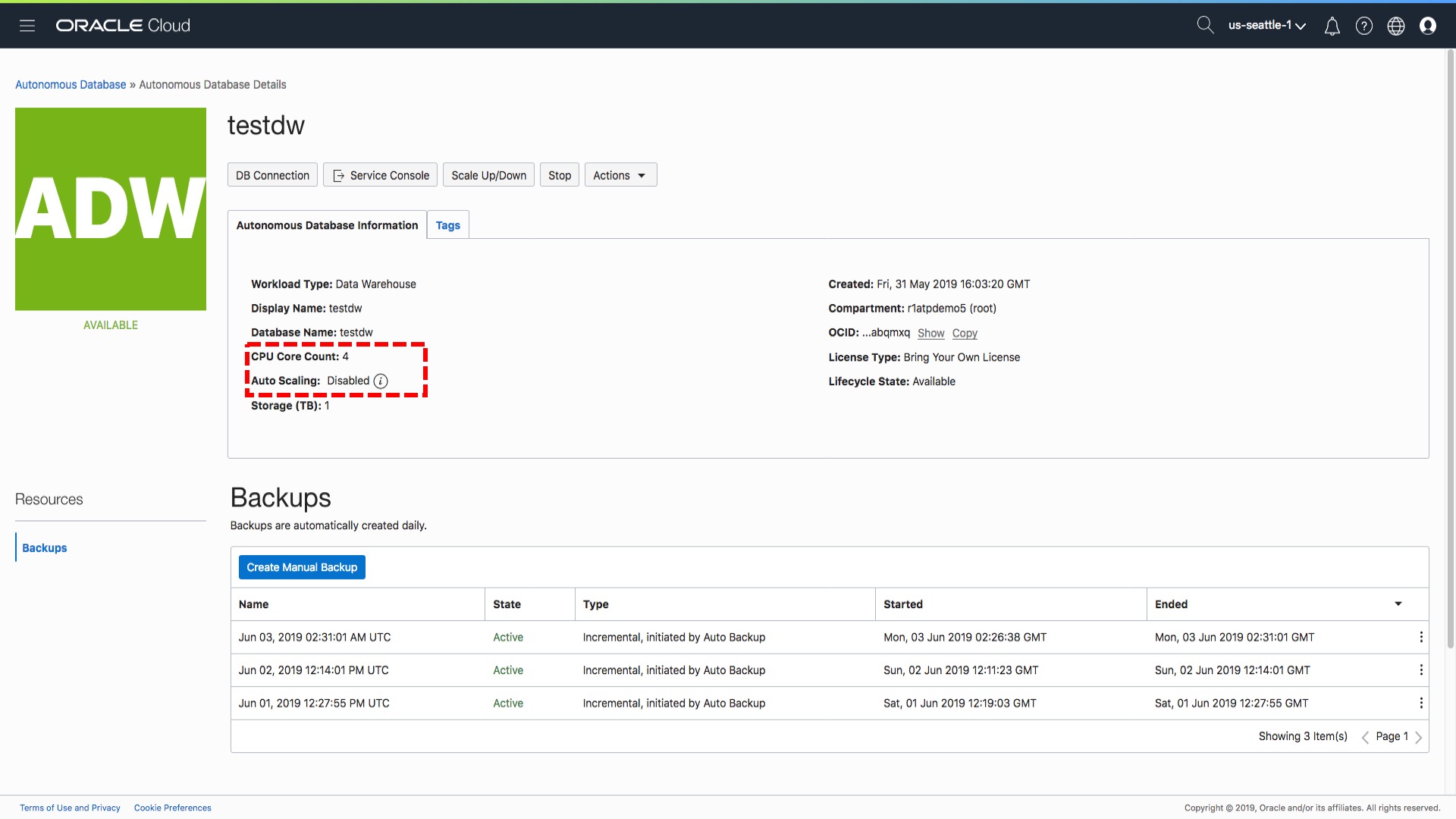

Let’s work through a simple example. Suppose I have an existing Autonomous Data Warehouse with 4 OCPUs and 1TB of storage and auto scaling is not enabled (i.e it’s disabled).
Slide21
First step is to enable the auto scaling feature by clicking on the “Scale Up/Down” button…
Slide22
and clicking on the Auto Scaling check box

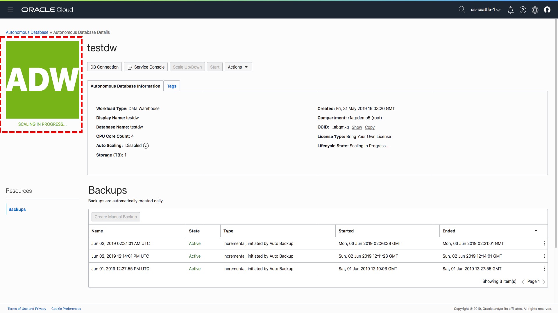

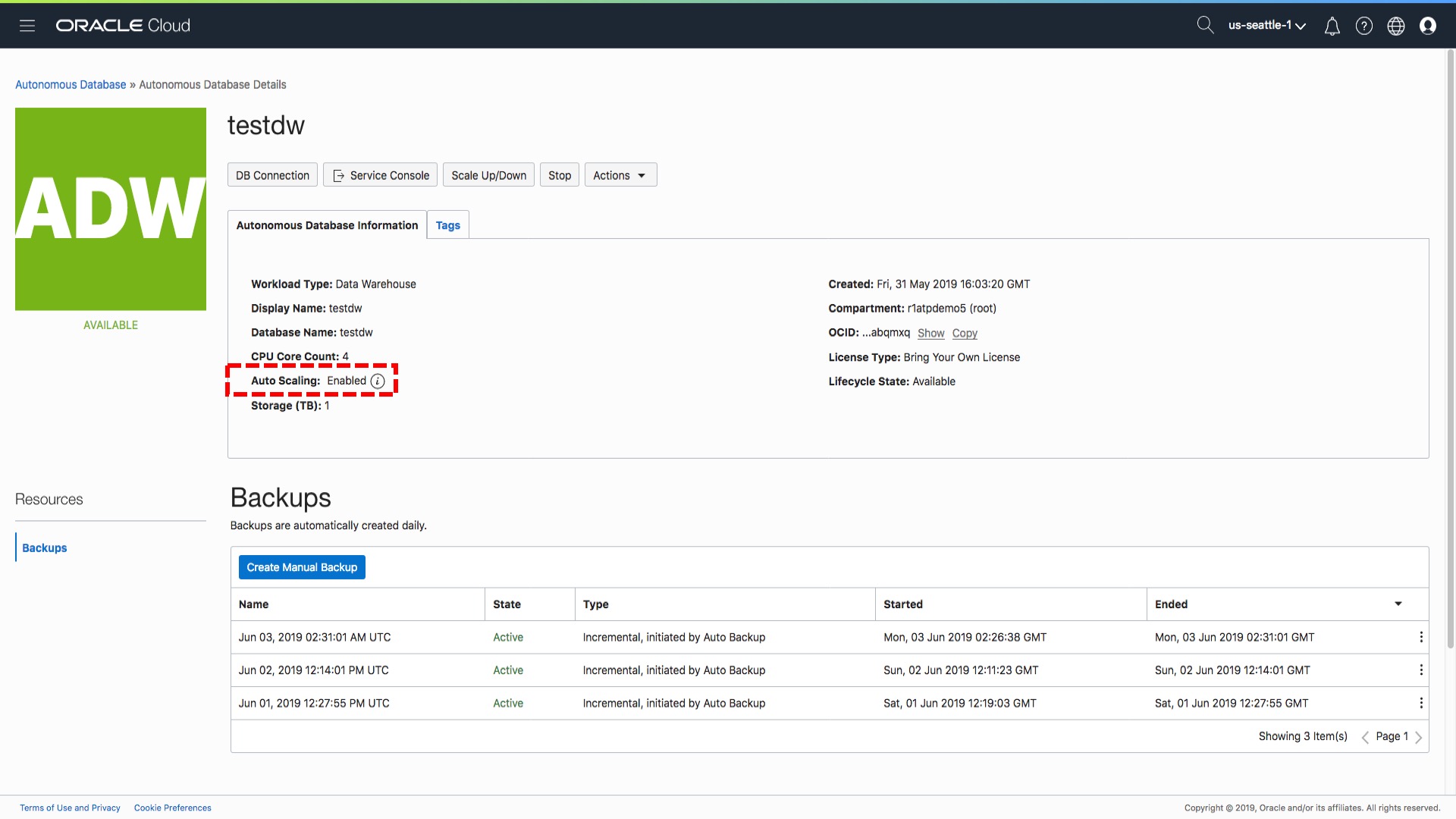

as soon as I click on the blue Update button my instance will switch to “SCALING IN PROGRESS” mode.
Slide25
at this point my data warehouse is still online and fully available. In the background the system is setting up the infrastructure so the data warehouse can just expand itself as the workload grows. Notice at this point, the system is still showing that auto scaling is disabled. After about a minute the status area will change to “AVAILABLE” and auto scaling will be enabled.

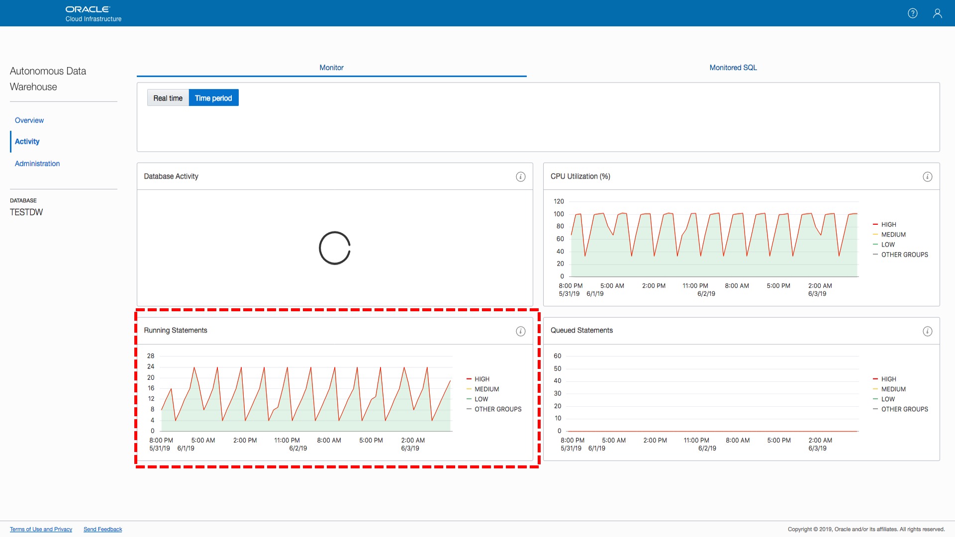

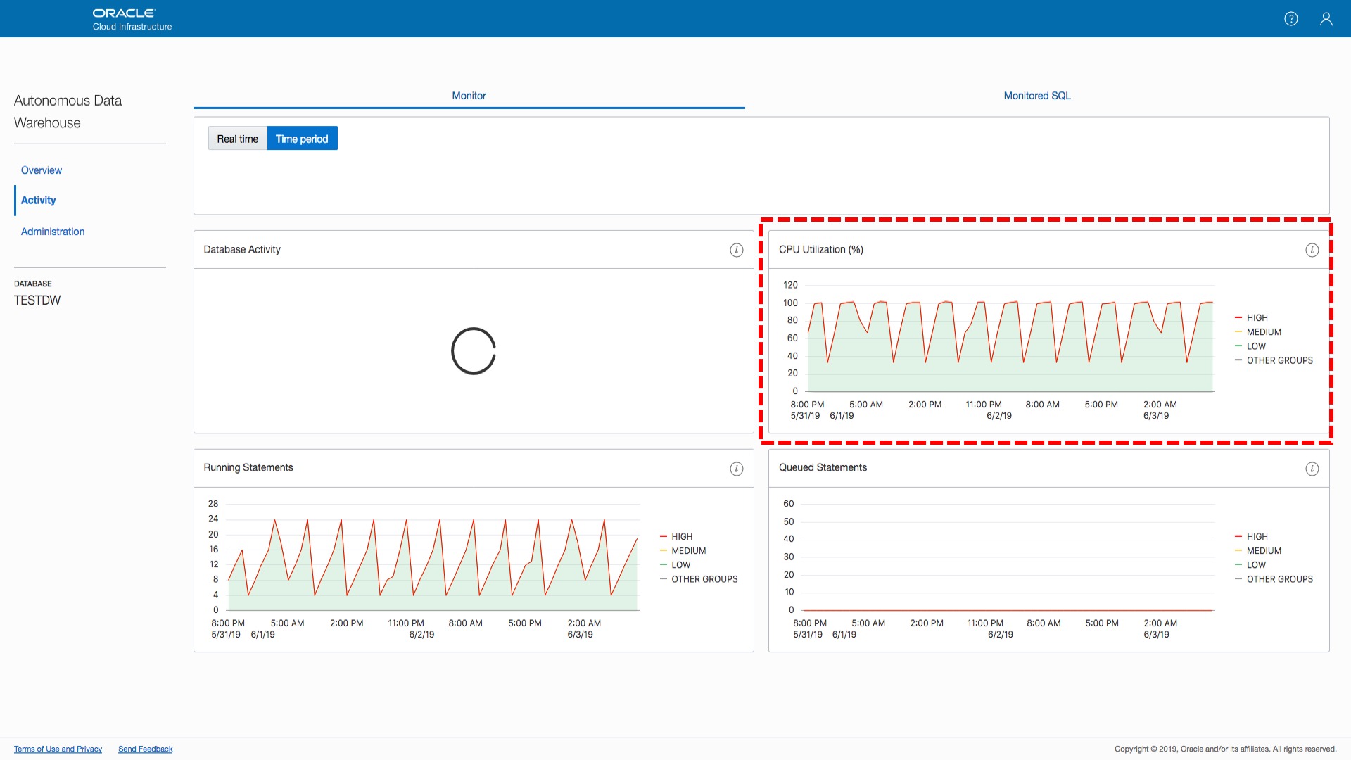

Now let’s throw some queries at this data warehouse. In fact let’s use up all the OCPU capacity on the system and let’s run this workload a number of times at different points in the day and see what happens. If we switch to the Service Console we can monitor the resources and workload on our data warehouse. In the service console graphs below you can see that my workload peaks at around 24 queries and that same workload kicks off at different points in time throughout the day, hence the spikey looking graph…
Slide32
You will notice that when my queries are running the CPU utilization hits 100%…
Slide33

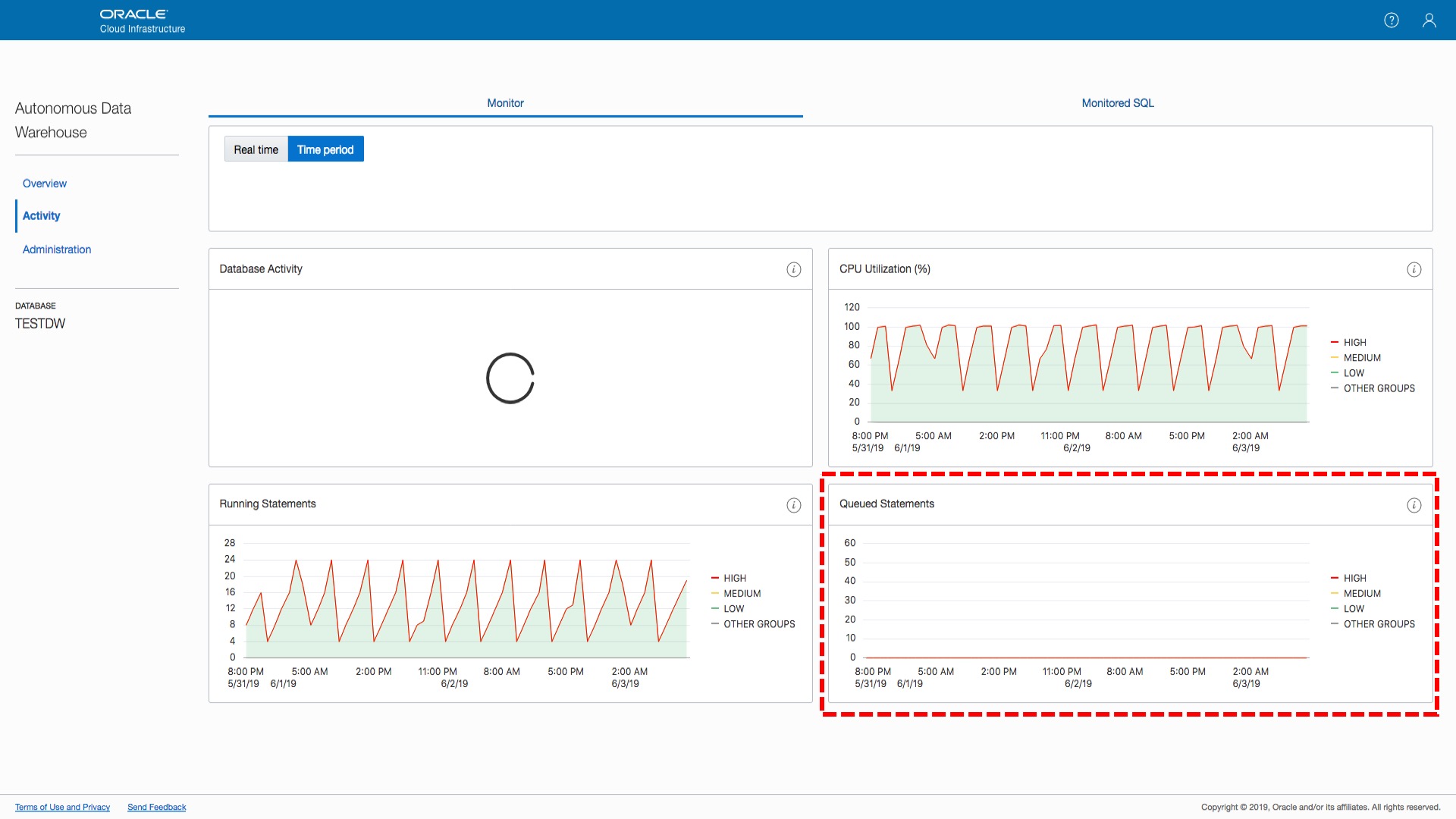

But there is something odd going on here because I am maxing out on the OCPU resources but I am not seeing any sign of queries getting queued?
Slide34
What is going on here? Well it’s got nothing to do with auto scaling and here’s why…Firstly, you will notice that my queries are running in the low resource group so queries here won’t get queued. Secondly, enabling auto scaling does not change the concurrency and parallelism settings for the predefined services. See Managing Concurrency and Priorities on Autonomous Data Warehouse section in the documentation for more information.

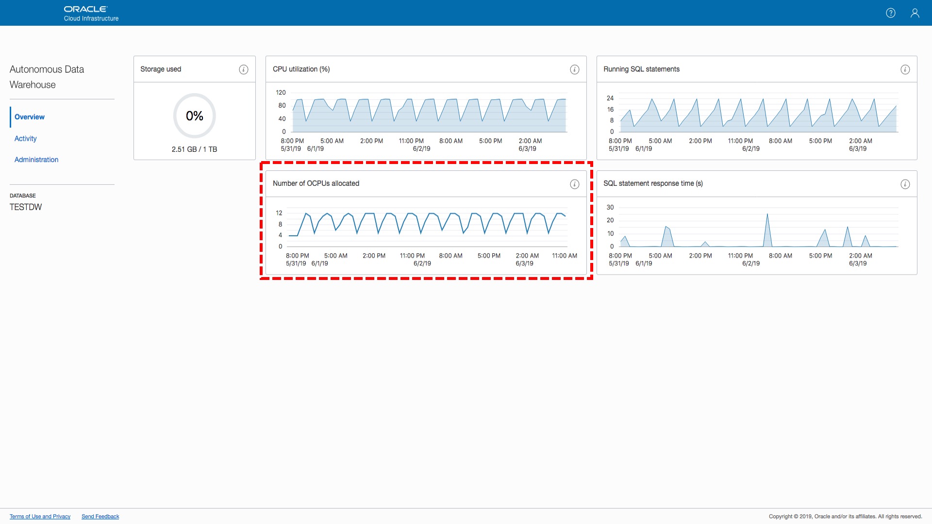

Anyway, if we switch over to the “Overview” graphs we can track what’s happening to the number of OCPUs being used by my data warehouse…
Slide36

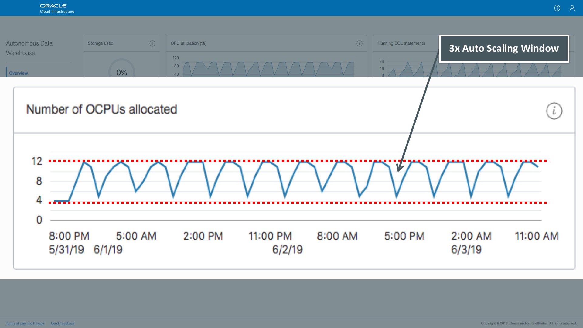

in the graph showing number of OCPUs allocated you can see that with auto scaling the graph is no longer a straight line over time. The number of OCPUs is fluctuating and the reason it’s fluctuating is because my autonomous data warehouse is reacting to the size of my workload by automatically adding, totally transparently behind the scenes, more OCPUs. Each time we get close to fully using all the OCPU capacity, the system adds more OCPUs up to my maximum of 3x the original starting number (which in this case was 4 OCPUs). This means I have a window of between 4 and 12 OCPUs that I can use to run my workload.
