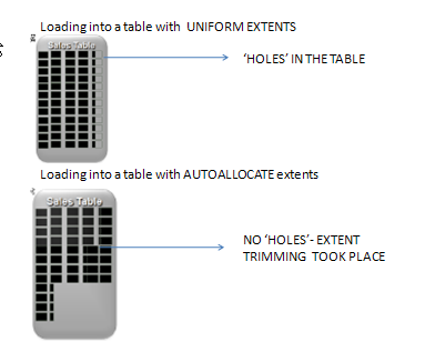

For performance reasons most loads leverage direct path operations where the load process directly formats and writes Oracle blocks to disk instead of going through the buffer cache. This means that the loading process allocates extents and fills them with data during the load. During parallel loads, each loader process will allocate it own extent and no two processes work on the same extent. When loading data into a table with UNIFORM extents each loader process will allocate its own Uniform extent and begin loading the data, if the extents are not fully populated the table is left with a lot of partially filled extents, effectively creating ‘HOLES’ in the table. Not only is this space wastage but it also impacts query performance as subsequent queries that scan the table have to scan all of the extents even if they are not fully filled.
What is different with AUTOALLOCATE? AUTOALLOCATE will dynamically adjust the size of an extent and trim the extent after the load in case it is not fully loaded (Extent Trimming)

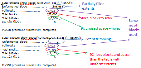

Let’s view the space usage using a PL/SQL package called show_space .
As you can see from the results there are no unformatted blocks in the autoallocate table as extent trimming has taken place after the load was complete. The same can not be said for the uniform_test table. It is quite evident from the numbers that there is substantial space wastage in the uniform_test table. Although the count of full blocks are the same in both cases, the Total Mbytes used is 10x greater in the Uniform table.
