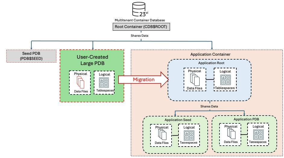

This blog demonstrates the use case where you already have a very large PDB and want to create an Application Container without having to execute a full database clone. The diagram below describes a large PDB hosted in the same Container Database (CDB) as the target Application Container. The steps described below are relevant for environments where the source large PDB is hosted in another CDB.
Diagram 2. Oracle Multitenant Large Pluggable Database Migration as Application Root
