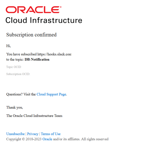

Step 3: Respond to the Verification message
  1. You will receive a message notification in Slack of your subscription. Go to Slack and click on the Confirmation URL.
  2. A browser tab will open, confirming that you have subscribed your webhook to the topic: Database-Notification.
    subscription confirmed

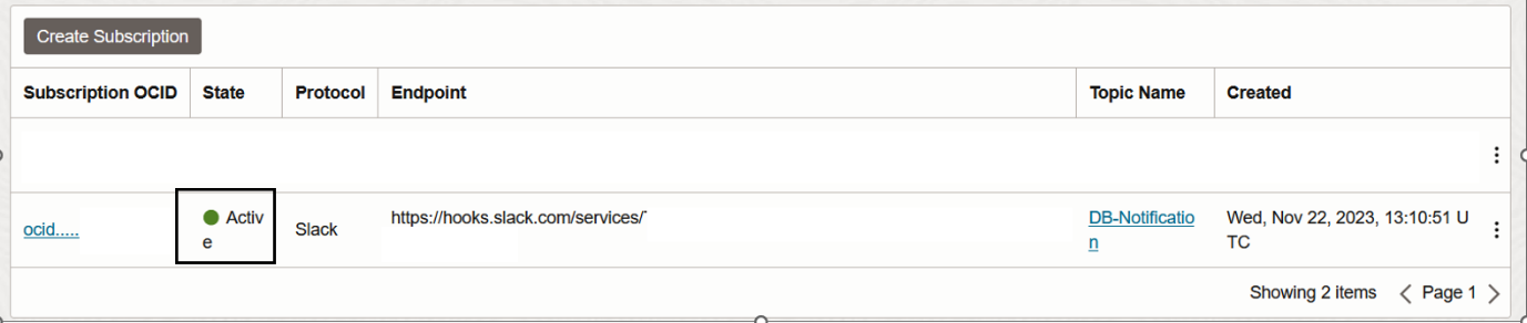

Step 4: Verify that Subscription Status Has Changed from Pending to Active
Your verification will change the subscription status from pending to active.
  1. Switch back to OCI console window and verify the subscription status changed to Active. You may need to refresh your browser.
    verify subscription

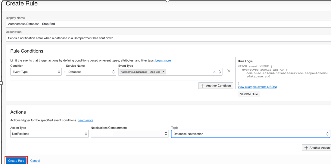

Step 5: Define an Event with Rules that Will Publish Messages
Let’s define an event that triggers a Slack notification when an Autonomous Database is stopped.
  1. From OCI Services menu, click Observability & Management > Rules.
    go to rules
  2. Click Create Rule
    create rule
  3. Fill out the dialog box:
    • DISPLAY NAME : Provide a name, such as the event type that you will be choosing; like Autonomous Database – Stop End.
    • DESCRIPTION : Provide a description.
    • Under Rule Conditions
      • Condition: Event Type
      • SERVICE NAME: Database
      • EVENT TYPE : Choose Autonomous Database – Stop End from the drop down menu.
    • Under Actions
      • ACTION TYPE: Notifications
      • NOTIFICATIONS COMPARTMENT: Choose your compartment.
      • TOPIC: Choose the topic created earlier, Database-Notification.
  4. Click Create Rule
    completed rules
You have configured a Notification service and tied an event to it with a specific compartment. When a database is shut down, a notification will be sent to the Slack channel associated to the webhook.

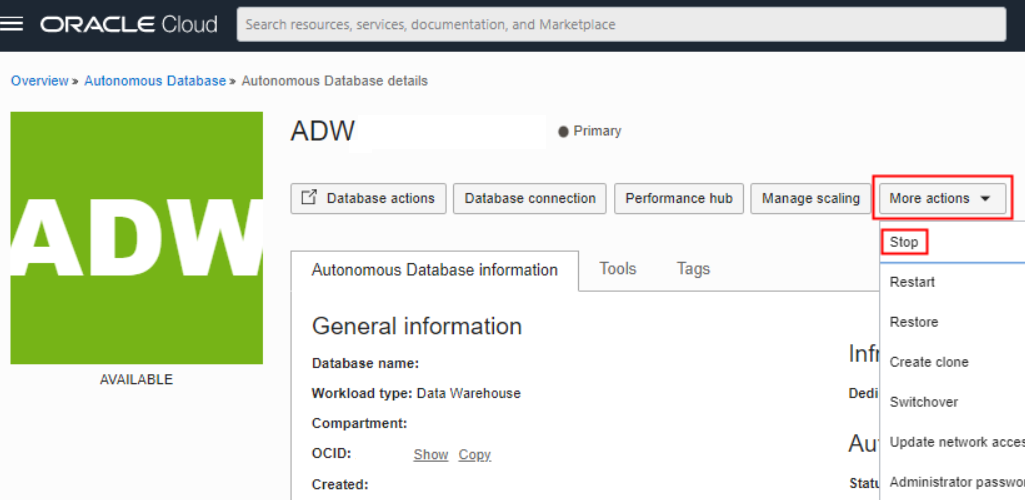

Step 6: Trigger the Event
Now, shut down the Autonomous Database to trigger the notification.
  1. Navigate to your Autonomous Database’s Details page. From the More Actions drop-down menu, select Stop.
    stop adb
  2. In the confirmation dialog box, click Stop.
  3. Wait until the database status changes to STOPPED.
