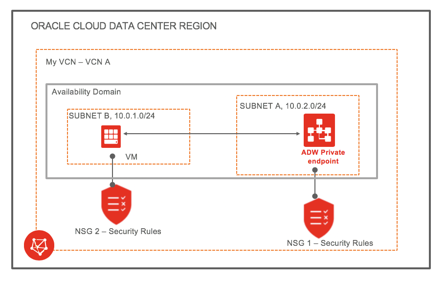

Let’s start with my VCN setup and walk you through the steps necessary to securely use the Mongo API on the machines you want. (Picture courtesy of the referenced blog):
Network diagram that shows an application running in the same VCN as the database.

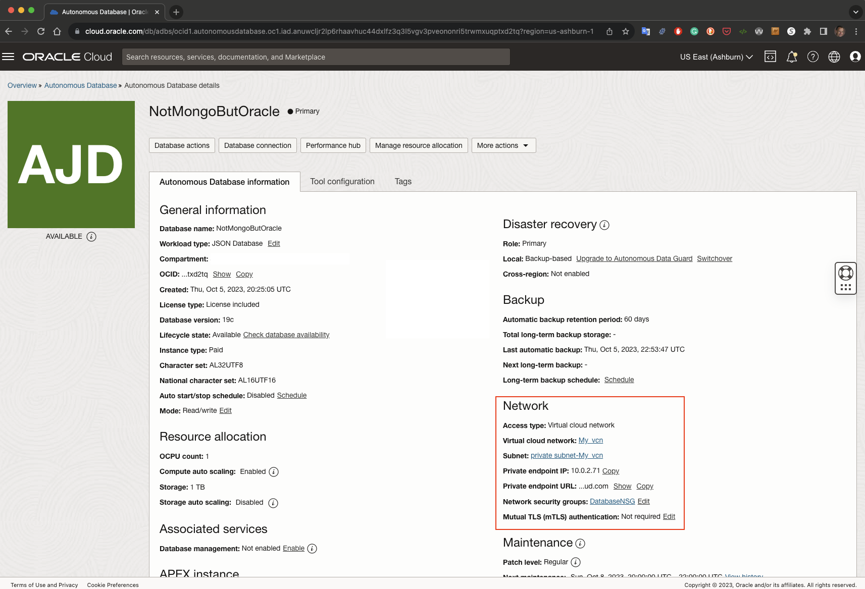

As you see, my Autonomous Database is in a private subnet (SUBNET A), and the network security rules only access from my second public subnet (SUBNET B). (Details on this in a moment.) Here is what my database looks like in detail. You can see that its private IP address is 10.0.2.71 and the network security group is DatabaseNSG. We will look at that one in a second.
AJD detail view on OCI Console

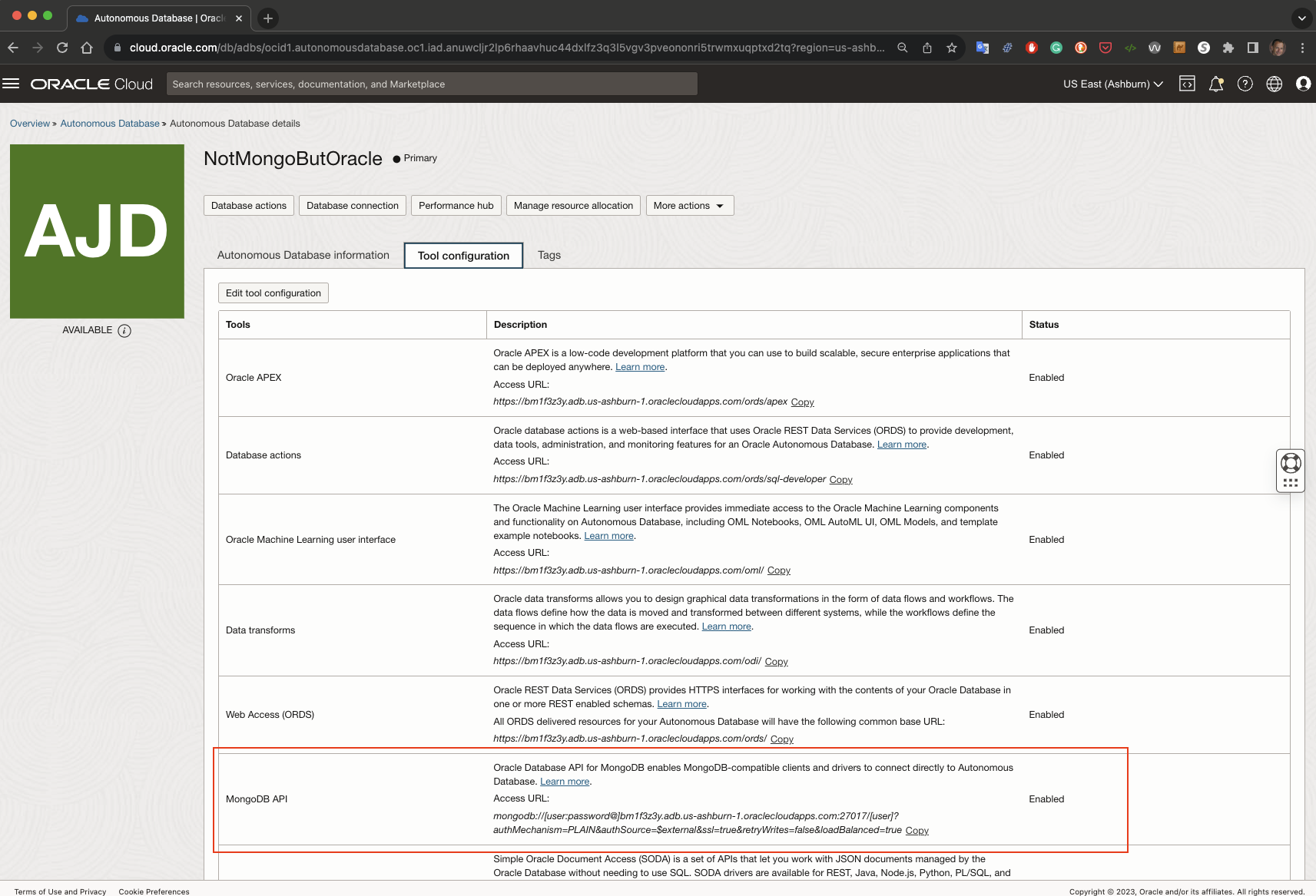

To ensure that the Mongo API is enabled, go the the OCI Console and look under the Tool configuration tab. It will show you whether your Mongo API is enabled or not. Now is also a good time to copy the connect string, which can be done conventiently on the same screen:
Tool configuration tab of Autonomous Database on OCI Console
The database and Mongo API is ready for you. I copy the connect string as shown on the console:
mongodb://[user:password@]bm1f3z3y.adb.us-ashburn-1.oraclecloudapps.com:27017/[user]?authMechanism=PLAIN&authSource=$external&ssl=true&retryWrites=false&loadBalanced=true
If I want to use it later on I only have to replace ‘user’ and ‘password’ in the connect string.

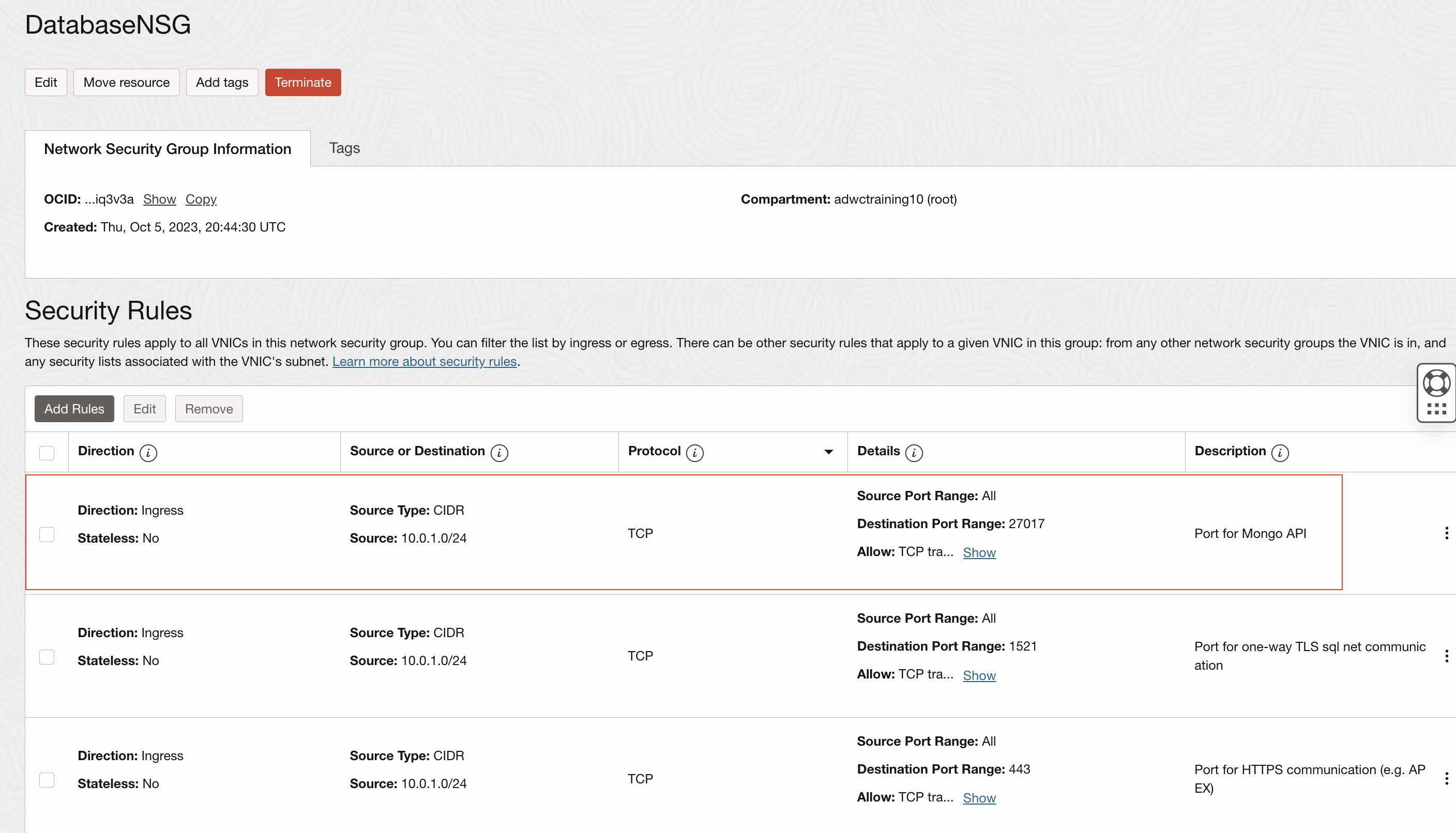

Open your firewall for Mongo API
By default, the firewall setting is very restrictive and lacks the proper database firewall setting. We need to allow the communication (ingress/egress) for our database. You will not be able to connect to your database in any way without further actions.
The only thing on the database side you have to do is adjust your ingress/egress rules to allow the usage of Mongo API. Your database has to be able to (A) be talked to on the port used for the Mongo API (ingress) and be able to answer (egress). As in real life, there’s no good conversation if neither party contributes.
When doing this with my sample VCN setup, I add TCP port 27017 to the list of allowed ports/protocols to my network security group DatabaseNSG to communicate between my private subnet (10.0.2.0/24) and my public subnet (10.0.1.0/24). So my network security rules look as follows with the inclusion of port 27017 for the Mongo API:
NSG rules for Mongo API
You see that I also added rules for both SQL Net one-way TLS (1521) and APEX (443), but we won’t delve into those. That’s what the other blog post is good for.

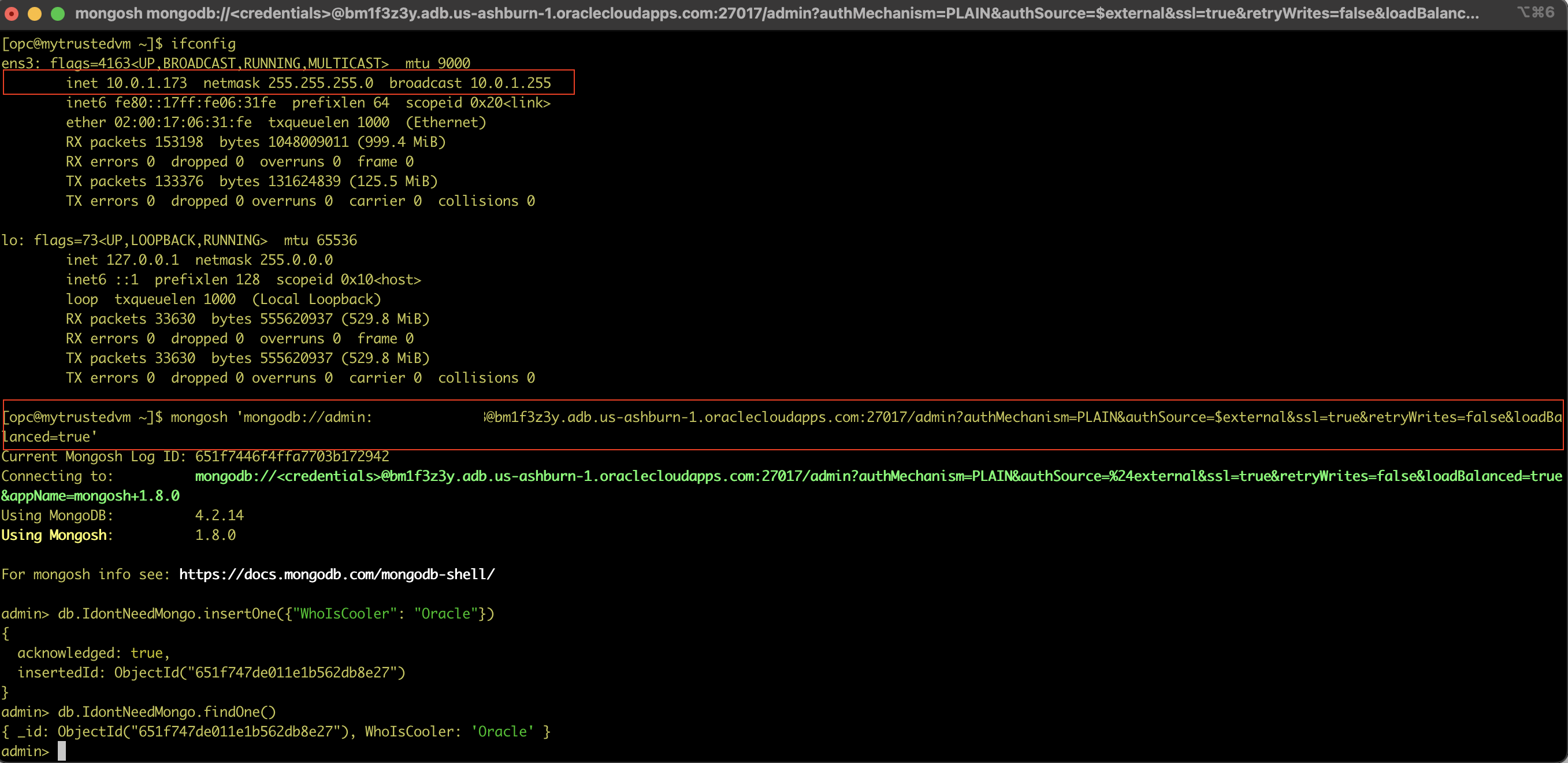

Connect from a VM within the allowed CIDR block
We are ready to connect to our Autonomous Database with the Mongo API. The allowed CIDR block in this example is 10.0.1.0/24, which covers the IP address space of 10.0.1.0 – 10.0.1.255. Connecting to a VM within this range (which happens to be the range of my public subnet within the VCN), I can connect using the Mongo API:
connect from trusted VM
There are a couple of things to point out:
  • I connected to this VM through its public IP address using my ssh private key, and you can see its private IP address, 10.0.1.173. That’s within the realms of allowed source IP addresses to connect through TCP and port 27017
  • I used the Mongo API connect string as shown on the console and just replaced username and password. I continued to use the FQDN (Fully Qualified Domain Name) of my Autonomous Database, bm1f3z3y.adb.us-ashburn-1.oraclecloudapps.com. That is important, we will get to this in a second.

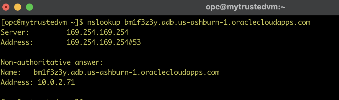

Let us check what the fully qualified hostname is mapping to:
FQDN IP address
It’s the private IP address of our Autonomous Database. (The name is on the detail page of the Autonomous Database above as well – the private endpoint URL – but not legible in our screenshot.
My VM can do proper DNS name resolution to access my Oracle database, so no further actions are required, and I am all set to use the MongoAPI (or one-way TLS sqlnet or APEX with the network security list shown above). We are all set for our production environment. But now, what do I do for my developer’s (local) laptop?

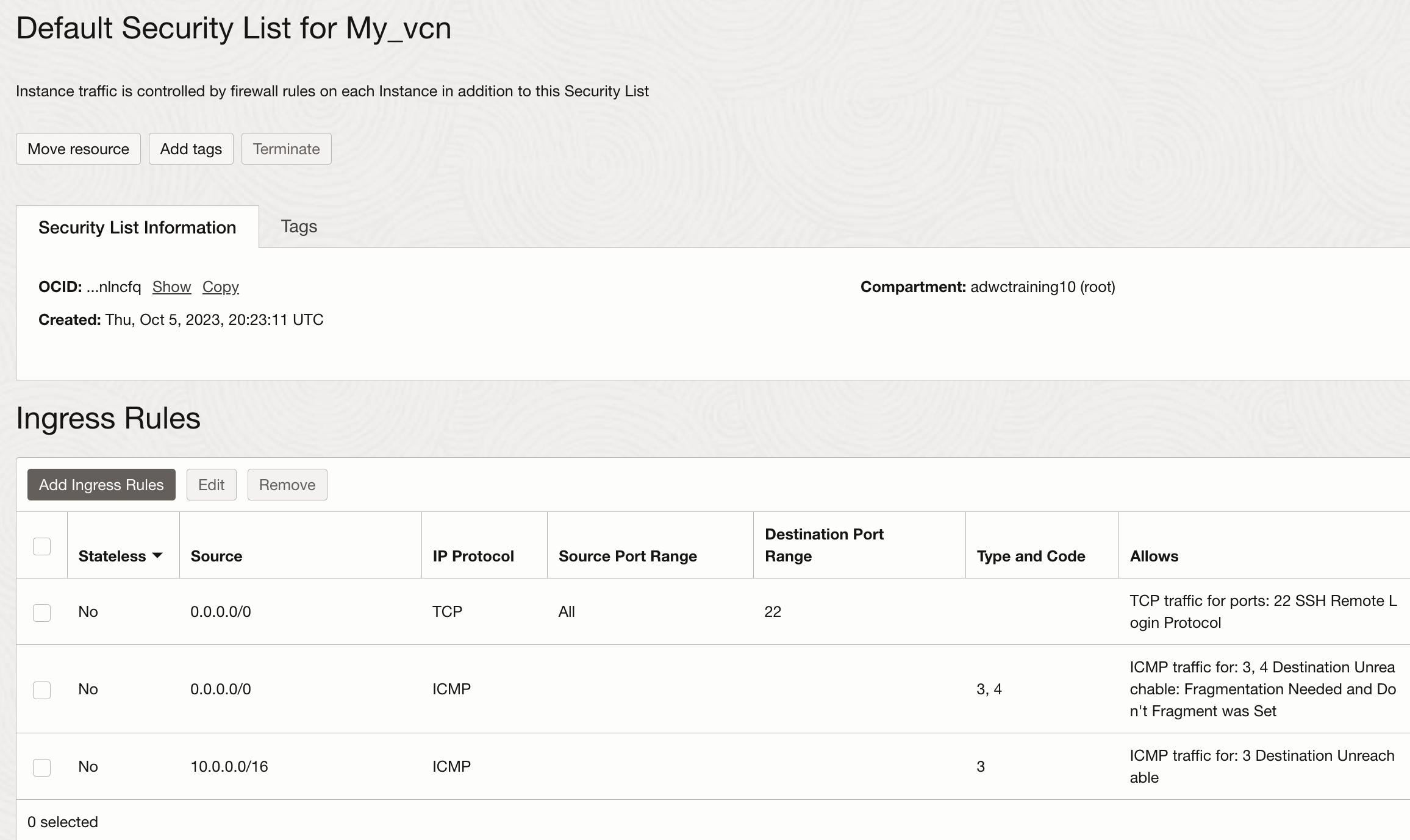

We will use our test VM for this exercise. Let’s quickly check the firewall settings of this VM to see whether my laptop can connect:
security list of vm
As you see, the default security list of our public subnet allows ssh connection from everywhere to our VM, so we are covered. (Egress is set to communicate with everybody on all ports and protocols.) Don’t worry, good luck to everybody out there to get my private key.
If your security list is defined differently and does not allow an ssh connection from the laptop to your bastion host, you need to enable TCP to ingress/egress on port 22 for your laptop. If you cannot connect via ssh to your bastion, you cannot use it as a tunnel.

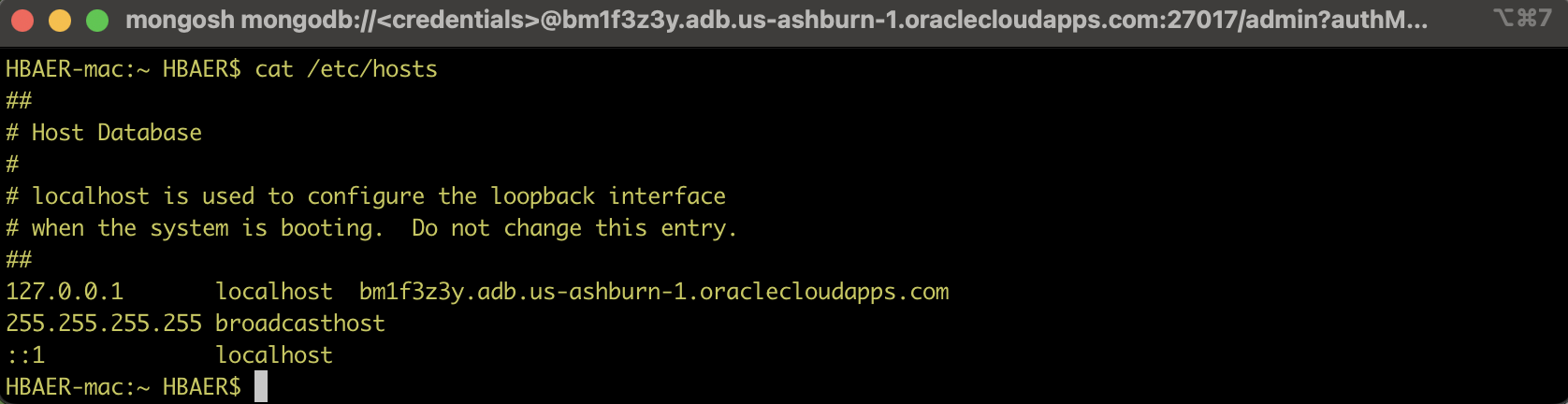

We are now almost ready to connect. But there is one more important step for us: we need to ensure that we can use the FQDN of our Autonomous Database to connect.
Configure your local DNS to map the fully qualified hostname to the localhost
My laptop has not the slightest clue about the names of hosts inside the private VCN in the Oracle Cloud. So, I need to teach it to map the necessary name to the IP address I have to use for communication.
This is because an SSL certificate is typically issued to a Fully Qualified Domain Name (FQDN) such as “https://www.domain.com“. That’s what the Oracle Cloud does, so if you want to use any communication based on SSL, you must ensure that you communicate using a fully qualified hostname and not an IP address. Try it yourself:
  • Do a nslookup of the name of your online bank, e.g. www.wellsfargo.com.
  • Replace the name with one of the IP addresses.
  • See what happens in your browser.
The simplest way for this is to add the fully qualified hostname of your Autonomous Database – the private endpoint URI – to your local /etc/hosts file as a name for your localhost. We need to map it to localhost since the ssh tunneling communication through our bastion will forward the communication from the localhost through the bastion to our Autonomous Database.
local /etc/hosts file with fqdn mapping to localhost

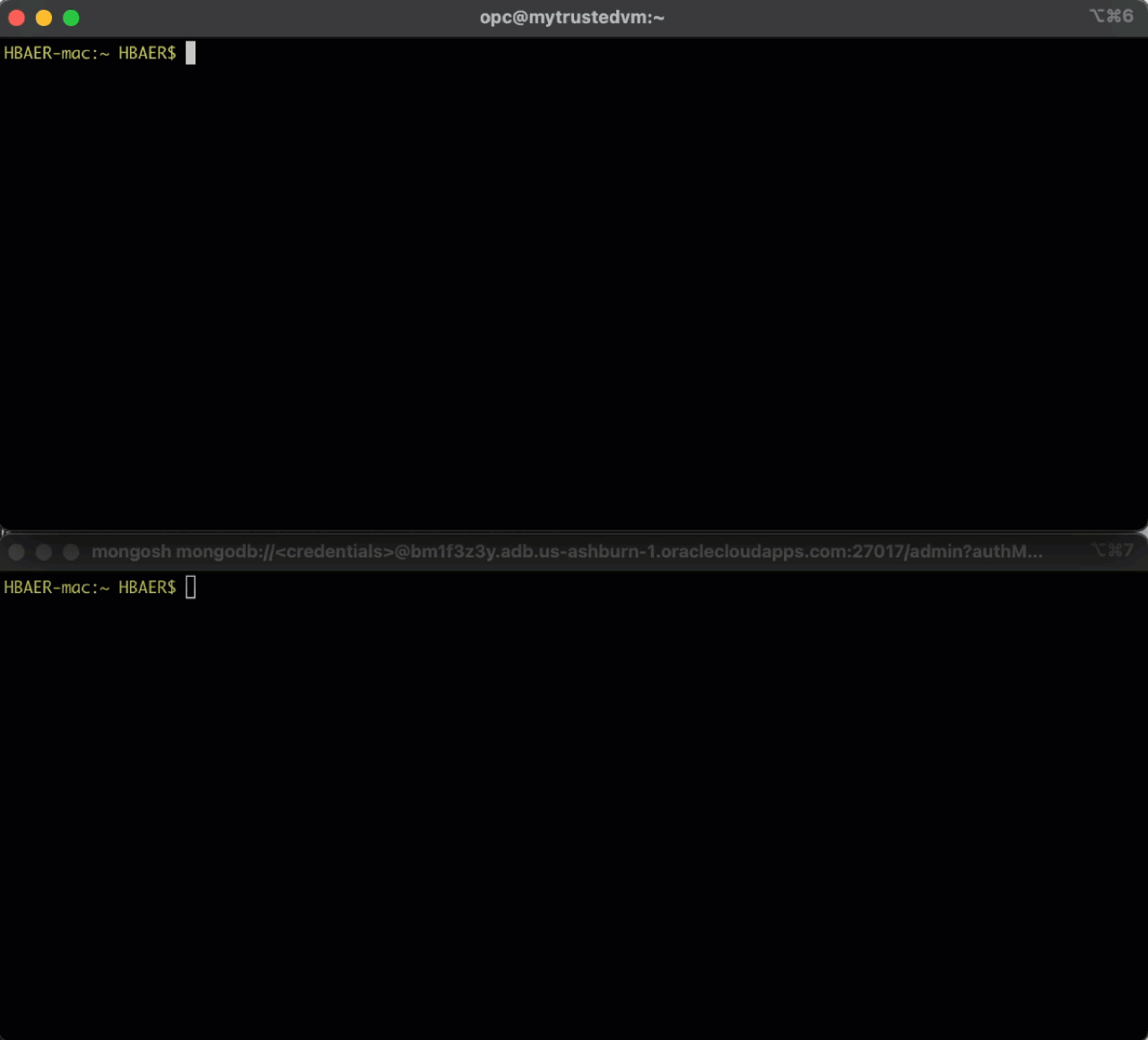

With that, we are ready to try it:
connect to ADB Mongo API through bastion
Port binding works fine, That’s about it. We connected to our Autonomous Database with a private endpoint using the Mongo API from a laptop not in the private VNC using a bastion. As always, if you know what to do, it’s not that hard 😉

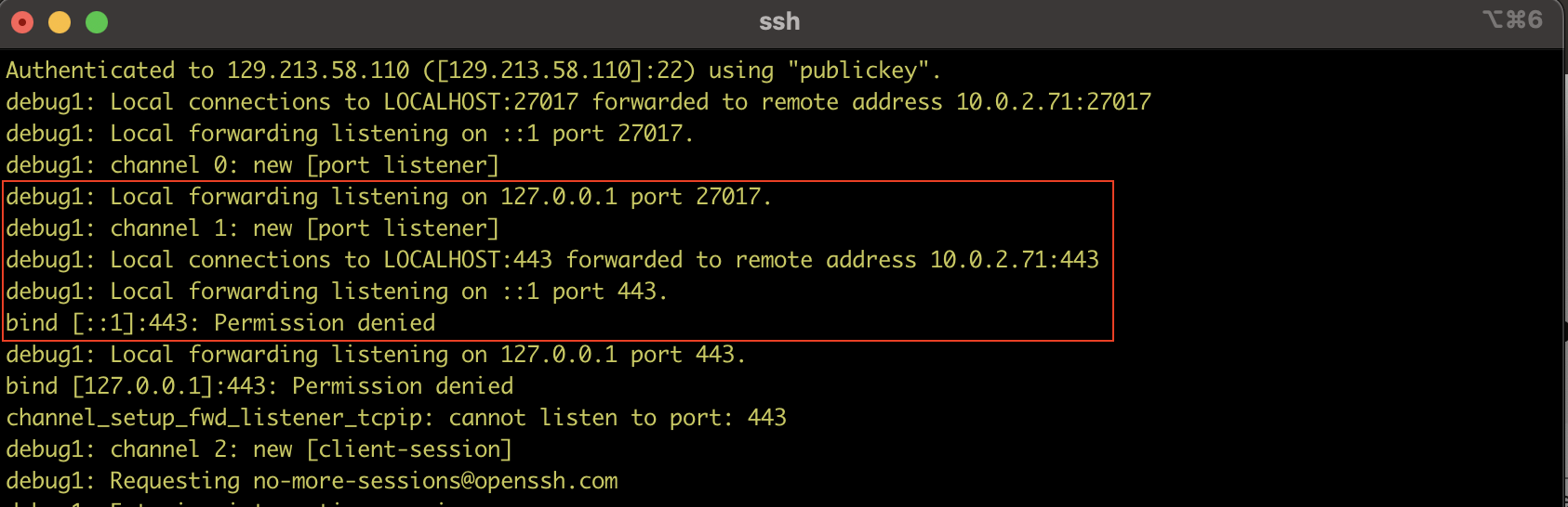

Linux ssh lets you tunnel to more than one port with a single ssh tunnel, but you need to bear in mind that the TCP/IP port numbers below 1024 are special in that normal users are not allowed to run servers on them. So when you want tunnel any of these ports – like 443 – you either need to grant access to the relevant ports, or much simpler, run the tunneling command as a privileged user.
While the command now looks as follows, you need to run it as privileged user:
ssh -i ~/.ssh/id_rsa -v -C -L 27017:10.0.2.71:27017 -L 443:10.0.2.71:443 opc@<the public IP address of my bastion>
If you don’t do this, you will see a binding error in the debug mode I used in this blog:
ssh tunnel with error

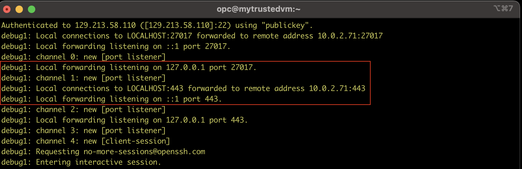

I am just using ‘sudo’ now, and voila, it binds both ports properly in one go, and you’re ready to use the Mongo API and APEX with one tunnel.
sudo ssh -i ~/.ssh/id_rsa -v -C -L 27017:10.0.2.71:27017 -L 443:10.0.2.71:443 opc@<the public IP address of my bastion>
proper ssh binding

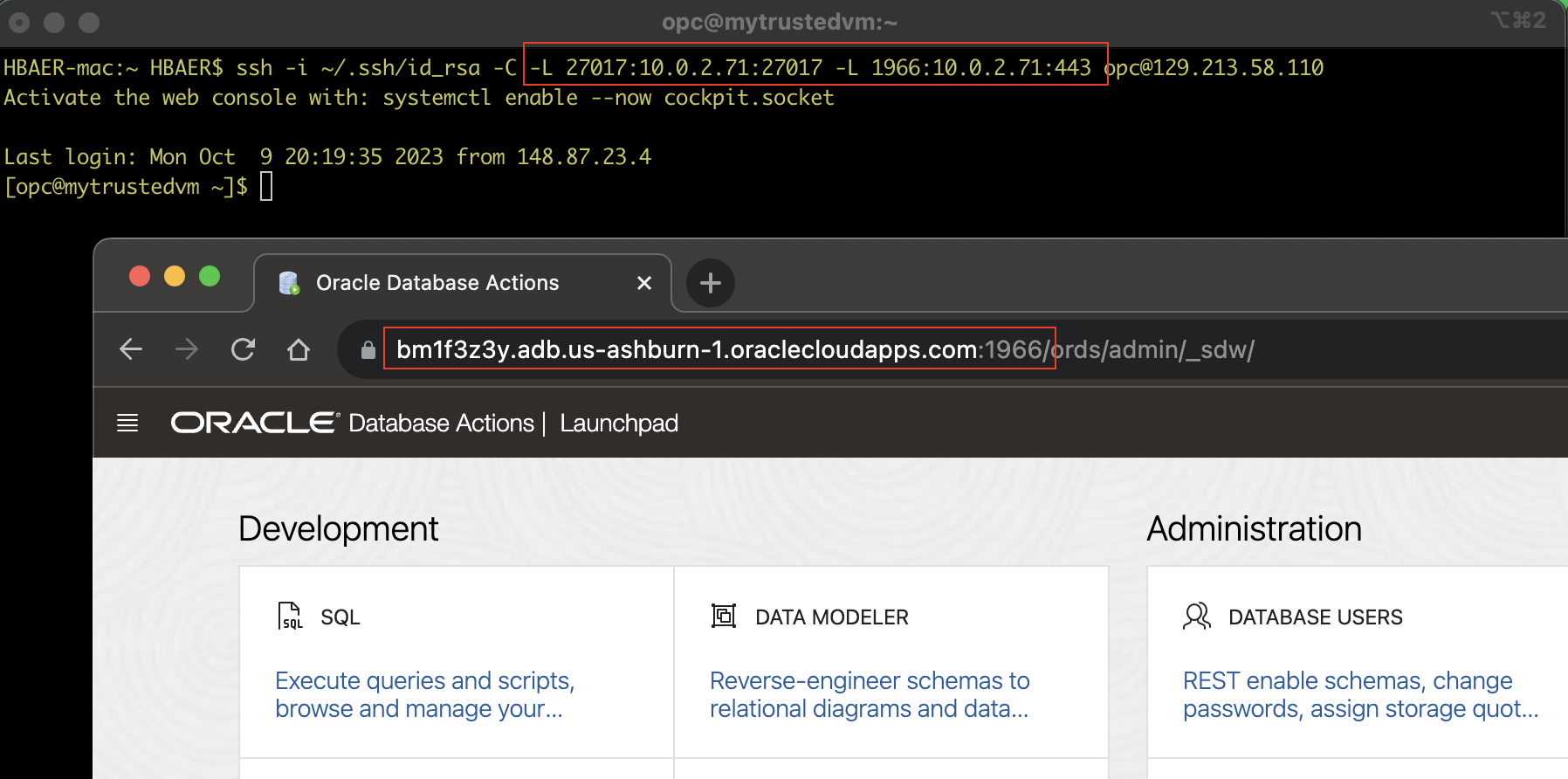

 And there is one more thing ….
You do not have to use the original port 443 if you don’t want to run the tunnel as a privileged user. Just use a port above 1024 locally to communicate with the bastion, which by itself will route it to the right port of your autonomous database, e.g.
ssh -i ~/.ssh/id_rsa -v -C -L 27017:10.0.2.71:27017 -L 1966:10.0.2.71:443 opc@<the public IP address of my bastion>
In this example, we are tunneling two ports through the bastion, and we even use the local port 1966 to the bastion, which itself forwards the traffic to the original port 443. The only thing to remember here is that you now need to use the local part to connect to APEX or Database Studio, as shown in the screenshot below.
dual port forwarding and port re-routing
